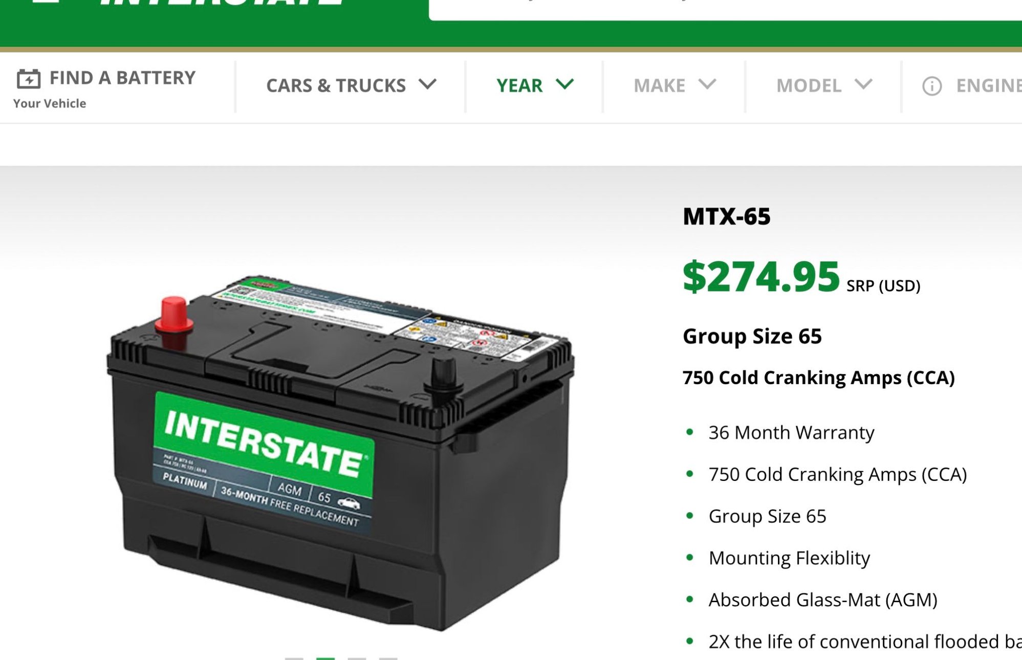

A picture would have been terrific and answered some questions for me.
To my eye the Interstate battery, as shown on their website, looks exactly the same on the exterior as my Walmart AGM. The only external difference I see is the color of the bottom case and the warranty. For me the real question is:” What are the internal differences, if any?”.
Bob

Externally, they are exactly the same, down to the scoring detail in the circular cell caps.
Internally, no information is available to the public to make that determination.

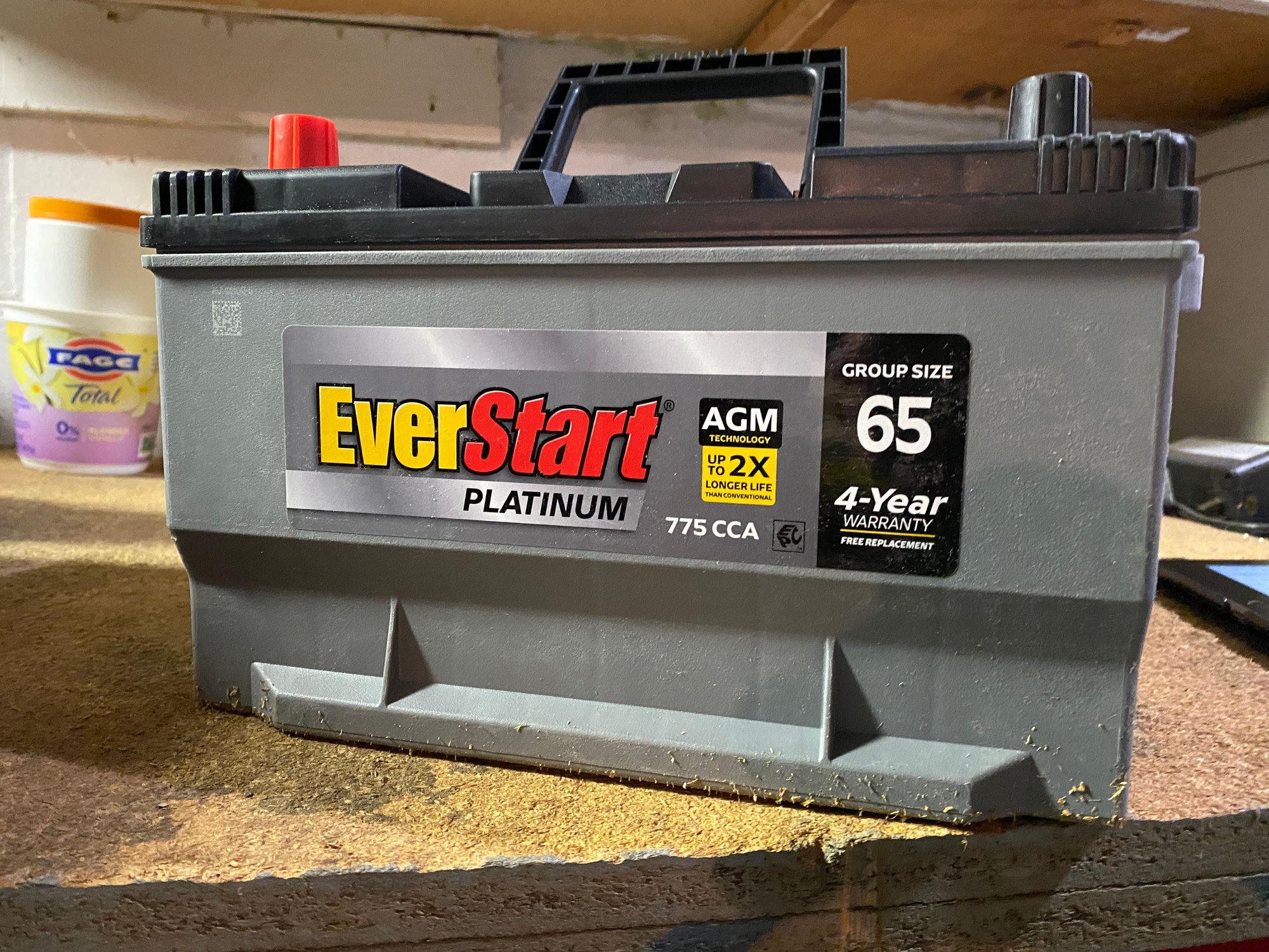

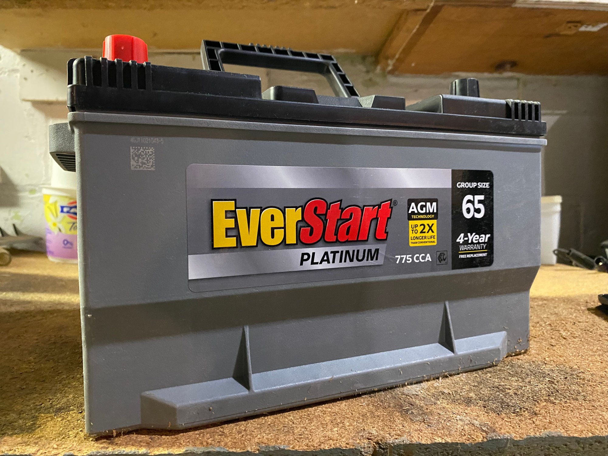

A lot of good information.
As I just today purchased 2 Walmart EverStart Platinum AGM batteries, Group size 65 with 775 CCA. They have the fold down handle into the top of the batteries.
The date sticker says 1/2025. Looks like the newer batteries are of the 775CCA variety ?
If pictures are needed I could take some prior to installing them within the next few days.
From what I've read is that locking the truck for 8 hours or more will update system to the AGM battery versus Flooded Lead Acid.
Truck is a 2019 F350 King Ranch with 6.7 and lots of other electrical added items. Snow Plow package, heated rear seats, auxilary fast heater (not sure if that is the actual name).
