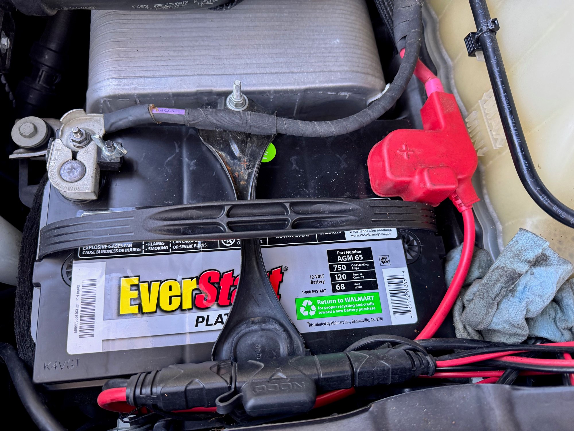

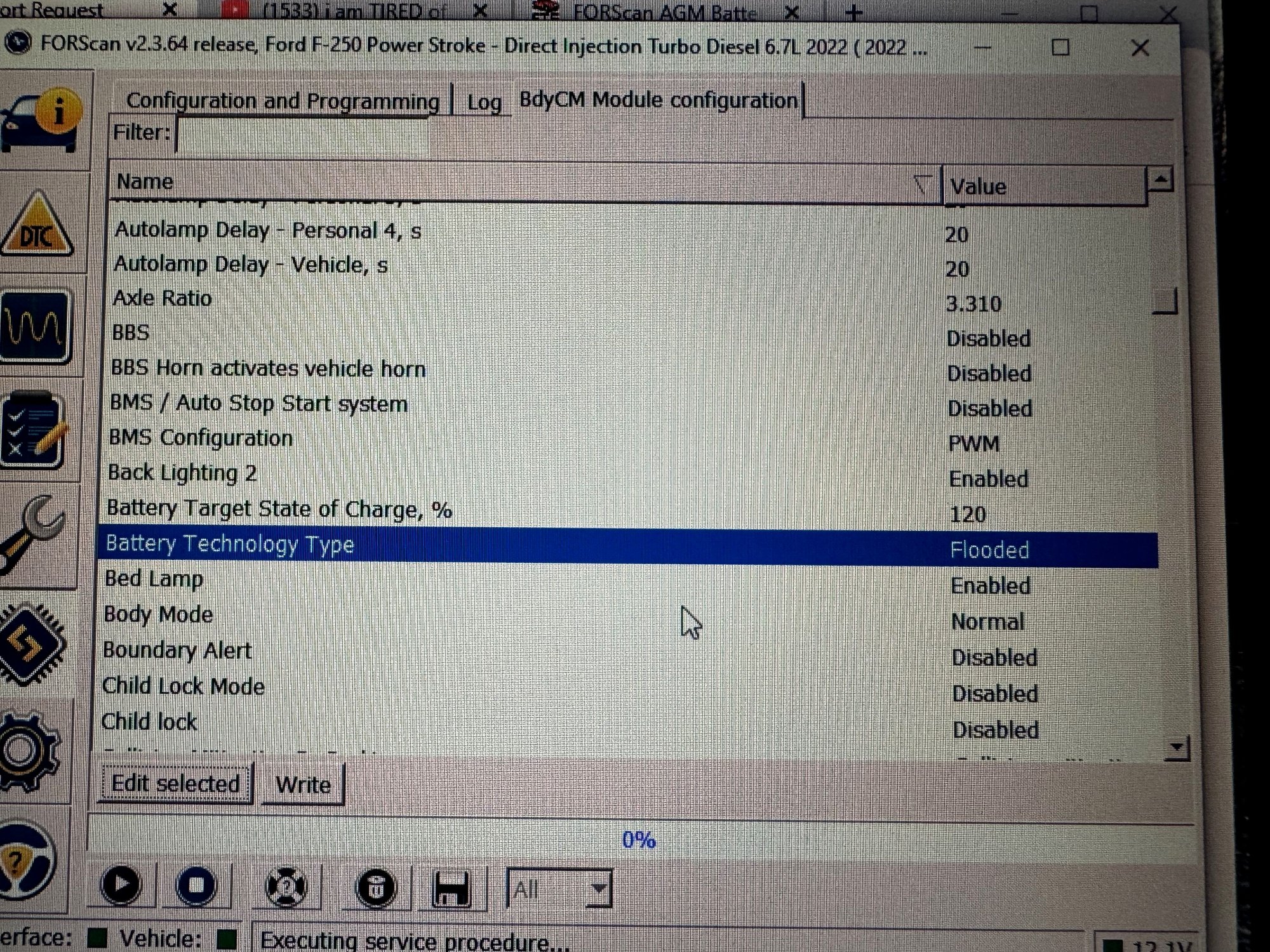

So just wanted to update my process with Forscan and my findings using it. Also, FWIW, my truck is a 2022 6.7 and was built 9/17/2021. It came with 2 FLA batteries and dual alternators.
First off, as already mentioned, we cannot purchase an extended license, however, we can still get the free 2 month trial license. My mistake was not reading the directions, which has changed since the last time I got a trial key and was emailed to me. After going back this evening, I noticed that they state in bold that the trial key will not be emailed. This is what they say:
As soon as the form is filled and submitted, the process of Extended License generation will be started. The process may take some time, usually up to 30 minites. The Extended License key will NOT be sent by email. Instead, you will be able to download the license key on this page as soon as the generation process is completed, by reloading the result page or by resubmitting the form using the same data.
Once I followed the directions, the key was immediately available.... So I went out and hooked it up to the truck. I pulled up the English side of the BdyCM module and found that the "Battery Target State of Charge, %" was set to 120. I would like to read more about this and find out why it is actually set to 120. I have heard that some (unsure what year models) are set to 80, and I have see where at least one user changed it to 90. I went ahead and changed it to 100, knowing how easy it is to change it back to 120, or something lower, but I would like to figure out more about this setting. I understand that different battery types have different preferred charge rates at different stages. I just can't understand why 120 was ever an option. Also, since it is listed as "Target State of Charge" this makes me think that this number doesn't represent one of the stages of charging, such as "bulk" charge. Makes me wonder if it has something to do with 1 battery vs 2... I don't know.

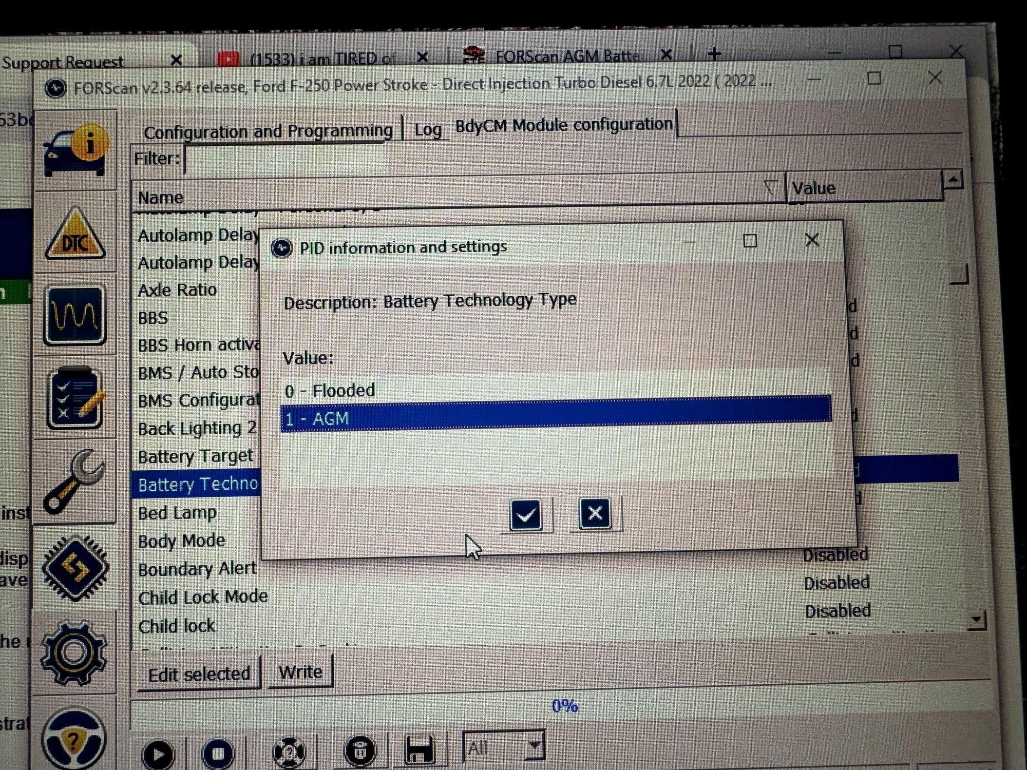

Also, the "Battery Technology Type" was set to Flooded. I was pleasantly surprised to find that there were only 2 options for this: Flooded and AGM. So this was an easy change, and is now set to AGM. And I did change the battery type to AGM first, just to see if it would change the target state of charge % afterwards, however, it did not.

Everstart Platinum AGM Group 65 driver side battery.
BdyCM module in Forscan. You can see the Battery Target State of Charge, % and the Battery Technology Type. This is the default settings. I changed it to 100% and AGM.
Only 2 options on the Battery Technology Type, Flooded and AGM. I have seen some photos with more options, but not sure what year they were.
