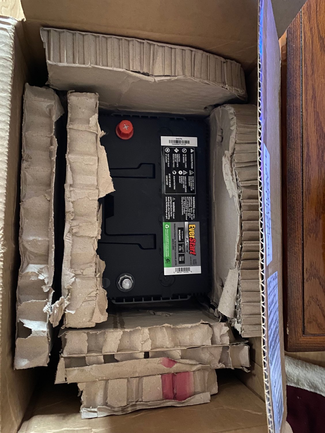

The Everstart batteries were delivered by FedEx today. Thy were well packaged. One was fully charged and one was only 80% charged. First order of business is to top them off before install.
I never thought my simple question would become so complex and generate the responses it did. I want to take a minute and thank all who have posted , and continue to post. It has been very educational for me and I am sure other members as well.

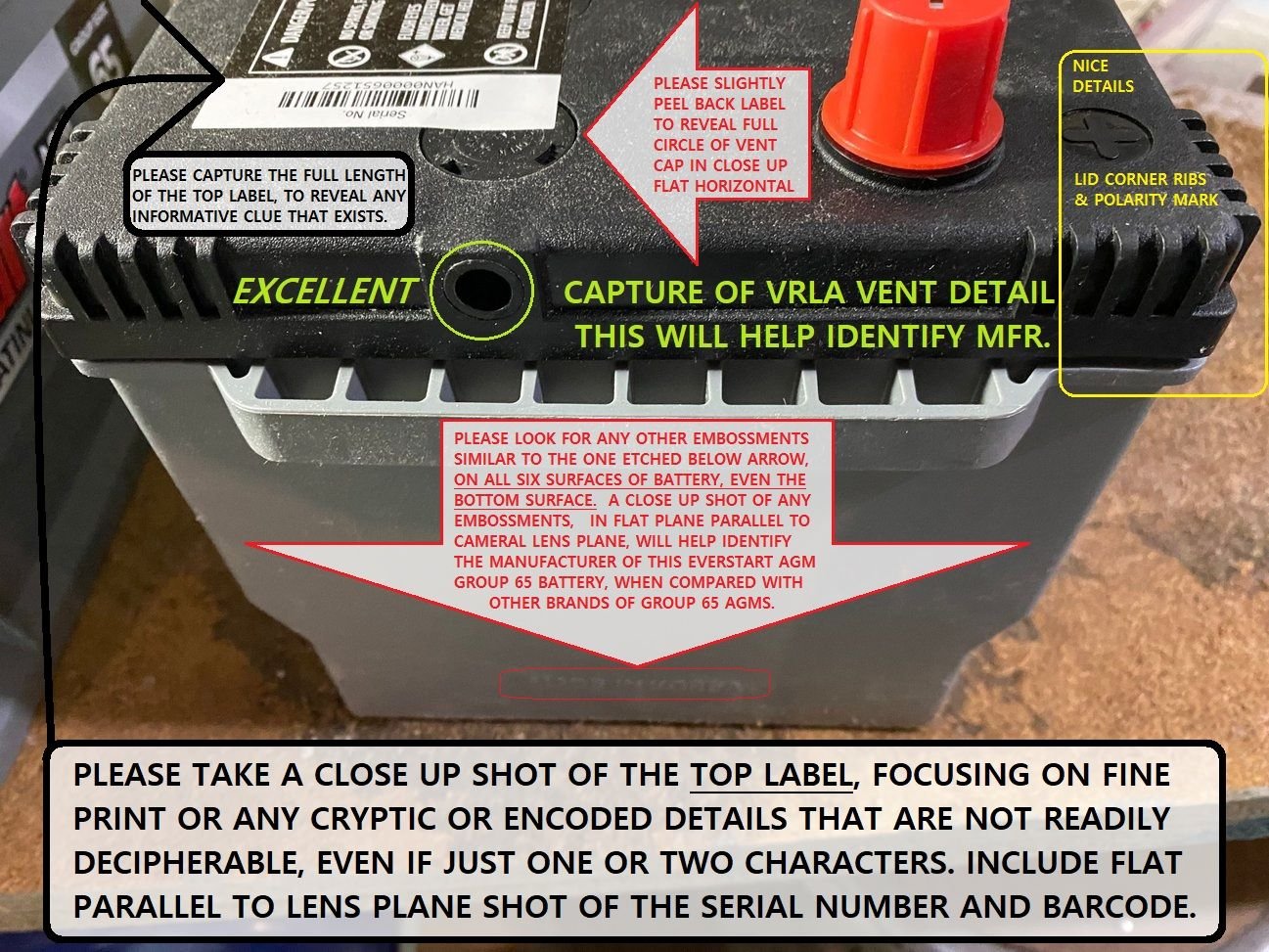

@HorizontalHunter
Your top down photo of your newly arrived Walmart Everstart AGM platinum battery indicates a THIRD case design (which suggests three different supplier manufacturers) for the Everstart Platinum AGM in the Group 65 size.
Before you install the batteries, and while you are topping them up, can you take a few more photos of your new Everstart batteries?
a. Macro close ups of the fine print on any label
b. Any stamped or heat seared case embossments of letters or numbers of any type
c. The construction of the lower half of the case, where it would engage any old style Ford wedge battery hold down cleat.
d. The upper sides of the battery, at the lid to case interface... any perimeter stiffening structures that double as support for strap handles, if fitted.

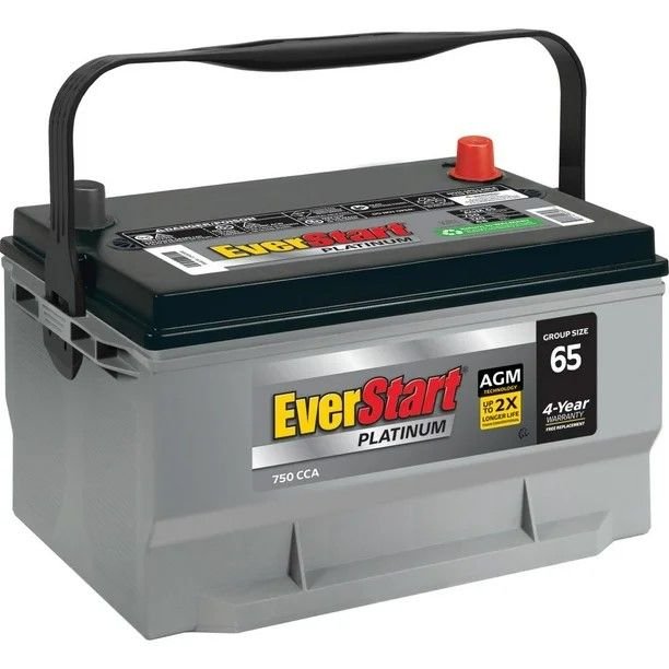

The unique aspect of your Everstart Platinum AGM Group 65 battery is the fact that it has a recessed swing handle embodied into the lid, compared to the two versions of Everstart Platinum AGM Group 65 batteries shown below.
e. Try to also take some shots matching the angles of the photos below
EverStart Platinum BOXED AGM Battery, Group Size 65 12 Volt, 750 CCA
EverStart Platinum AGM 12 Volt Automotive Battery, Group Size 65, 750 CCA, Top Post
Be advised that Walmart may automatically pull these images at any time. So interested parties wishing to compare what now appears to be three (3) different versions of Walmart Everstart Platinum AGM Group 65 batteries are urged to copy and save the two images above, before they are replaced with a grey Walmart logo.
The differences in these batteries strongly suggest a supplier / manufacture difference.
One might be made by Varta, which is owned by Clarios, which is owned by Brookfield Partners, who bought out Johnson Controls six years ago.
Another might be made by East Penn Manufacturing, who private labels many different brands of batteries.
And the third might be another PRC state owned battery manufacturer in China, or for that matter, all three batteries may come from different battery manufacturers in China, which has many now.
It will be very interesting to sleuth out the which battery case matches which other AGM battery NOT branded by Everstart or Walmart.

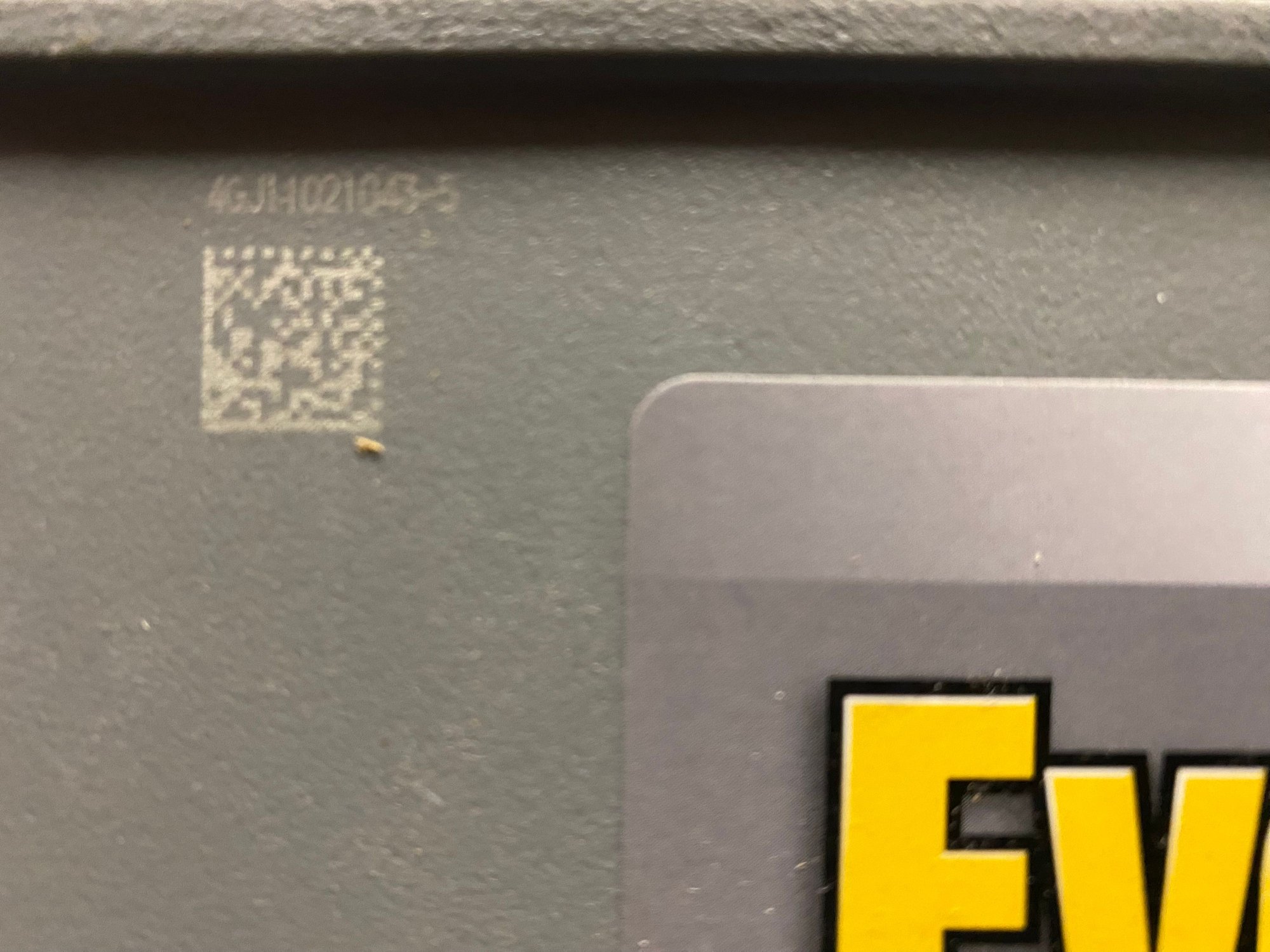

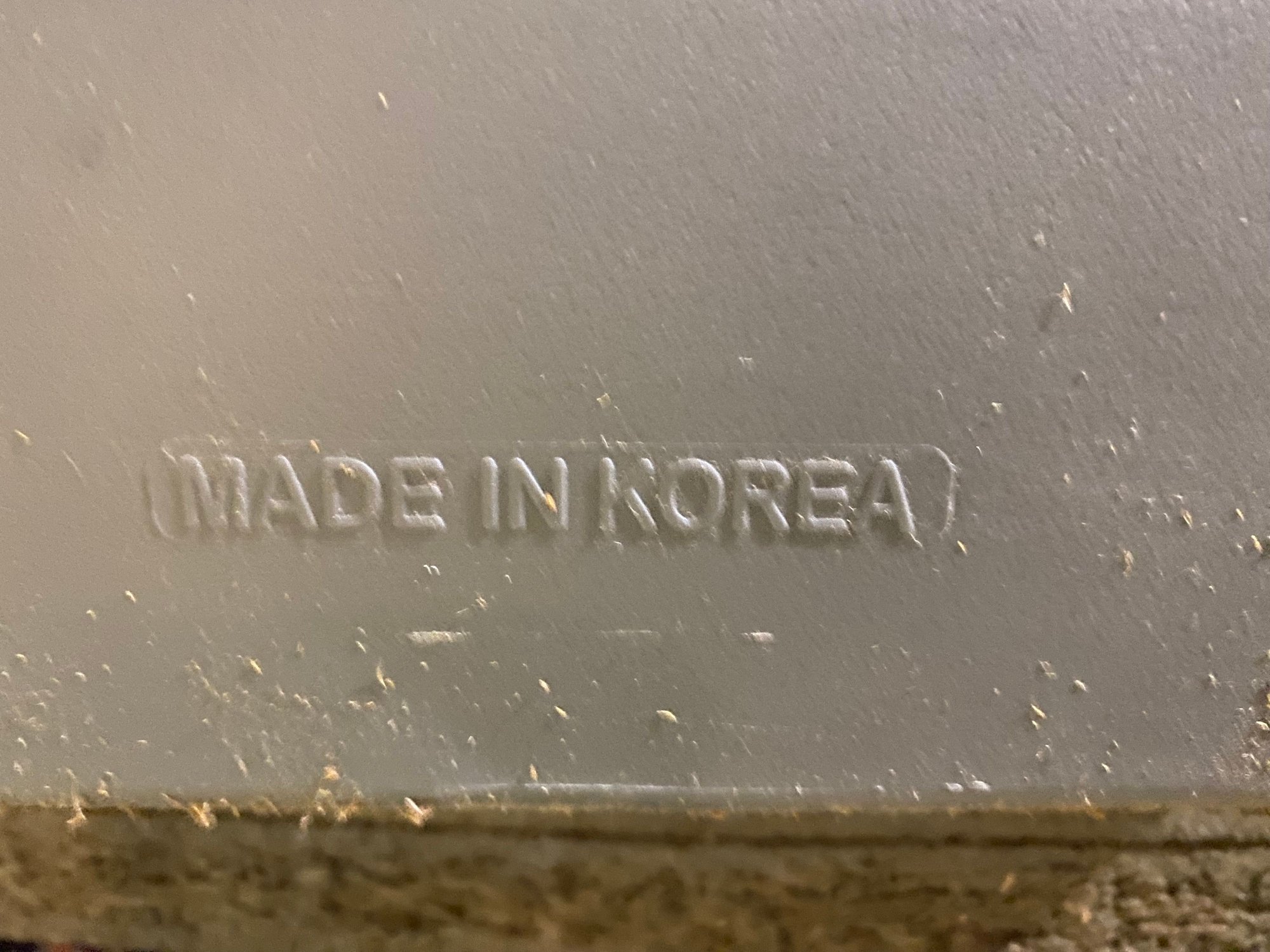

@Y2KW57
Absolutely, happy to. Let me know if you want more. I included an end shot as the carry handle is different and the base is tapered instead of horizontal.
Bob
