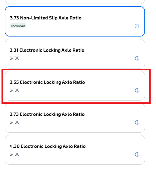

Originally Posted by ATC Crazy
3.55’s are not offered behind a gas engine anymore, so we can forget about those for this discussion. 3.73 or 4.30 is all you get.

art cooney's Avatar
art cooney
Trailering
Joined: Aug 2016
Posts: 17
Likes: 11
I just tried to do a build and select the 3.55 with the 7.3L gas engine and it brings up the dialog that says it will add the diesel and remove the gas engine. So, it looks like even though it shows as an option, it is only for the diesels.
