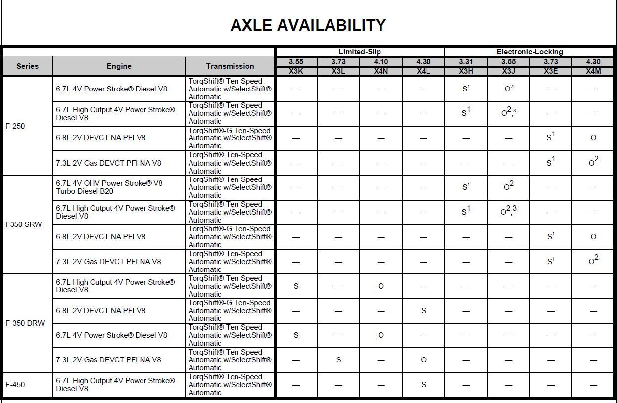

the first gear on the old 6 speed was 4:17:1. That means a 10R100 with 3.73 has first gear equivalent to 4.20 on the 6R100.
https://media.ford.com/content/dam/f...Tech-Specs.pdf
By that logic, since the highest ratio offered with 6 speed gas F250 and F350 was 4.3, and a majority of them had 3.73, all ford gas trucks should be dead by the side of the road from tranny blowing up from gear hunting and 6.2 gas motors dying from constantly being lugged. At the very least ford owners hould have made a class action lawsuit against to Ford that their 3.73 6.2 trucks were totally undriveable and 4.30 6.2 trucks were BARELY adequate.
So either ford trucks have been dying left and right and we just don't know about it, or that the 4.30 imperative upheld as gospel by a small group of users is mostly based on conjecture and preconceived notions, and perhaps, just perhaps, users' own confirmation bias.
