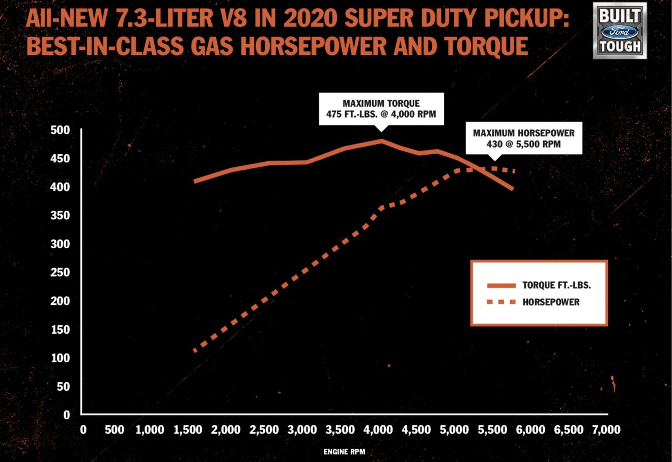

You don't believe the 7.3 makes over 80% of its torque at 1500RPM onward? Do you trust ford or do you think you want a more credible source?

Peak is correct but the rest of the chart is misleading. Torque = HP x 5252 divided by RPM, when you do the math 100hp at 1500 RPM like the chart shows doesn't come out to 80% of the engine's peak torque at 1500 RPM.

If you line up the graph at the mid point of the number 100 you will see at 1500 rpm the HP is a bit above 100. But let's use your understimation, approximation of 100 hp, 350lb-ft at 1500 rpm is 74% of the peak torque and way more than enough to keep a 3/4 ton rolling down the road.
If you can't keep a lightly loaded F2/350 going down the road with that kind of torque between 1500 and 1700 rpm, then it is user error or mechanical issue.

Either way it's still irrelevant, you aren't making the max torque for that RPM unless the throttle is wide open.

A torque curve that flat is irrelevant? LOL. Whatever happened to your wild accusations of "false numbers"? Did Ford make all this up just to screw with you? In the old days people had enough sense to not accuse others of lying unless they are sure. You don't seem to have that sensibility or decency but, at this point in time, it's exactly what I expect from you. I expected better from someone flying the Battle Flag.
Like I said, if you find that kind of torque challenging to work with without the aid of 4.30, it's a user problem, not an equipment problem.

Torque numbers are on the chart by Ford, if you don't like it, take it up with them.
