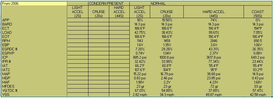

I tried to search and I am sure the information is on here but is there a list of ideal Scangauge reading values.
for example what is a good range for the transmission temperature to be running at. I am up to 430K miles and while I regularly flushed and changed transmission fluid up to 250K roughly I was advised that if I changed fluids I was likelto cause more problems than if I simply left it alone if it was running fine
thanks in advance Mark

I'm at 240k and I still flush my transmission every 20k miles or so (the manual states 30k). My flush is a repetitive drain and re-fill. Please do NOT ignore filter changes.
From Piolet (see his attachment at the bottom of his first post):
https://www.ford-trucks.com/forums/attachment.php?attachmentid=71501&d=1364848489
My lists
https://www.ford-trucks.com/forums/a...9&d=1487935804
https://www.ford-trucks.com/forums/a...0&d=1487935804
https://www.ford-trucks.com/forums/a...1&d=1487935804
https://www.ford-trucks.com/forums/a...2&d=1487988098
ICP volts relationship to pressure (see last couple of posts in the thread linked below)
https://www.ford-trucks.com/forums/1198869-relationship-between-icp-pressure-and-voltage.html
