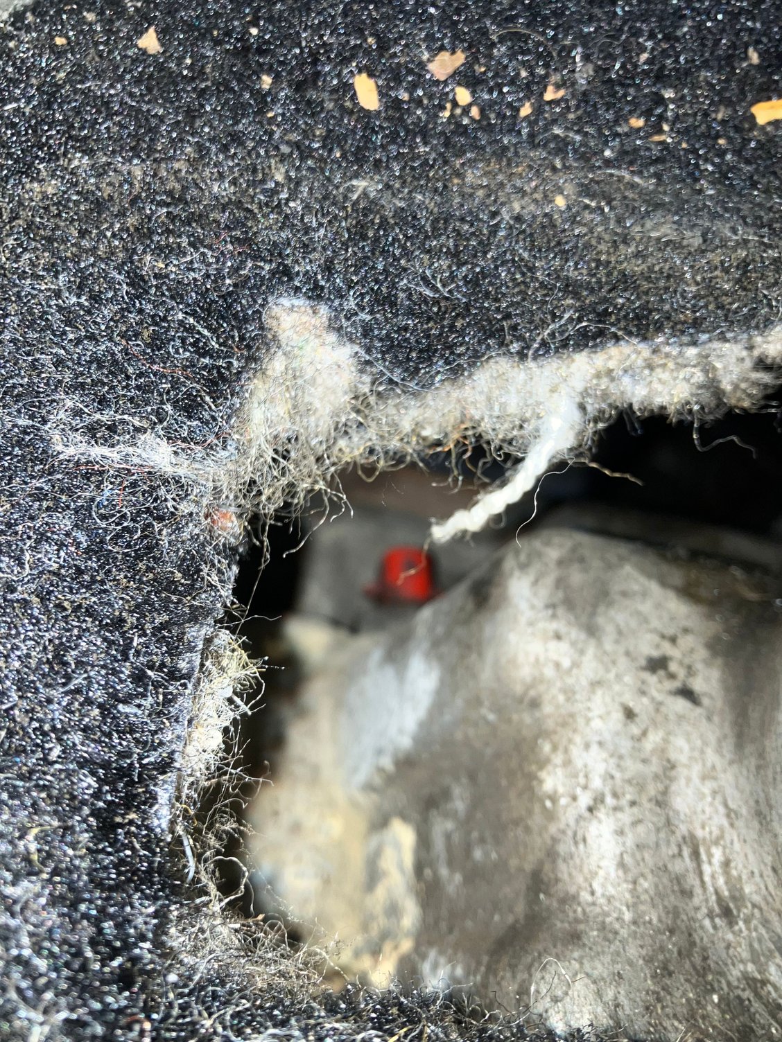

Hi everyone,
I inherited a 1985 f150 4 speed manual. The reverse lights aren’t working. I believe it has a Borg Warner T18 in it.
i took the shifter boot off and the switch looks like the one found here:

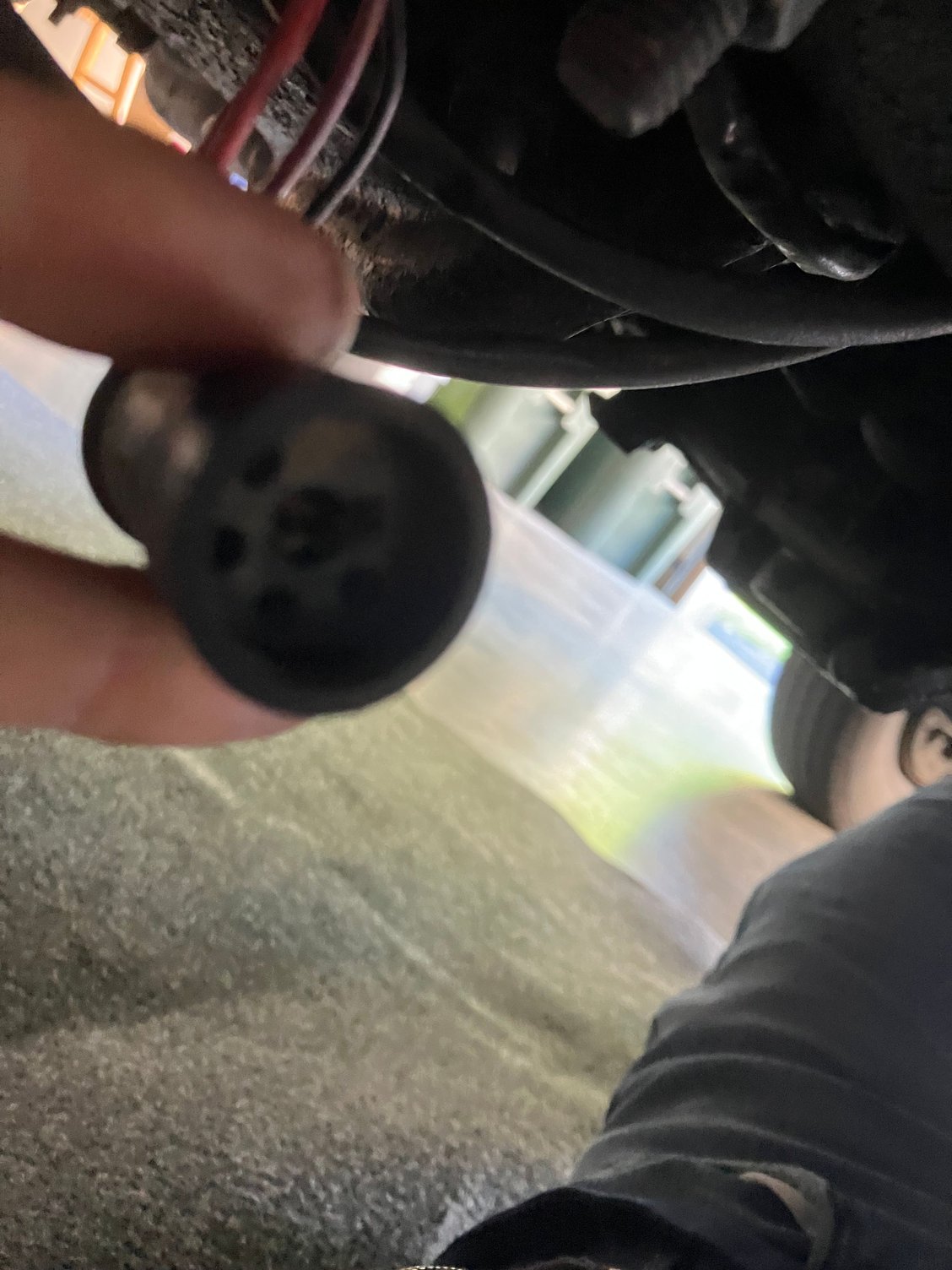

I’ll attach a picture. I don’t see any connector plugged in. I am under the impression that I need to buy something like in the link above. I’m unsure what I plug the pigtail connections into. I also found this unplugged underneath the truck.

Connector found underneath truck
Reverse switch
Reverse switch

Here's a purloined image from eBay showing the location of the reverse light switch on a T-18. This is the same arrangement as the T-18 on my '84 F250:
Red switch connector at the lower left corner of this stolen image
https://www.ebay.com/itm/336532750934
Courtesy of RockAuto, here an end view of the 2-pin connector:
More pics here:
https://www.rockauto.com/en/catalog/...mp+switch,4240
Does your switch look like that?
Not sure about that round connector you found. Are you positive you have a T-18? Look at the certification label on the driver's door jamb for a transmission code. Post that and we can help determine what you have.

Yes the switch looks like that. It’s oval shaped. I’m not entirely sure it’s a T18. The door jam says T19 but it doesn’t have the original transmission in it. It’s hard to downshift to 1st (unsynchronized) which made me think it was the T18

Originally Posted by 19bulln0se85
Yes the switch looks like that. It’s oval shaped. I’m not entirely sure it’s a T18...
Okay, we are making some progress. If the switch has the oval 2-pin connector as shown above, the exact transmission model does not matter.
Even if the transmission has been changed, the original was a T19 so that would have had the same oval connector. Not sure what to tell you about why the corresponding harness connection is not nearby, or what that round connector is.

yes, I cleaned the socket and verified the bulbs were good. I can check the wiring in the vicinity and the grounds.
My understanding is that the connector that plugs into the reverse switch is missing and the pig tails would need to get spliced into the back-up light wiring any way. Thank you!

Keep looking around for the wire and plug. If someone swapped the transmission they unplugged the wire and hopefully wrapped it up and around something close by.

Will do! Part of me is wondering if the connector from my first post is the one that plugged into the reverse switch on the original transmission and the back up lights have never worked since the new one was added

You can apply 12v to the connector and see if the reverse bulbs light. Then if they do replace the connector with the one you need. Or innovate and run wire to a toggle switch in the cab. Who needs to wear out bulbs everytime you hit reverse?

Maybe the reverse lights only work with the headlights on? If so turn on the headlights and one side of the connector has 12v. Then jump across and check the reverse lights.
