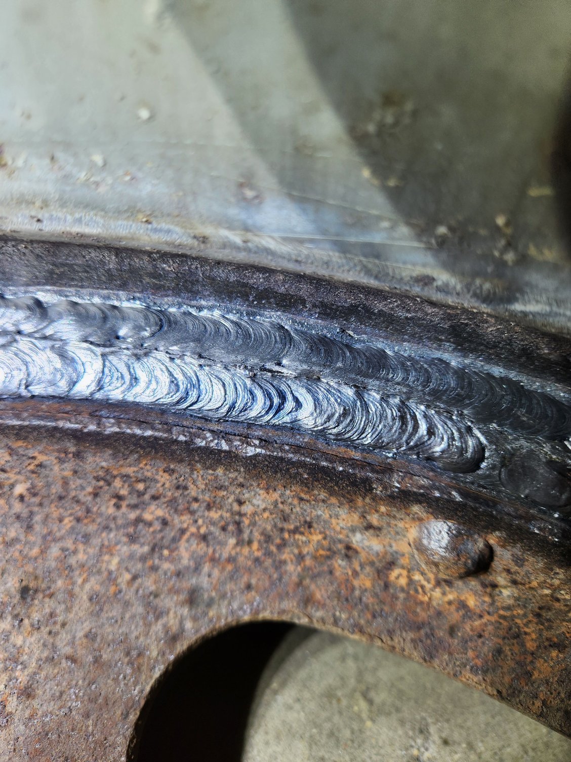

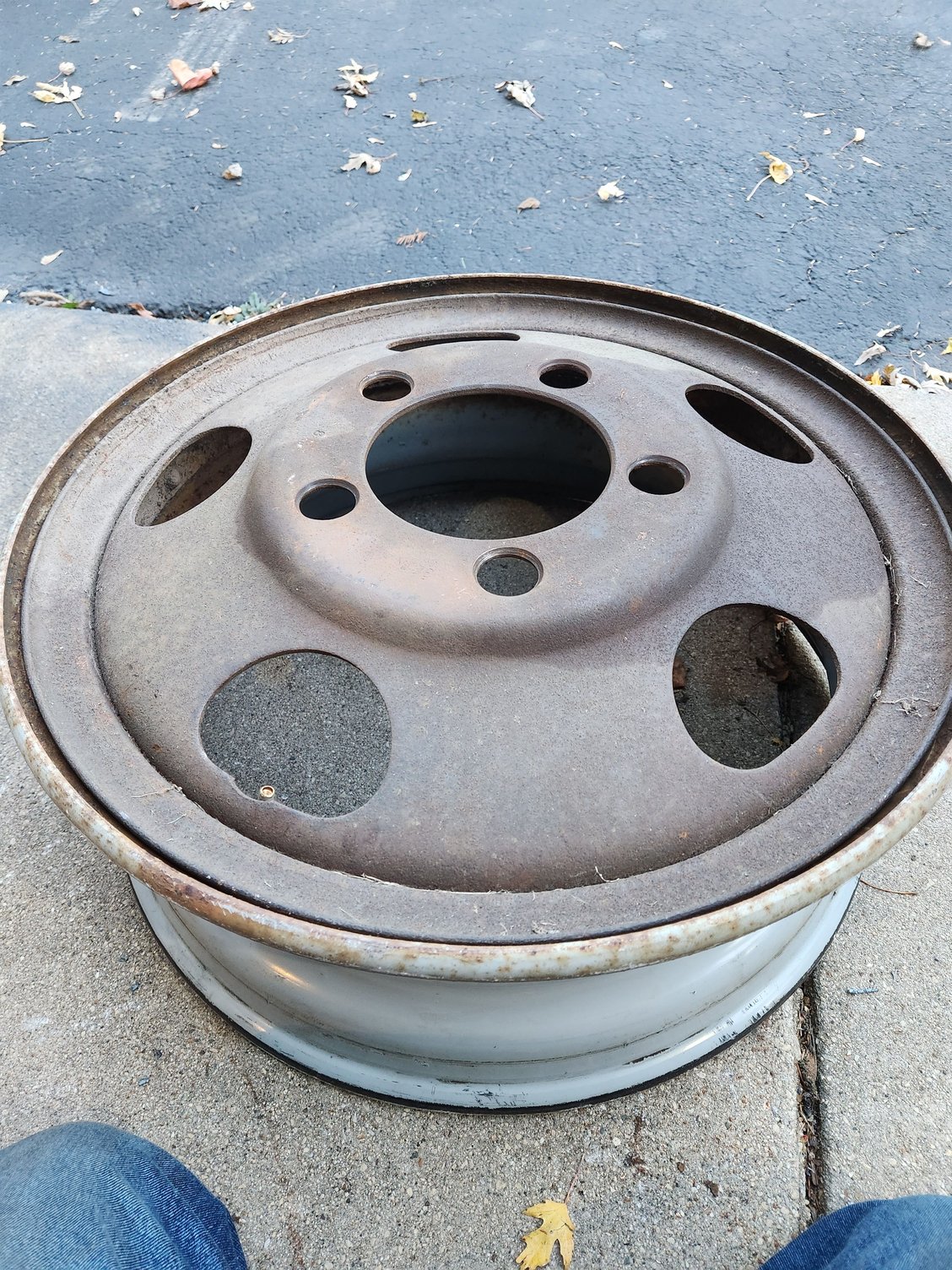

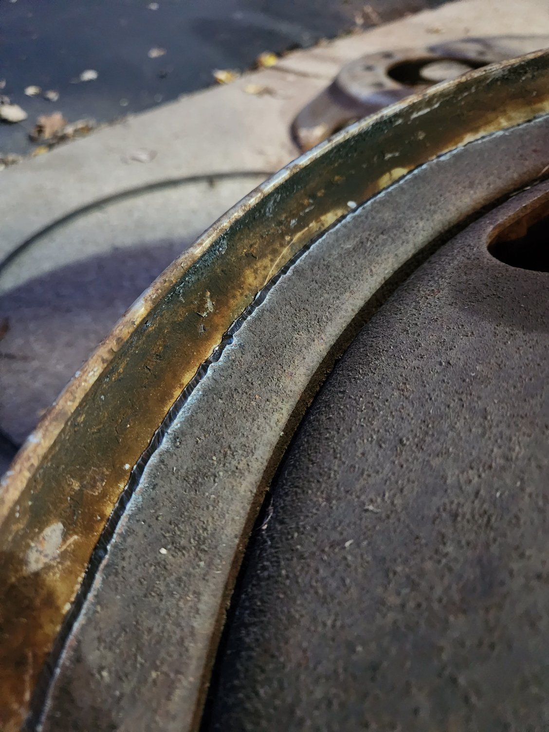

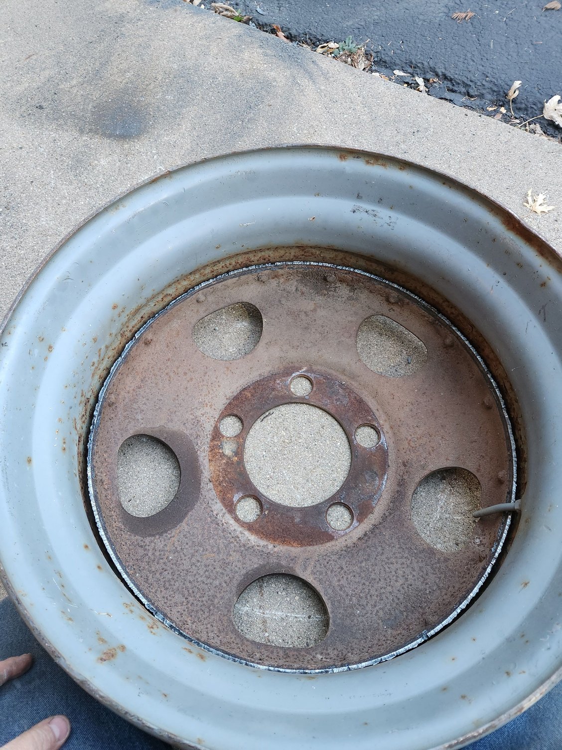

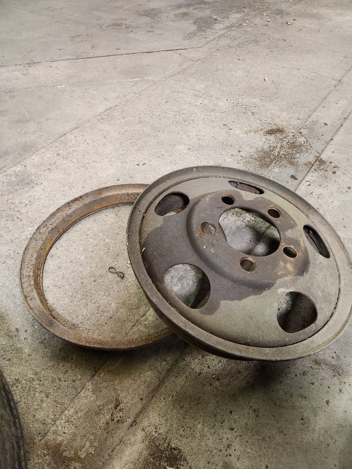

Original RH5

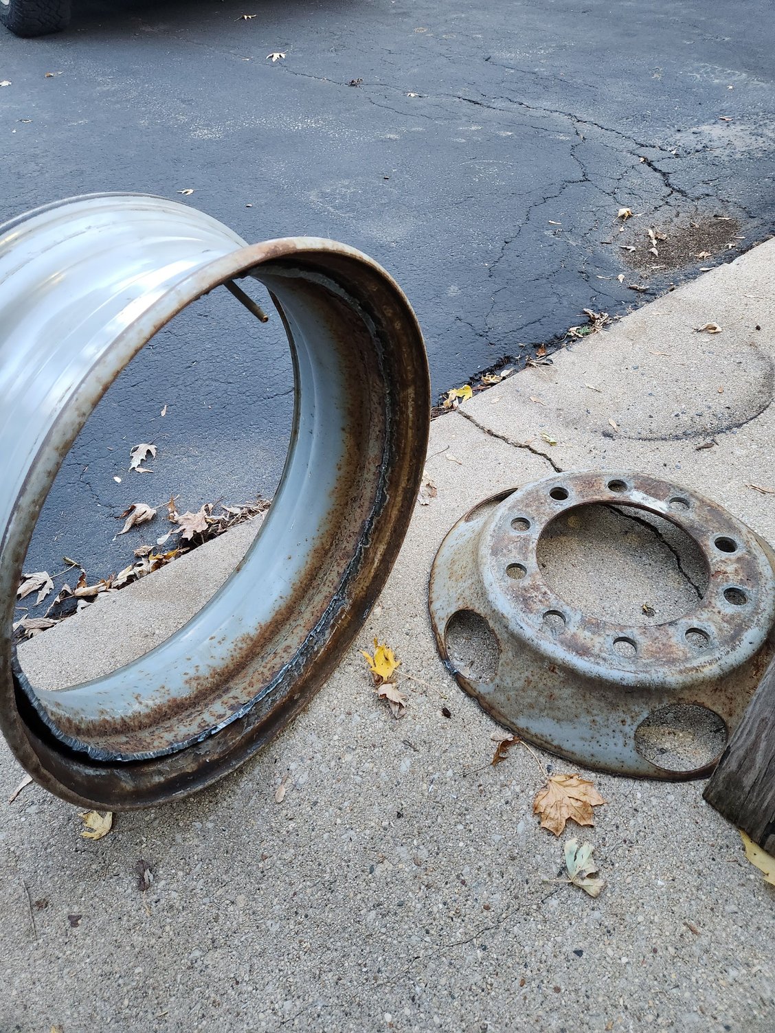

Cut the center out of a 7.5x22.5
Cut part of the outer half of the rh5 off...right at the edge of the rivets
Drops right in
1/4" gap is all thats left
See the gap
Cut just the lip off the rh5 so it is flush
1/4" x 1" rolled into a hoop by the fab shop
Fills the gap perfect

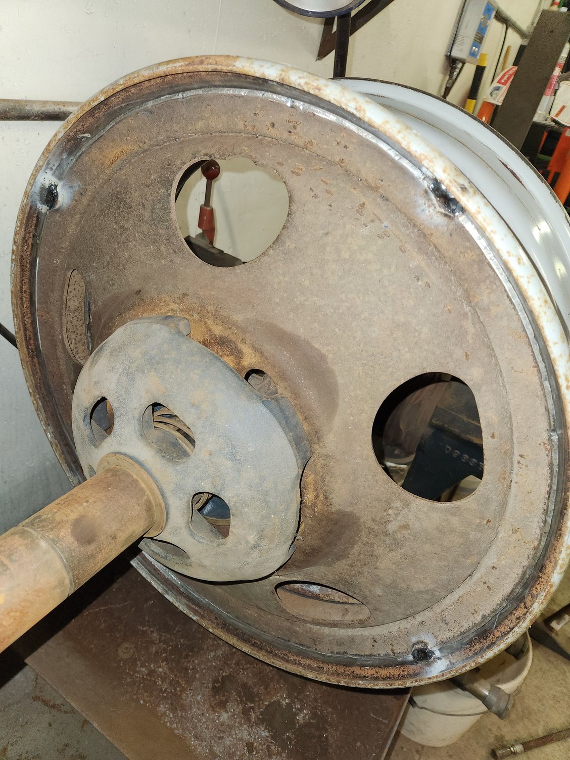

Tacked and spun on a brake lathe to check alignment
Welded on the face and the inside
Welded the 1/4" filler to the 22.5 and then welded again to the RH5....18 feet of welding per wheel

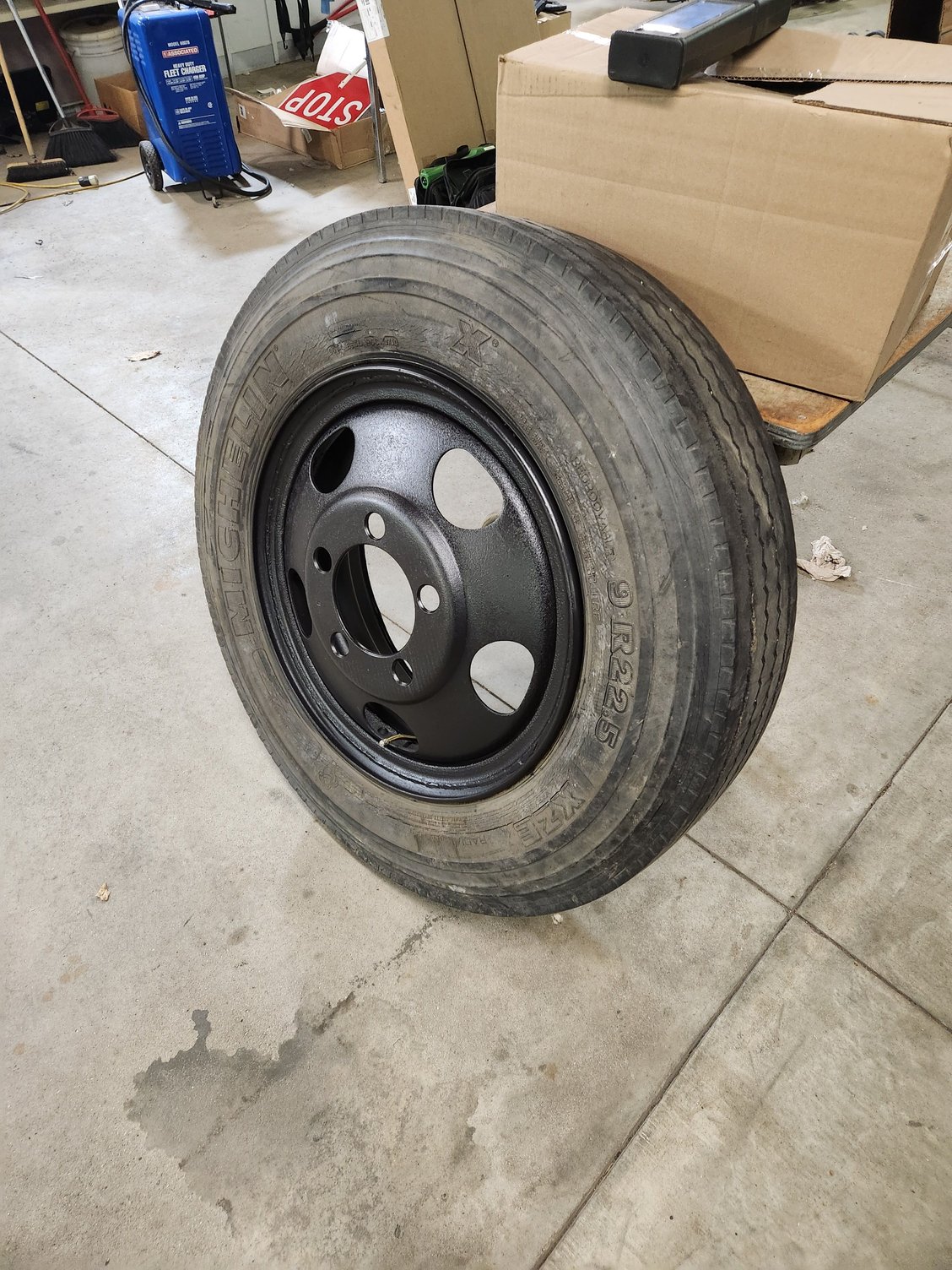

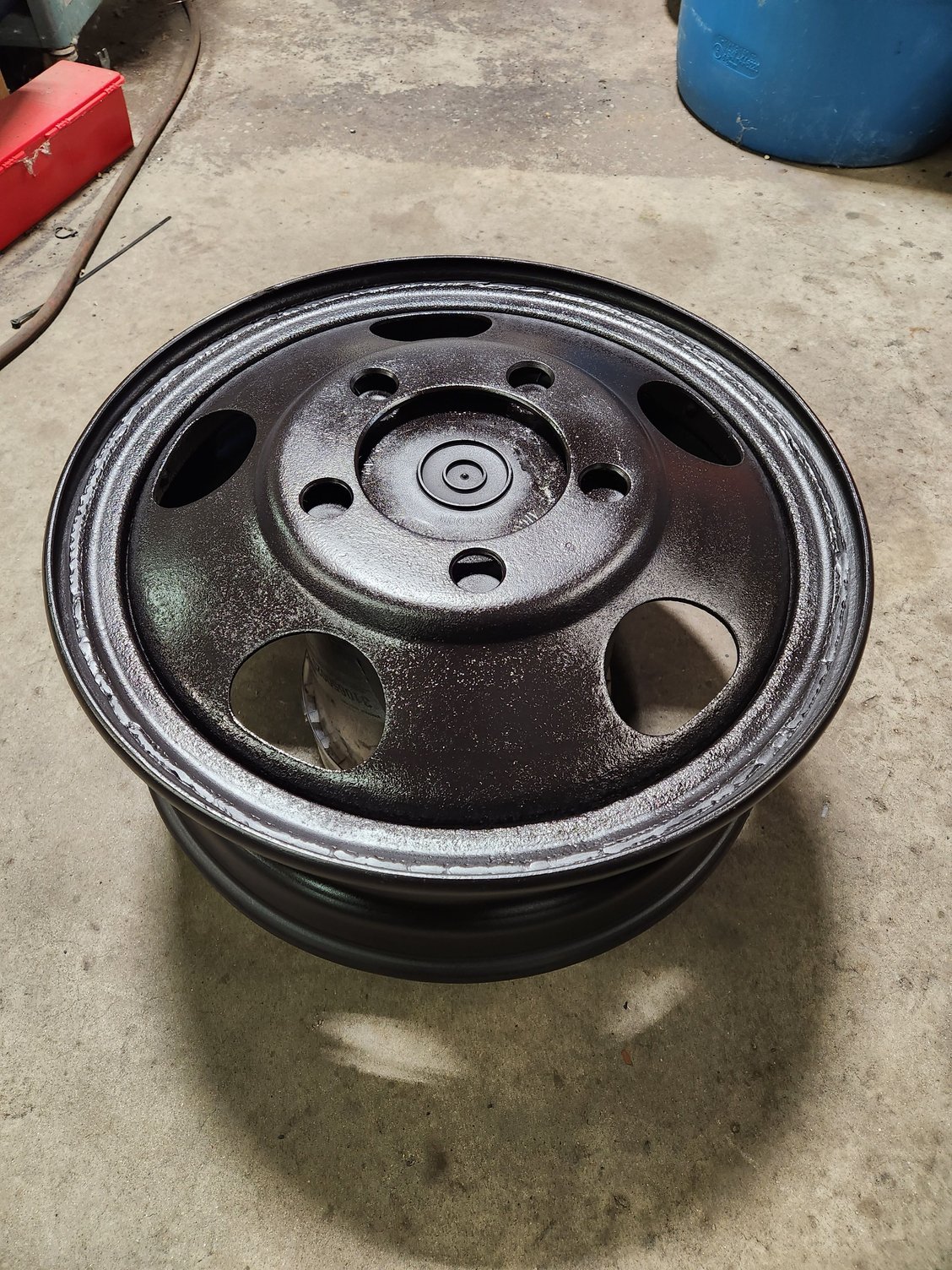

Rattle canned for now...powdercoat will happen before new rubber happens
Junk tire for now just to roll around
Fits great on the front...have a pair on the rear now too...may need to do 1/2" spacers...pretty close to the leaf spring but it does fit as is.

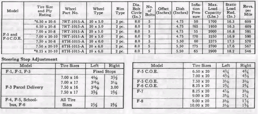

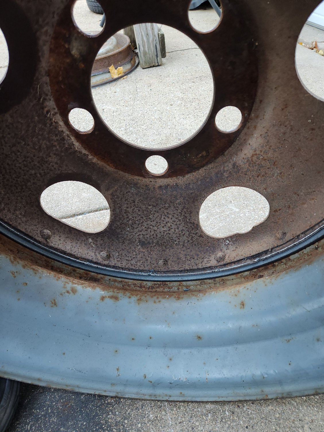

The 9R22.5 Pictured is a dead ringer for the 8.25-20.
7.50-20 tires change over to 8R22.5 on 5.25 wide rims.
Original specs for the F5 wheels:

Hammermanr2 and I are trying to relay that you need to be conscious of rim/tire width for the duals and steering. Thus, I gave original F5 specs on the wheels and their 22.5 equivalents.
