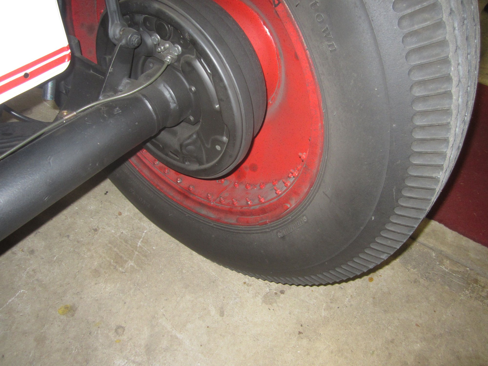

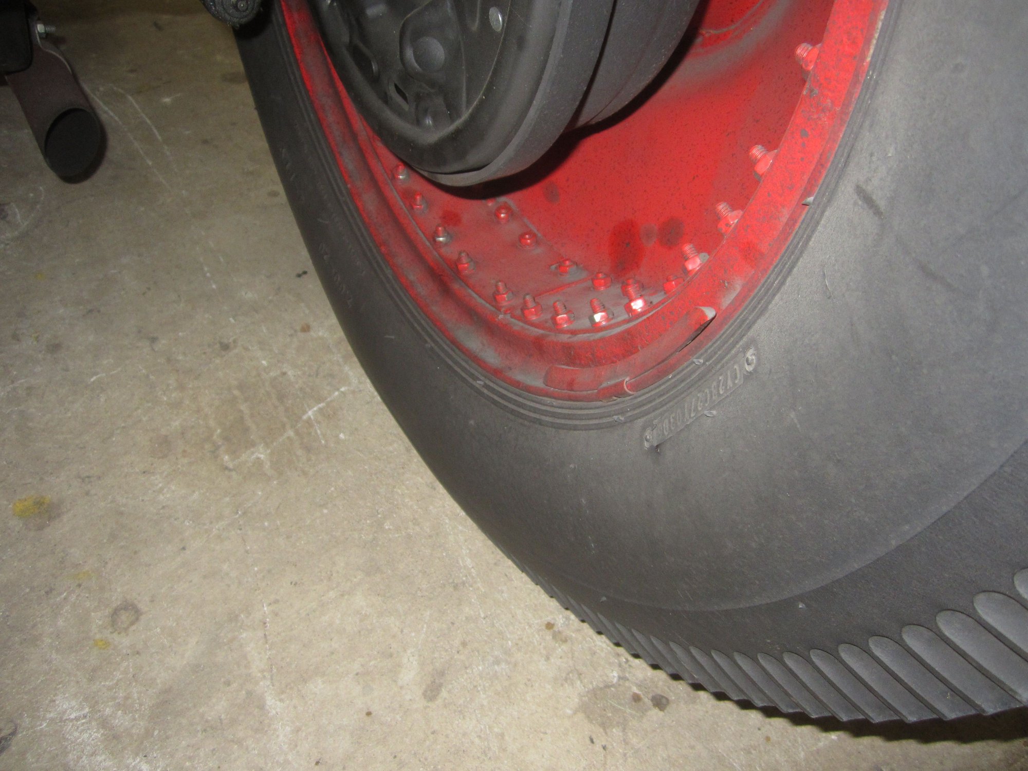

Every now and then I get to work at this guy’s house. He welded 2 halves together, but couldn’t mount a tire because of no drop center. So he cut the wheel so a tire could be mounted.

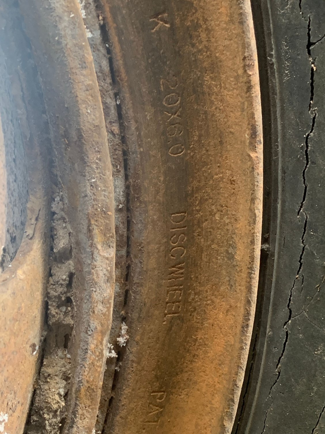

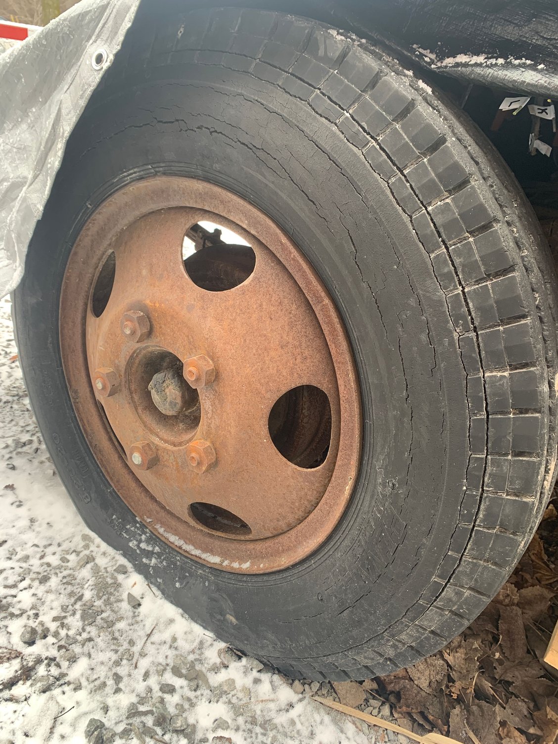

I finally got a chance to have a close look at what I have. I think I’m lucky. The rears have lock rings on the insides facing each other. Here’s a picture of some markings on inside the rim I was able to take through one of the windows as well as a picture of the DS pair. Unfortunately I think the fronts are WM’s. They are all 5 on 8”.

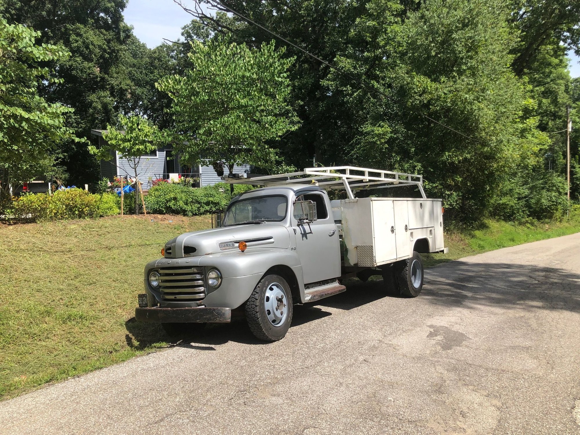

Hi ,
so what we did on our F5 is got blank 19.5" wheels and made a template and drilled them out our self . the new wheels were like 150 each and then there was a bunch of time with the drill , but they work great. We did loose one left hand thread lug nut if any one has one to spare and then for our f3 we got 19.5 srw wheels from boar trailer company and they worked great too . neither are historically accurate , but they both look good , and fit well , and we got a great deal on good year 8r19.5 so they more or less look period ......

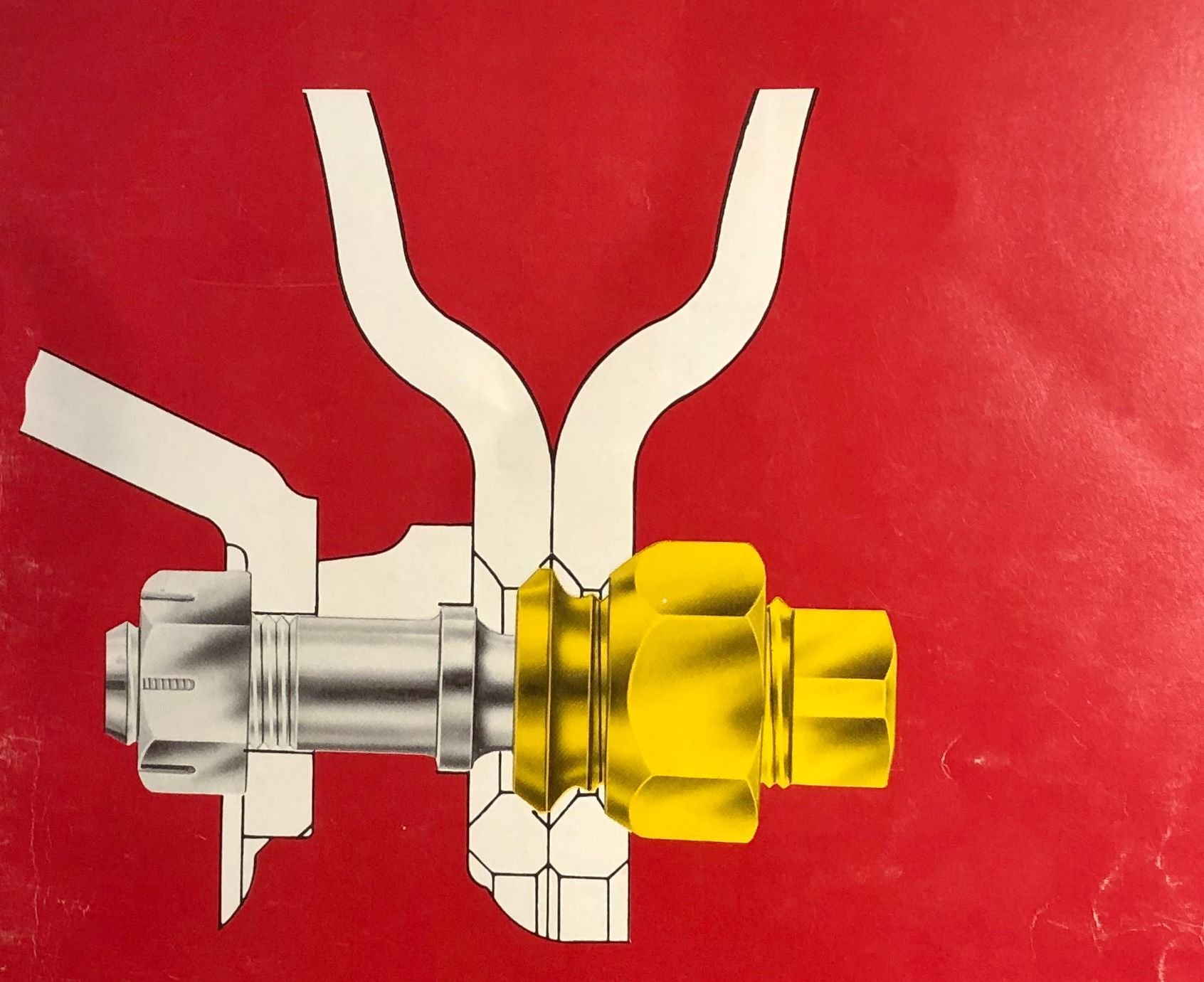

How did you ensure that the newly drilled lug holes would properly provide a secure seat for the stud piloted lug nuts? Factory wheels have what are called “ball seats” that locate and center the wheels on the studs. If you’ve just tightened the nuts to the flat surfaces of the discs you’ll have wheels moving on the studs. They will need to be retorqued frequently. Hub piloted wheels center on the hubs which allows their use of straight lug holes and washered nuts. Stu

Stu - we used a really big step bit and then several carbide rotary burrs of different shapes until we got the seat to an acceptable place . the one thing we did cheat on is that they should ideally have seats on both sides , but we only did one , so the 4 are only for the inner and the two are only for the outer . I will say several people told us that we would never be able to be accurate enough , and that it would give us all sort of rolling issues , but almost a thousand miles later , we have no issues and no weird tread wear . again the only down side is the 19.5 are a good bit smaller and that makes the already short gearing even shorter , but i will say the one day both of the 6.7s were down we were able to move 3 yards of gravel with no problem . Stu what should we do with the 6 20"s and 5 17"s?

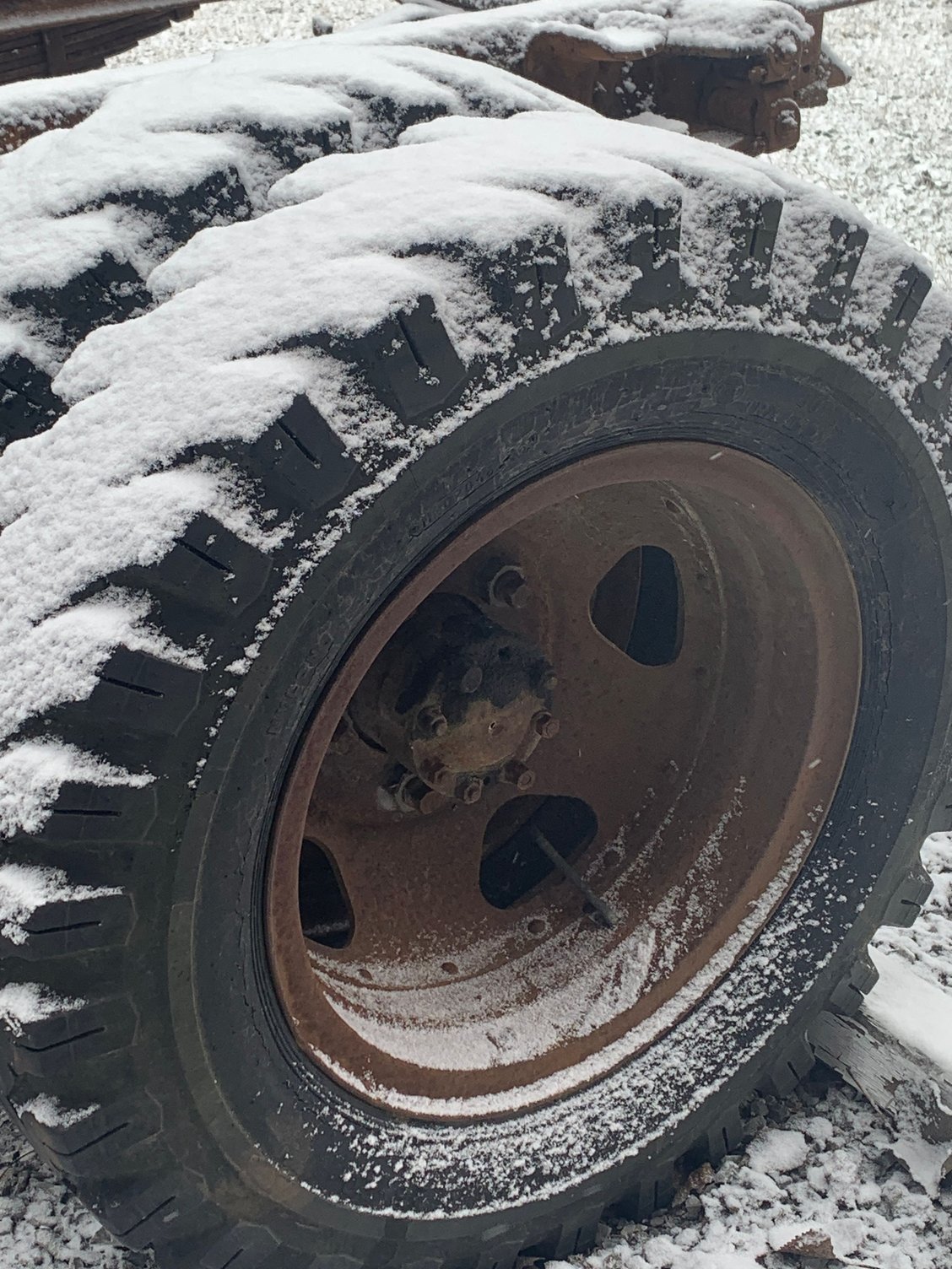

I found a guy up here in Ontario with 20x7.5” wheels with lock rings. Hole pattern is 6 on 8.75”. I’m gonna pick up two this week to replace my fronts 20x6” with 5 on 8” widow makers. They’re off of an M35A2. I’ll have some modification work to do but I think it’s within my abilities. I’ll report back here how it all goes.
