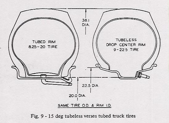

All we are saying is that the common 8.25x22.5 truck rims are too wide for the equivalent 9R22.5 or 8R22.5 tires which will use rims in the ~6" and ~5" range respectively.
The standard 8.25x22.5 rims will fit 11R22.5 wheels, but they are likely going to be too wide for the duals and steering.
​​​​​​Here is a picture that may help show equivalency from the 20" to the 22.5" tires
So, you start with the wheel offerings on your F5 (largest being 8.25-20) which translate to 9R22.5. Now you need to find a 22.5 rim to fit a 9R22.5 which optimally would be 6.75 inches (some tire manufacturers stretch this from 6 to 7.5 inches). The ubiquitous 8.25x22.5 rims will not be appropriate.
Correct, but keep in mind 8R22.5's are no longer available in today's normal tire market...and the 9R22.5 will work on a 7.50 wide rim but no larger.

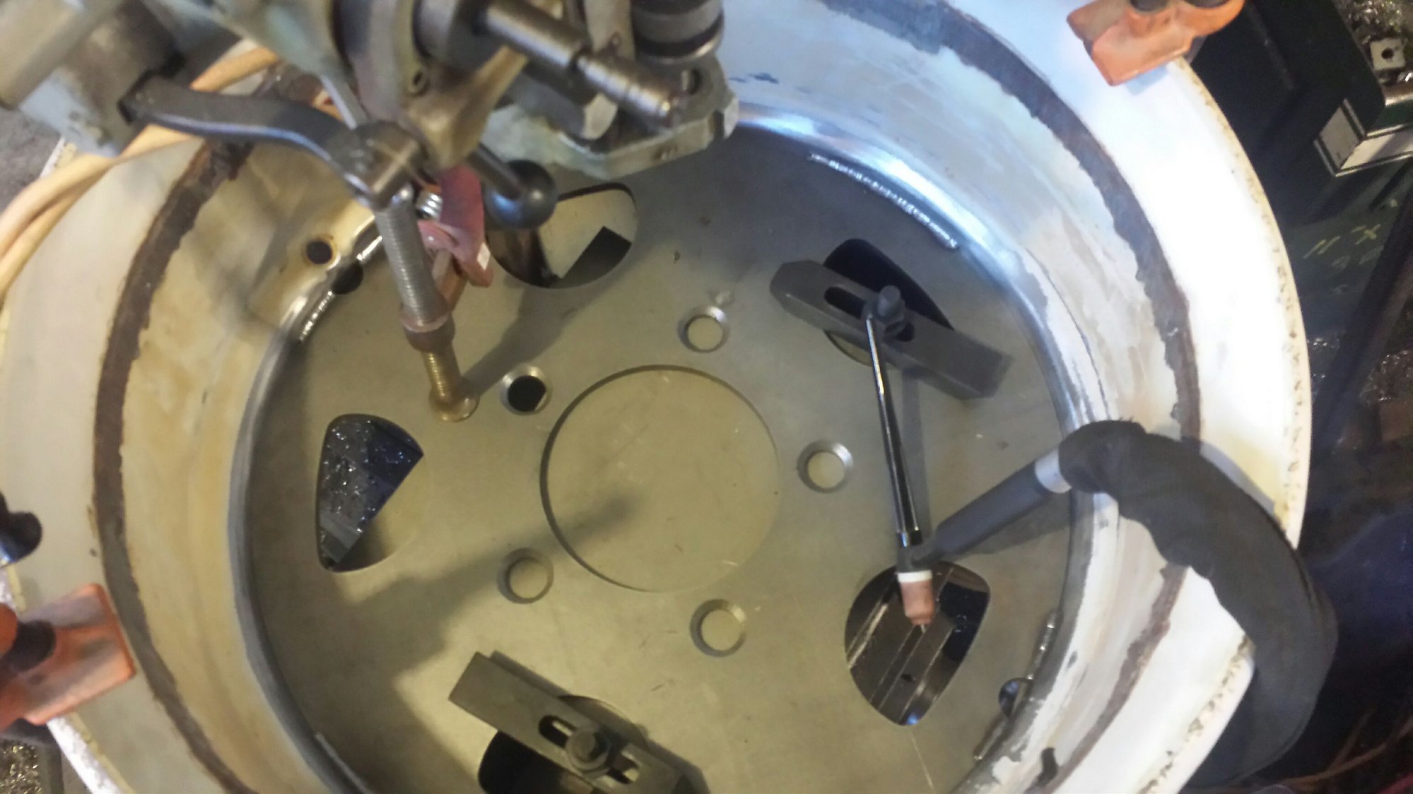

The rubbing will be against the frame. I was not about to make 6 wheels so I made 12.25 x 22.5 rear wheels and 8.25 x 22.5 fronts. The fronts are offset to move the tire out like you'd find on something running 315 on 9 x 22.5 front tires. I needed as much tire diameter as I could reasonably put on to get the engine RPM to where my Cummins was happy. Running 385/65-22.5 rears and 275/80-22.5 fronts. That is over an inch diameter difference but I knew I was not going to fit 11R up front. The fronts just rub the spring perch rivets at full lock so they have a nice polish on them.
12.25 x 22.5 welding
