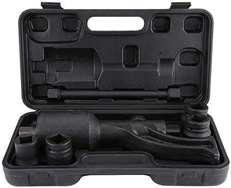

A few points - first - you didn't overlook the reverse left handed threads on the left side of the vehicle? Secondly, the torque spec on the lugs is in excess of 400 ft/lbs. A consumer/prosumer electric impact won't touch it. You need something pneumatic with like a 1" drive. I personally have not regretted getting a pneumatic impact gun, a combination Budd socket, and a porkchop. Also very helpful is a torque multiplier when I don't have access to air. T there are many branded imports similar to this that seem to work well enough for the home gamer:
Oh, and a porkchop helps separate the inner lug from the outer lug in the event they don't separate in a friendly fashion:

I'll look at a Torque Multiplier tool as shown in your post, we are working on this way out in the field where it was parked with no big air, etc.
