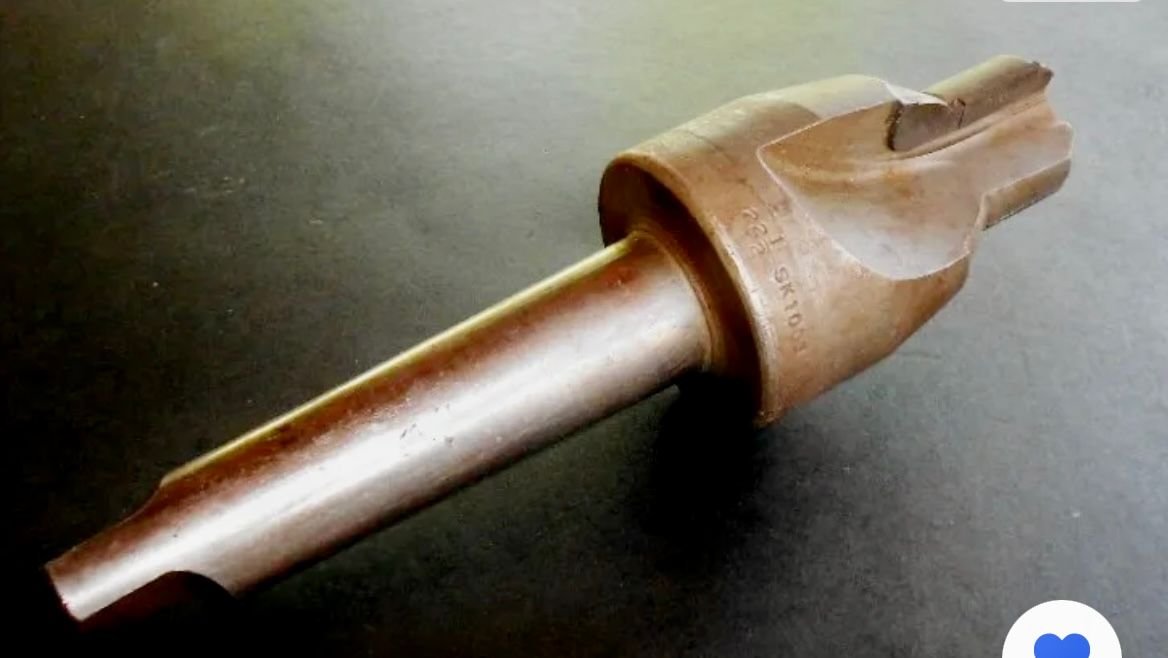

This Budd ball seat machine bit would be needed. Stu
https://www.ebay.com/itm/334953973042
