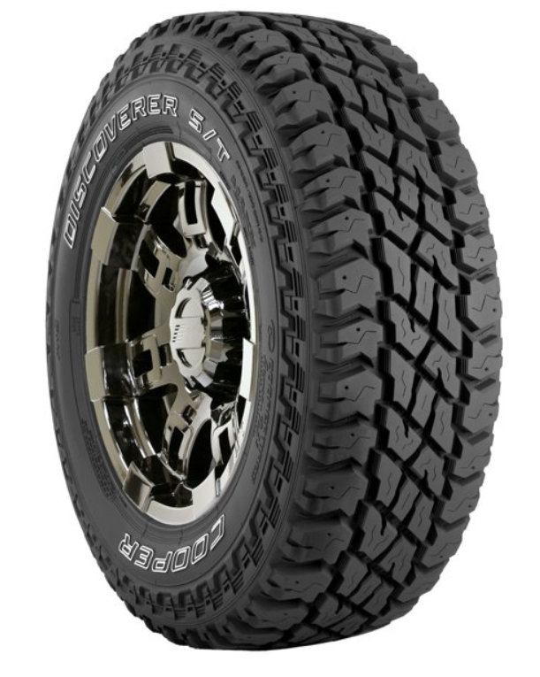

Just to add a bit of my own experience to what Chris and Cody have said above. I run 65 PSI in the front and 75 in the rear for my truck that tows heavy 90% of the time it is moving. I do this because after testing and evaluating various PSI settings on both the front and back, I found this to be the best marriage between comfort, capability and confidence in towing.
My Cooper S/T MAXX may not be a true MT like the Toyo tires you are running, but they have ~60,000 miles on them and I am on track to get 75,000 or a bit more. Proper inflation, rotation and monitoring is essential to the life of the tires and that is critical because these tires cost too much to just burn through them.
Picture of the S/T MAXX is below for tread reference sake.

I have had the same success with the Cooper S/T Maxx as well but with all four tires at 80psi. When you get the proper alignment YOU WILL know! The 99-04 trucks wear the front tires remarkably well. I am no Saint, sometimes I will go 12,000 miles between rotating the tires. When I do, the front tires are almost completely flat, MAYBE a little feathering on the edge lugs after 12k. Alignments and front tires are funny, some people have problems with them, others never have problems. I am the "others" never had a truck aligned on racks and have never had a problem either. My OBS has a Dana 50 TTB front axle (notorious tire wearer) that has had everything replaced and aligned by myself, it can go 10k EASY without rotating tires.
