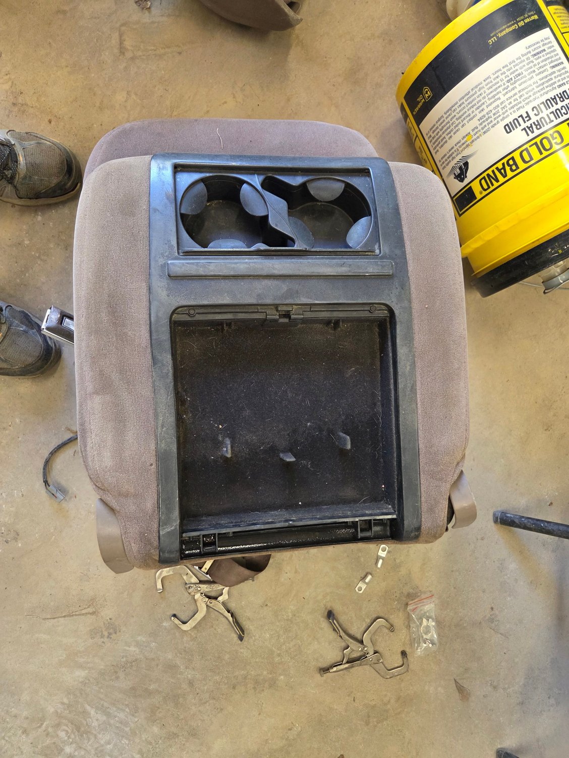

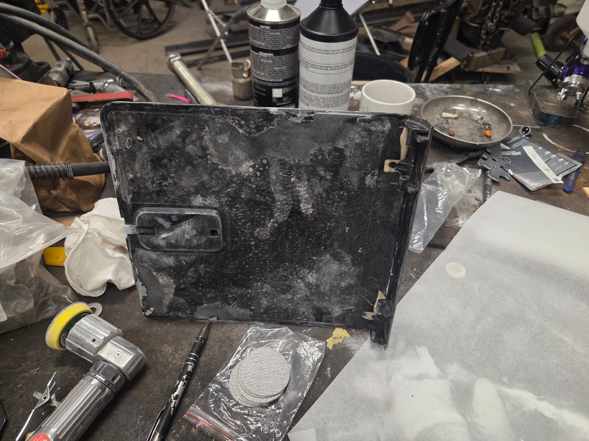

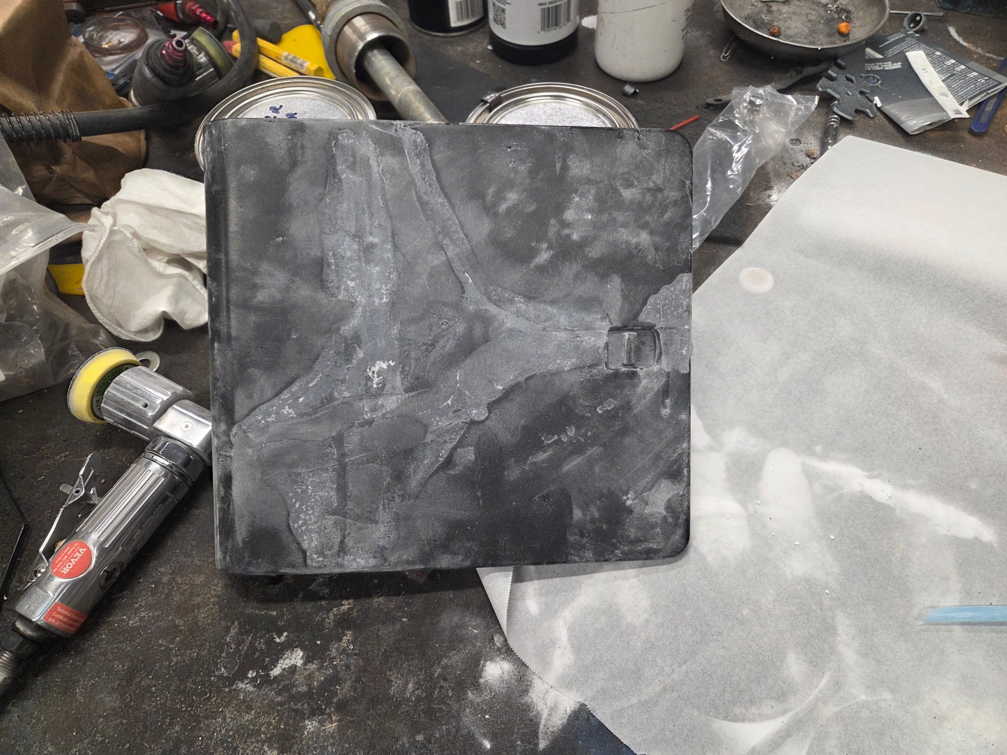

In the process of getting the seats and getting them ready to go in we have discovered that the lids(door) for the center console is very hard to come by. As near as I can tell theses are NLA and if you find one in a junk yard it is broken. So here is our first attempt at a solution. I had one with all the pieces in another truck. The inner piece was not broken so we used some jb plastic weld and glued the pieces together. And then we used super glue and baking soda on the outside of the cover so that we had a surface that could be sanded smooth for covering.

This is the center console we are using
Top of cover after mostly sanded
Bottom of lid after gluing together
