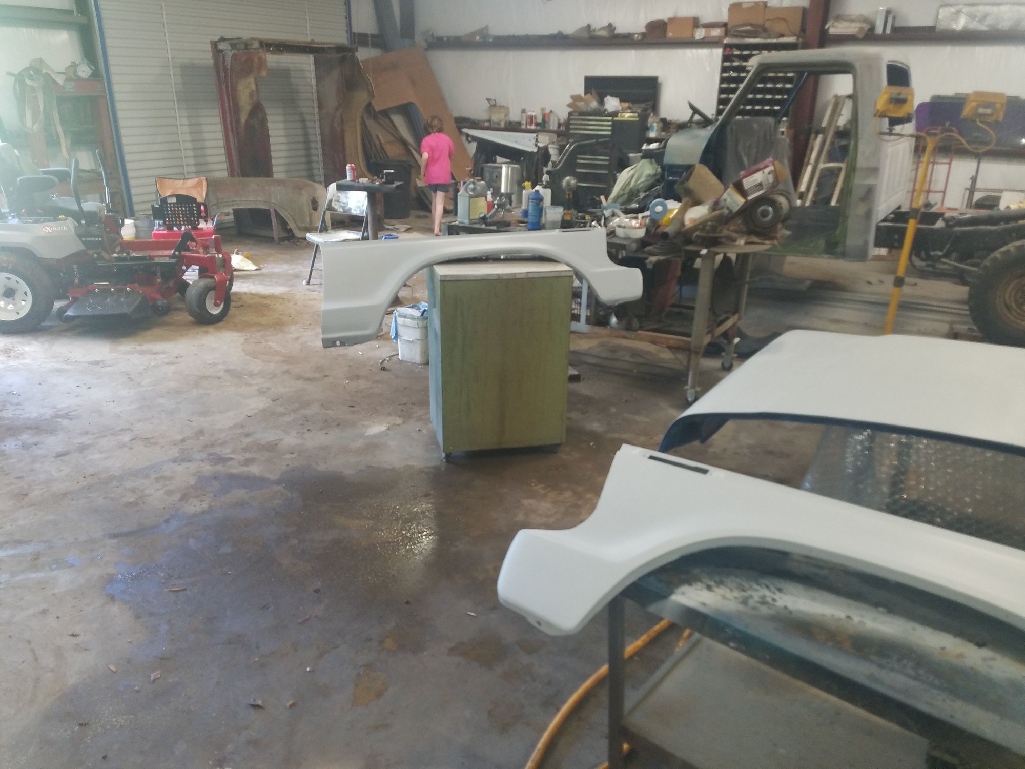

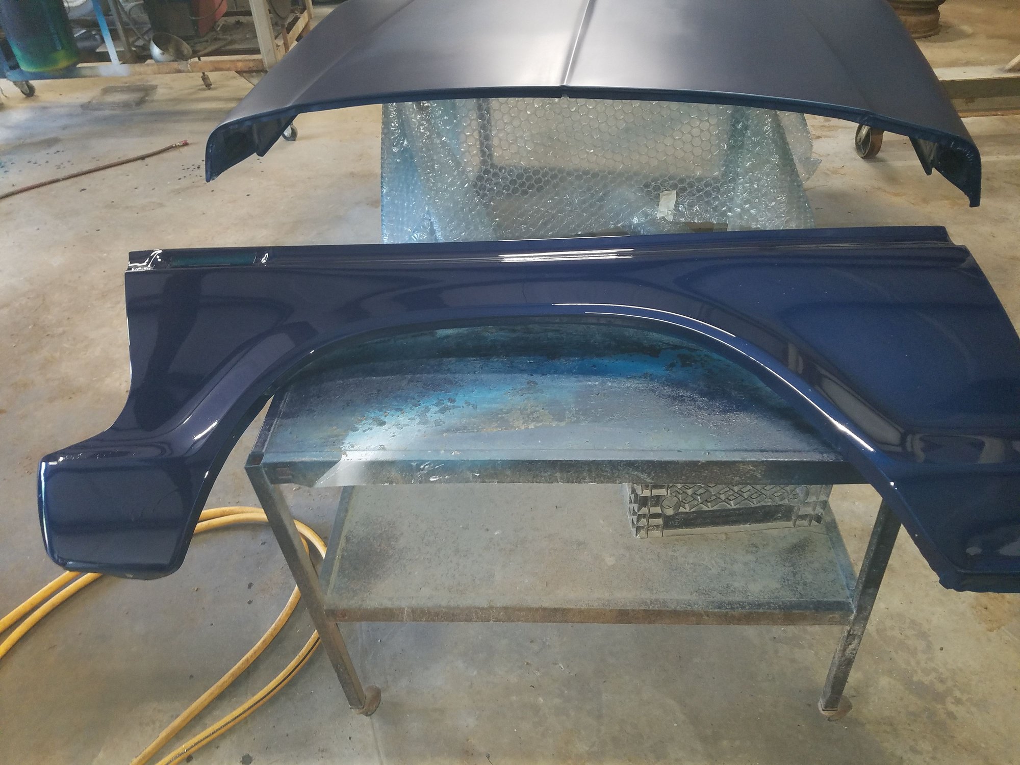

Well things didn't go as i hoped for, did get fenders painted and cleared.
i ran out of the primer i had, so used a different kind on the hood. I used what left over from my sons truck.
it fish eyed like crazy ( we had same problem on his truck). So i will have to sand down and try again. Paint gun also went stupid and sprayed to one side on hood creating a couple of runs. Then a fly landed in wet paint and messed it up.
so sand again it is
Right fender
Left fender You can see in background hood, but has to be redone

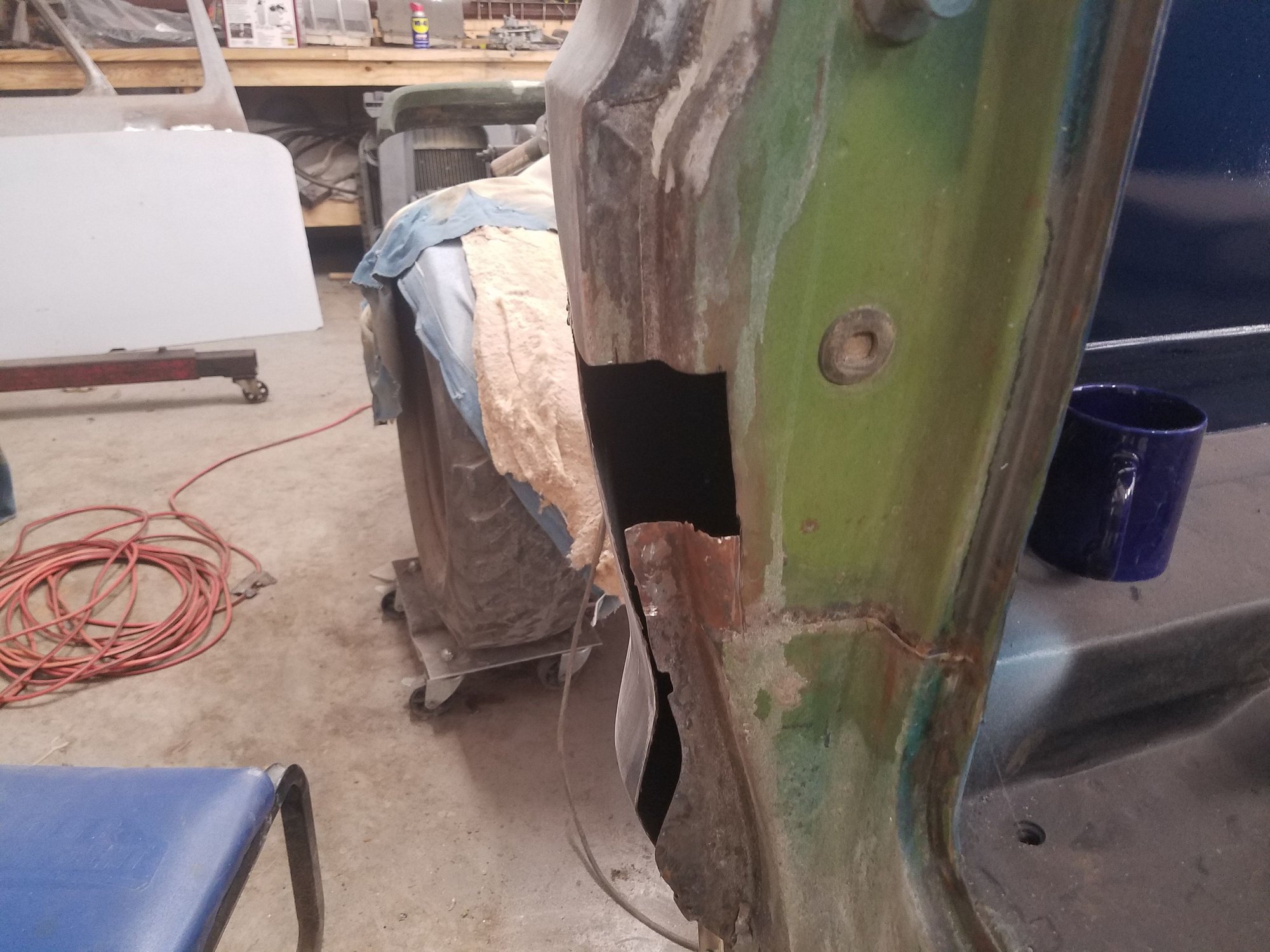

More pics

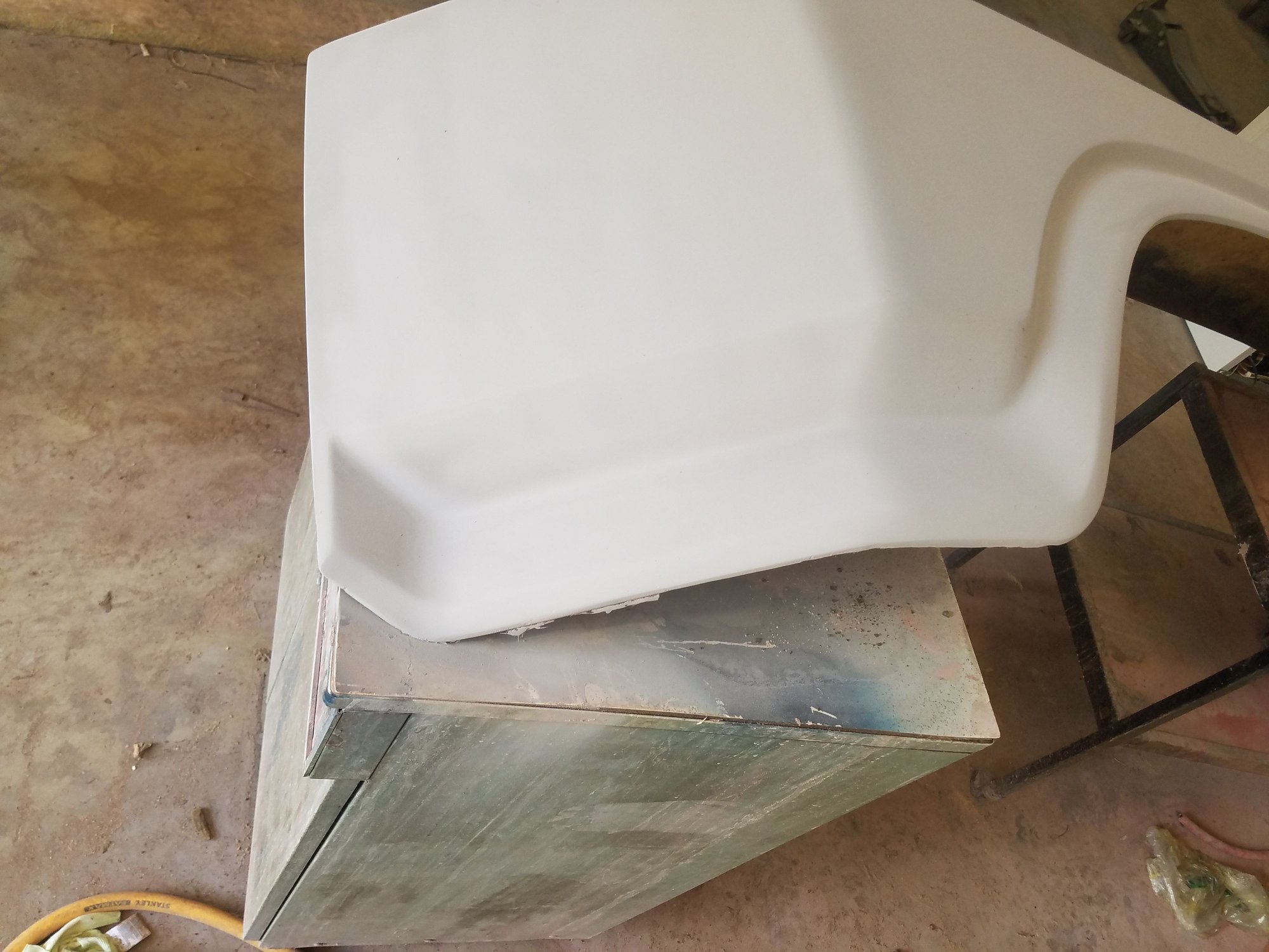

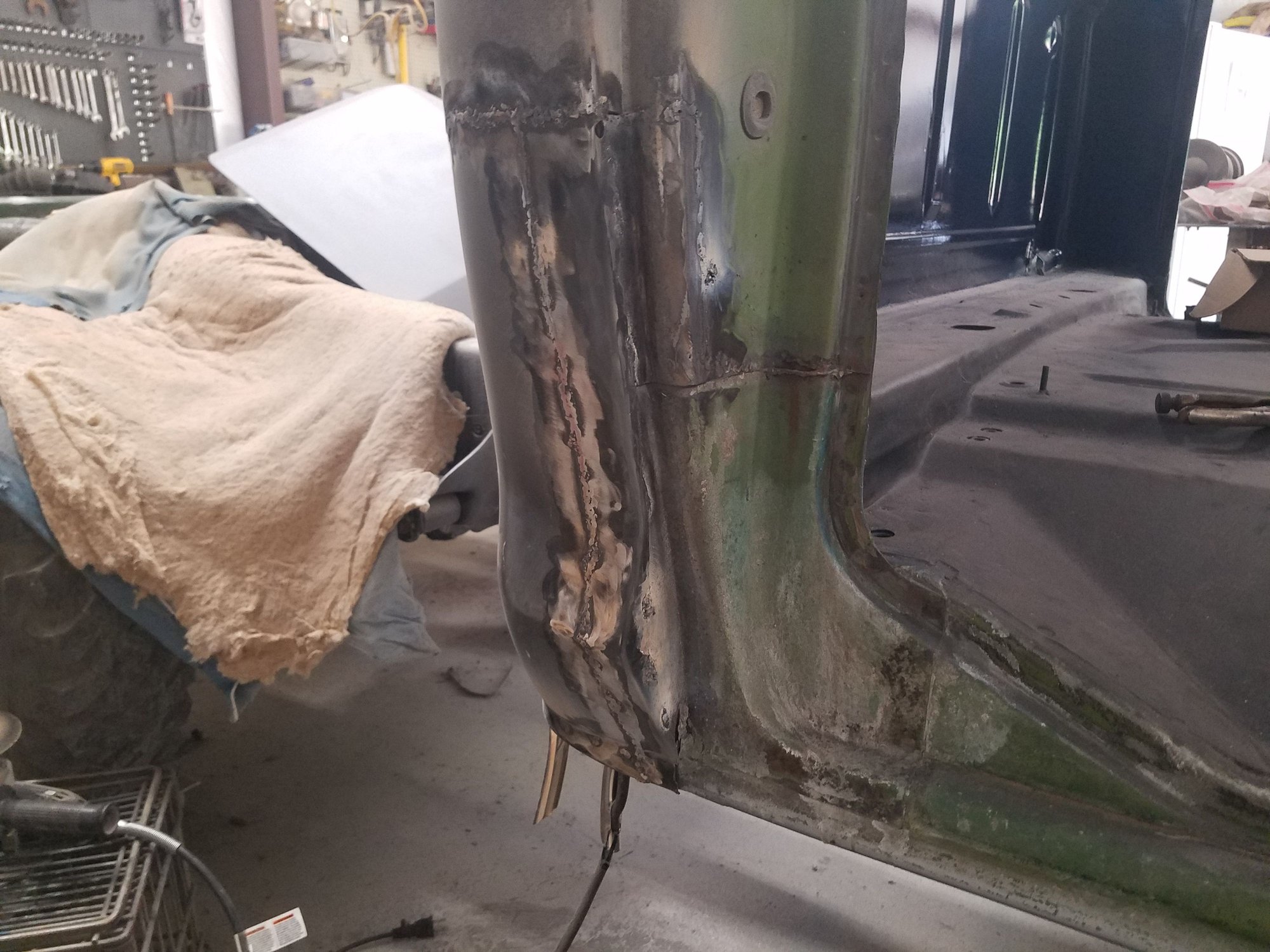

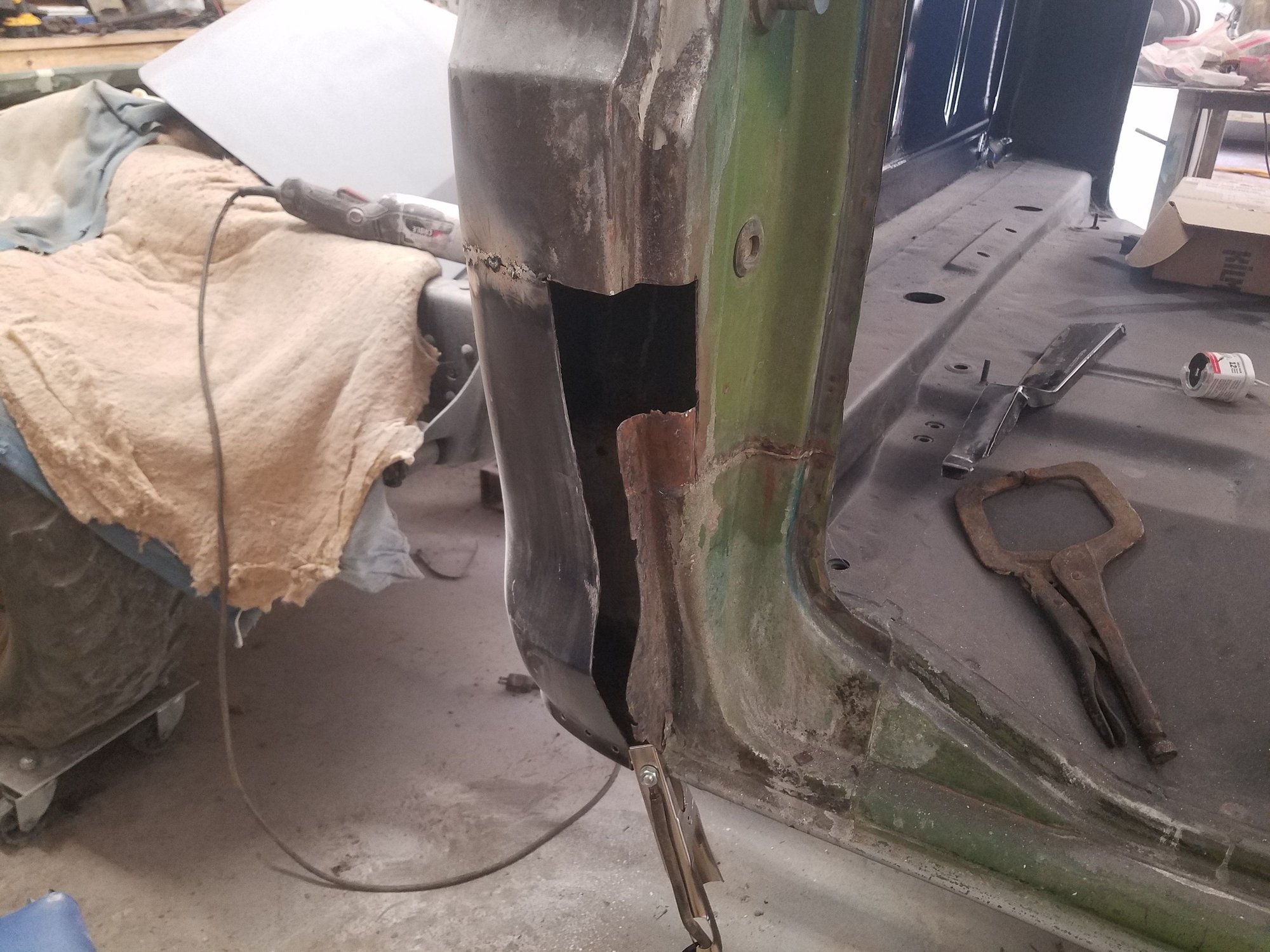

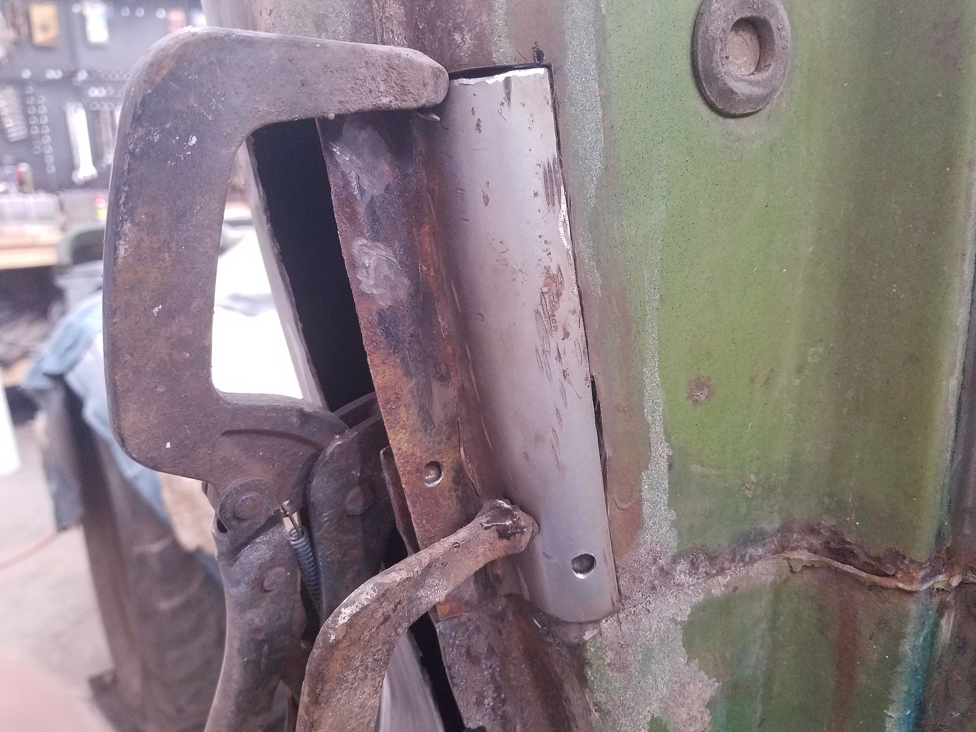

Finally got back to passenger side rear cab corner Had to replace small section of door frame as there was nothing to weld to
Another view of corner
Patch piece cut from another truck
Patches welded in
Another view of it

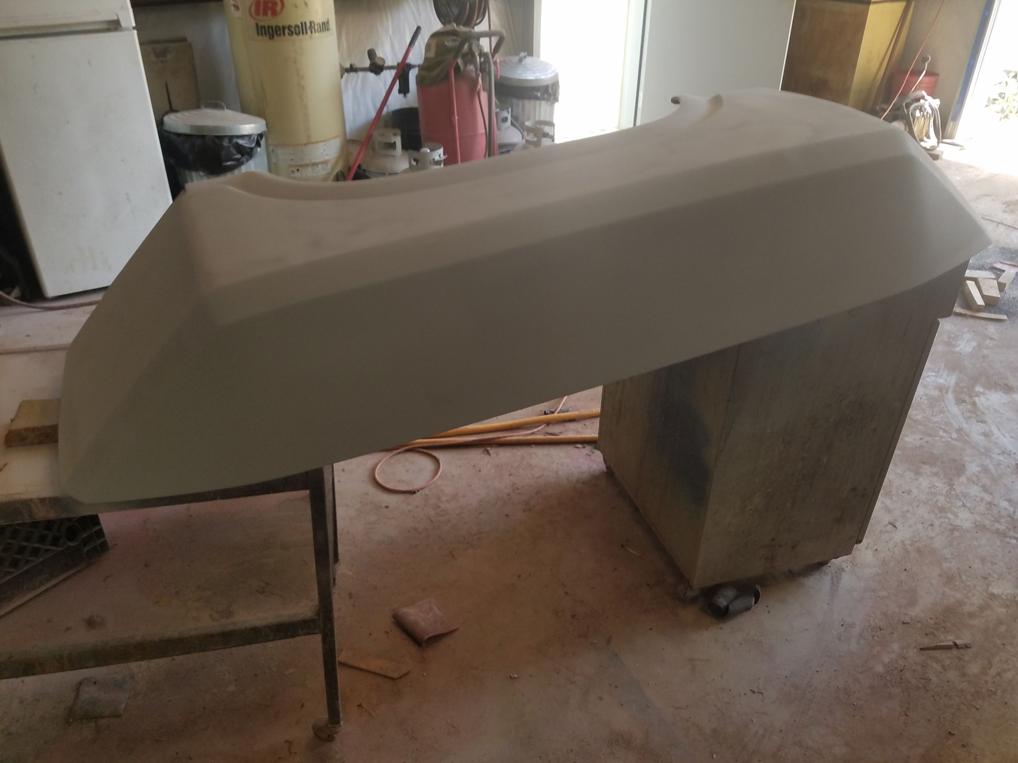

More progress made
Small repair on passenger side rear fender
Fenders in primer
Body work on welds

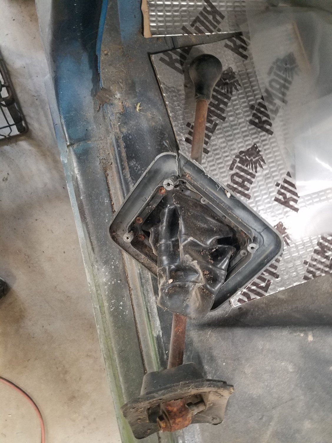

Bring progress up to date
Gear shifter i lost for about 3 months
Gear shifter rehabed

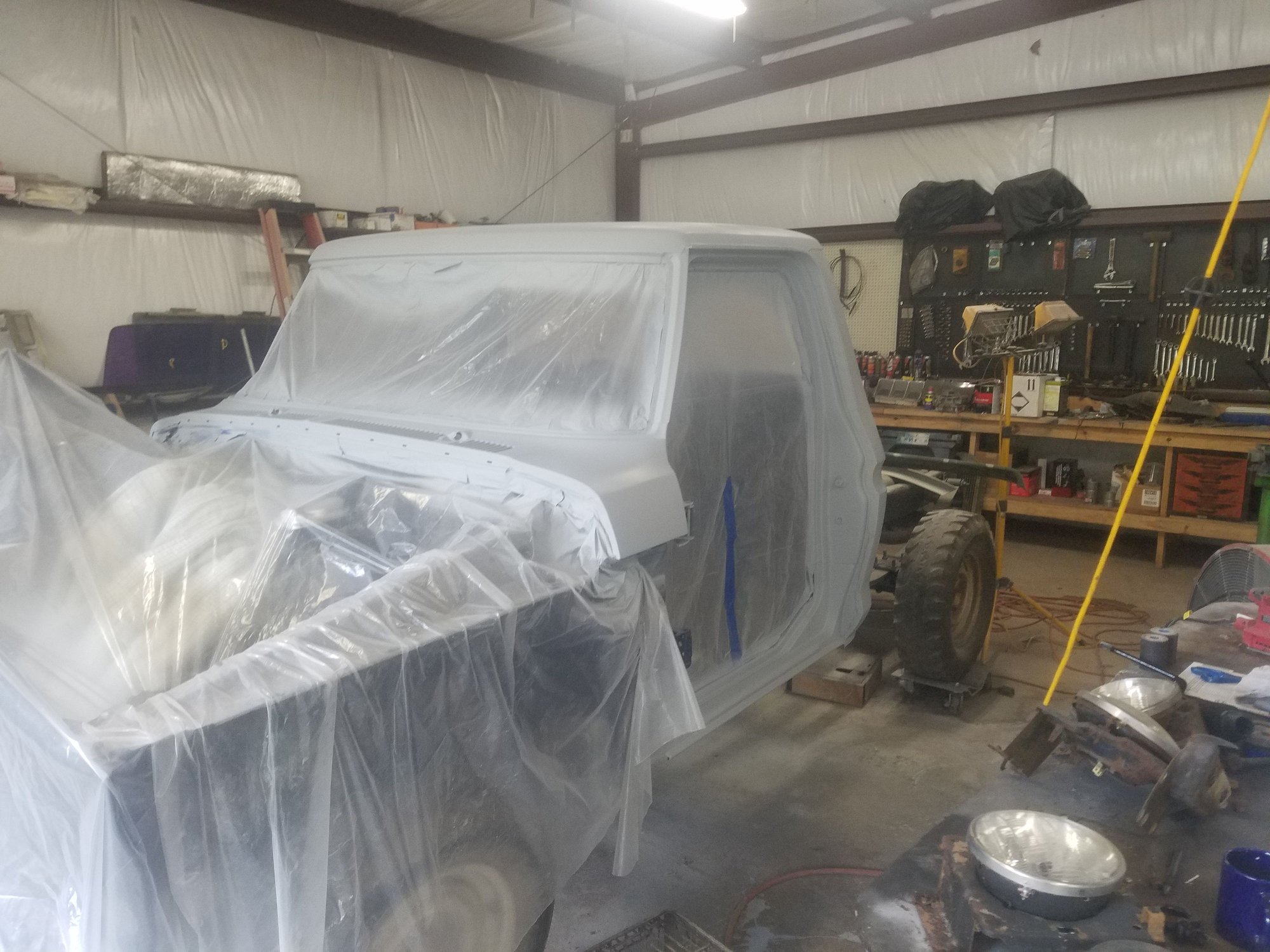

Back of cab in primer
Full cab minus doors is primered
