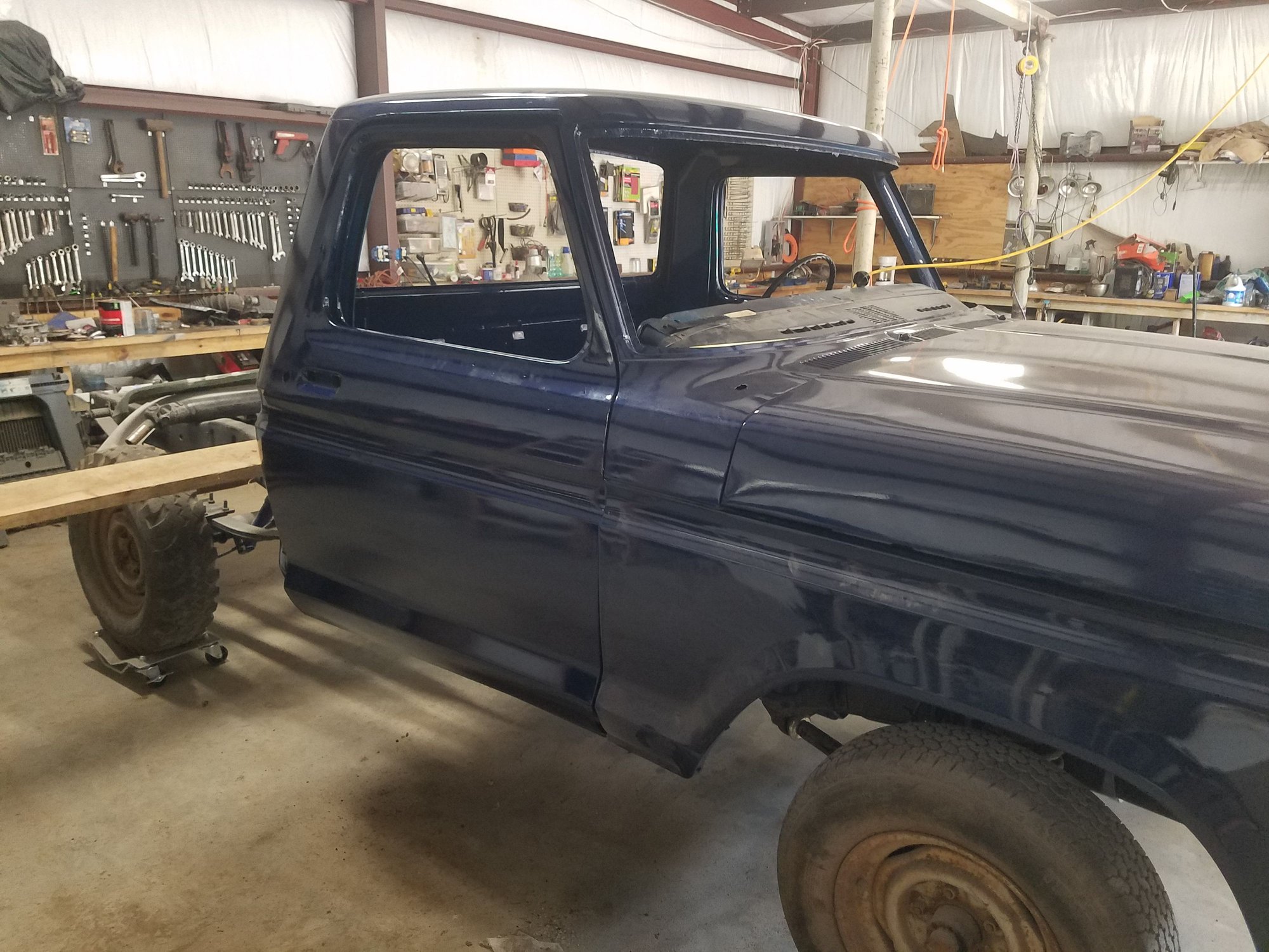

Doors are on and adjusted still gotta work with fenders and hood
Drivers side
Passengers side

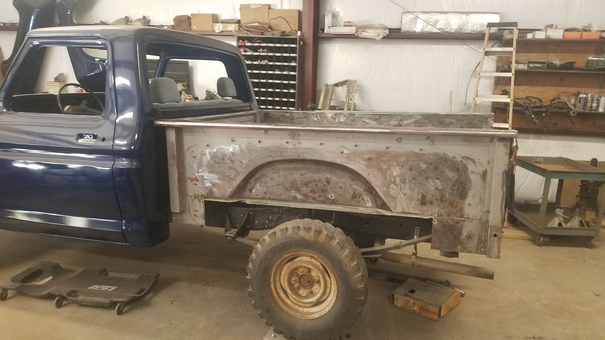

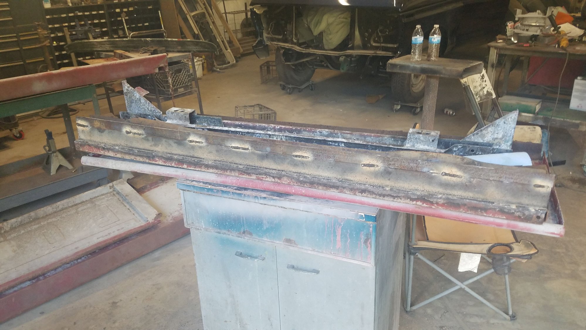

Playing catch up again,
l have been working on the truck as i can.
Original cross member from front of bed
Front cross member repaired
Rear cross member being repaired, i didn't take a picture of this before starting to work on it.

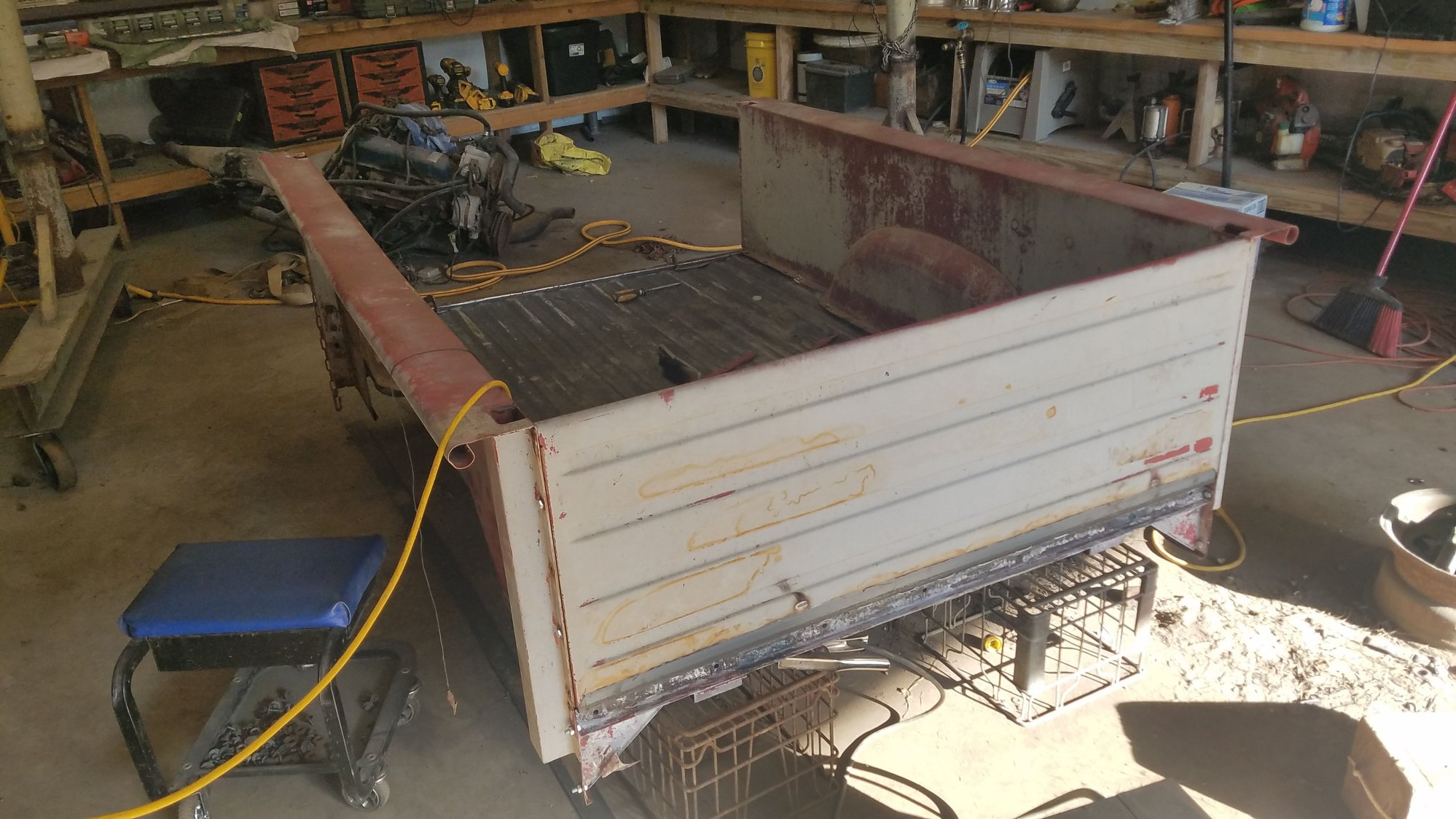

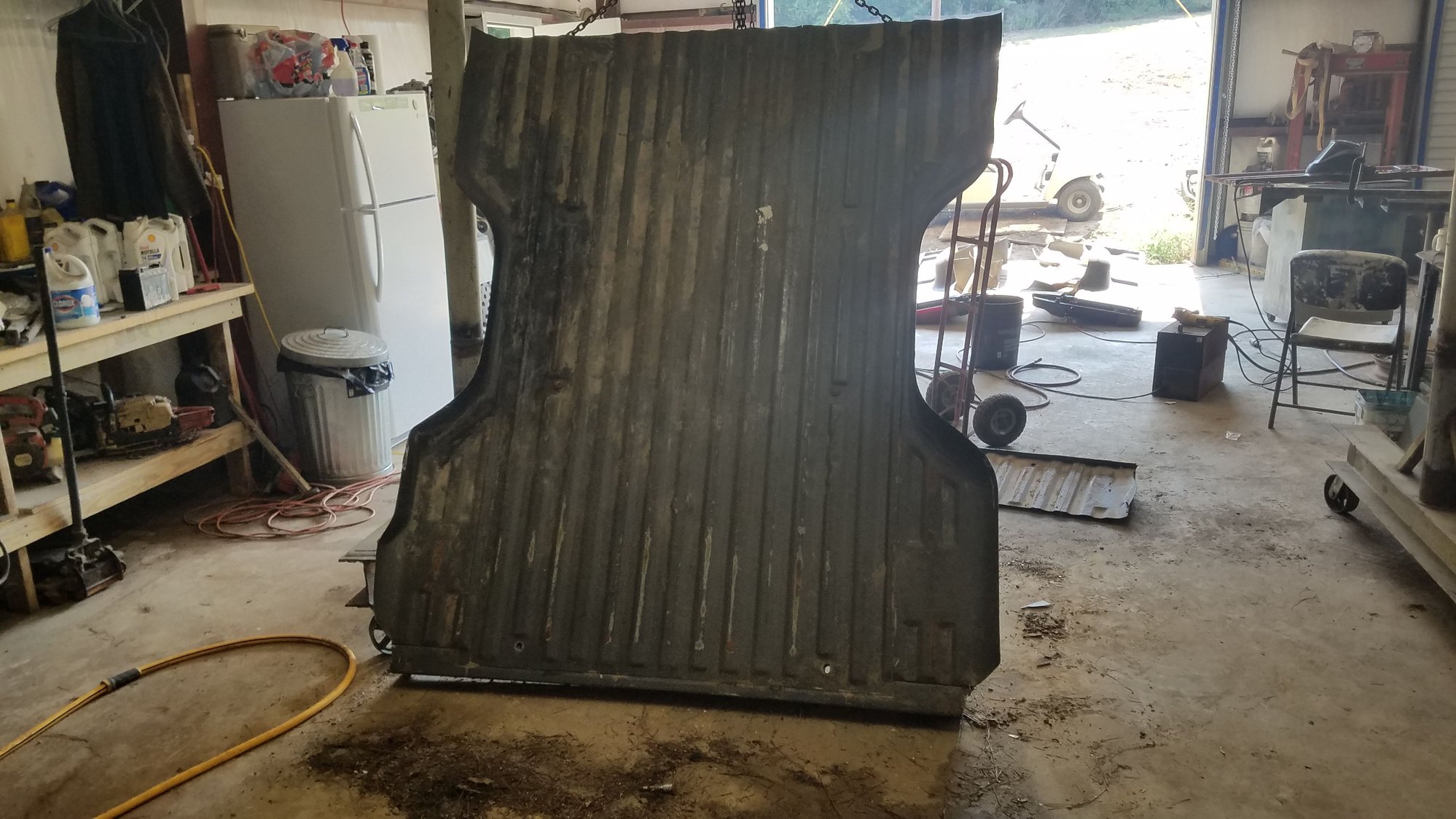

I am still working on the bed
This is the bed floor that i will be using
Cross members have been mounted to the bed, and we are test fittig sides to make sue everything lines up right

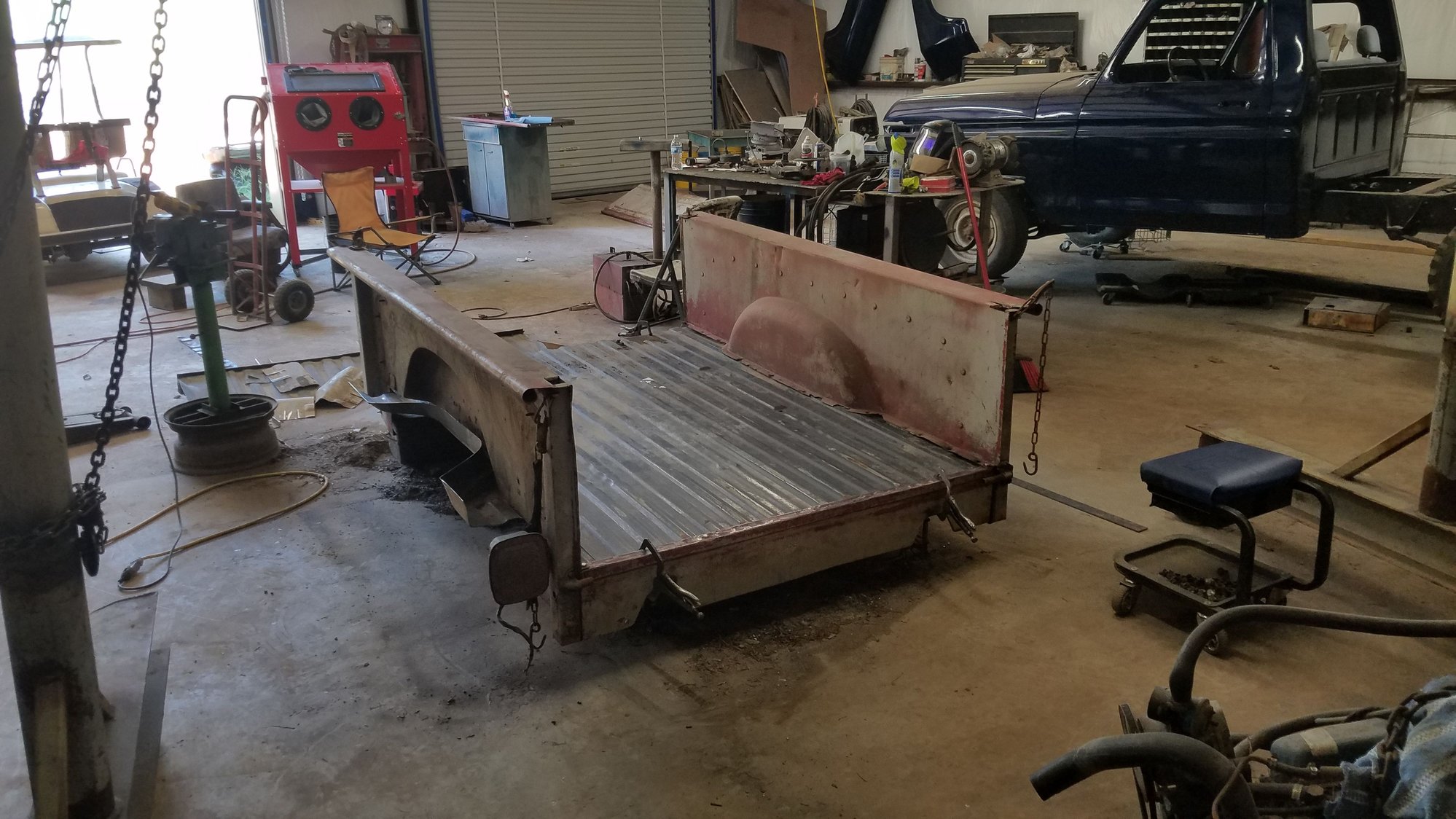

More work on the bed
Coming along pretty well i think
Bed disassembled again for cleaning and repair work

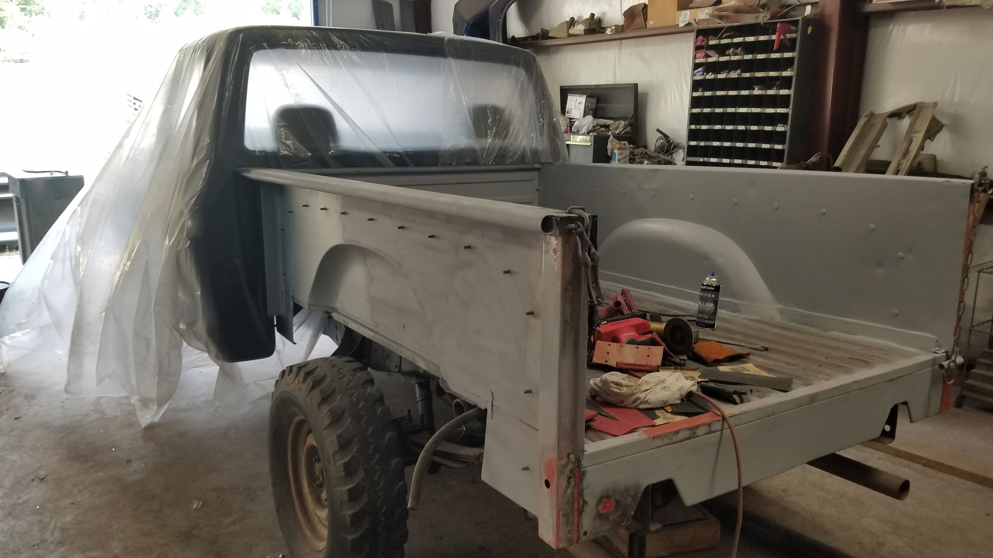

More progress on the bed
Test fitting floor to the frame
Everything lined up the way it should
Bed box reassembled on the frame

Now for some full disclosure
i messed up. In the process of putting a steel floor in a flair side bed i did not take the thickness of the original wood floor into consideration. This caused me a problem of a gap between the floor and bed sides.
hummm how to fix, the resolution i came up with was 2x1/8th inch flat iron to fill the gap.
i will post some pics

What do yall think about this work around
You can see the gap between the floor and bed sides
Here is some of the flat iron tack welded in
Here is a picture of filling the gaps around fender well

Finished stitch welding flat iron in. These are after cleaning welds and seam sealing. Looks way better. They need sanding and cleaned up.
i don't think they will real noticeable.
