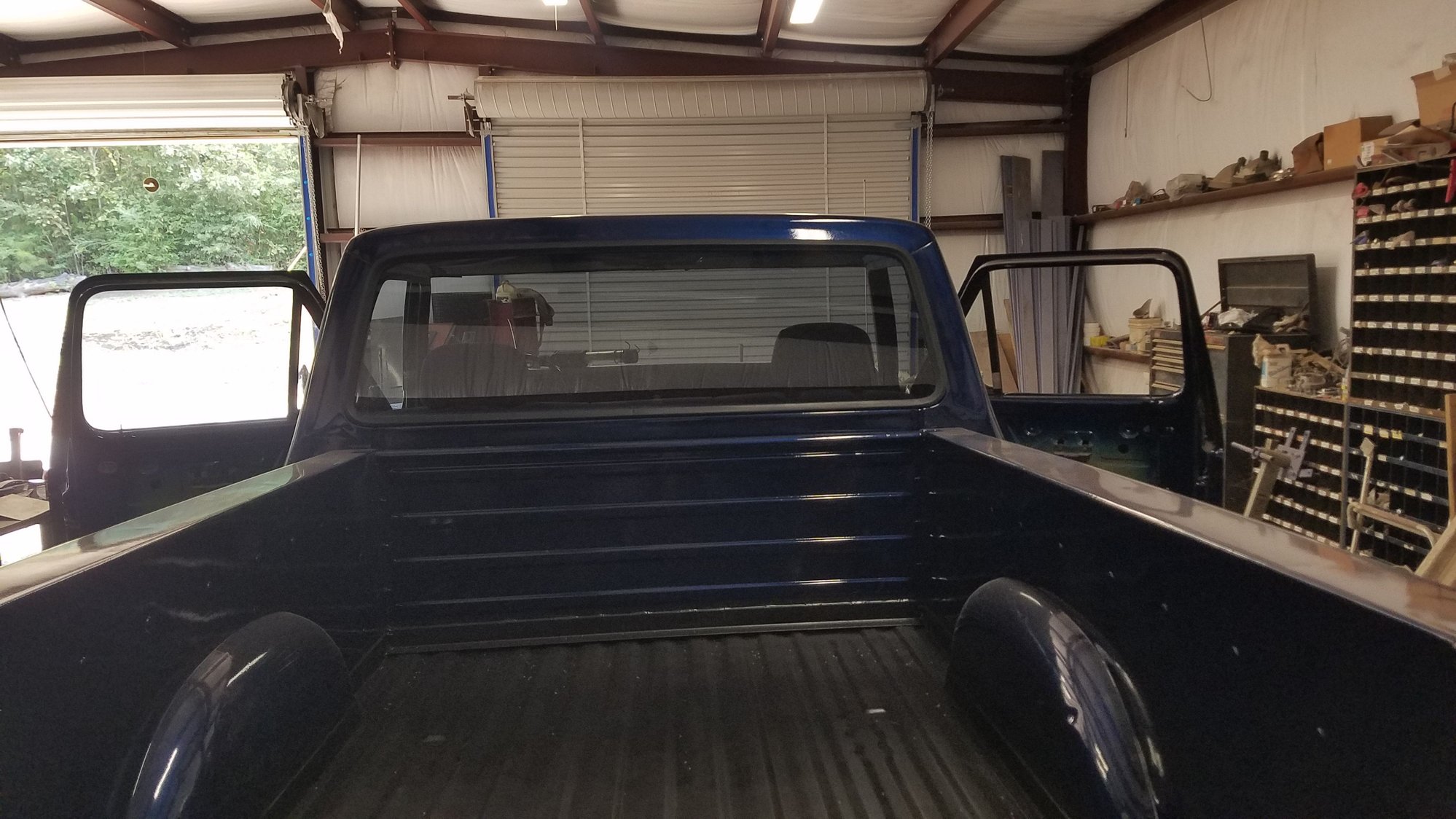

Here awhile back i asked about using luan for headliner. Well that is what we did, and it was a son of a gun to install. I don't think a person could put it in without help and some cussing. I personally would not do that again.
This is the only shot i have of it right now

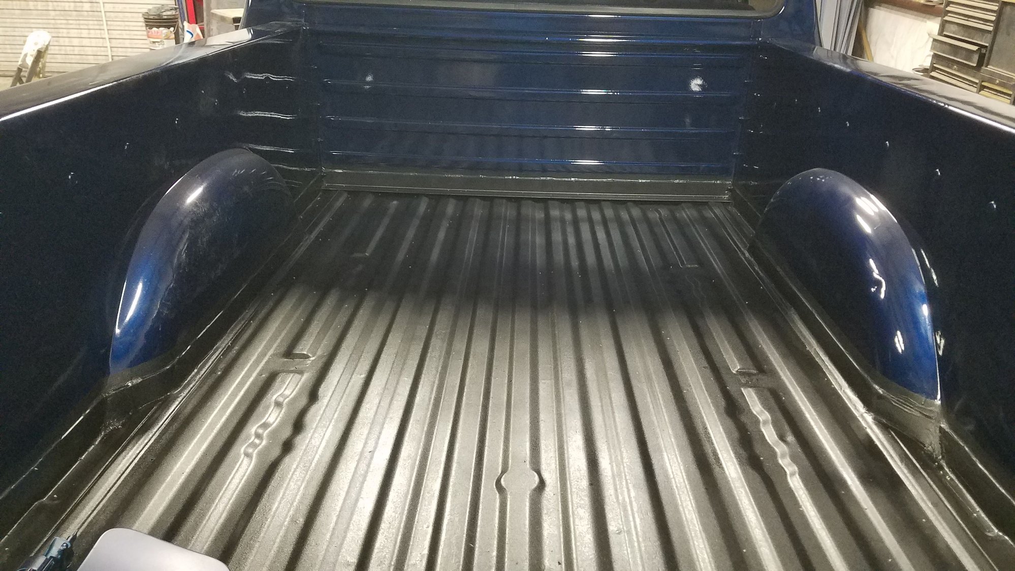

Here is a look at the inside of the bed completed, if this is a repeat please forgive me.

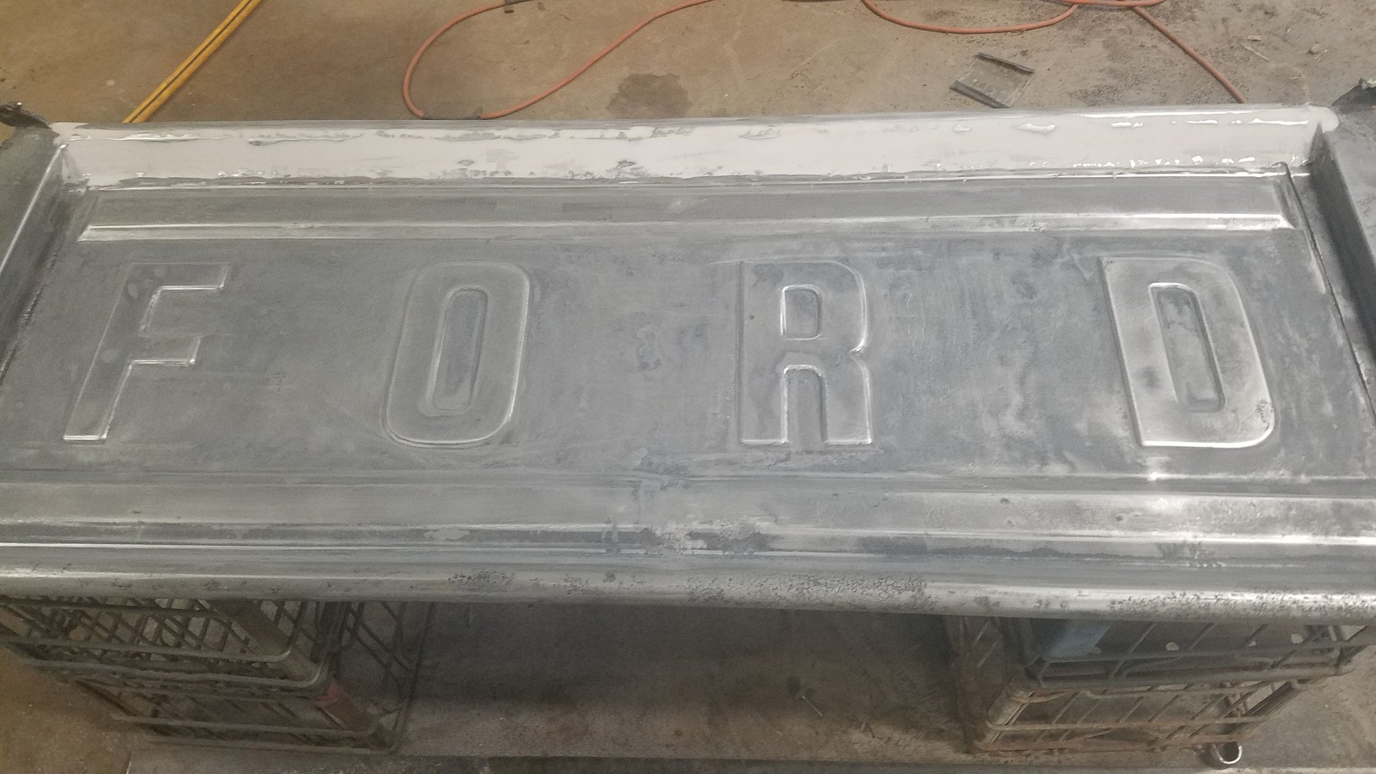

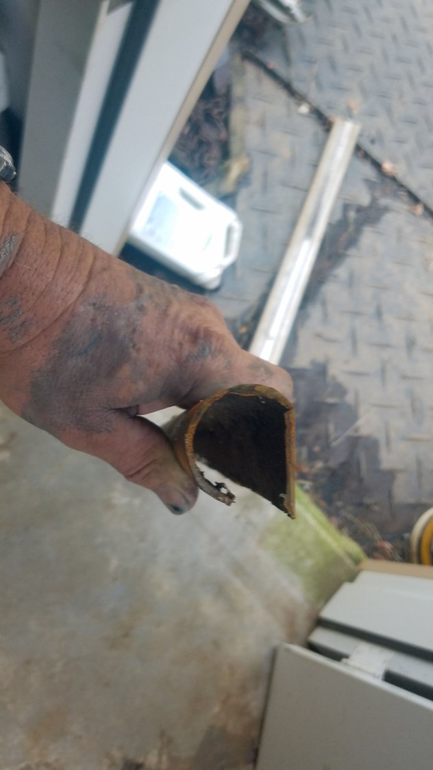

Now it is time to work the tailgate. I have been avoiding this due to the amount of rust damage. The whole upper part of the gate is in pretty bad shape.
I cut pretty much all of it off, then treated what was left. And a few pin holes welded closed.

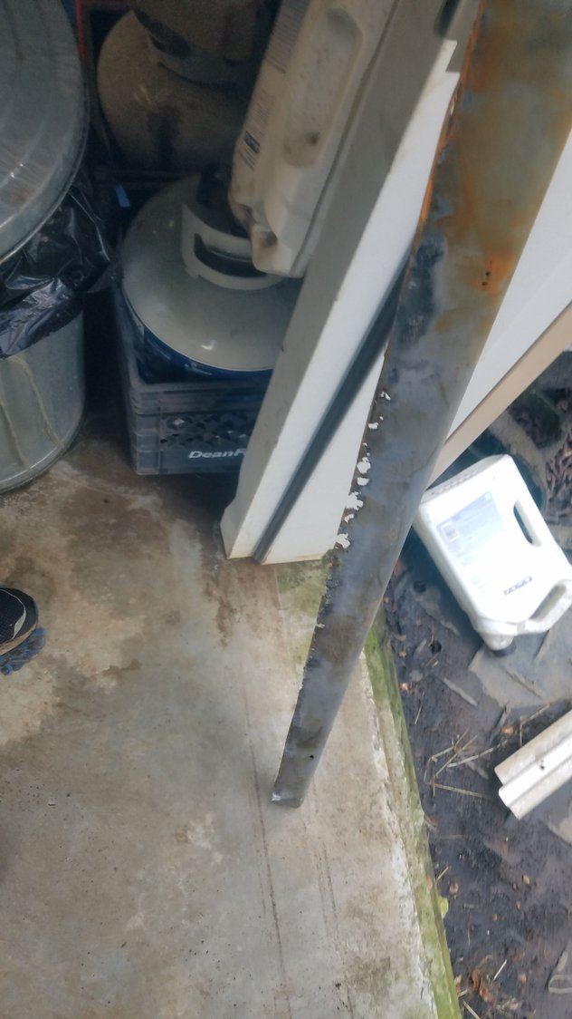

This is the piece i cut off. Now what use as a replacement? I needed a piece of pipe with 1 3/8 od. Took a bit but finally found it. The upper pipe for a chain link fence. For 20.00 bucks got what i needed and some cheater pipe to boot.

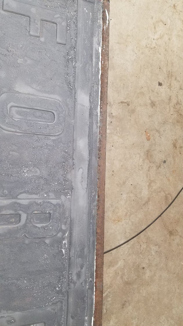

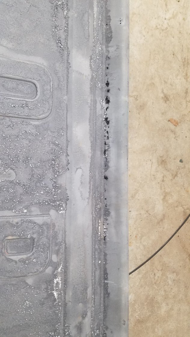

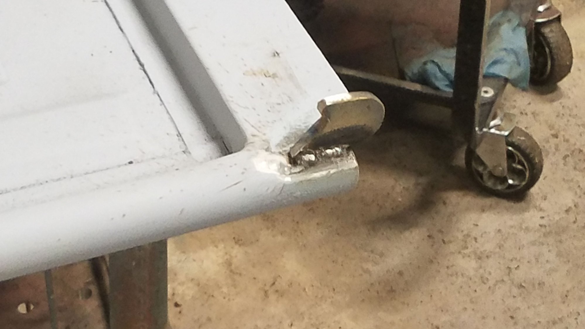

Im terrible about remembering to take pictures while doing something so there are gaps in the progress. I did not take pictures of just the pipe installed. Here is where i was welding in a 1 3/8 strip to close in the bottom side of it.
And with a little filler applied
A the back side partially primered.

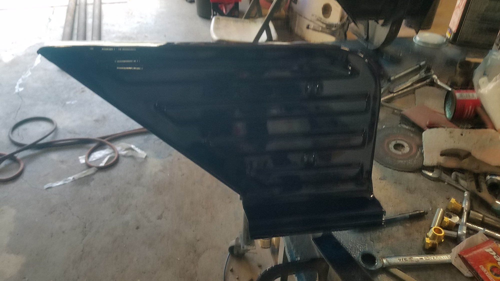

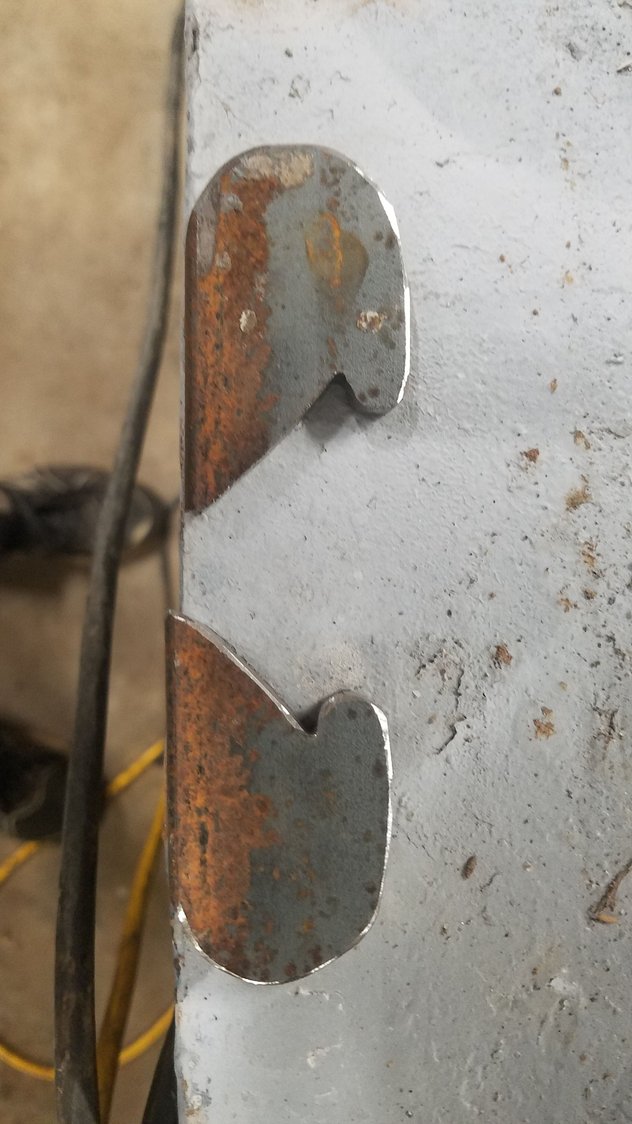

I was trying to straighten one of the latch pieces and the little ear piece broke off. So i cut out some replacements. That is alot of little cuts with a metabo blade.
Here they are mounted on tailgate, then wet sanded and primered. Let cure ready for paint.

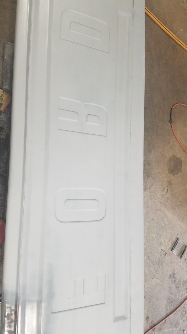

Wrong paint gremlins got me again, but only on the front side of tailgate
Sand it down again.

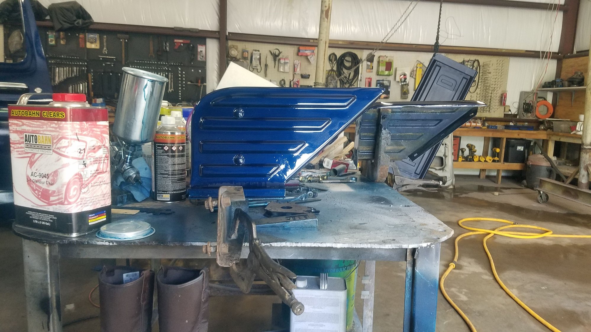

We did get the tailgate mounted and painted finally. And not a moment to soon.

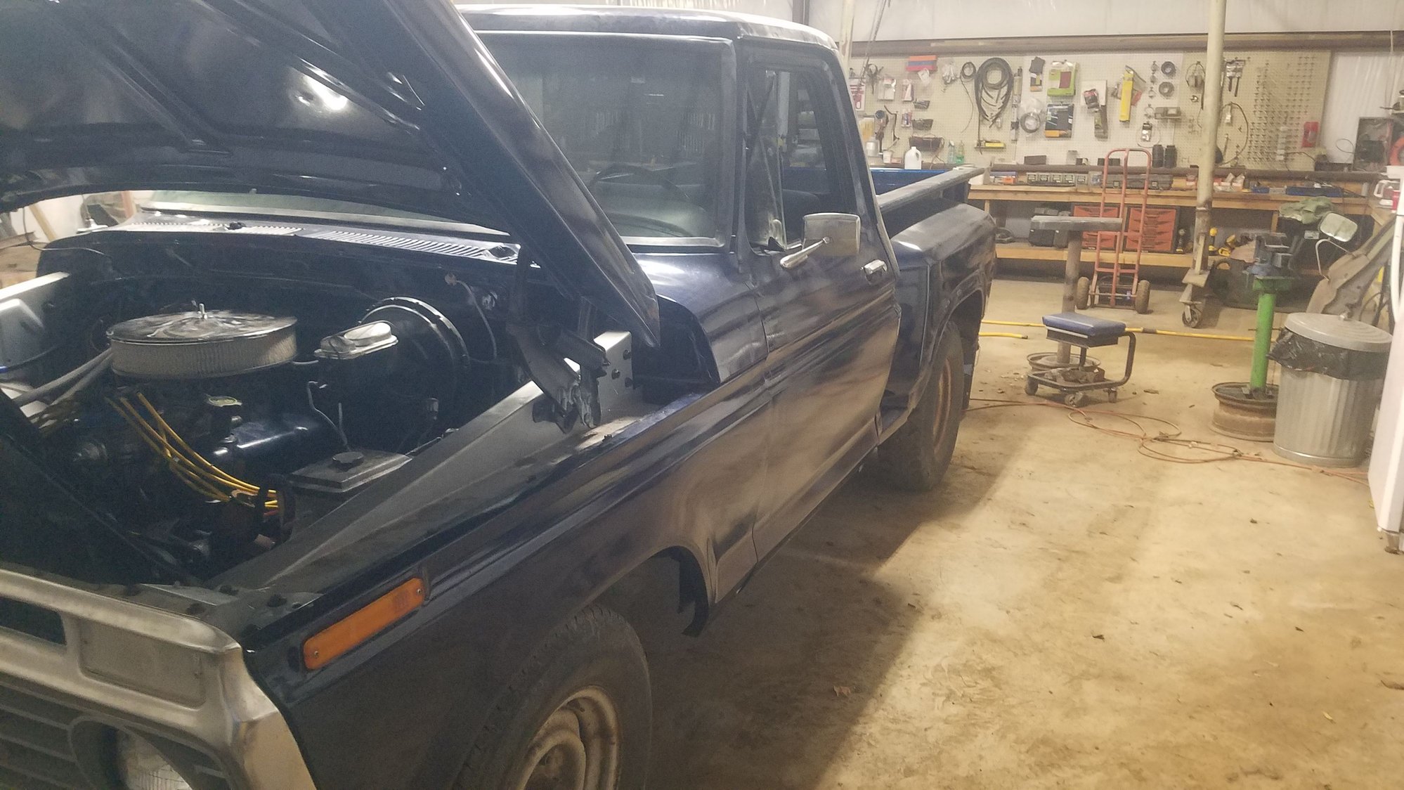

to start with had a few engine problems, when trying to start for the first time some of the valve train components broke.
so the investigation starts. Some of the parts where not the correct parts. Had a little difficulty getting the right parts, as the three suppliers i used had all merged into one. Eventually got the parts and motor reassembled.
Motor started and ran with about a round and a half. This #%&$, thing is still not letting me add attachments.

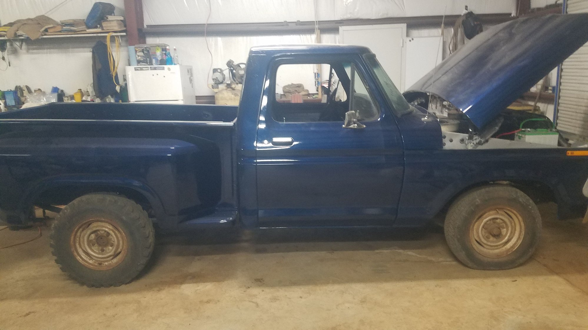

side view, different rims and new tires are scheduled for tomorrow

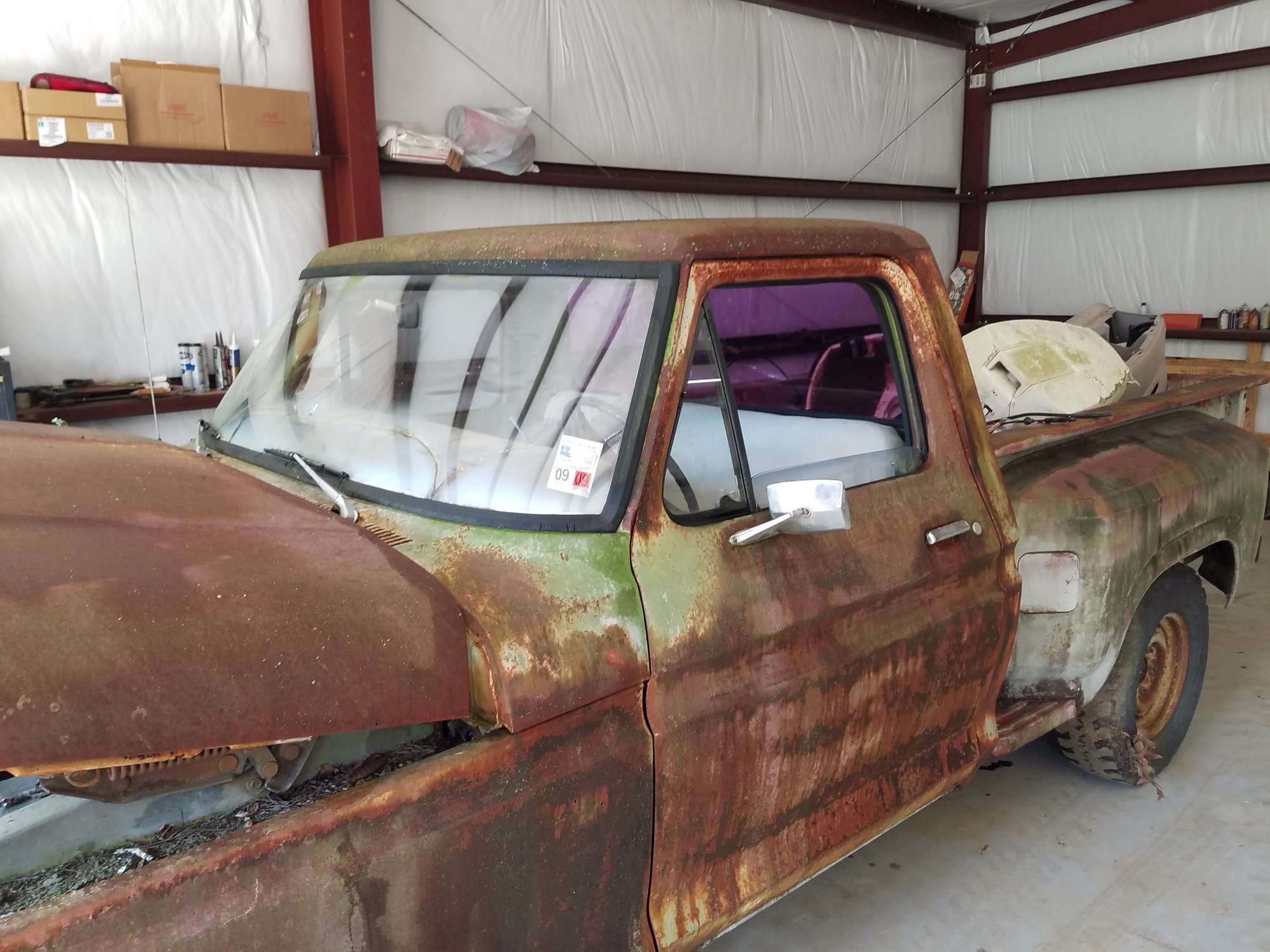

from this
to this
