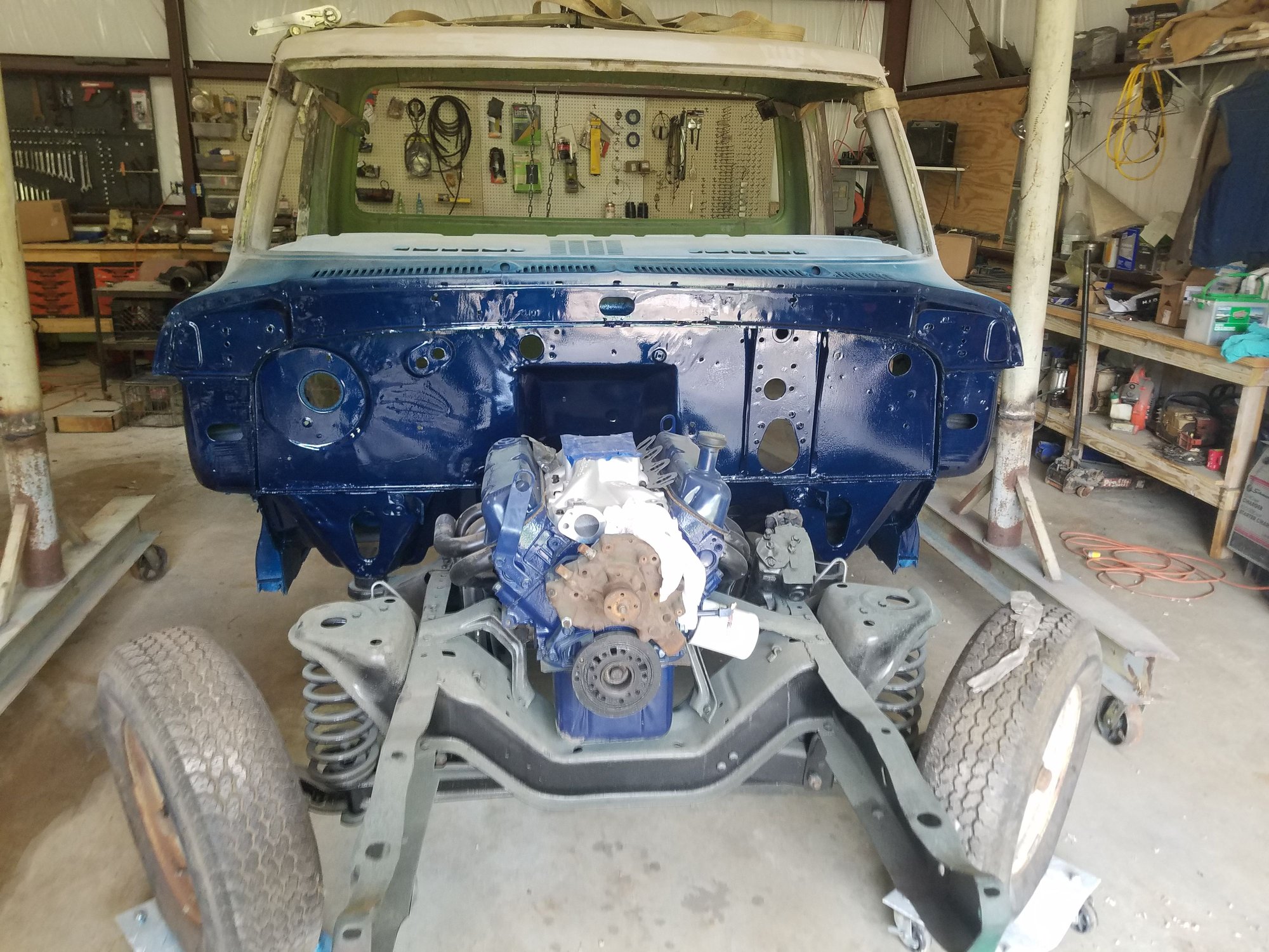

Finally got motor and transmisson set back in the frame and bolted, also got exhaust tied together
A coat of paint on firewall
A little clear coat
Cab back on frame and bolted down, this how she sits today

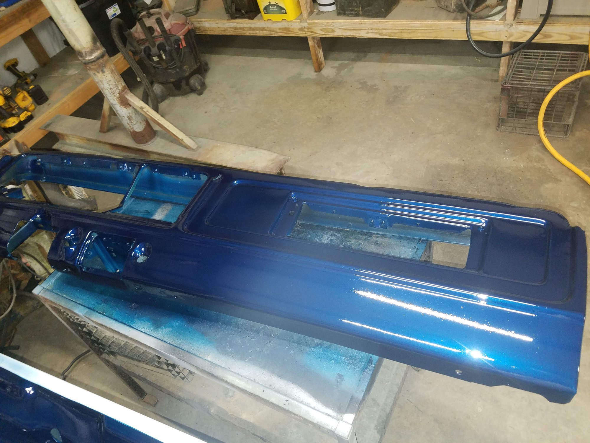

Dash board painted and assc. although not shown

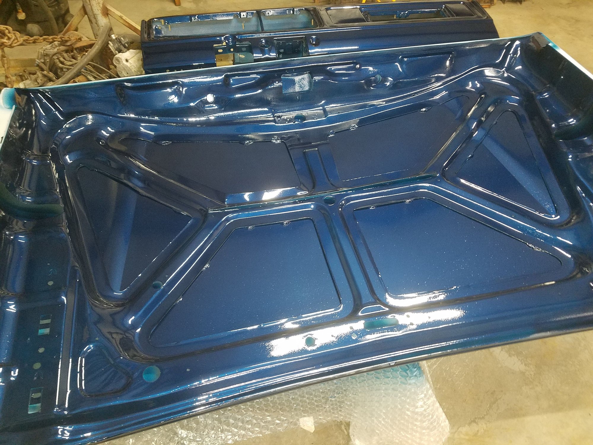

Underside of hood, i will try to start reassembling front end next week.

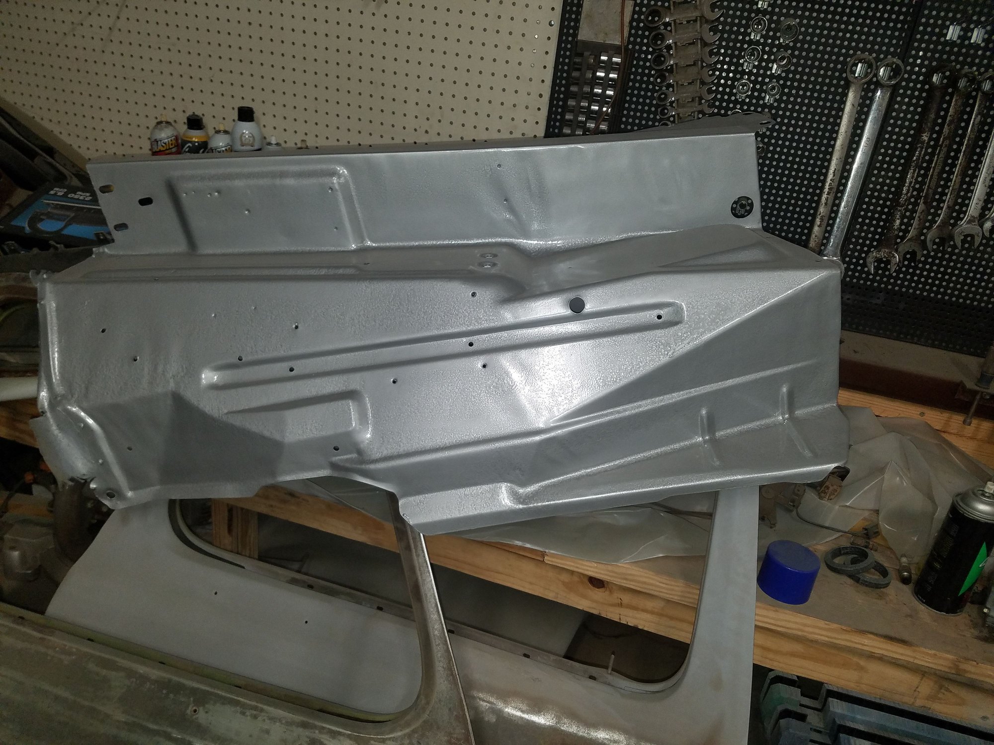

the inner fender wells i followed someone lead on here (sorry don't remember who it is). And painted engine side with the silver hammered paint, thanks they came out looking really good
Drivers side painted
And passenger side done also

I like the original look too, but as far as i know you can't by it. And get them redone original ain't happen. So i sand blasted them, treated,primed and painted them. That hammered paint came out really good. Thanks whoever's idea it was.

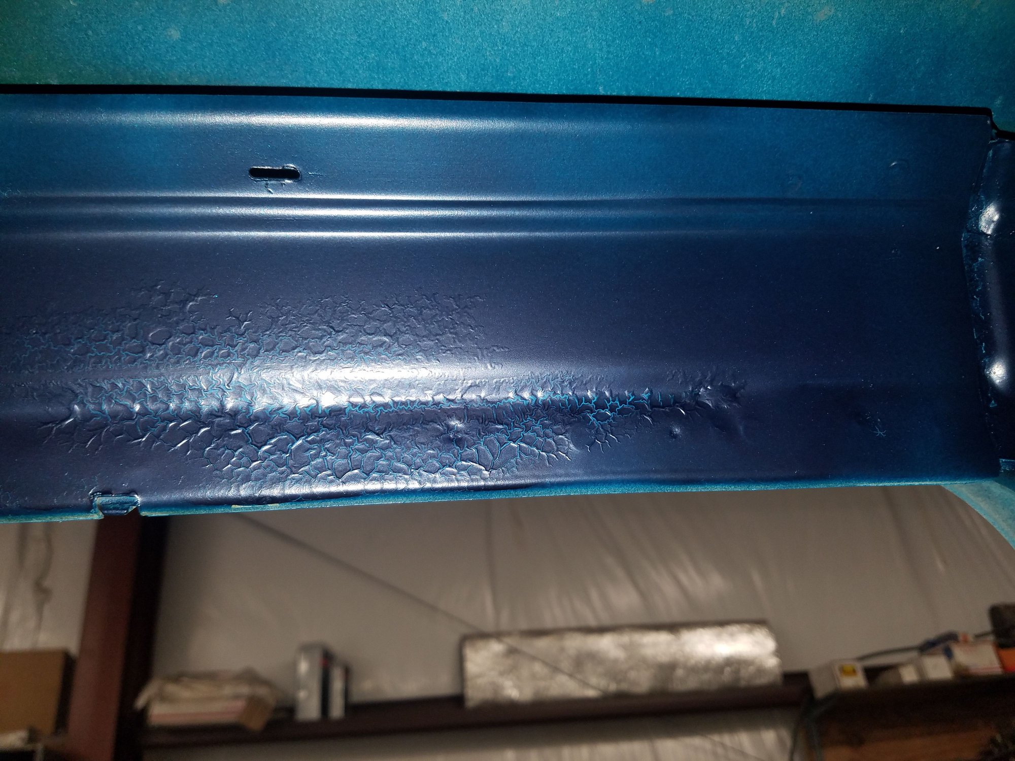

Bad paint job, had to redo. Primer did not cure as it should have, temp. humidity who knows had to redo.
This time looks much better At 400.00 a gallon first time is best if you know what i mean.
Paint redone
