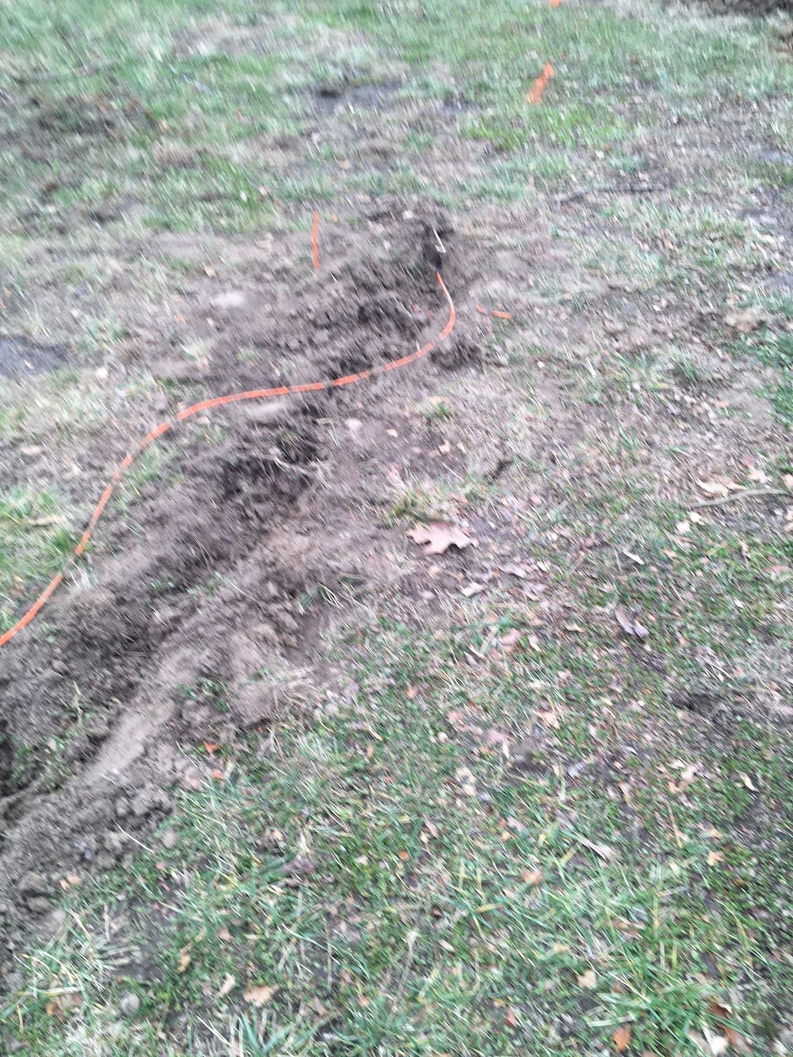

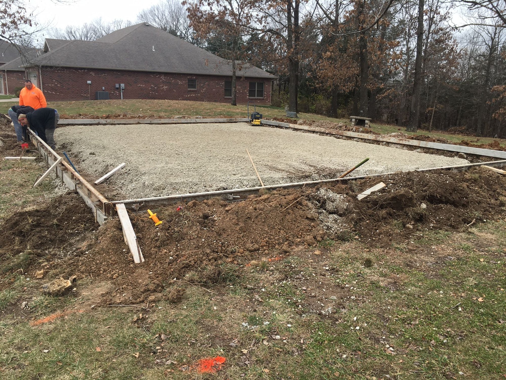

Time for an update. The build has started. I got my building permit and they began work on Monday.
The guy doing the work asked how I managed to get the building permit in this neighborhood. I just smiled. Some of the neighbors might not appreciate a garage on that lot, but the building is for me and not them.
They started some hand digging because the Mediacomm internet cable and power are running where the sidewalk connecting the house to the garage will be. We actually had to move the shop about 5 feet away from the house to avoid the buried cables.
Well, the internet cable was not very deep (I told them that) and one of the workers managed to slice through it in his digging. He said he thought it was a root. Great, now no internet. Mediacomm will be out in7-10 days. The crew did a splice that worked for about 30 minutes.... Fortunately my work has hot spots available so now I can continue to work from home.
Here they are after two days of work. There was more fall than we expected.

Phone and internet wiring are usually barely under the sod. Sometimes I tear them out accidentally even when they are marked because they are so shallow.

Thanks for the update, Joe. Interesting similarity, they cut my internet cable when I had the construction road cleared for my new garage. If your cable was not spliced with a current grade splice connector, it will be flaky. Perhaps even with the correct piece, it will be flaky, depending on the condition of the rest of the line. Those splice connectors are readily.available .
