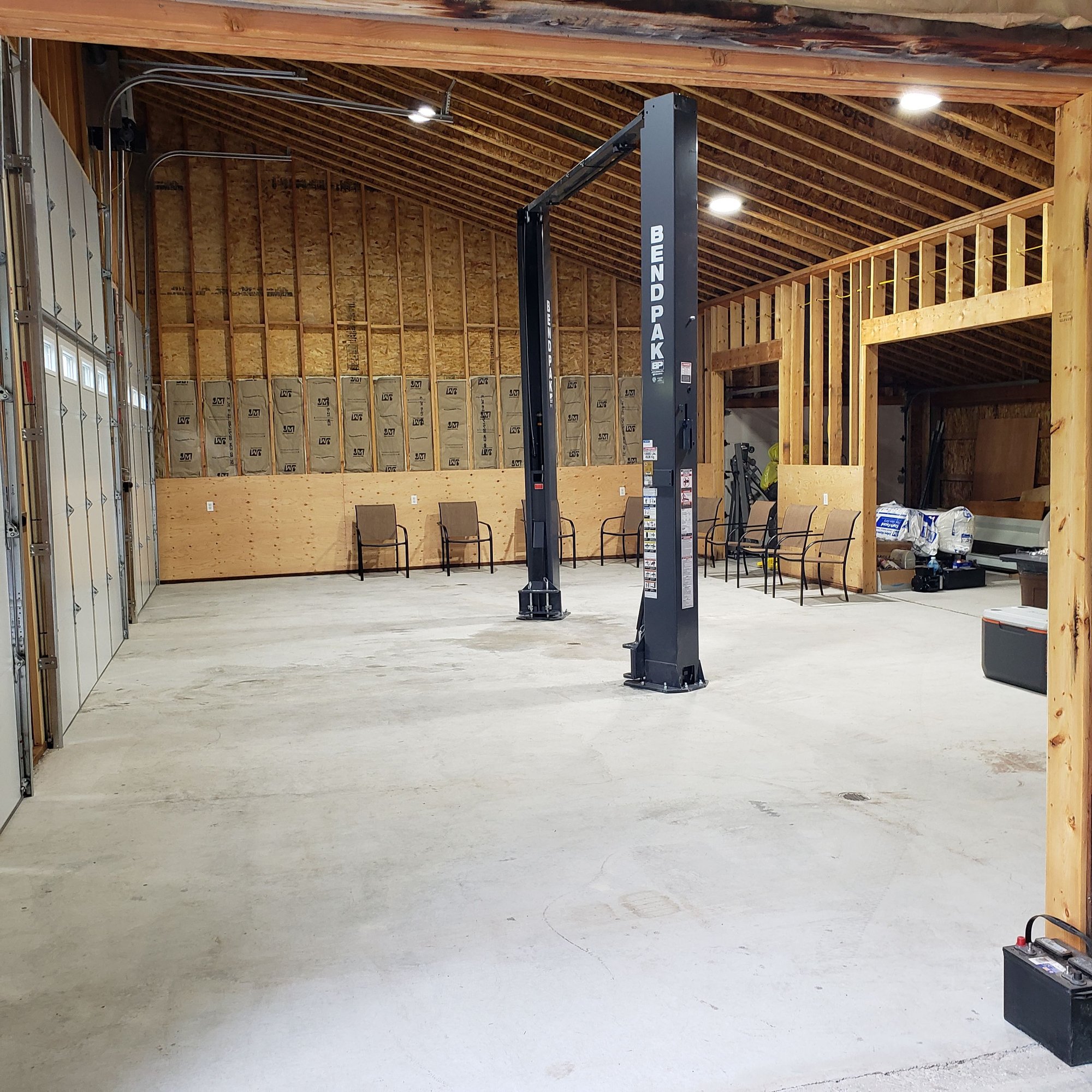

All doors are 10' high except the 12x12 where the lift is located. Front wall is 20' high and slopes to 8' so the snow slides into the pasture. Frame construction with metal siding for fire prevention up here in the north woods.
This is a shot of "high lift" doors. They follow the wall up and curve over just enough to clear the opening. I went with wood, so I got around the span problem by building large door frames in the middle wall and using 12" BCIs for rafters.
