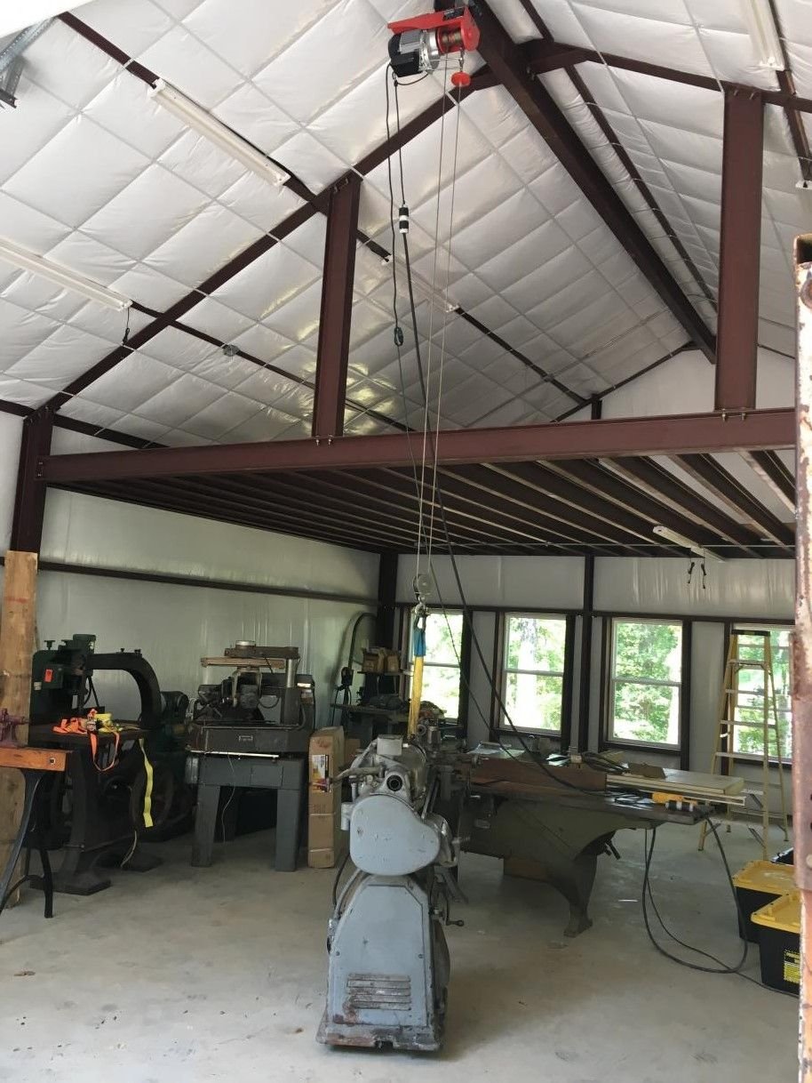

Mine is red iron, 30x40x12 with a 6/12 pitch and a 20x30 loft area across one end. Door is 12x12. Mine was built more as a general purpose shop, wood and metal work, than a car shop. I had it engineered with an I-beam to support a 1 ton hoist and trolley. I also had a 12x40 lean to added for lawn mower and other outside stuff to keep that out of the shop. A sloped lot will add considerably to your foundation costs. Mine had a 48" drop front to rear.

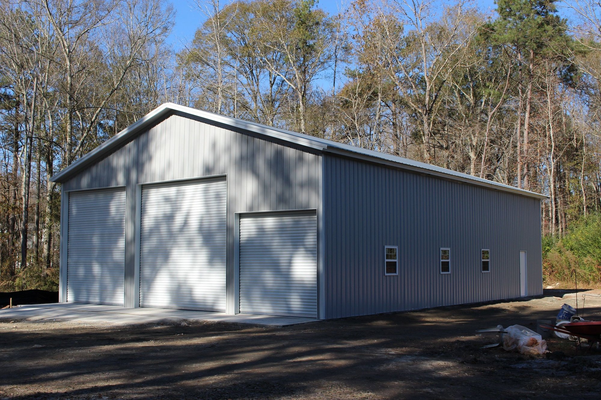

I have a 40' x 60' pole barn built in 2015. 16' eve height with the peak at 22'+. I wanted the height to allow 14' tall doors which will accommodate the maximum allowed height by U.S. DOT at 13' 6". The doors are 10x10, 12x14, and 14x14. This also allows for the 12' max height of my 2 post lift. You will need more height if you lift a vehicle with the hood open up to maximum lift height. The metal trusses give you more "head room" and they are on 10' centers. Construction took the crew 7 working days total and were split up to allow the concrete floor to cure. The duration of construction was less than 3 weeks. On a cost basis, it was cheaper than a steel building and had more headroom than a wood truss pole barn at about the same price.

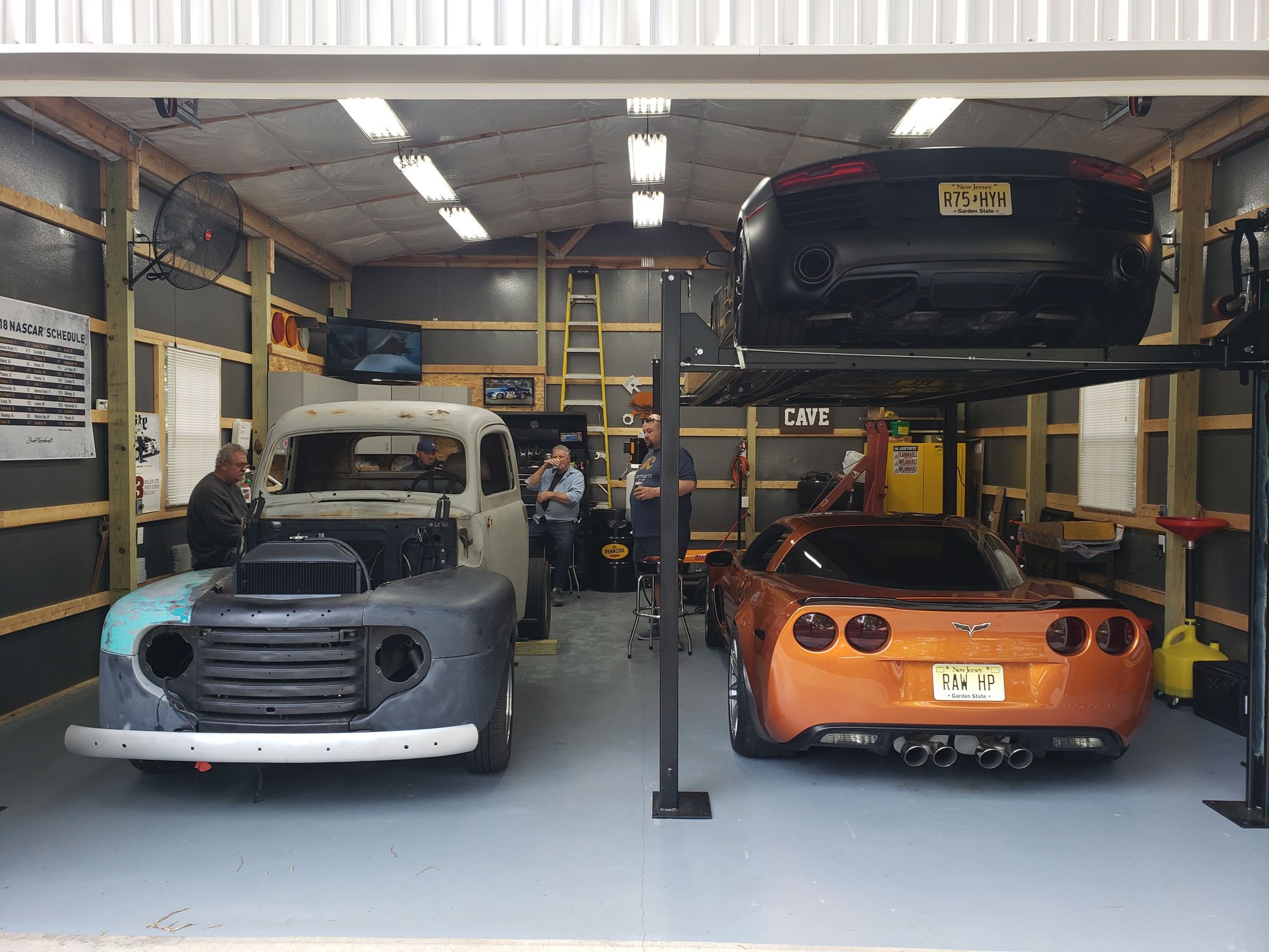

Hello, my shed is 40x30 metal on post building with a 10x10 door and a 16x8 door in one long side. A 3' walk in door in each gable end. 14' tall. Extra tall/wide 4 post lift lines up on 10' door. I can put the f3 on top and pull the f150 under it without pulling in mirrors. 4" thick concrete is all the lift specs called for, but I thickened the slab anyway at the 4 legs. Framed out the interior with 2x4 horizontally just like the outside, ran all the wiring in that 2"space, insulated with 6"fiberglass and sheetEd with same metal as outside. I don't bend good or kneel good anymore , that's why I went with 4 post over two post. Plus I can store a truck on it. If you are planning for a lift, my advice would be to plan what you want it for, find the lift you want, check and double check your required total heights, and build accordingly. Above all have fun with it! Larry

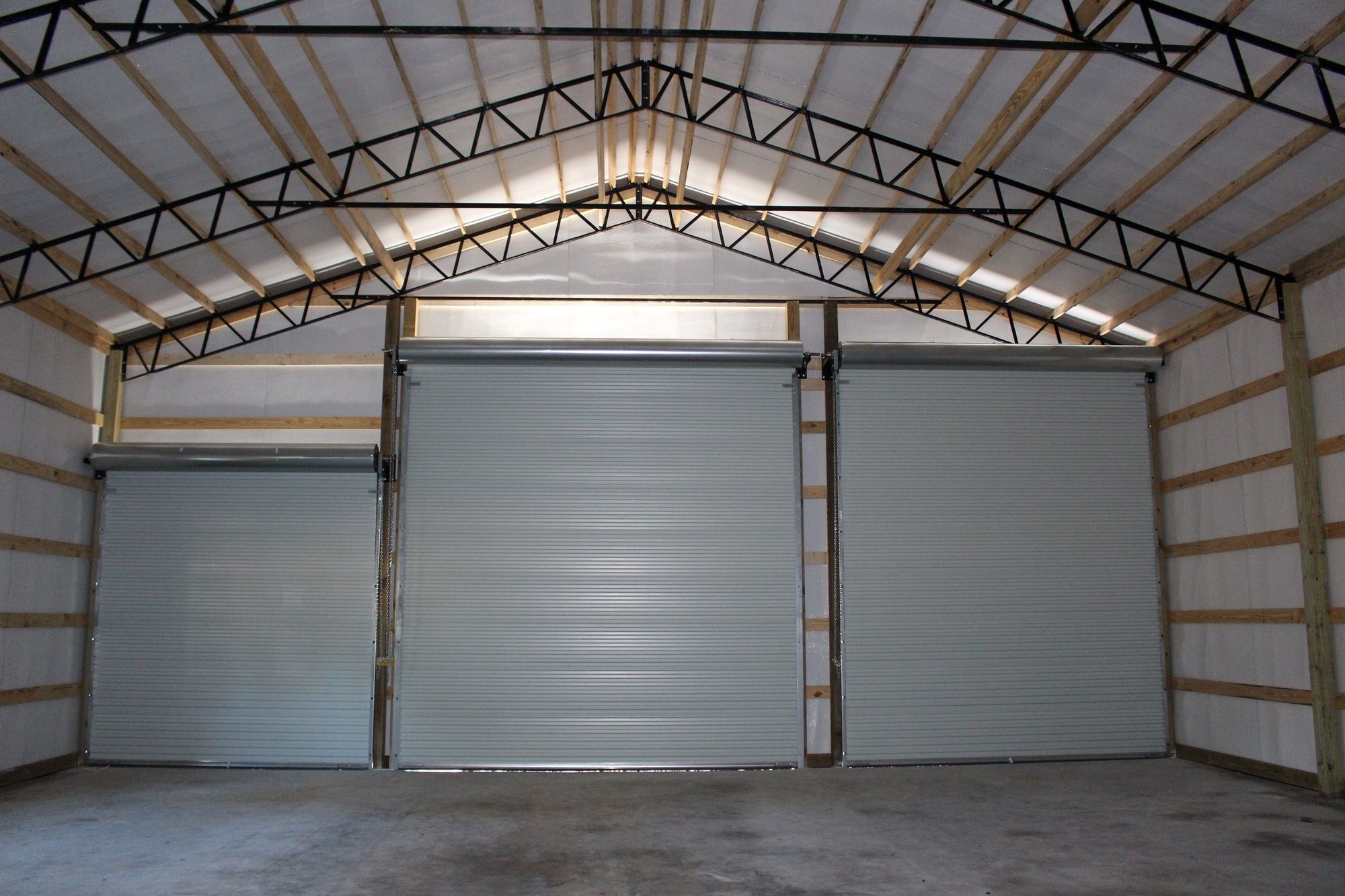

Roll up doors are the best, helps with the lighting, minimum one at 10x10 others 9x9, 8ft wide just a tad to close for the quick pull in and you control the size so why not. I did three doors two are like a drive through the other is a single, all with roll up doors, would never do a shop with regular doors. I surface mounted all my electrical (hard wired) because me, I am always changing things.
