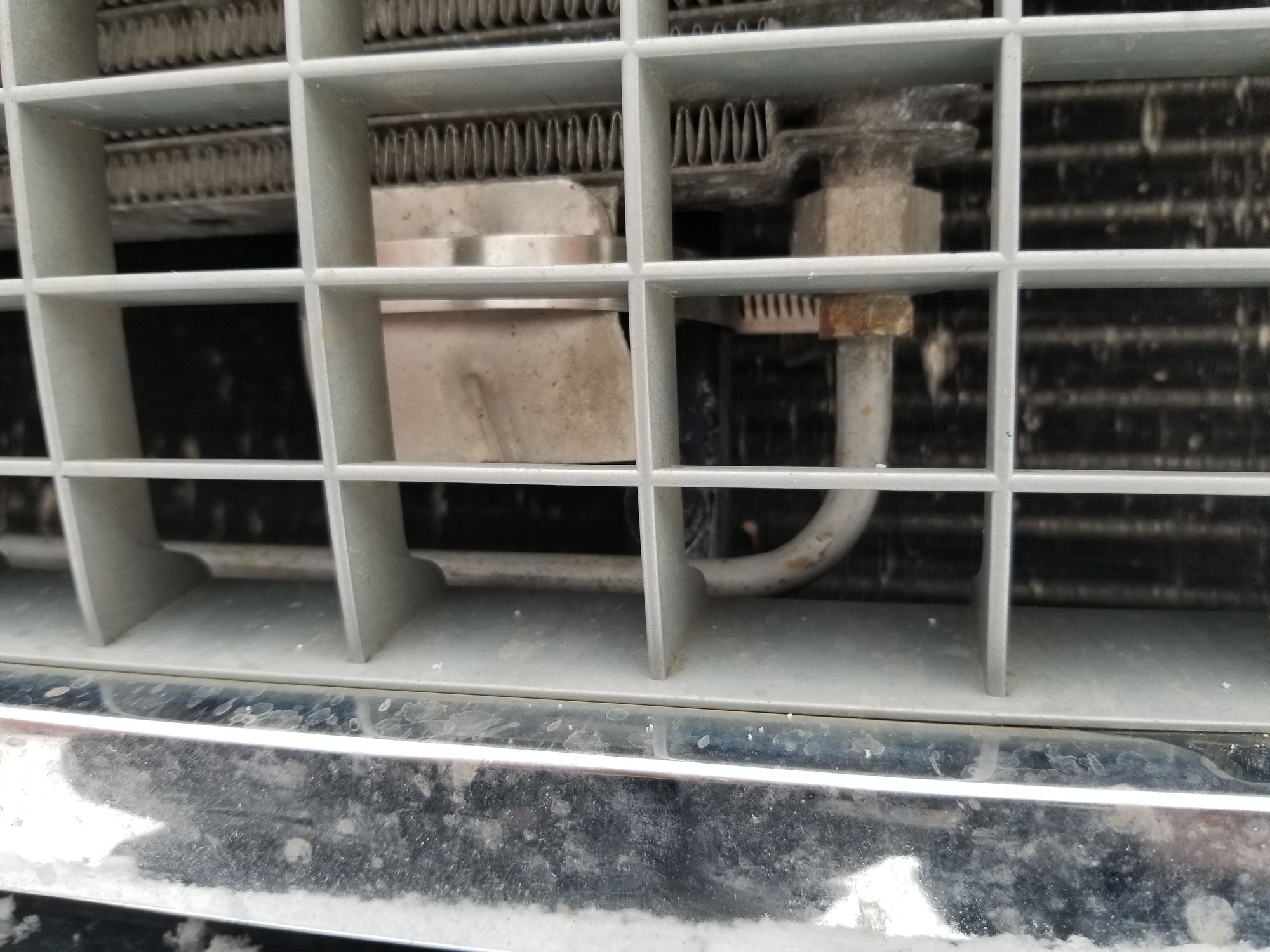

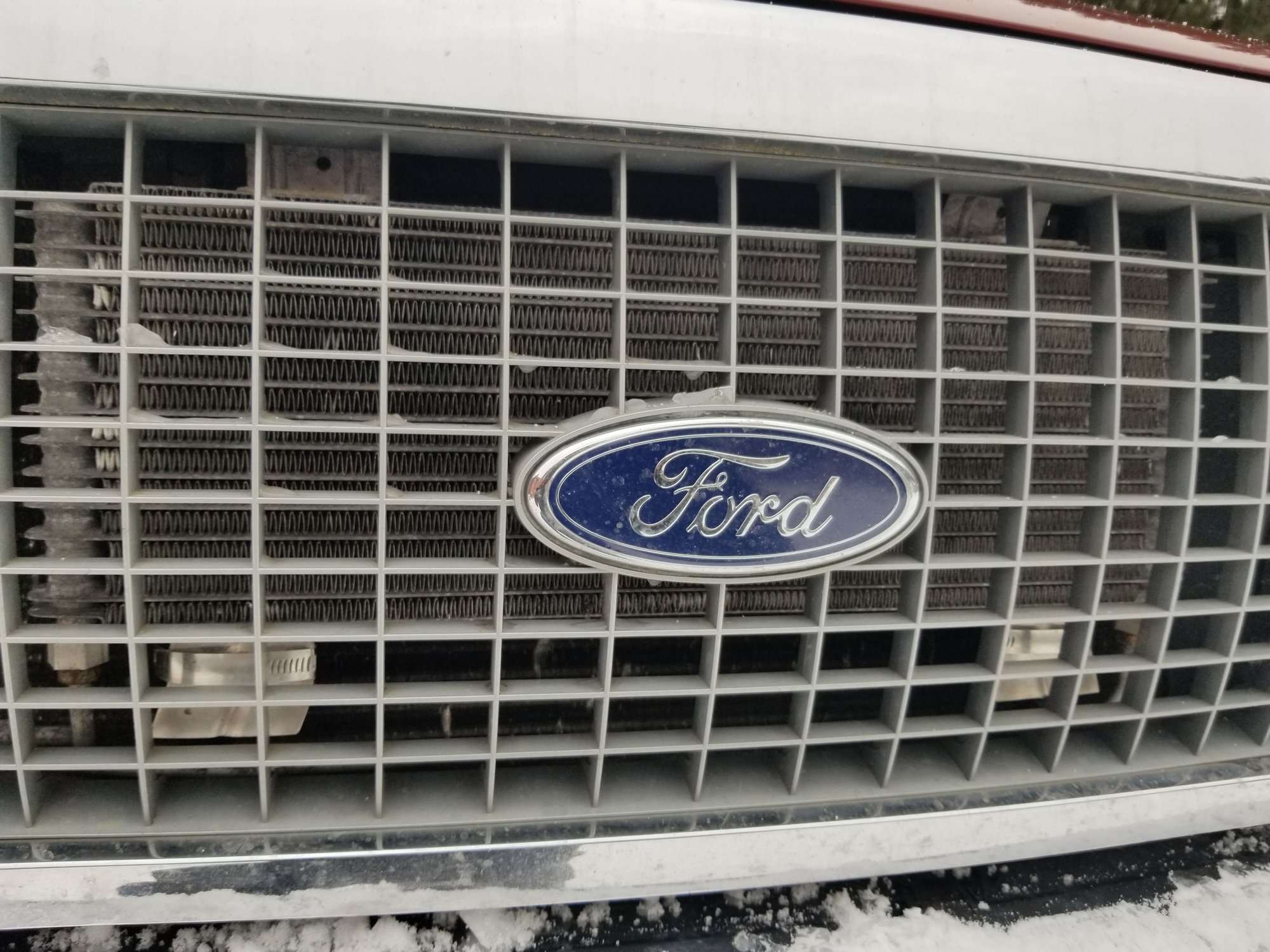

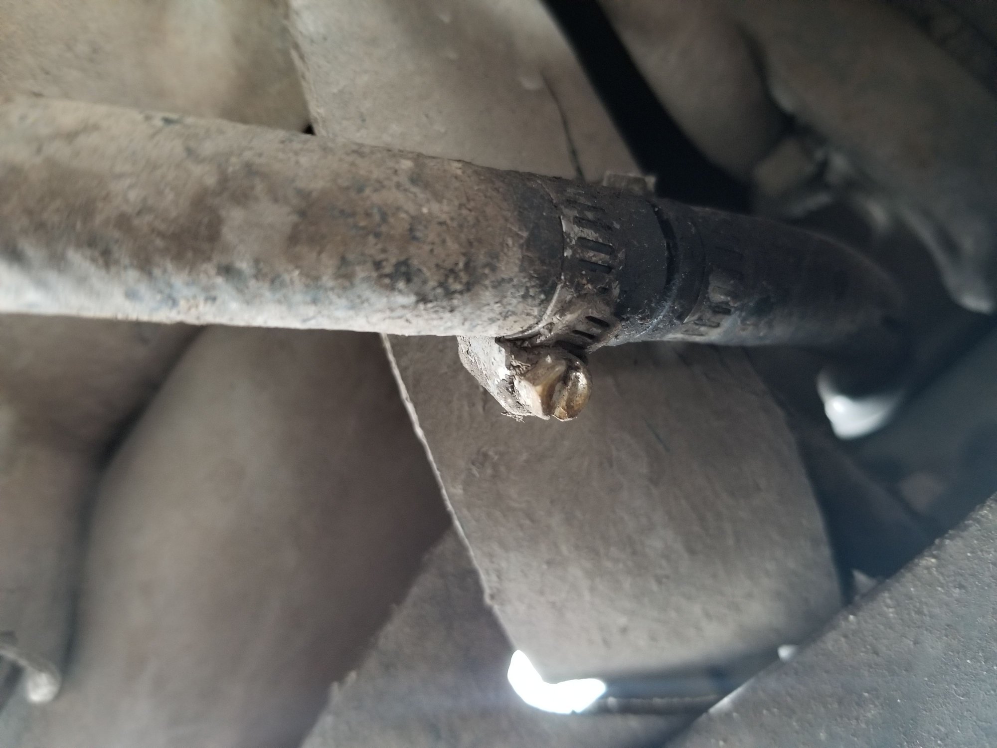

The V10 cooler is mounted to the fiberglass panel behind the grille. Mounted at the top with bolts and held in place at the bottom with stainless hose clamps. Hoses are factory Ford and spliced into the cooler loop with brass nipples.

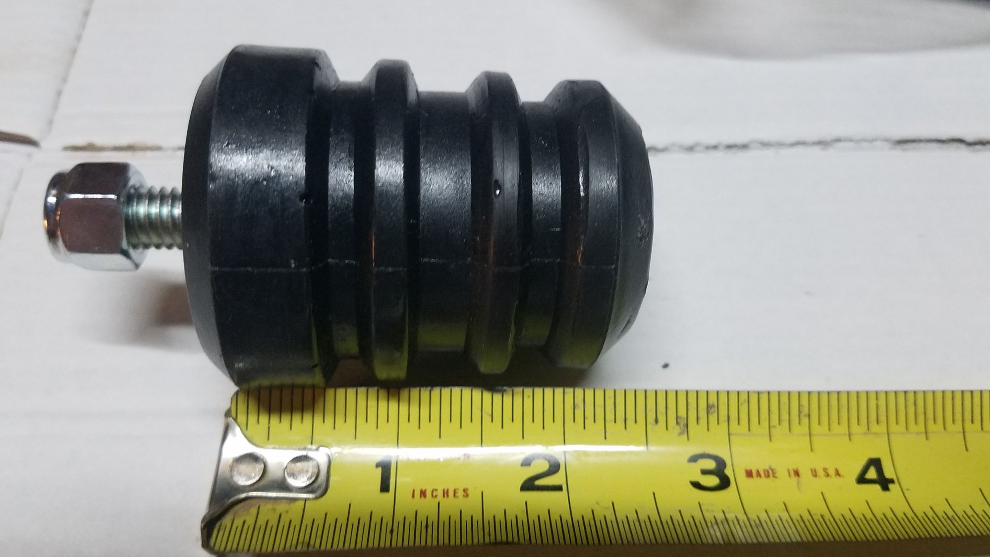

So the anti-wrap springs have no bump stops anymore, rendering them useless. Figure it is easiest to just replace the bump stops on them, factory Ford units are ~100 a set. Decided to get something cheaper. The measured gap is 3" so I searched for universal bump stops.
This is what I went with for stops. A softer compound and for Low Rider use.
https://www.ebay.com/itm/Belltech-Un...Cclp%3A2334524
