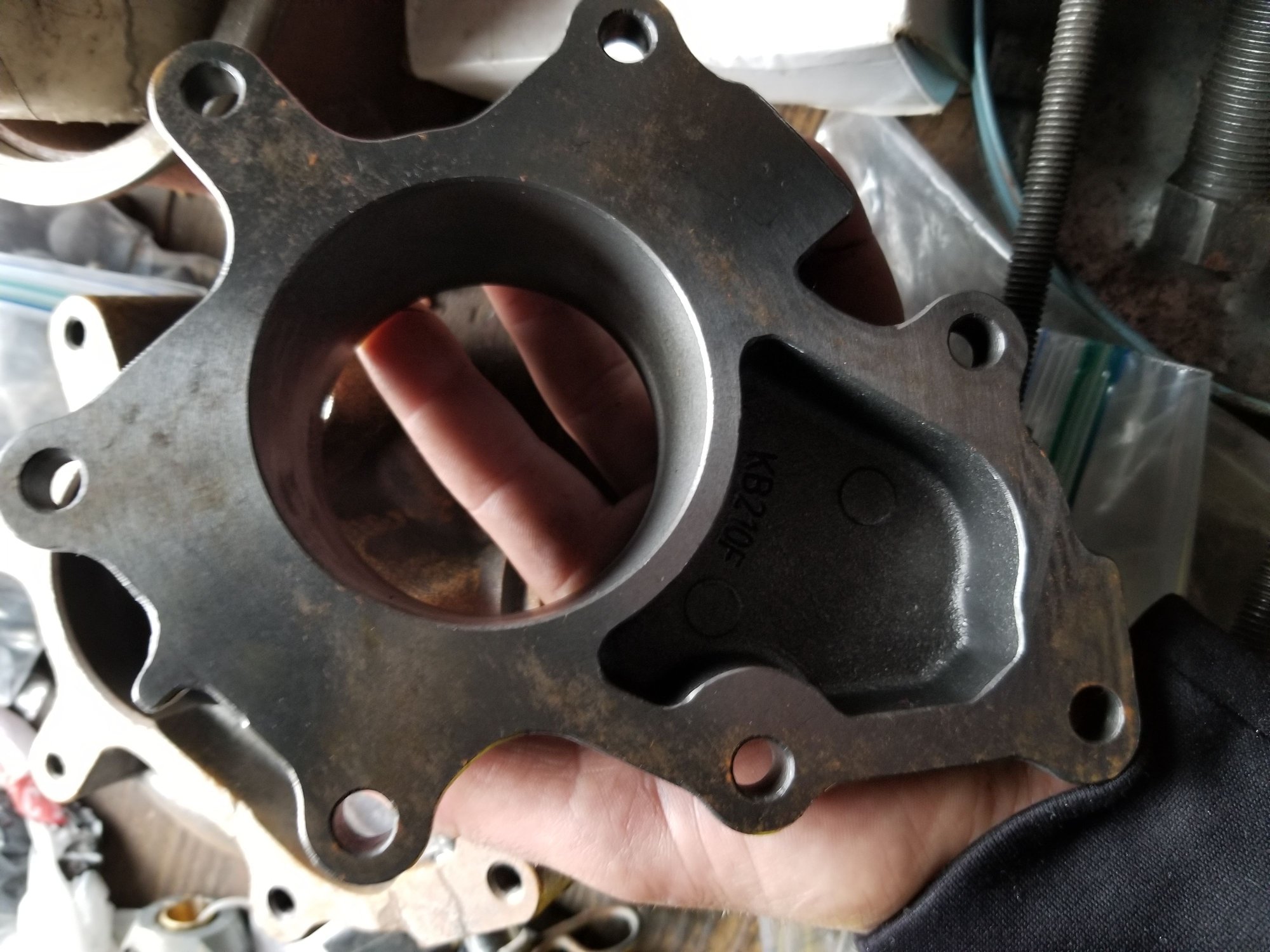

Also got the "high flow outlet" for the gtp38, it also has the ebpv delete cast into it. Looks like I will need to open up the wastegate portion to optimize flow.
