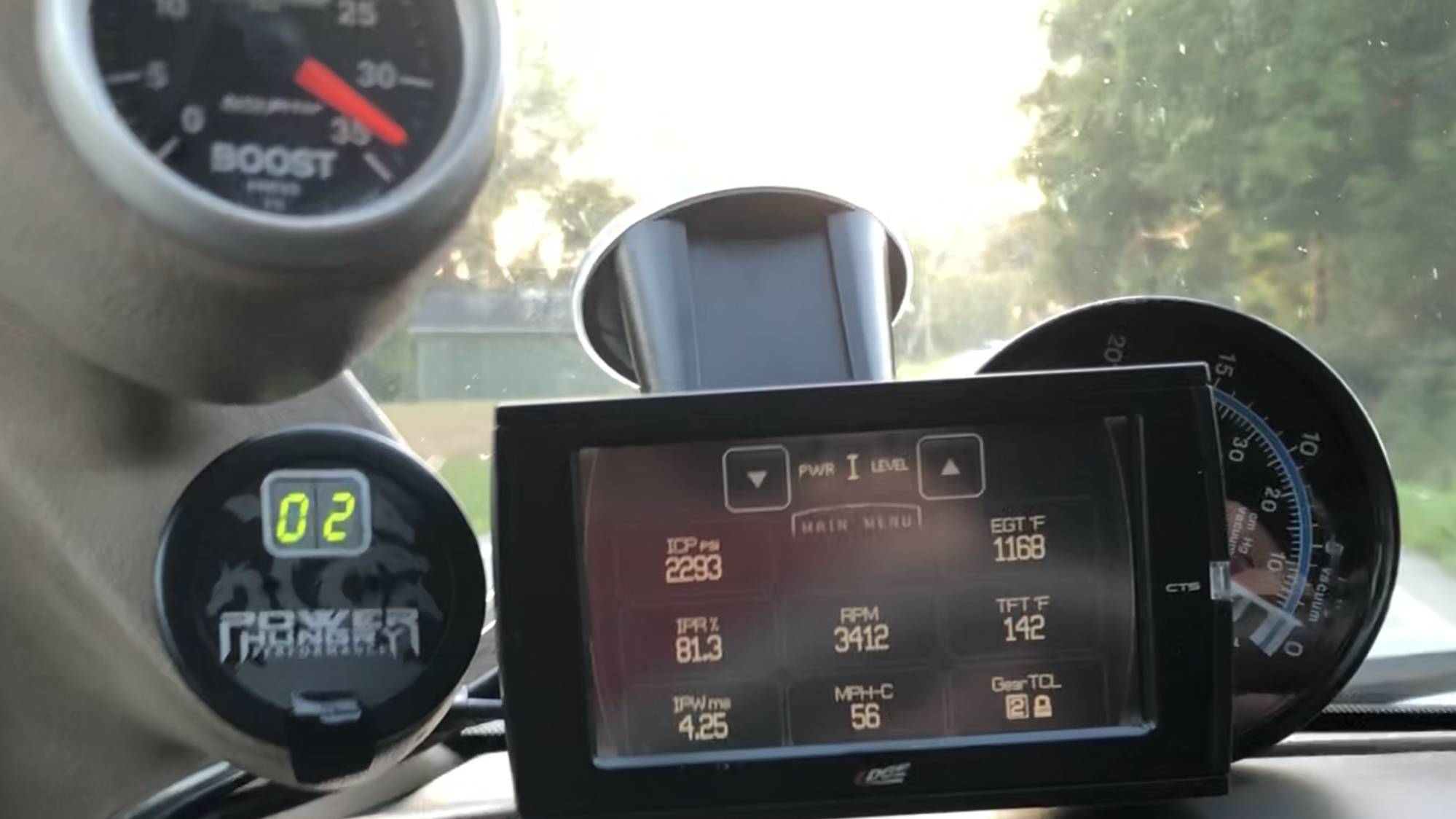

Did a WOT 140hp test run recording the gauge this evening. Temperature was around 84*. The run was from 11mph to 70mph over approximately 10 seconds.
What I see in the video is the vacuum gauge sweeps up to 1 inHg fairly quickly as boost hits about 30psi and then it remains there constant throughout the rest of the run. Even as boost would drop and gain due to shifting and rpm, the gauge remained on 1 inHg.
Under all normal driving the needle remains at zero with little to no movement.
My assumption from this testing is the 6637 breathes freely with almost zero restriction up to about 30psi of boost. I’m using boost as a rough gauge of amount of airflow. 30-35psi remained the same 1 inHg of vacuum. Variance in rpm in the 30-35psi boost level also did not effect the vacuum reading.
Snapshot of video. This is just before the auto shifted to 3rd I believe. 140hp PHP tune, 34psi boost, 3400rpm, 1 inHg vacuum with the Donaldson Blue 6637 style filter.
Zoom of gauge in previous video clip. 140hp PHP tune, 34psi boost, 3400rpm, 1 inHg vacuum with the Donaldson Blue 6637 style filter. The smudged number is a “5” and the outside increments are 1 inHg each. Refer to earlier post for visual of “zero” condition.
