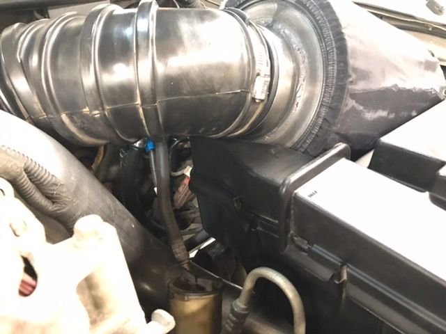

FWIW, the noise with my 38R and AFe intake isn't too bad. I am a turbo whistle addict though.
Thanks for the input!
If you like the 38R sound then you may be disappointed in the SXE whistle....
Personally I don’t have any issues with the 6637/SXE sound but love the clean look of the AIS. Of course the noise reduction of the AIS is a bonus for me. I think I dislike the look of the factory battery cover more than anything when using the 6637. And if it’s removed it just doesn’t look right due to the battery box design.
What’s the extra ductwork? Cooling for the alternator?
I will probably miss the turbo noises a little but my objective in switching to a T4/SXE setup is to rein my EGTs in. I'm willing to lose turbo whistle for that.
Yup!

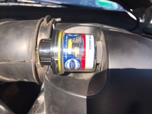

I have the AFE as well and just finished my SXE install. There is still a whistle but it is not loud or obnoxious. Of you like the 38r then you will probably be disappointed in the lack of noise.
