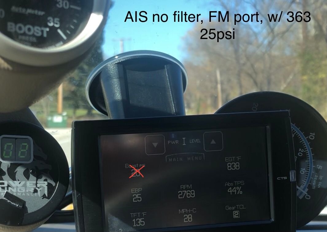

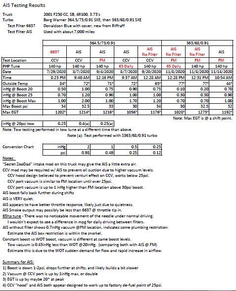

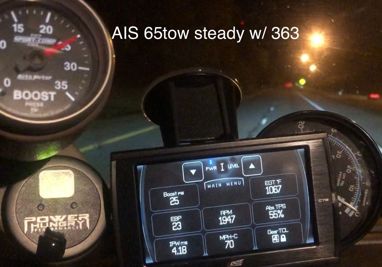

OK guys, sorry for the long delay in response. I haven't had time to give a response respectful enough for the good posts you guys have added. I will post my current testing status update and hopefully have time to go back and address your posts this evening.
So as most of you probably know by now the turbo has been swapped out since the beginning of this adventure in AIS testing. I went from a 364.5/73/0.91 to a 363/68/0.91. All the testing presented in this post was with the smaller turbo. I reran the AIS test with gauge in FM port with current turbo just for consistency. As Y2KW57 states though, temperature likely has a pretty fair effect on testing. At least in the EGT aspect. The vacuum readings probably remain similar between temperatures.
What I have found is the AIS shows a restriction in the system when accelerating quickly. It seems the rapid call for air outweighs the actual boost numbers. Towing with a steady boost shows a significantly lower vacuum in the air box.
I have also noticed the rpm doesn't seem to play a big factor in the vacuum gauge. This may only be true because the engine is ramping up so quickly that the restriction just holds for the entire sweep. However it is possible the lower steady state towing vacuum is at least partially related to the boost being made at a consistent lower rpm.
As I mentioned the other day, the AIS box has a significant restriction even without a filter. The gauge would hit about 0.7inHg under a heavy throttle. Surprisingly the needle would also move fairly easily even in the 65hp tune during moderate acceleration. This leads me to believe the fender sleeve mod may truly help the air flow of the AIS. I know this has been previously stated by other members based on the FM readings but I was glad to quantify it a bit with a vacuum gauge. The restriction seen from the air box should be from the draw of air through the snorkel. One key point aspect that I cannot quantify (at least not without doing @aawlberninf350 's suggested filter & duct tape method) is how much restriction the AIS filter alone causes. Even though the airbox has a restriction, it may be possible the filter is the biggest bottleneck and therefor we may not actually see any additional restriction from the snorkel. Sorry, don't think I will being adding duct tape to a $70 filter to find out though.
So with this all said, I may be doing a fender sleeve mod to the box for another test run. I know, much to the dismay of Y2KW57. Here's some reasons I'm not overly concerned with the potential ice dam or water aspect. 1) I looked at the fender and it appears a big part of the air would be coming from behind the headlight. 2) I don't drive the truck in the rain or snow much. 3) I'm hoping the twisty turns taken by the air while heading to the box would cause the water to want to drop out. Much like the "Hidden Zoodad" mod Y2KW57 describes in another thread. 4) Many others have ran a sleeved AIS without issue. 5) I feel like this would help the snorkel keep up, especially during those sudden demands for air. I think I have found the correct shop vac filter. Does anyone have a link to a good write-up on a fender sleeve mod?'
What would really be nice is if someone with access to a dyno would perform these tests under more controlled testing and with a more appropriate gauge. @Peixinho would you happen to know anyone with such a facility?
Reading the gauge and various conditions has proven difficult especially when trying to keep the data and readings consistent. For example, I have noticed the vacuum @ 25psi varies between 1st and 2nd gear. I'm assuming this is from the quick drop in demand due to engine rpm and boost reduction. So it would also stand to reason the readings may be different depending on how fast I am travelling when starting the WOT run.

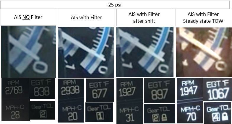

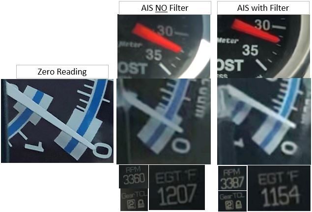

Here are some photos of the different tests. I have also clipped and combined some to hopefully make it easier to compare. I will go back and update the pdf in the original post shortly.
version 1.3 of the AIS testing
Comparison at same mph around max boost for these highway speeds. EGT increase is likely due to weather.
Comparisons at 25psi. Notice the middle ones are different gears.
