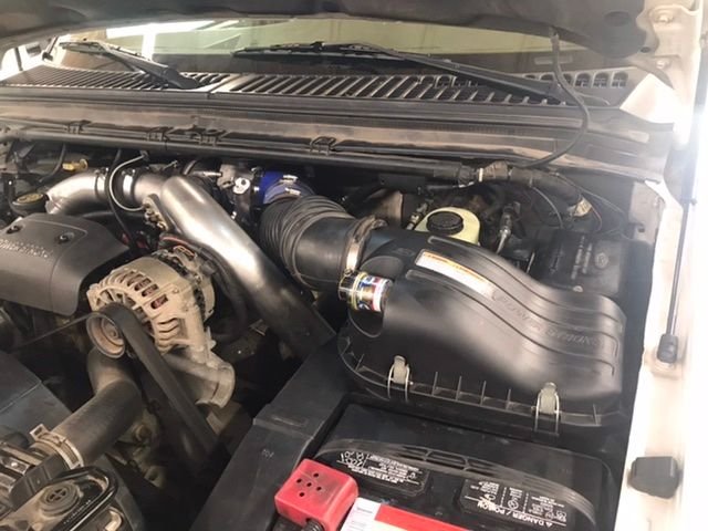

Here’s some photo proof.
AIS/SXE combo. Isn’t it pretty? I do love the clean look of the AIS.

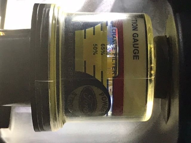

6637/SXE test including towing

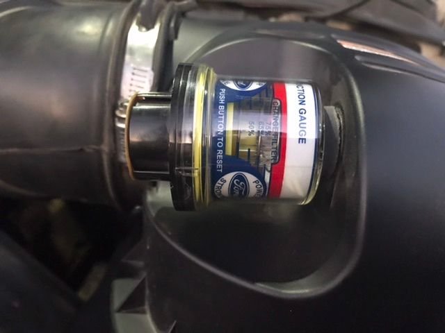

Same condition for AIS/SXE with normal driving

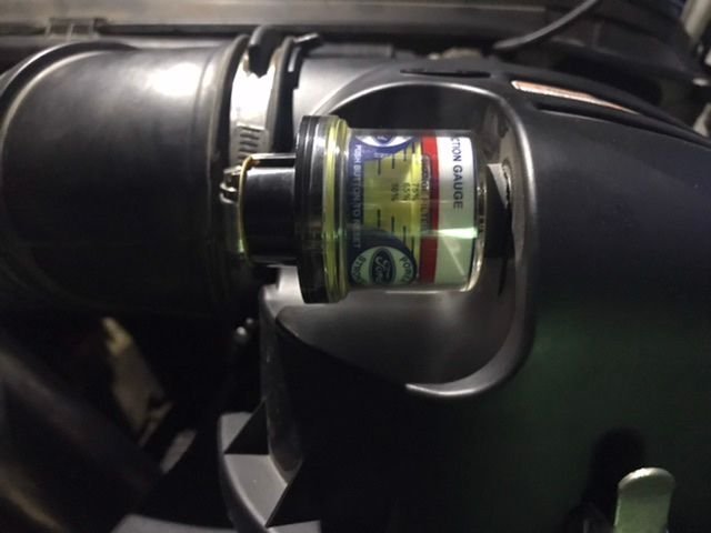

AIS/SXE with 140hp tune and full throttle run
AIS/SXE with 80hp tune and full throttle run
