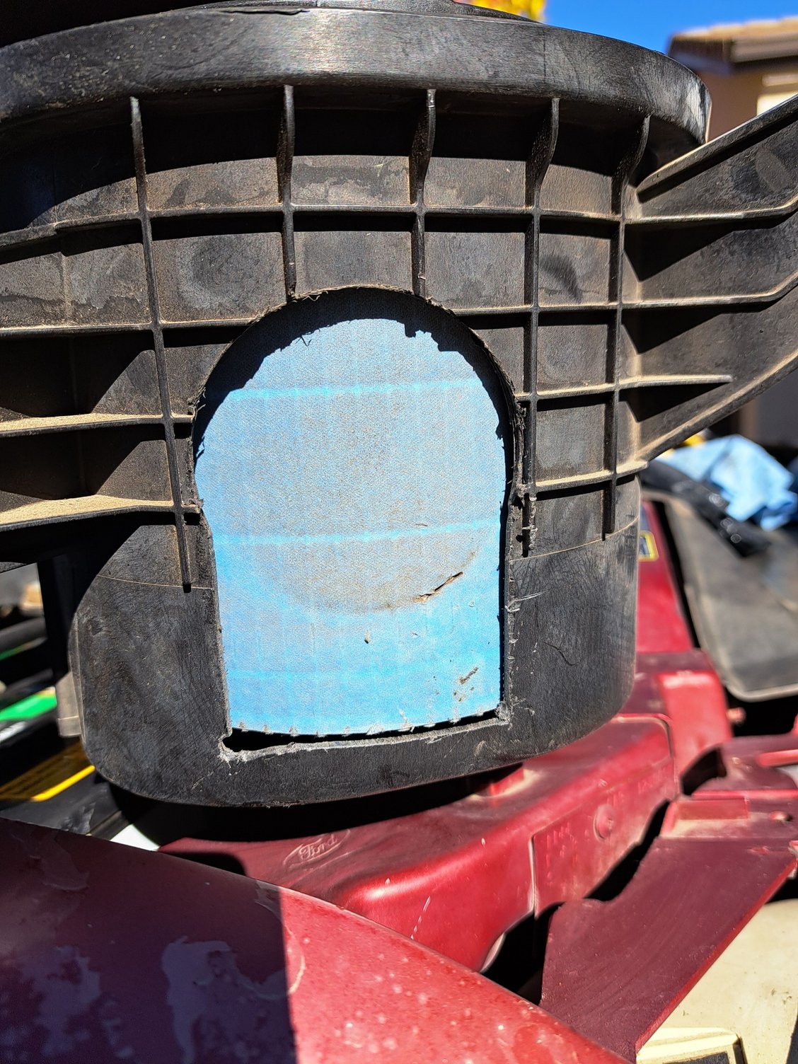

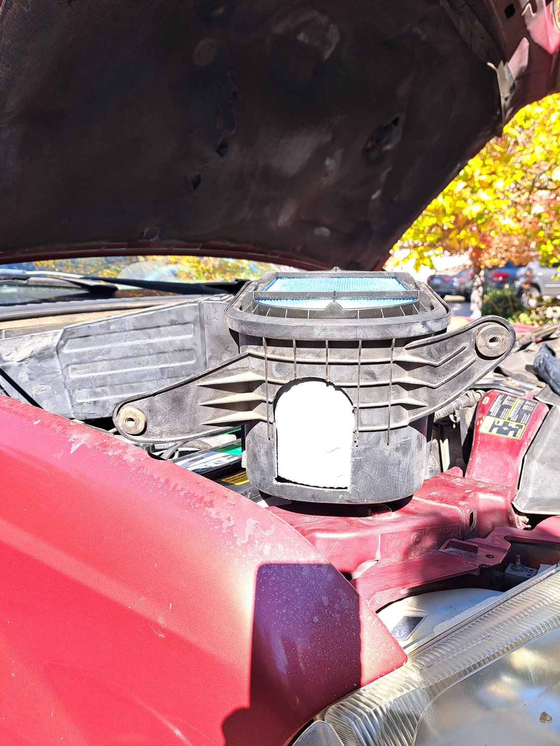

Thanks for linking this thread for me Jason, I wanted to follow up on the AIS fender hole mod mentioned here.
I finally had reason to pull my AIS. Not a good reason; CA smog finally noticed my Mishimoto IC. Passed smog inspection 6 times, but not 7. So I had to install an OEM IC. Sourced from one of the many Rancho Cordova yards $125.
The job was way easier 13 years ago.
So I had the usual 3" hole in the side of my AIS. Decided to cut the opening lower to allow flow more directly under the filter and not only to the side. I think the pics are self explanatory. The original hole plus the recent cut out.
Old Nov 7, 2024 | 07:19 AM
  #270
Lex2002's Avatar
Lex2002
Joined: Aug 2011
Posts: 2,319
Likes: 89
What is a mishimoto IC?
