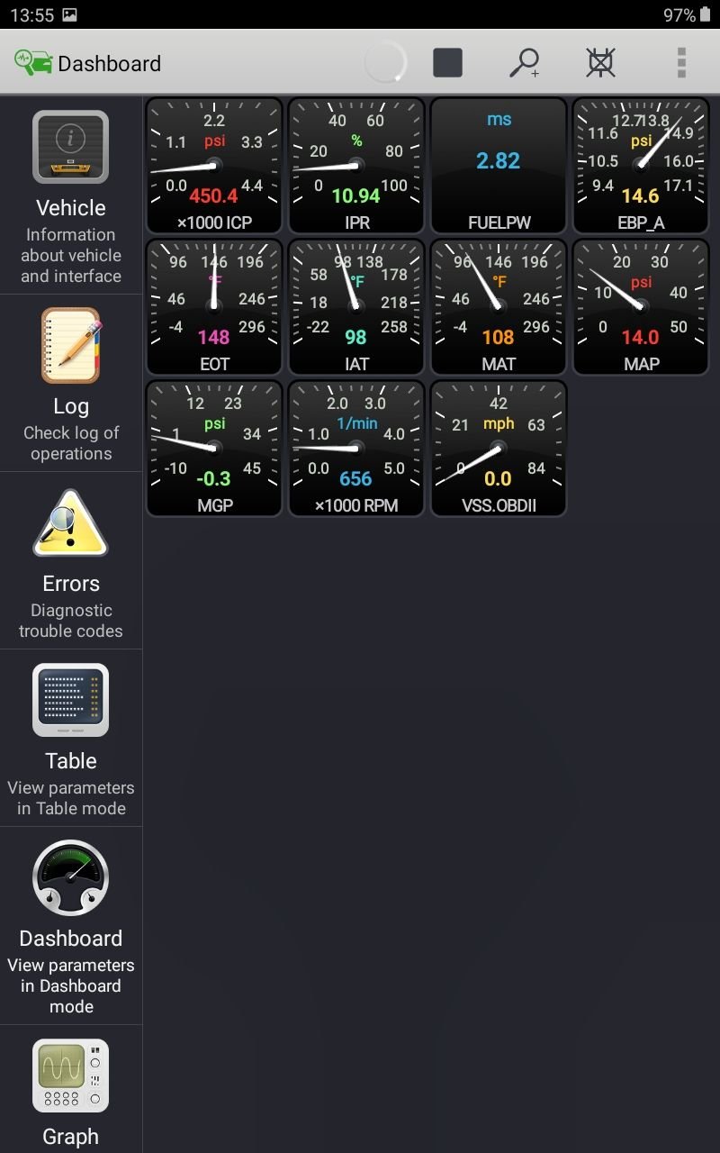

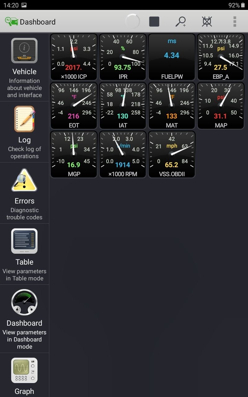

Some random screenshots I took today while towing the camper. Don't judge my FuelPW or IPR readings... This was all using PHP 80HP, which I saw no noticeable difference from the 65HP. I have since switched back to the 65HP tune and will run that from now on.
My IAT sensor is tucked up under the fuse box. I have a plastic cylinder secured to the sensor base which covers all of the sensor itself. It probably receives very little air flow in its position with the cylinder around it. I have a Donaldson blue 6637 style filter with a pre-filter cover on it.
Outside ambient temperature was between 91 and 100 degrees!
MGP is boost, thanks for the tip on that @BWST
