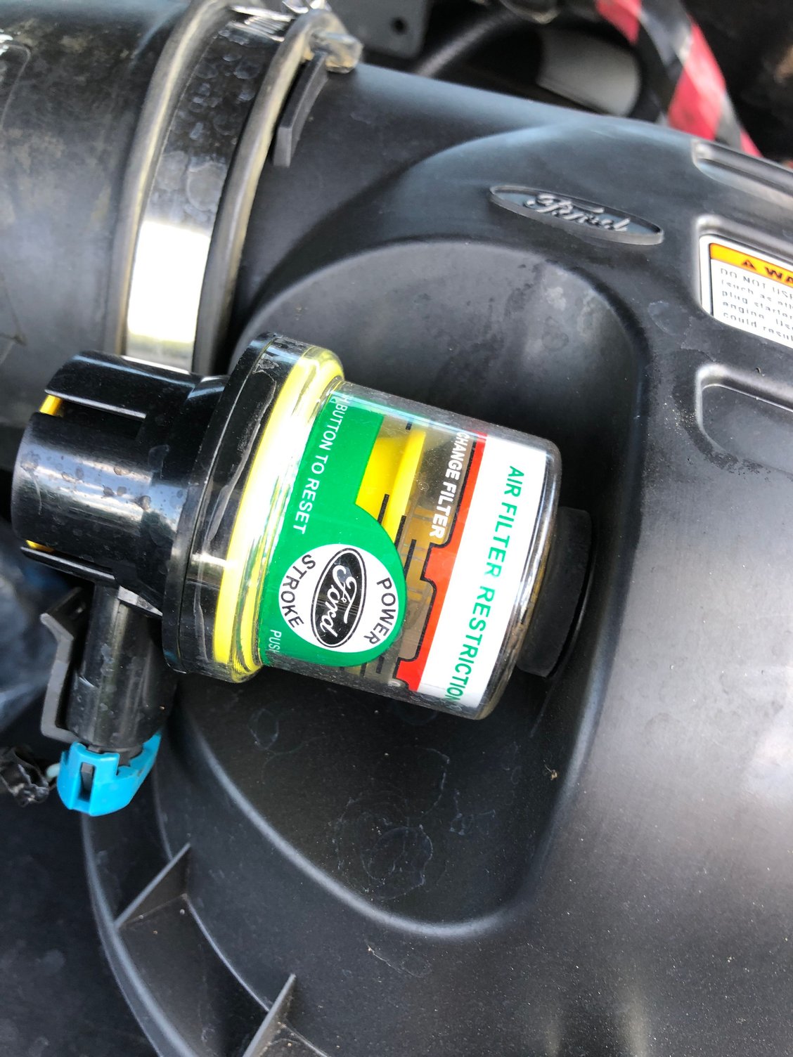

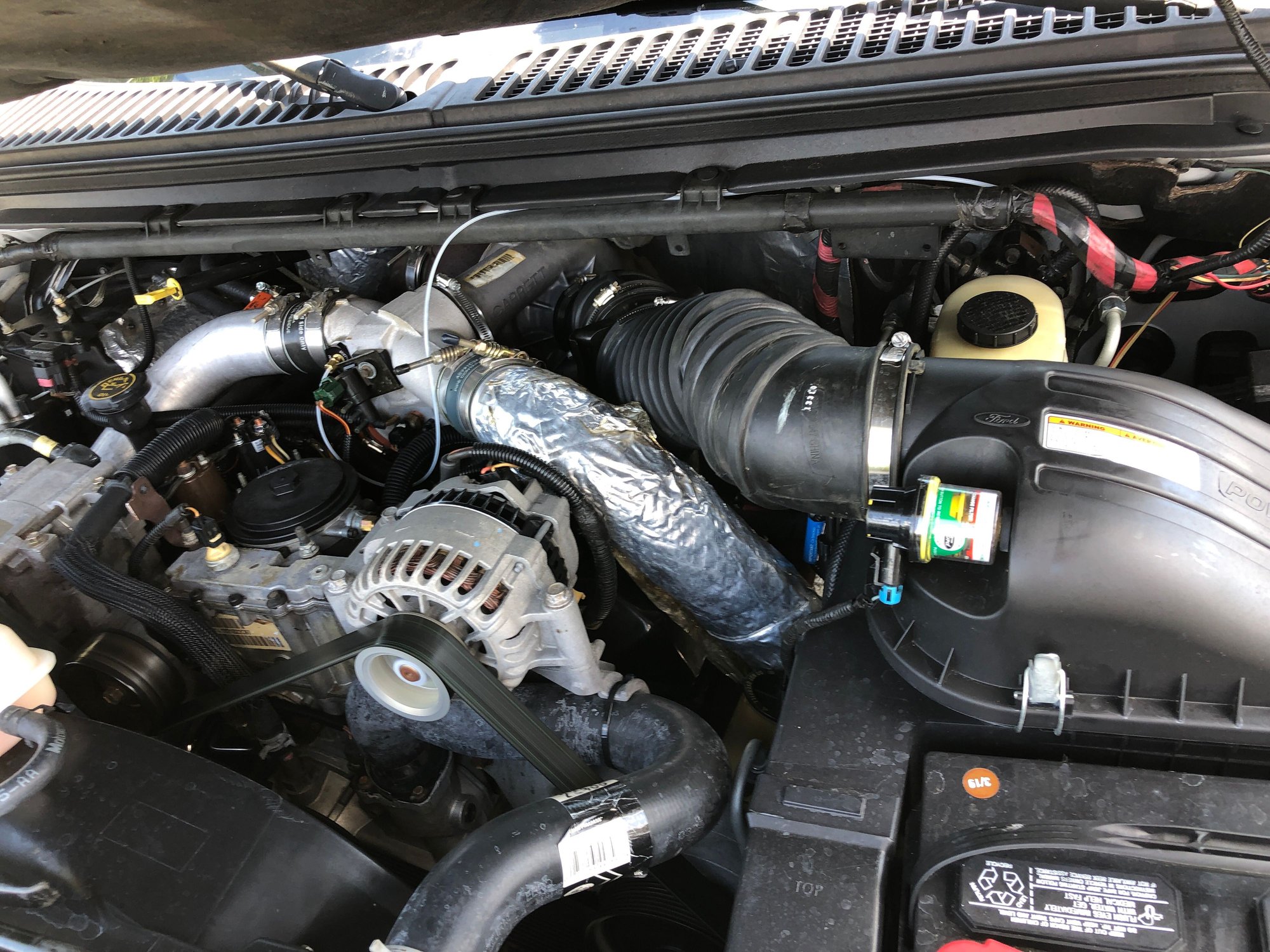

For what its worth,
this is an ais with ais monitor with about 10,000 miles on it, stock 2003 tunes and stock turbo, bellowed up pipes wastegate plugged and straight piped stock exhaust
What 23-24 psi does

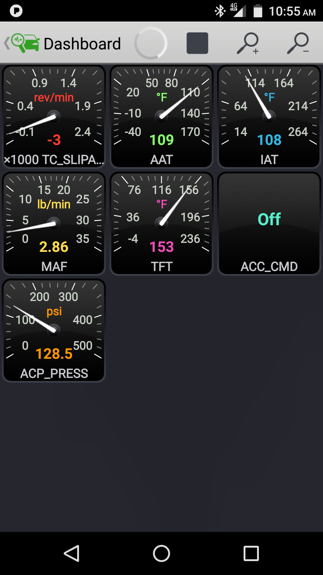

Monitor IAT temp with the sensor in the AIS. Then compare that to IAT when you have the sensor out of the box for 6637.
Yes good point. I’ve done this before but can’t remember the numbers. I know the AIS runs very close to ambient. And like folks have stated before I believe the 6637 was within about 10* of ambient once up to speed. I’ll doublecheck when the 6637 is back in.

100 degrees outside going down the highway. 6637
