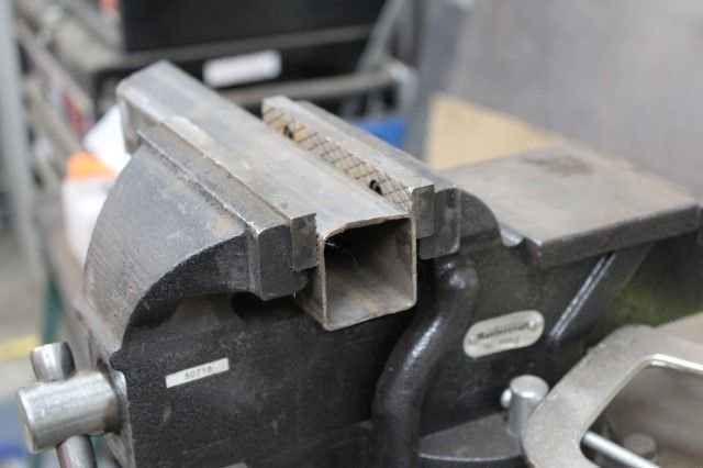

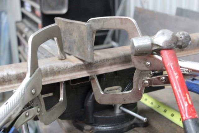

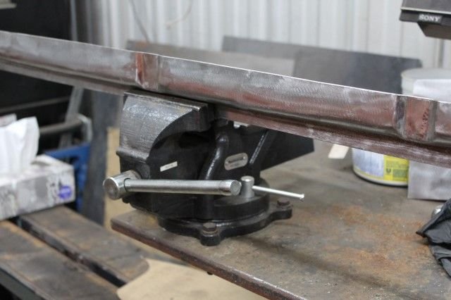

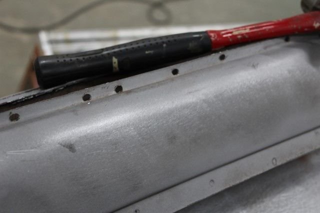

The back panel of the cab at the bottom between the 2 outer cab corners has a lot of pin holes so I formed a piece of 18 gauge that will replace the damage. I was trying to figure out how I was going to press the grooves to match the back. All I did was place a piece of 1 1/2" square tubing in the vise which was the widest point of the groove and a depth of 1/4" and use a piece of scrap steel and a hammer to simulate the groove and some hammer and dolly work.

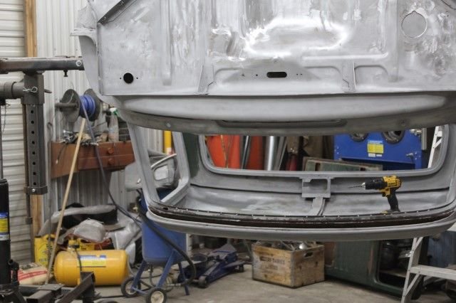

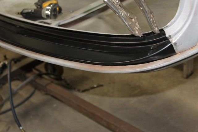

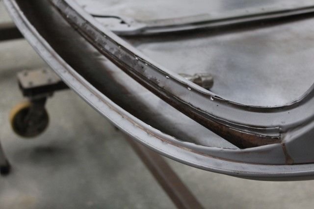

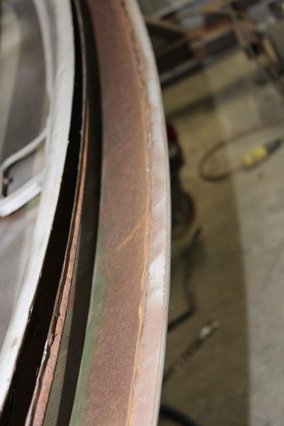

Last Friday I started to do some of the sandblasting on the cab be was far too hot out there in the sun so didn't get it finished
today I decided to start the repair of that rotted out roof brow
I wasn't completely sure what I was getting into so opened up a section to see how all the layers pieced together..
At first I left enough metal to weld to if I had decided to trim the patch panel. From the factory the under brow is spot welded to the drip rail
and I have no access to weld the new piece like it originally was. After digging in deeper I decided to remove it all and will use panel adhesive
where it attaches to the drip rail.
All these pics will appear upside down because I'm working off my rotisserie
cut out the biggest chunk to get a better view..
here's a few of the cut outs
Trimmed the metal flush to the underside of the drip rail , the rust wouldn't allow me to see clearly where the spot welds were so had to do some digging
then proceeded with the grinder to remove the rest..
Drilled out the spot welds where the window lip is.
and then started to separate the two header pieces
This is pretty much where I left off for today, still trimming out the spot welded metal, will be away for a couple days so won't be back to it until the end of the week.
That patch panel includes the window lip which is slightly different that the way the original pieces all fit together..

All fitted in and ready to weld in place after I sandblast what's under it or properly stated what's above it...
