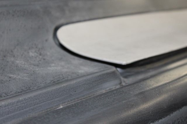

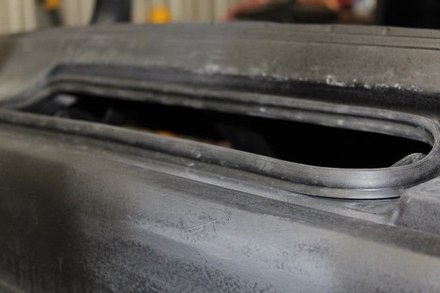

My intentions for this build was to keep it fairly stock looking but after reading through bjmayberry2's thread on cowl seal https://www.ford-trucks.com/forums/1...vent-seal.html
I went out and dry fit the seal on my cab
You'll notice I bought the top quality one
These damn things are not the easiest contraptions to install and can see where you'd have to be careful not to chip any paint
Not the greatest picture here but as hard as I pressed down I couldn't get the vent lid to lay flush with the rest of the cowl.

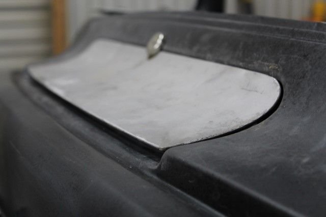

So the next step is to do what I did to the other builds and close it off completely
Cleaned up a spare vent , cut the underside screen off and will start welding tomorrow..
Hoping my decision to keep the vent windows isn't a fail either...lol

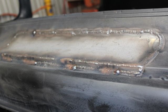

tack welded the lid in place and used a piece of 1/8" thick flat bar to fill in the front portion..
finished welding it in place and then cleaned up the welds

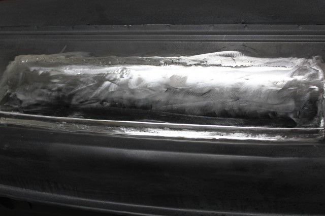

Then hid the mess with some body filler..
touched up a few divots and will spray again with some epoxy tomorrow..

Did you cut out the structure under the lid, or just weld the cap over it?
Old Apr 26, 2021 | 08:33 PM
  #203
56panelford's Avatar
56panelford
Posts: 281,873
Likes: 7,848
From: northwestern Ontario
I cut all the screen under it, the lid is a double layer of metal. I kept the one that came with the Mercury. The one I used the screen was damaged..If you're talking about the area that holds the rubber , it's still there..
