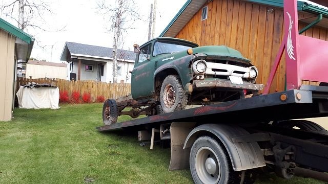

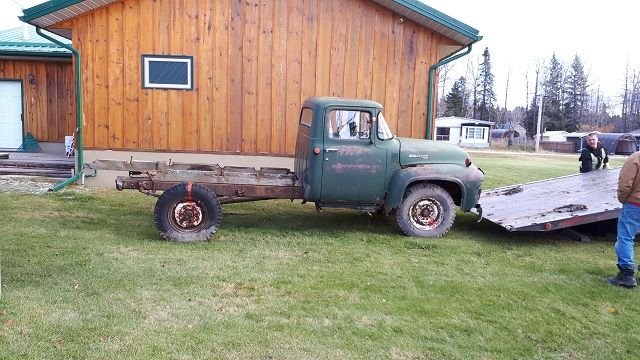

Last summer I inquired about this Mercury M350 that had sat in a field for approximately 40 years from what I was told and was given the go to take it at will. Last summer unfortunately was a very wet one and being a clay road leading to it made it impossible for me to get it until the fall. The truck had a very hard life by the looks of it and the pictures are proof of it..Here it is when it finally made it out to the main road thanks to a friend and waiting for the flat deck hauler..

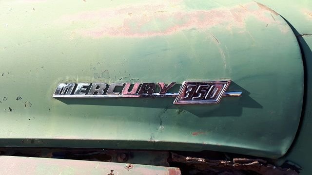

Side emblems are in fairly good shape, lettering on the nose piece are badly pitted and I'm missing the Letter C in case anyone feels sorry for me and has one please contact me..
It would appear to be a fairly basic base model with very little going for it..223 cu.in inline six, 3 speed heavy duty transmission and SRW rear axle with 5.14 to 1 ratio. It did have what looked like a home made flat bed on it made of wood which was removed where it sat. Wood was so rotten it crumbled in your hands..
The day it arrived was the 20th of October 2019
The rear wheels were locked up and wouldn't roll and surprised the tires held air..
This is where it sat all winter

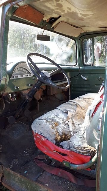

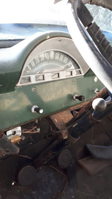

Now for a glimpse of the interior..lol
this truck actually had seat belts..

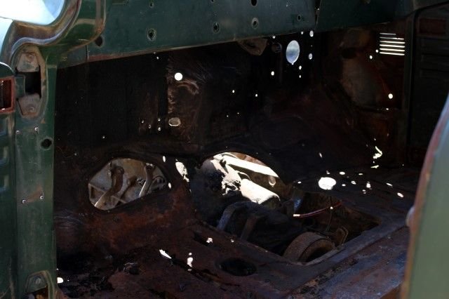

This spring after it warmed up enough I started removing everything from inside the cab
cardboard headliner.

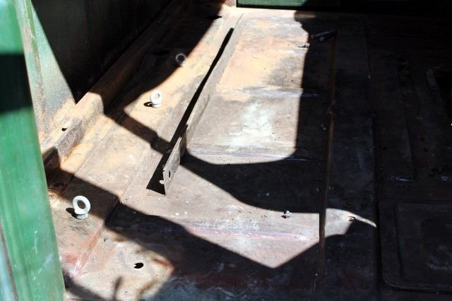

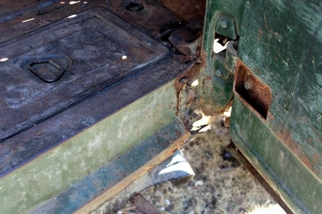

Seat and tank were removed then swept out, rear floor section appears that it can be saved but requires patching above the rear cab mounts,
needs rear inner cab corners and a front left side quarter section of floor. Passenger side under the cab mount needs some small patches as well..

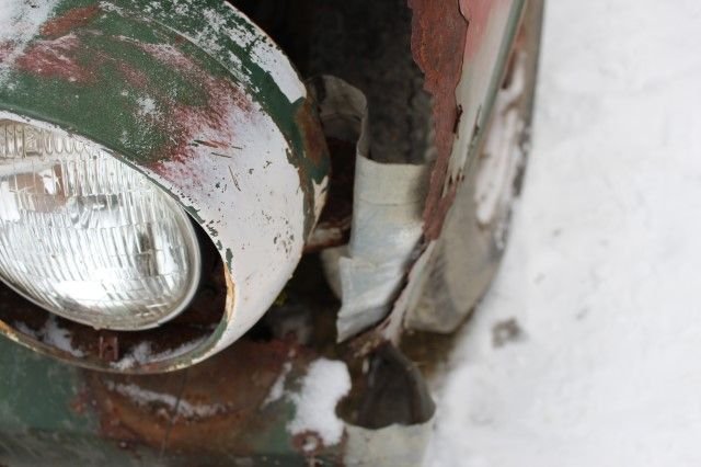

Now the front sheet metal or what was left of it was removed and taken to the dump..
Most of it was secured together with baling wire, tin plate and sheet metal screws..

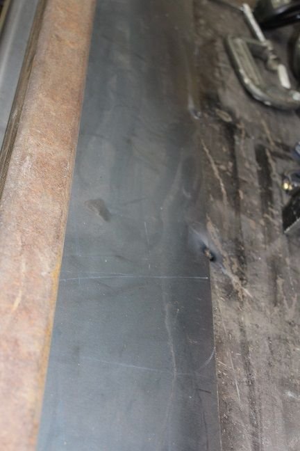

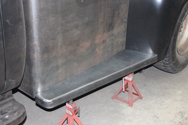

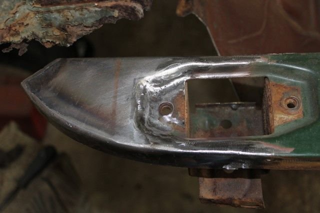

One of the last things I needed to do was make the short running boards for the front section of the box .

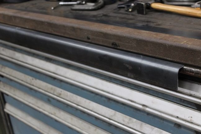

I wanted a soft edge towards the outside of the boards and came up with two failed plans until I just decided
to beat it with a dead blow hammer . I temporarily welded a steering shaft that's 3/4 " in diameter to the front edge
of my work bench then clamped a length of heavy wall square tubing close to the edge and placed a few tack welds
to hold the sheet steel firmly to the work bench , then slowly beat the overlap until it was 90°

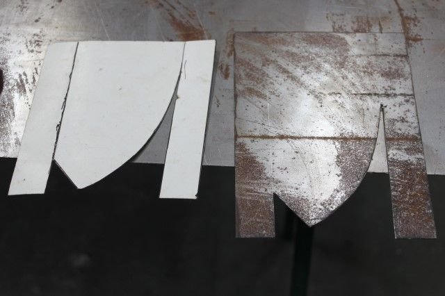

Then with the cardboard pattern I had made I marked and made my cut ..
I had left enough metal to wrap around the front edge to finish it off and using hammer and dolly I softened the edges
of both surfaces before welding
completed the welds and ground to match the bent edge..
Set in place but not quite finished and only have the piece welded in place where the board attaches to the fender,
will finish this one next time out in the shop then start the right side..

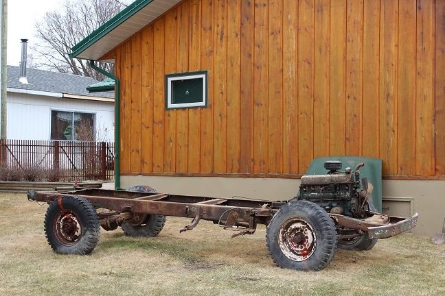

Motor is all there but missing the rotor from the distributor, oil in it is remarkably clean, it is seized up but put an inspection camera in each cylinder and no sign of rust so I did put about 2 ounces of transmission fluid in each cylinder last fall but haven't tried to see if it is free . I'll take the ring gear cover off one day and see if I can get it to move. No plans on using it or any of the drive train for that matter..

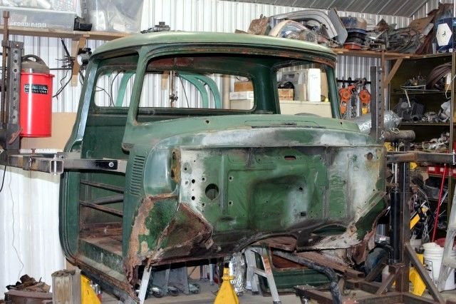

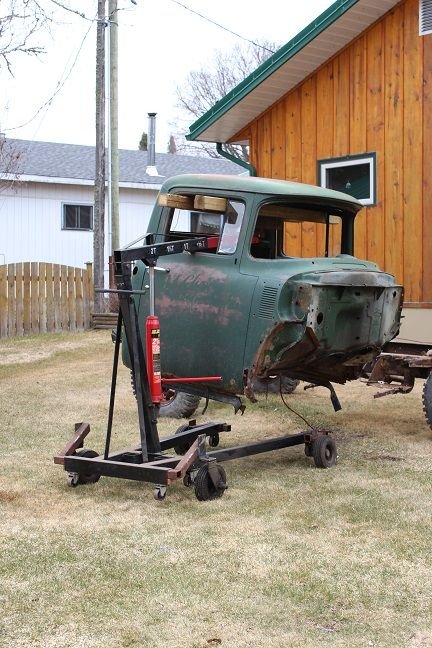

A couple weeks ago I removed the cab from the frame and brought it in my shop..

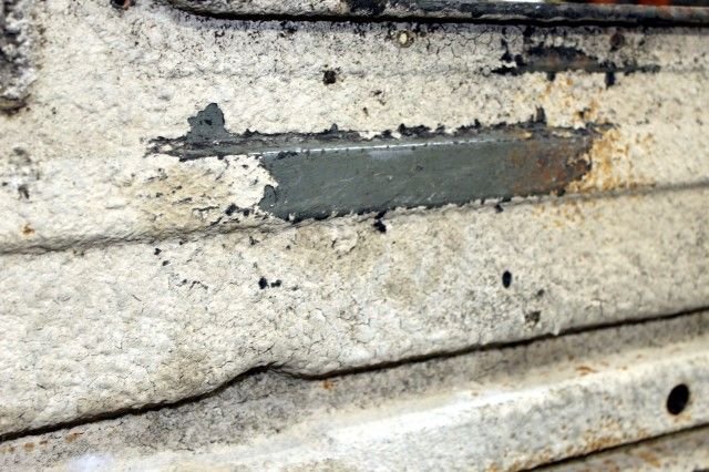

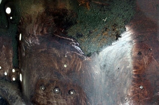

I gapped the doors and braced the cab before putting it on my rotisserie then started to scrape off all the under coating and sound deadening
material from both inside and outside..
I was then left with a rolling chassis that later was moved to the back fence line, I'll get to it once the work to the cab is done

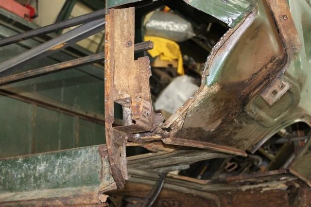

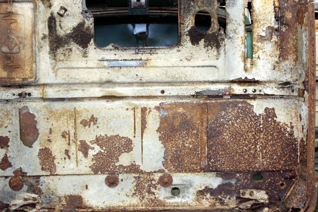

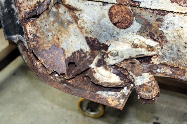

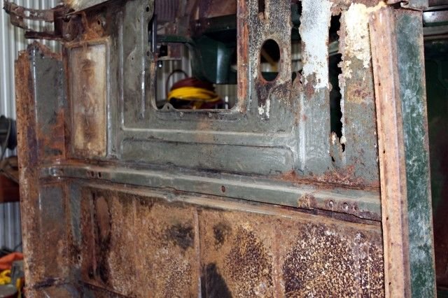

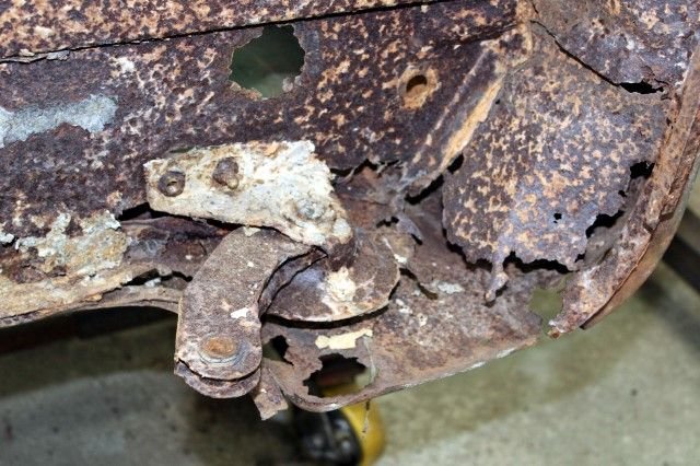

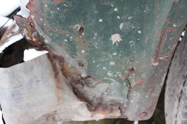

All four corners are rotten
Plan is to fix the the small sections of floor under the front cab mount and lower door post. Replace the front quarter section on the left side and a section of the toe board ( left side )
Then I'll remove the complete floor and do the repairs to the back section and replace the inner cab corners , rockers and outer corners all the way round..

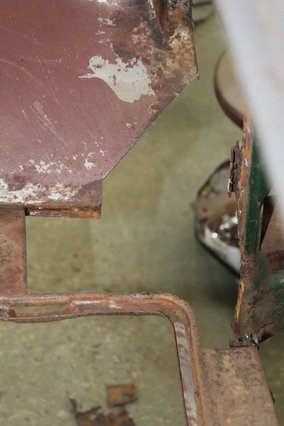

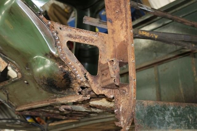

Yesterday I cut out the small sections needing replaced under the right front cab mount.
Made those patches.
Today I made the lower section of the door post and welded that in and can now weld the floor patches in and replace the cab brace and inner cab mount bracket..
then onto the other side..

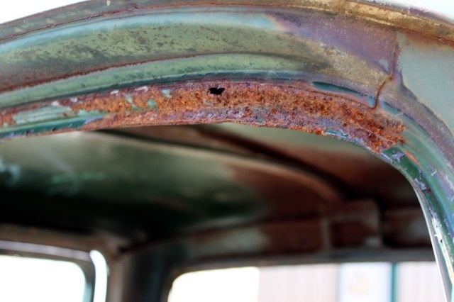

I'll know more once I get the sandblaster out, there is a hole in the window frame I discovered when I pulled the glass..
