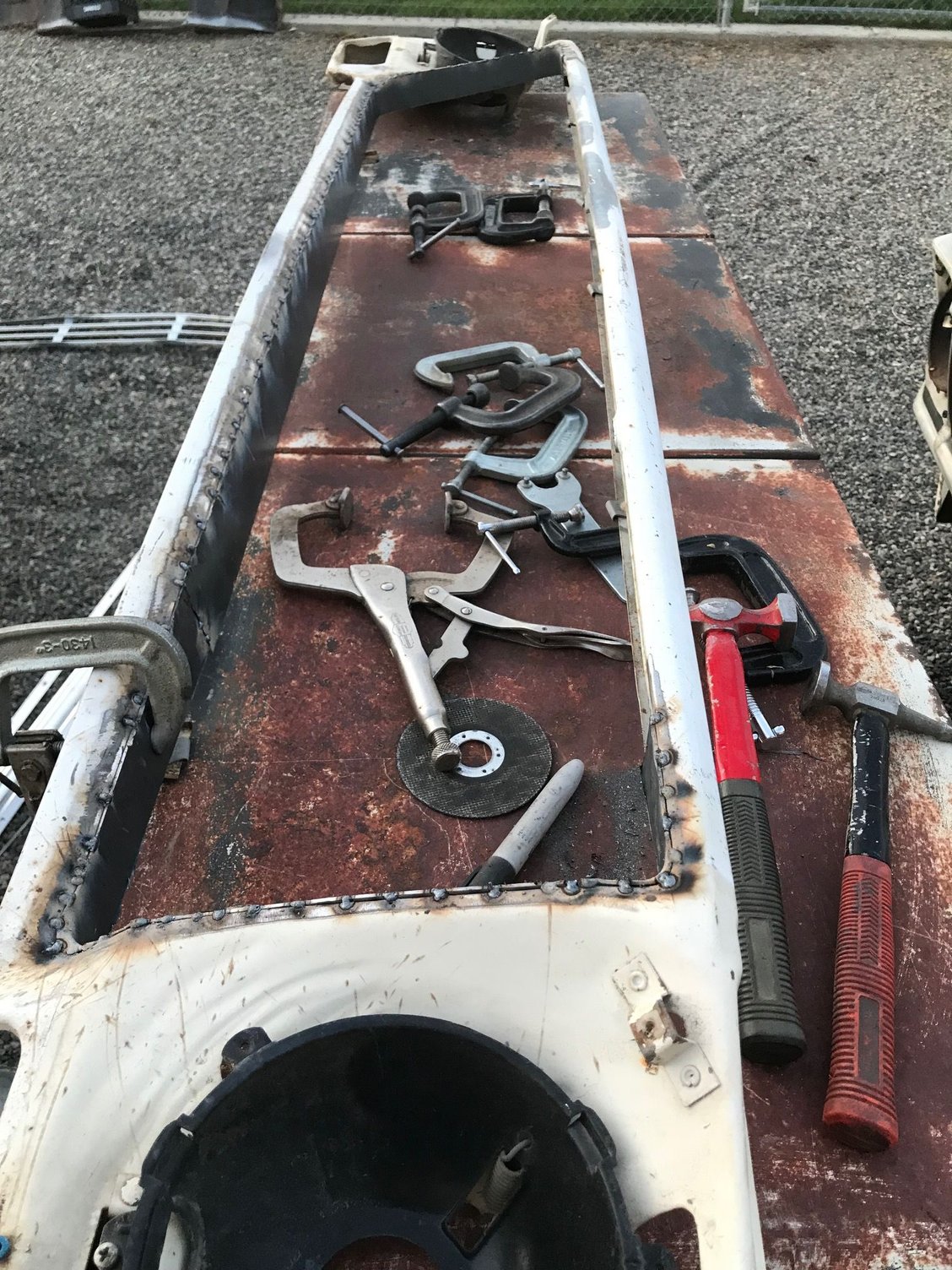

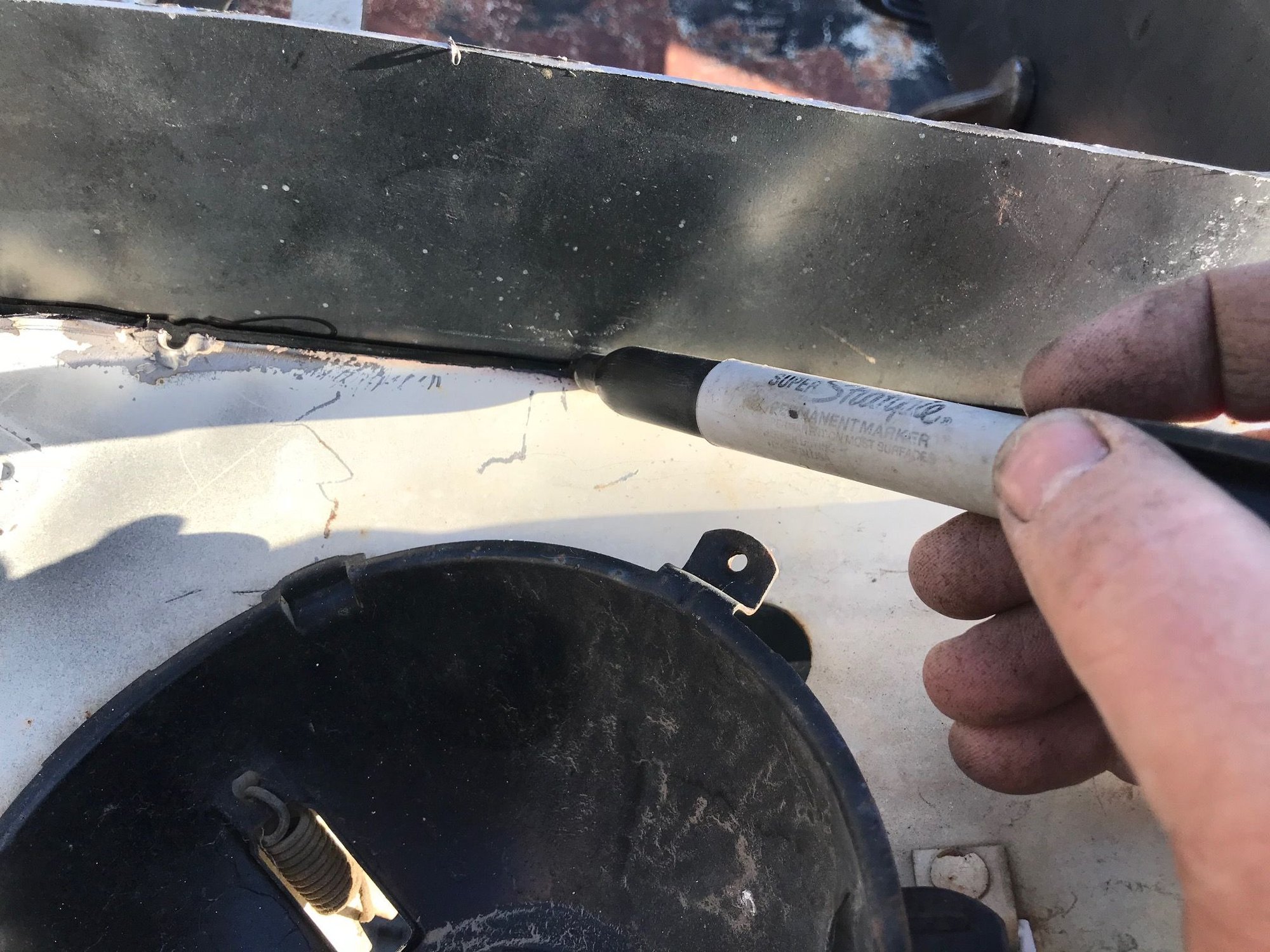

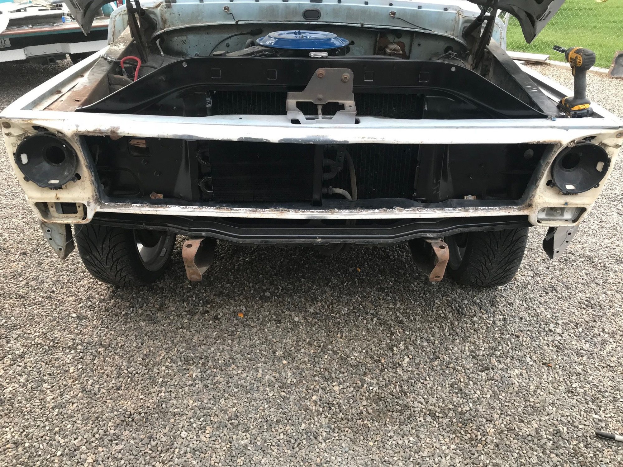

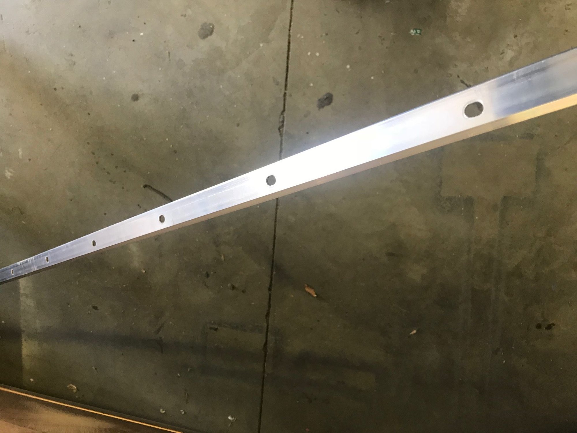

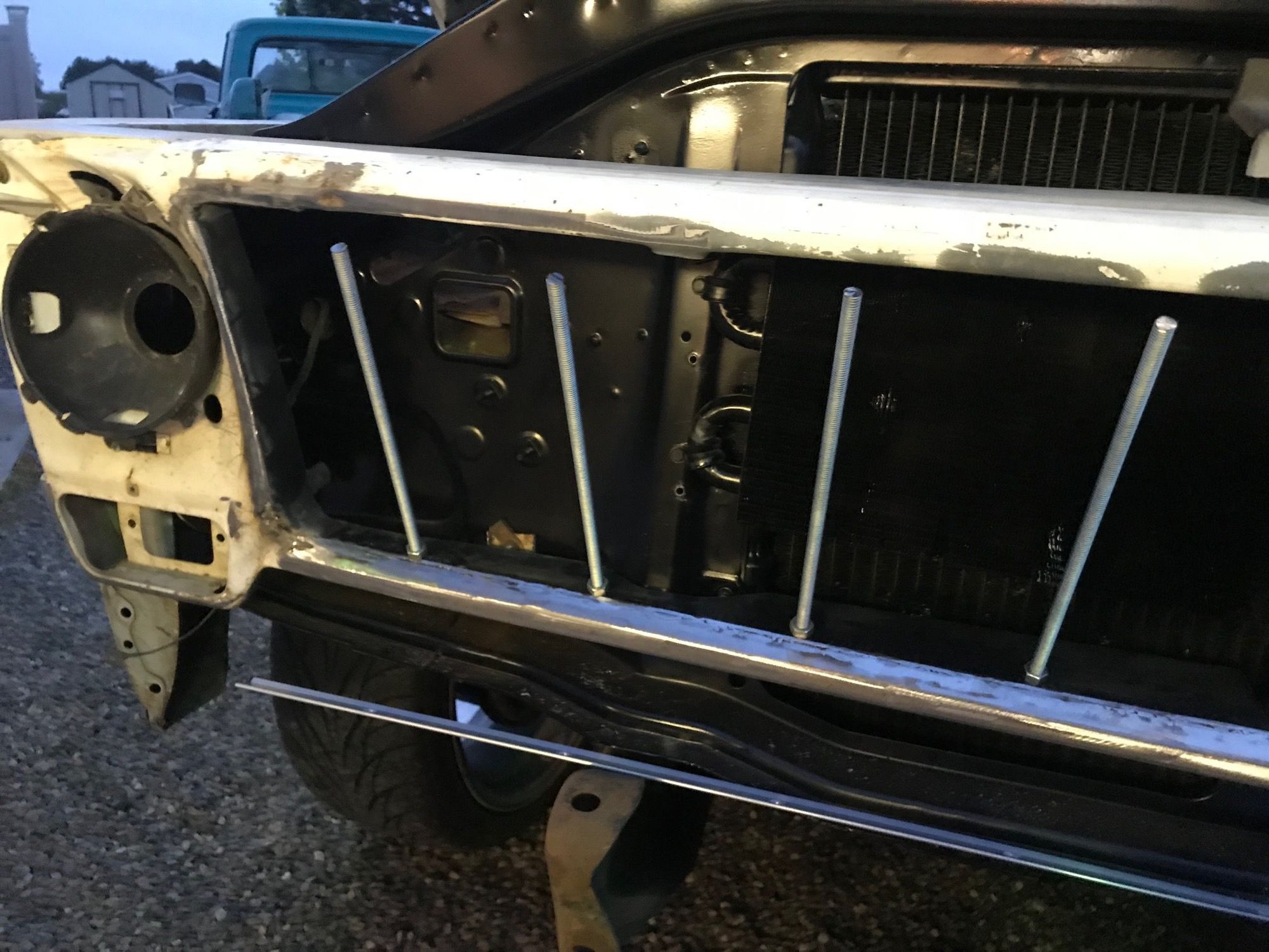

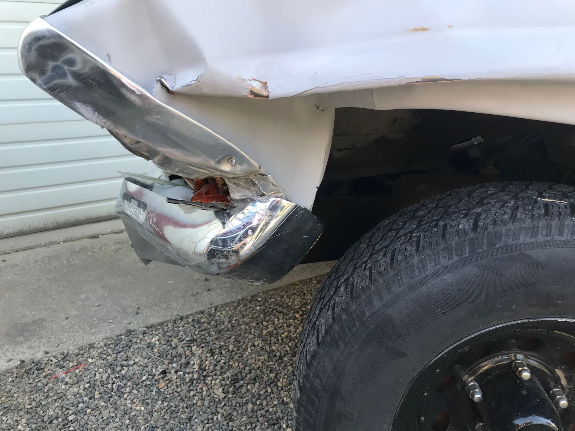

Been a long time but I picked up another truck so I had to come see what everyone has been up to and share... It's a 1969 F100 that I had seen on Craigslist but then it got hit by a drunk driver when it was just parked. The guy knew that I liked these trucks and had my contact info so he offered it to me at a price I couldn't pass up... So I ended up with another one that I wasn't looking for... I have all the parts to fix it so I brought it home and started replacing the damaged panels. But the only grill I have is a steel grill that had damage and had been repaired poorly. So that prompted me to try something I've been thinking about for awhile and that is a custom grill.

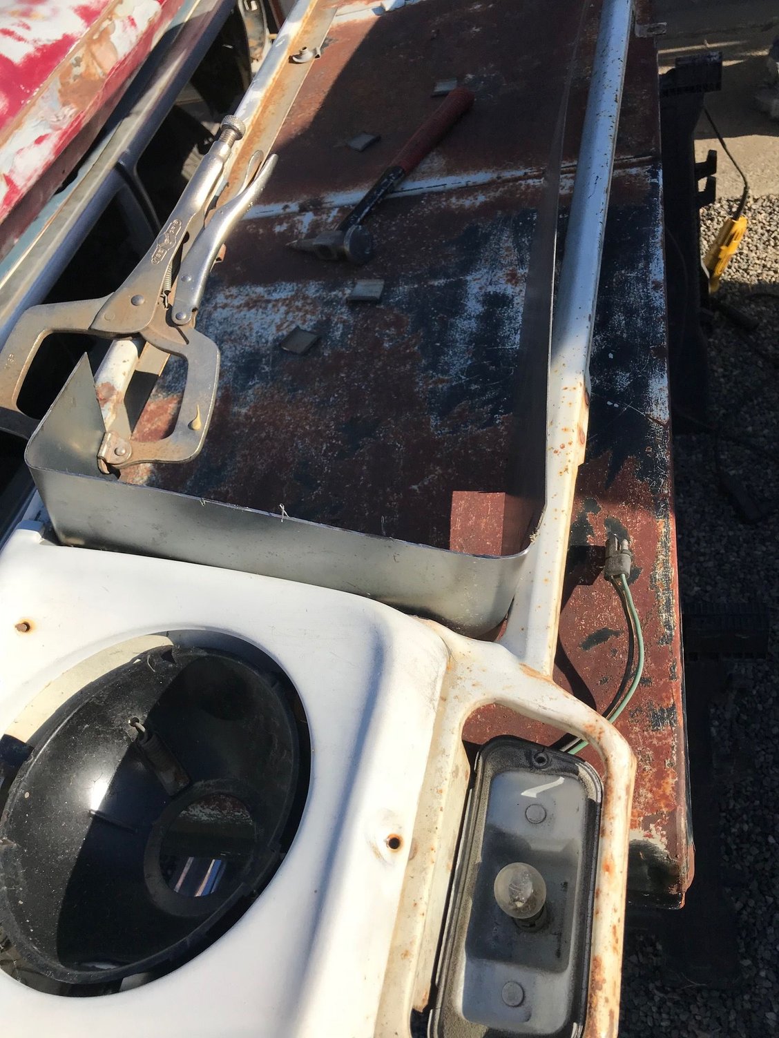

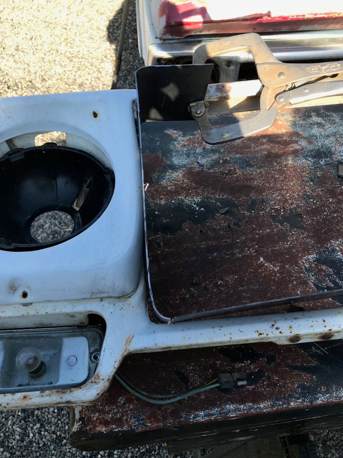

I got to work cutting out the center section and cutting a panel to go around the inside.

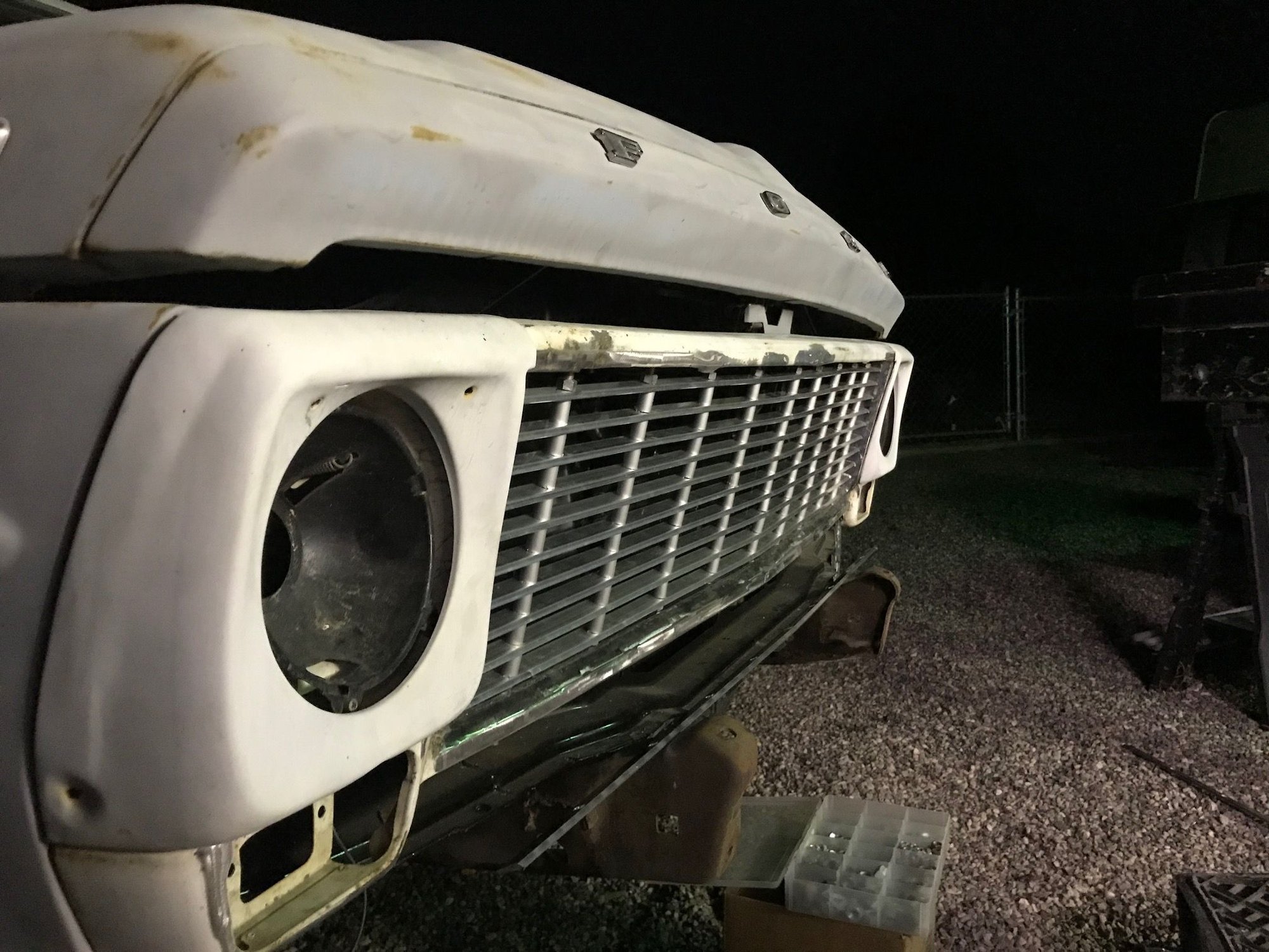

After test fitting and trimming to fit. I then drilled holes and cut some 3/8" threaded rod and dropped them into the grill. I also cut some pre-molded aluminum strips and some aluminum rod for spacers and started sliding them onto the rods.

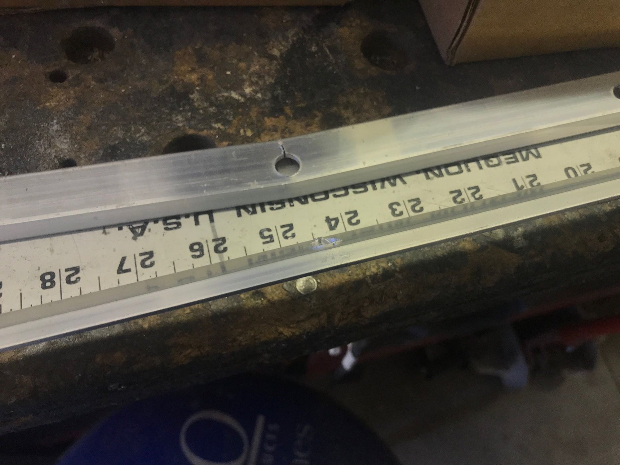

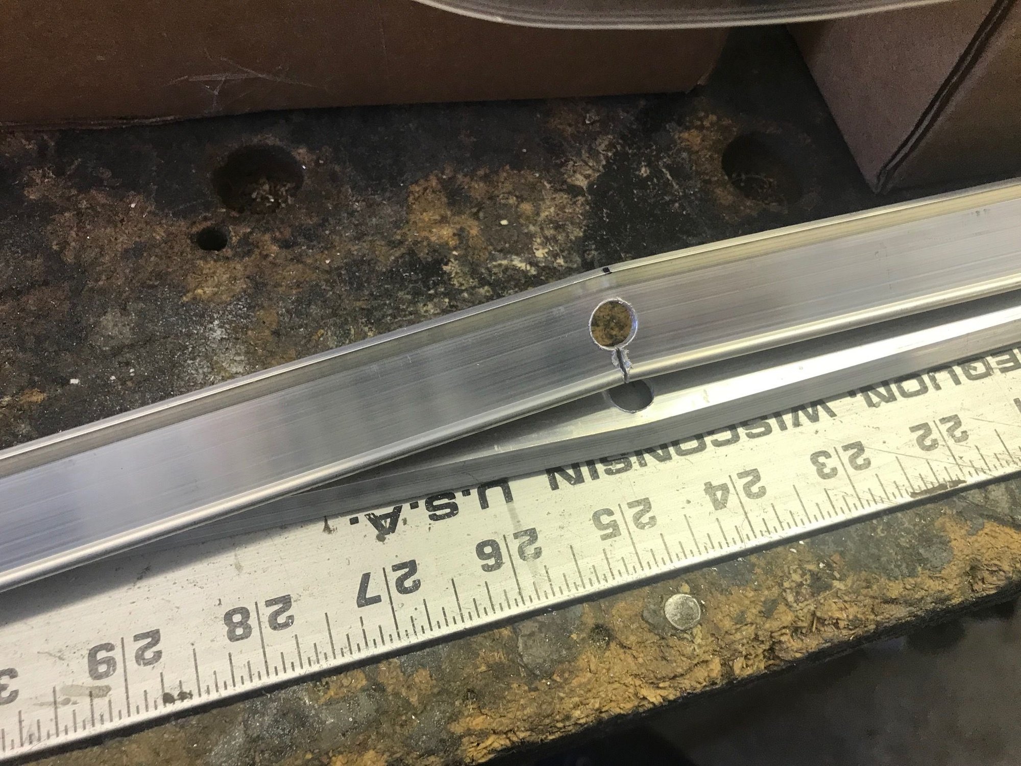

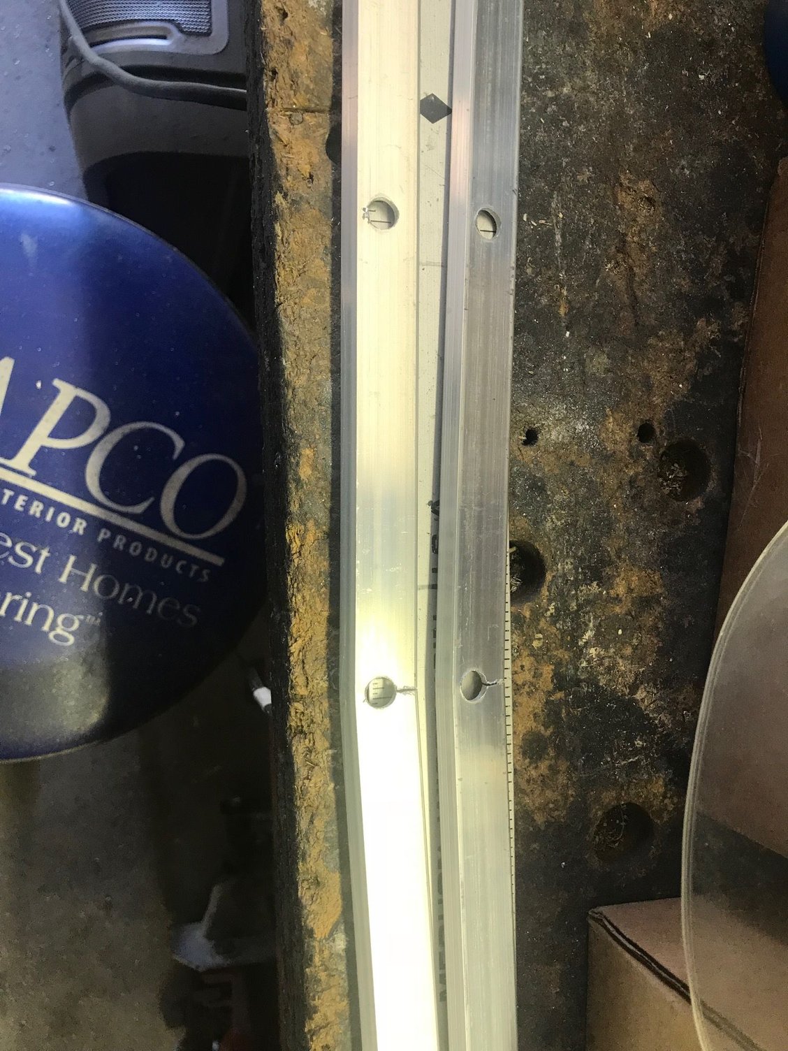

Also I gave the aluminum strips a little bend so they have a bit of a point and follow the slope back of the grill. Continued cutting spacers and strips and adding them on until it filled up the space.
So now that it's mocked up I need to pull it all back apart and finish body working the shell and clean up all of my cuts on the aluminum. Polish the aluminum strips and then paint the shell the body color. Oh I probably will customize the headlight buckets a little as well but a lot still to do before I start on them.

Thank you, I'm with you there I'm pretty picky when it comes to custom grills so I'm hoping I can pull this off. I did cheat when it came to the holes... The aluminum strips came with pre-punched holes so all I had to do was drill them a bit larger to fit the 3/8" rod . Then one little relief cut in the center was all it needed to then bend it to match the grill profile.

I was going to ask about the bow in the aluminum slats, but I see in the pictures how that was done. Very cleaver.

As for expense you might be surprised I've only spent about $90 for supplies. The Aluminum strips are a roofing product we sell at work (GAF Termination Bar with lip 10 LF) We sell it for $7.29 a stick (I got it for cost) but even still you make 2 strips per 10' and so far I only needed 5 of 10' strips to make the insert (I bought extra as I wasn't sure how many would be needed) Threaded rod was $14 for 12 LF and the 1/2" Aluminum tube was $10.68 for 3' at Lowes, I bought 3, so another $32. (I'm sure you could find that cheaper but the metal supply was closed) So over all that doesn't seem too bad.

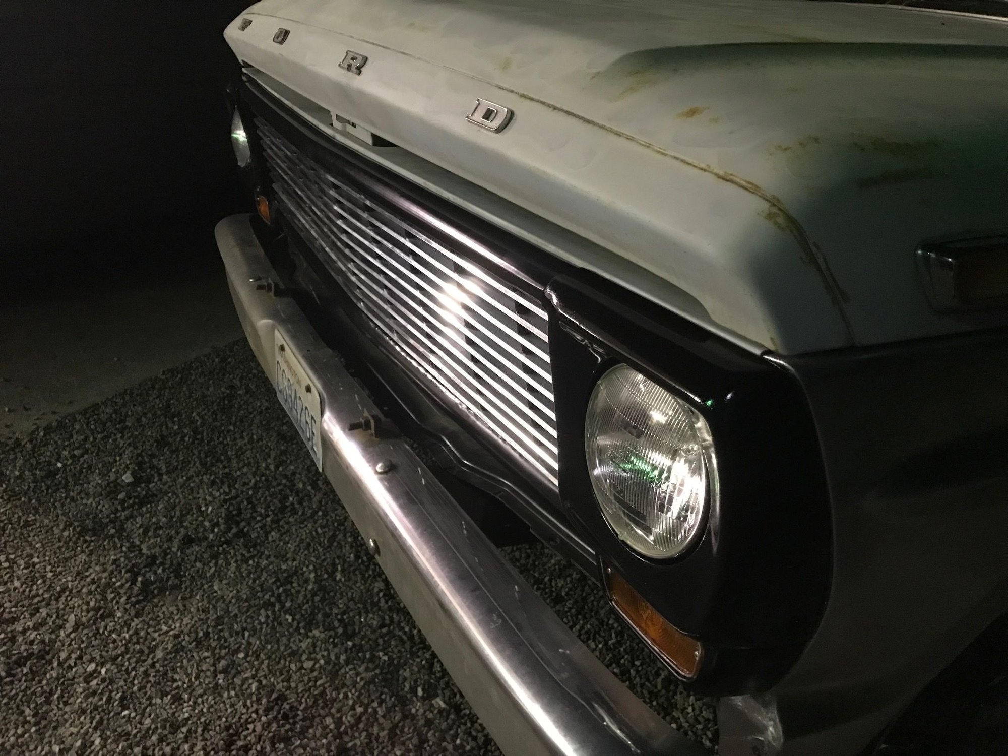

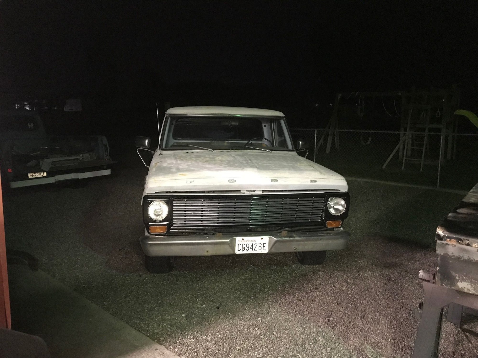

ok guys here is the nearly completed custom grill for my 69 F100. I still need to make some more spacers for the top of the grill (I don't like the threaded rod showing at the top) and I need to pull the bumper and gravel guard off my parts truck clean them up and bolt them onto this truck. The plan is to paint the truck Satin Black or Matt Black and the grill shell will be painted to match so this gives you an idea of what I'm going for.
Thanks for checking it out.
