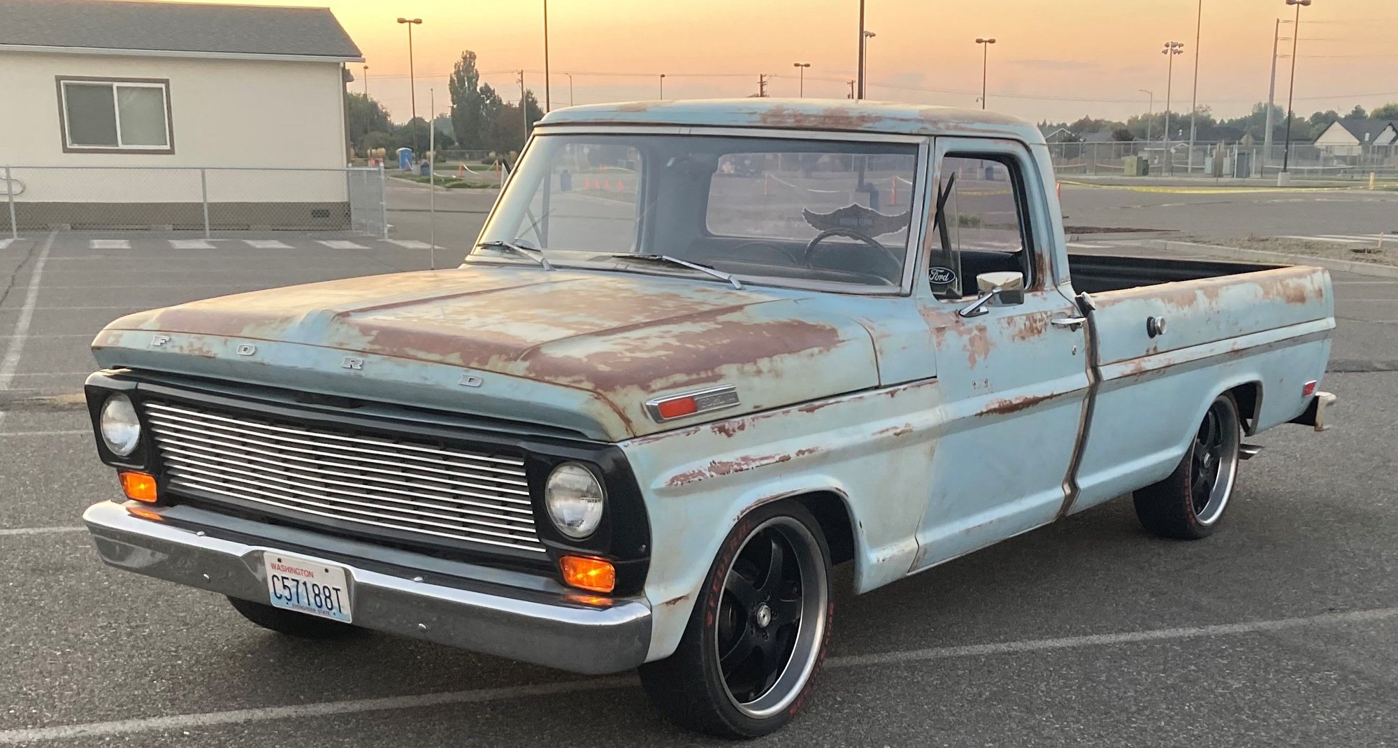

Yeah it will be unique with the grill painted body color but if I can pull off the patina paint on it as well I think it will look great. The center aluminum strips will stay polished and will tie in with all of the other chrome and polished parts. I think it should all go together nicely...
Here is a older picture of the custom grill again so just imagine it light blue and blending in more with the body. Also note the fender paint has been reworked and looks a lot better now then it did in this picture.

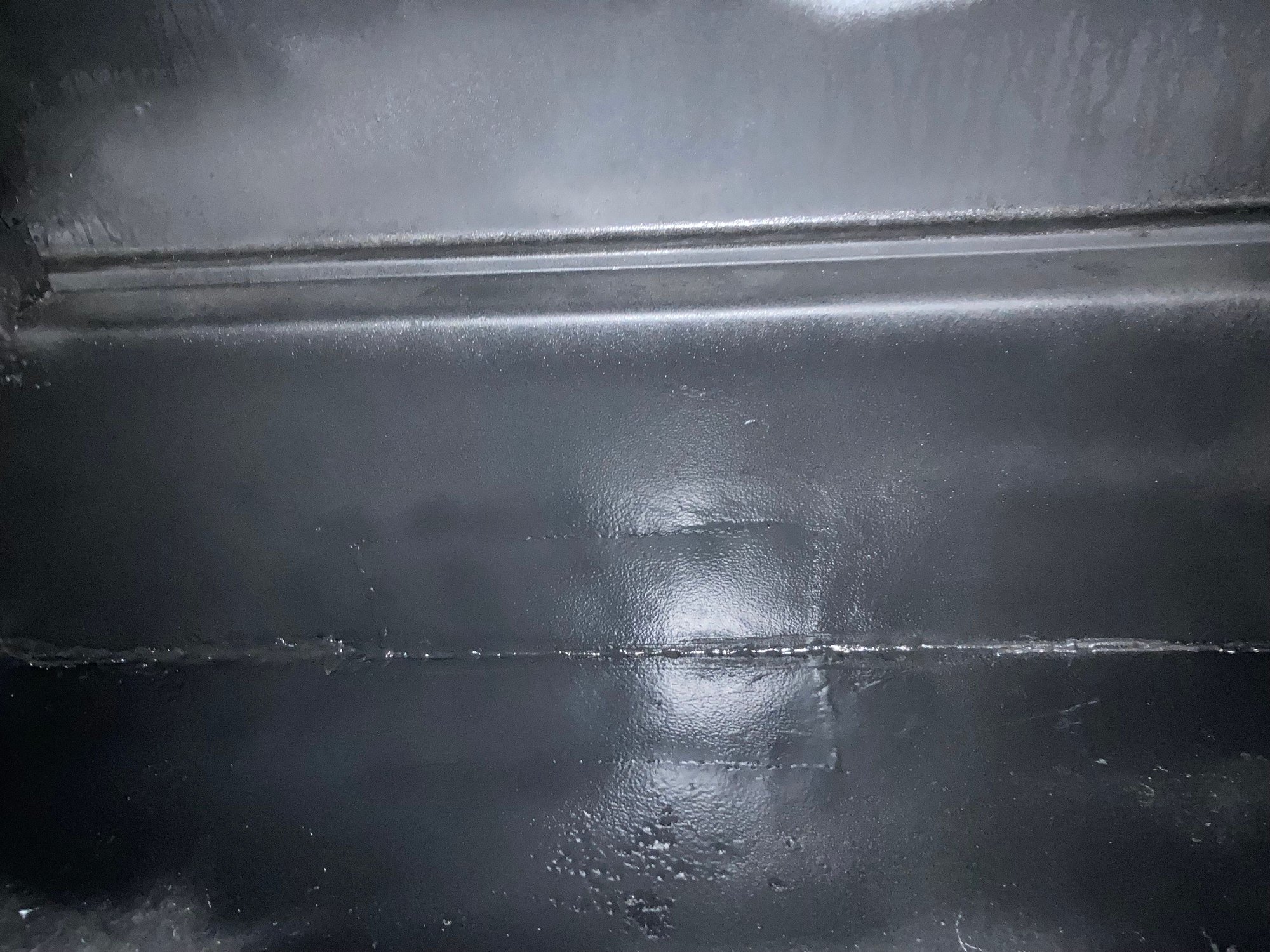

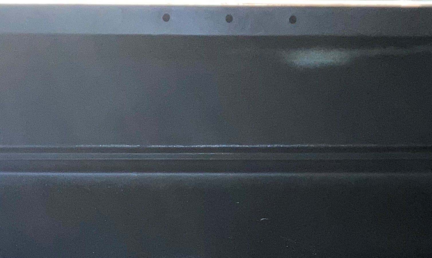

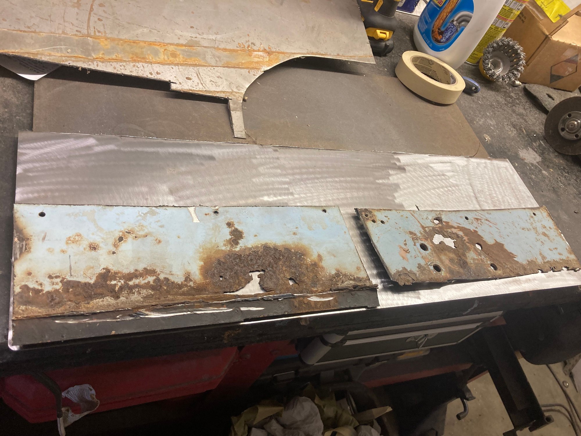

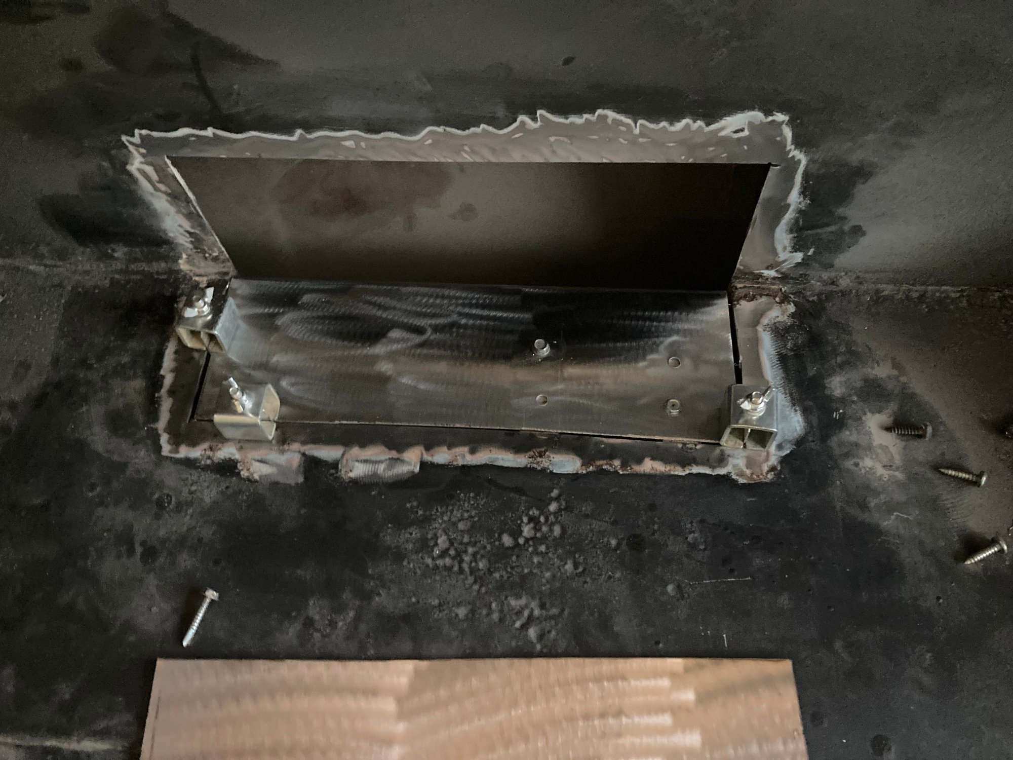

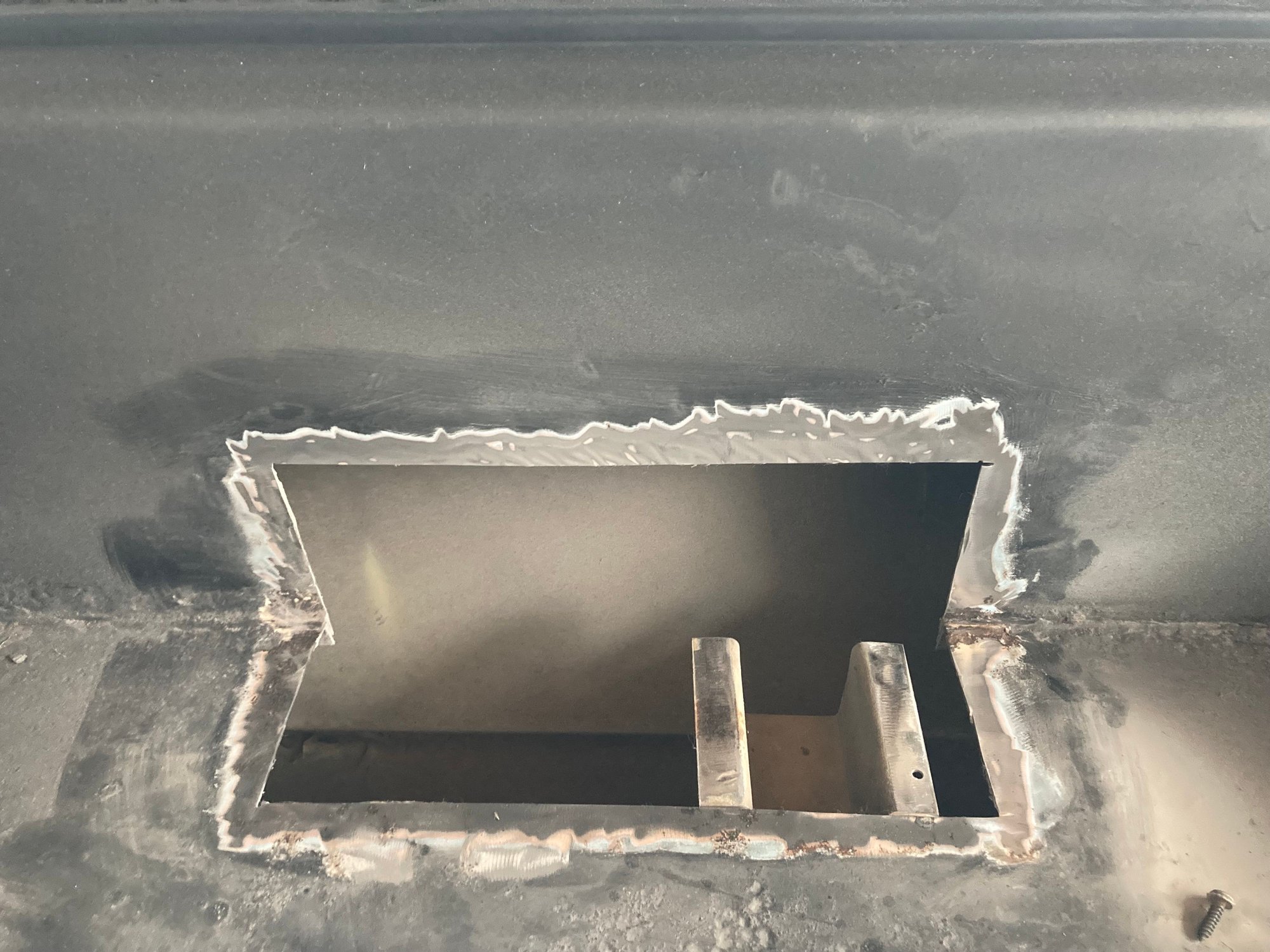

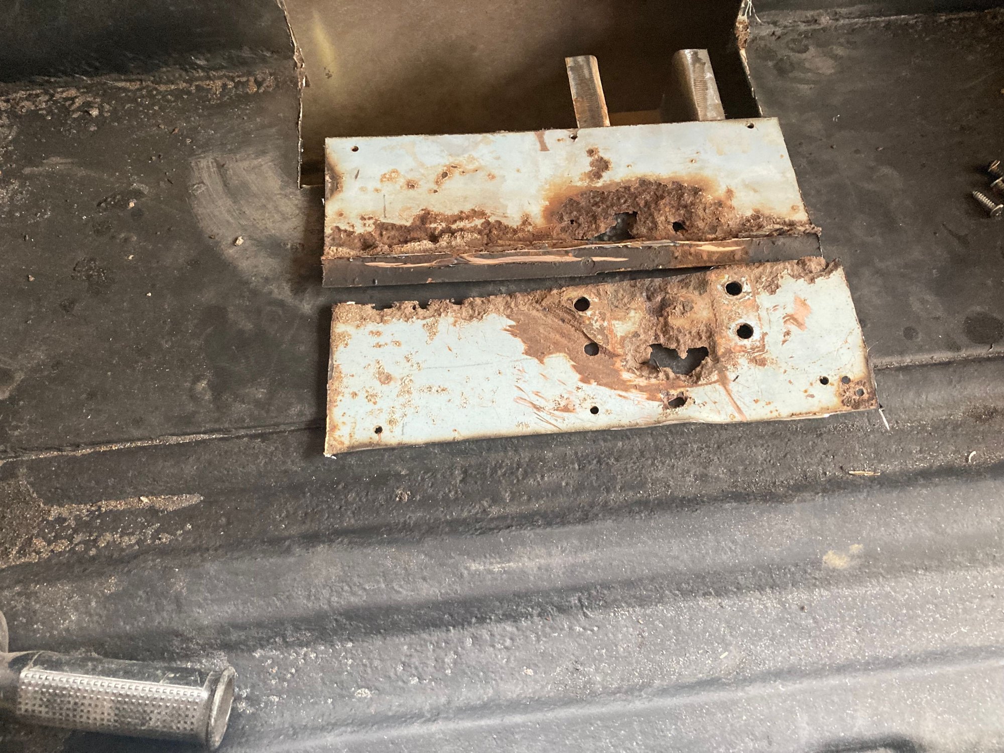

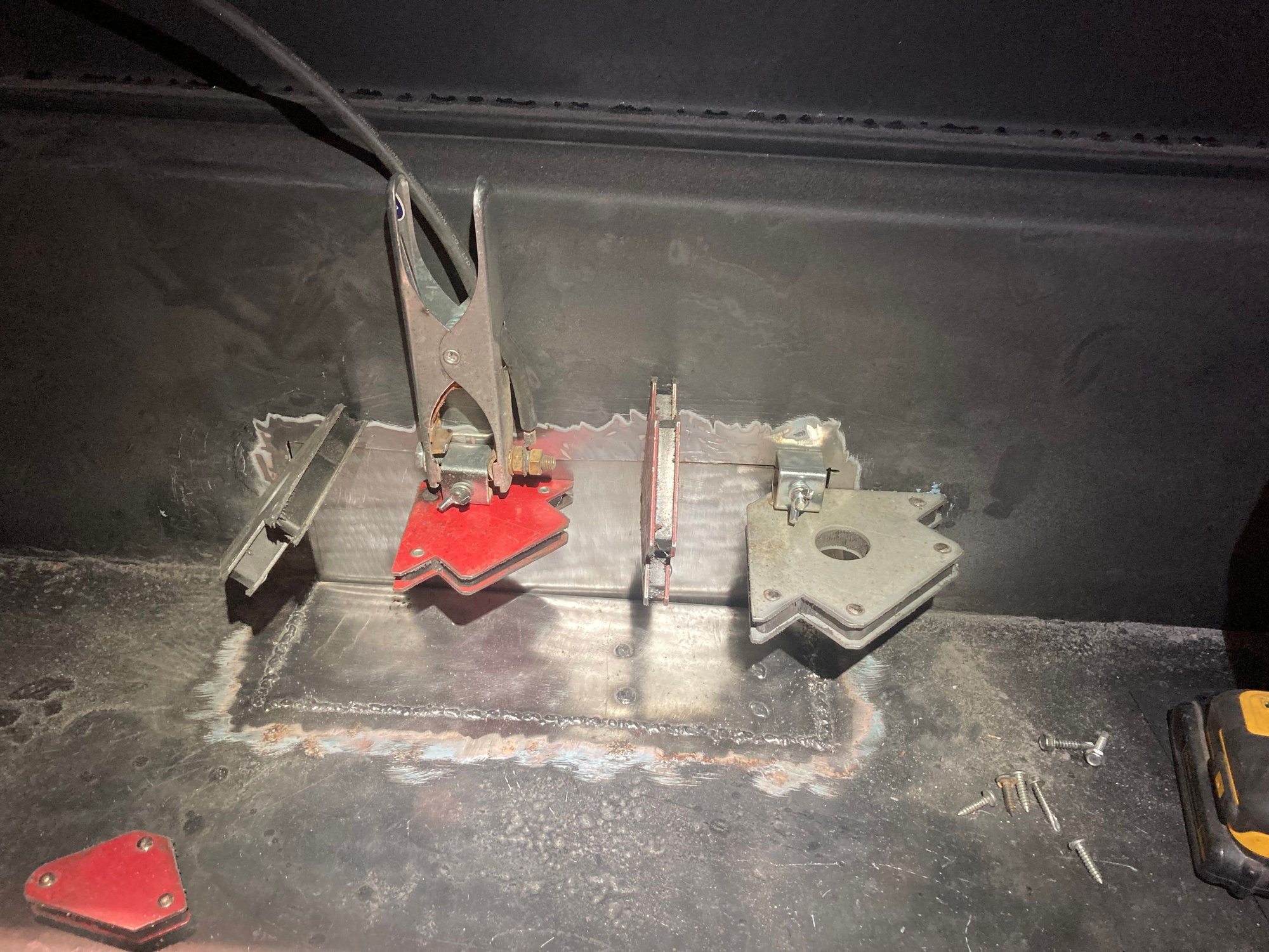

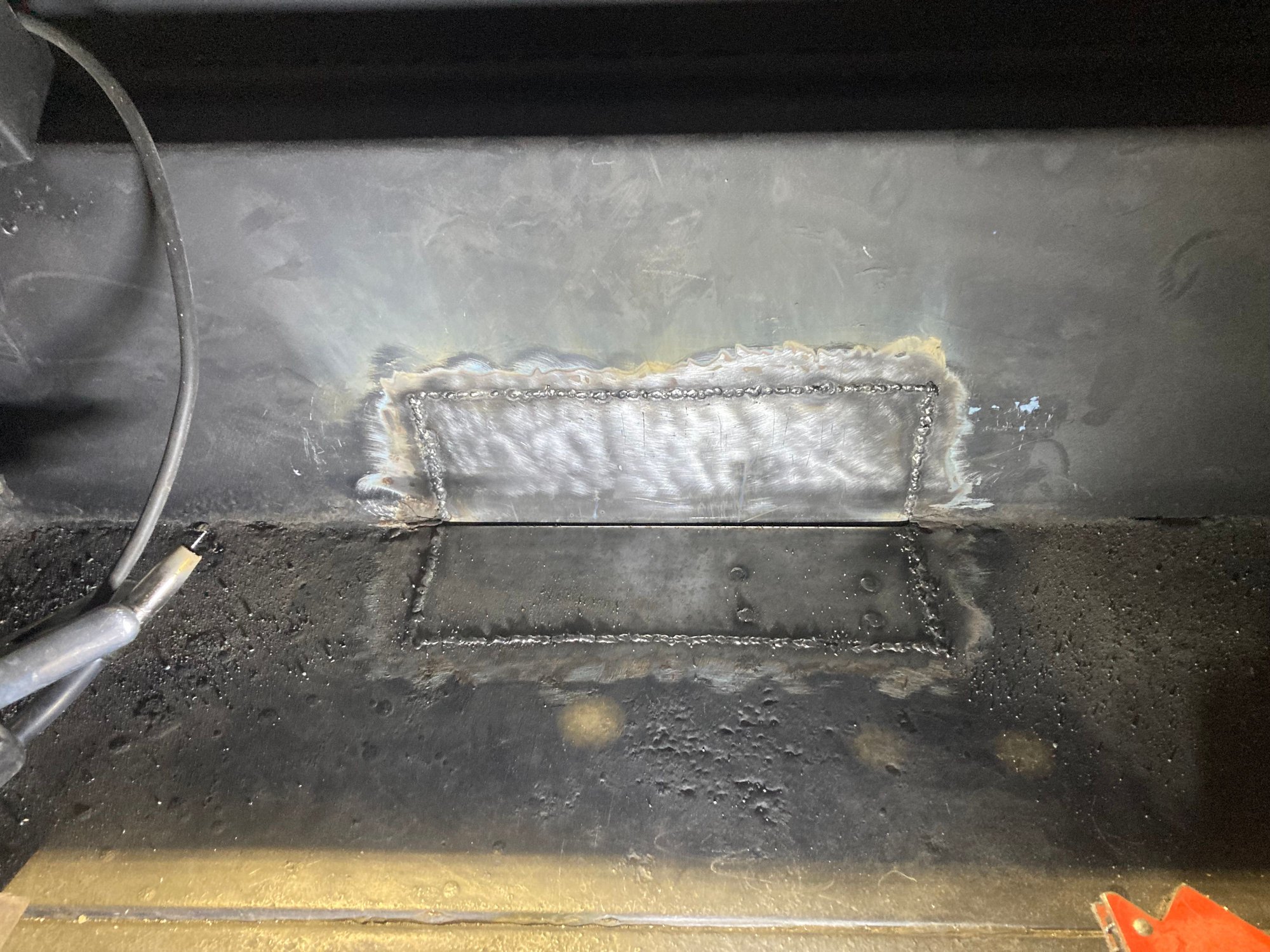

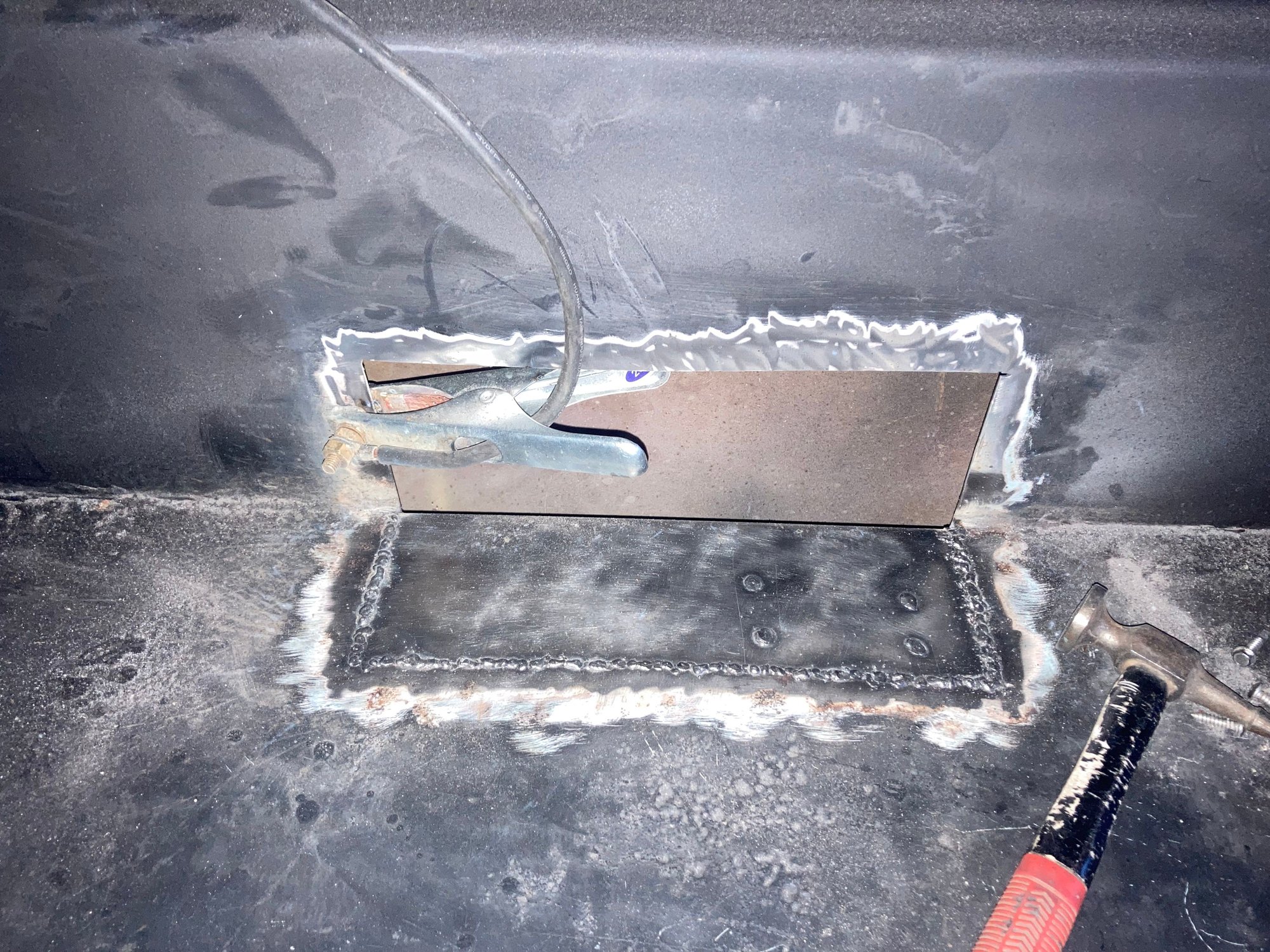

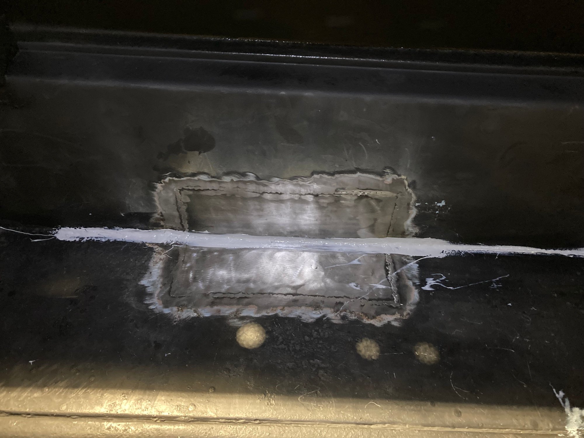

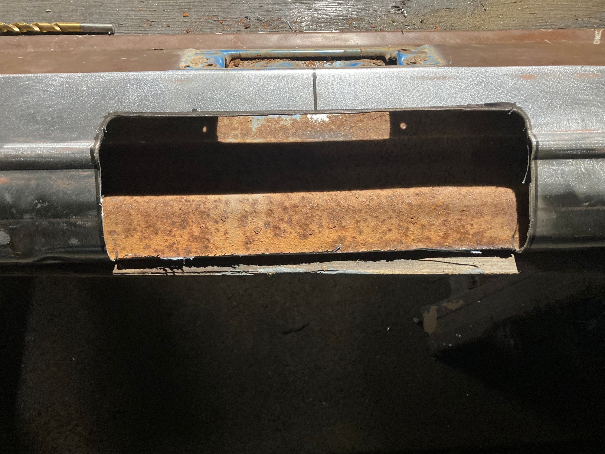

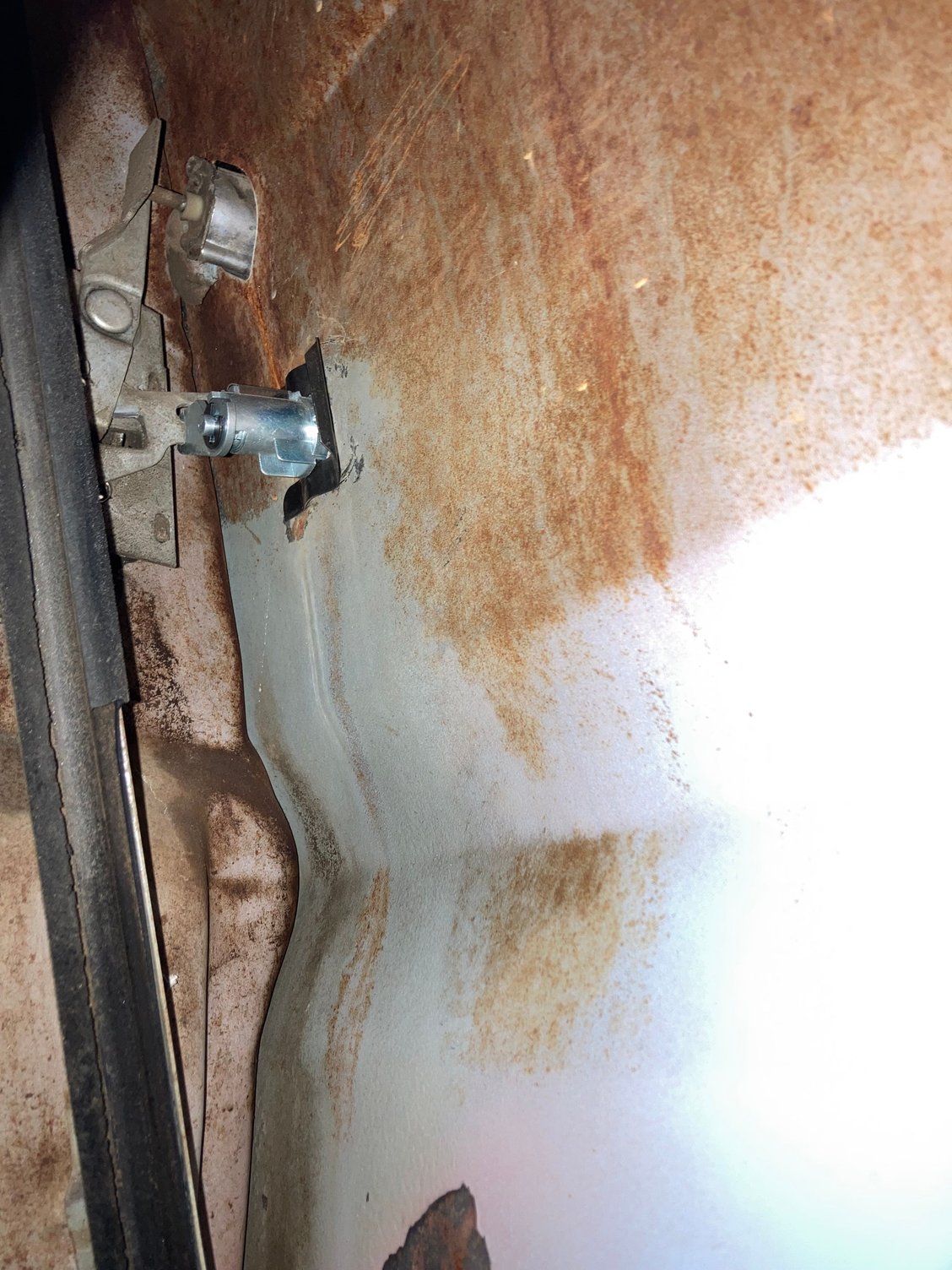

Getting ready to spray in a bed liner but there was a steel angle plate bolted in on the passenger side that must have been part of a home made or aftermarket spare tire holder. There were extra holes in the top bed rail and in the plate so something was attached at some point but all that was left was the angle plate and that held dirt and moisture against the bed floor and wall and rotted it out. So I got to work cutting out the rust and making a patch.
These holes were directly above the angle plate on the side of the bed rail...
put a 90 degree bend on the bottom patch to match the floor and predrilled some holes to plug weld.
Put in some new seam sealer and then sprayed on a quick coat of paint to protect the new metal.
It's not pretty but it's not rotten anymore and the new bed-liner coating should be thick enough to help blend it in a little more.

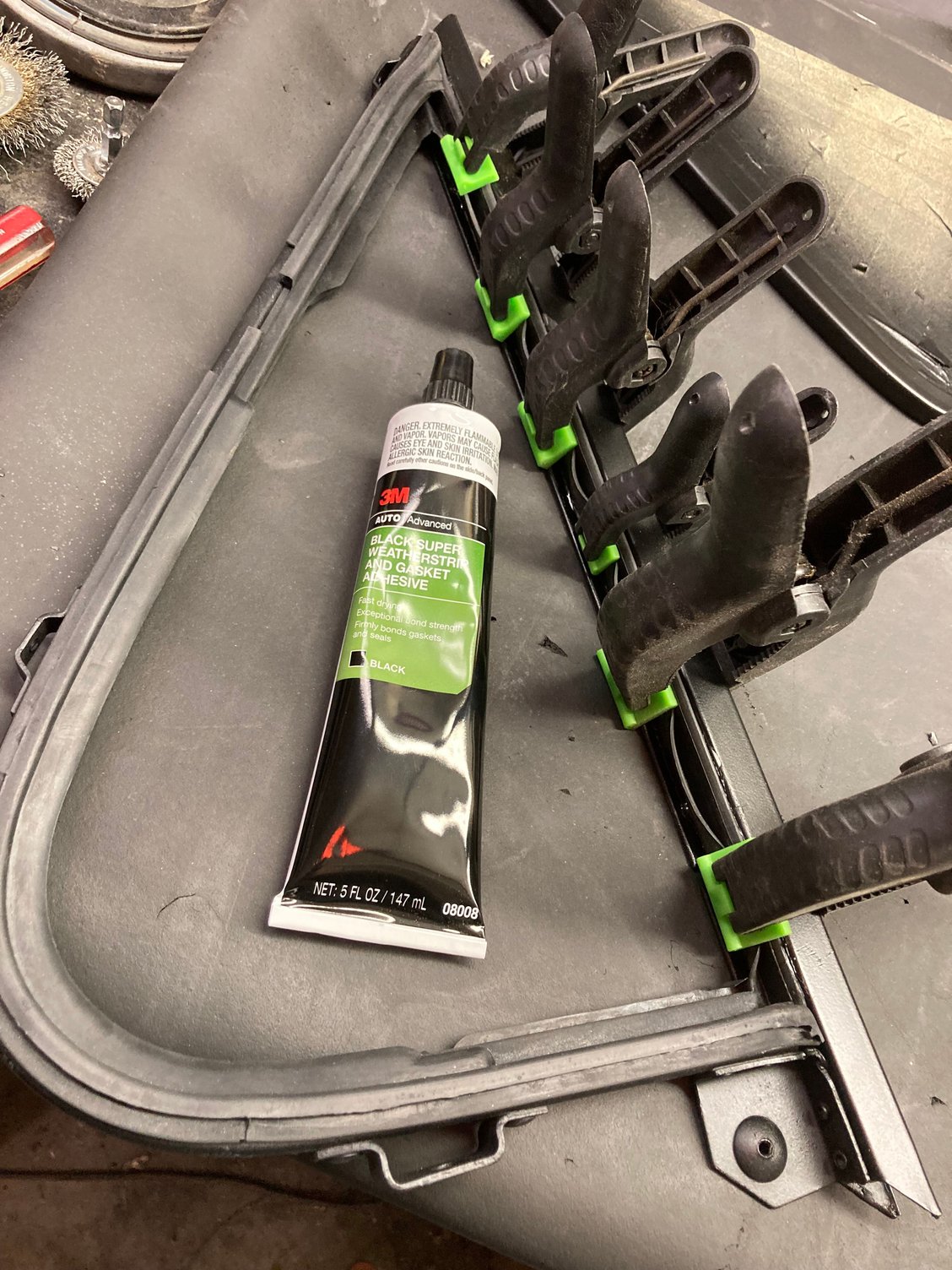

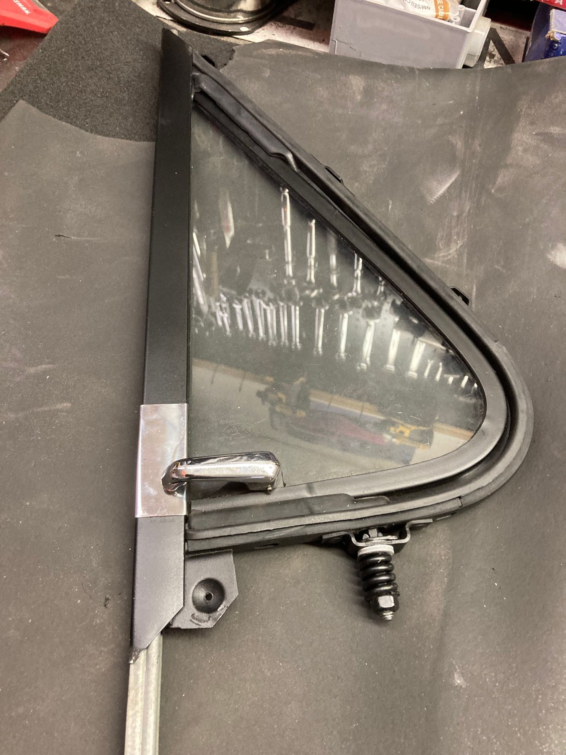

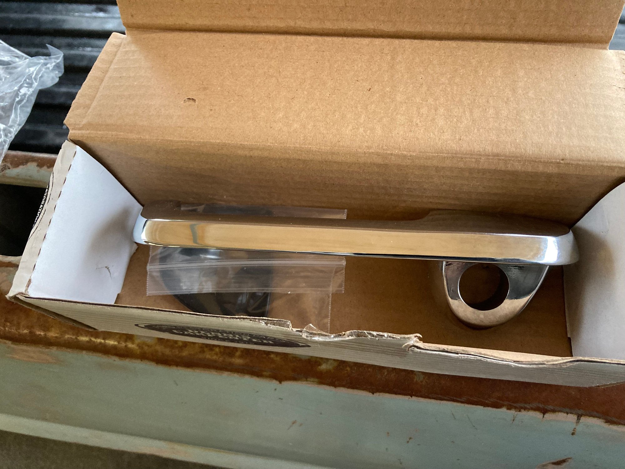

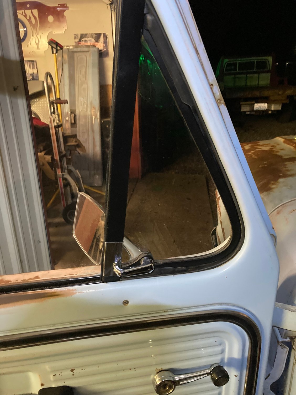

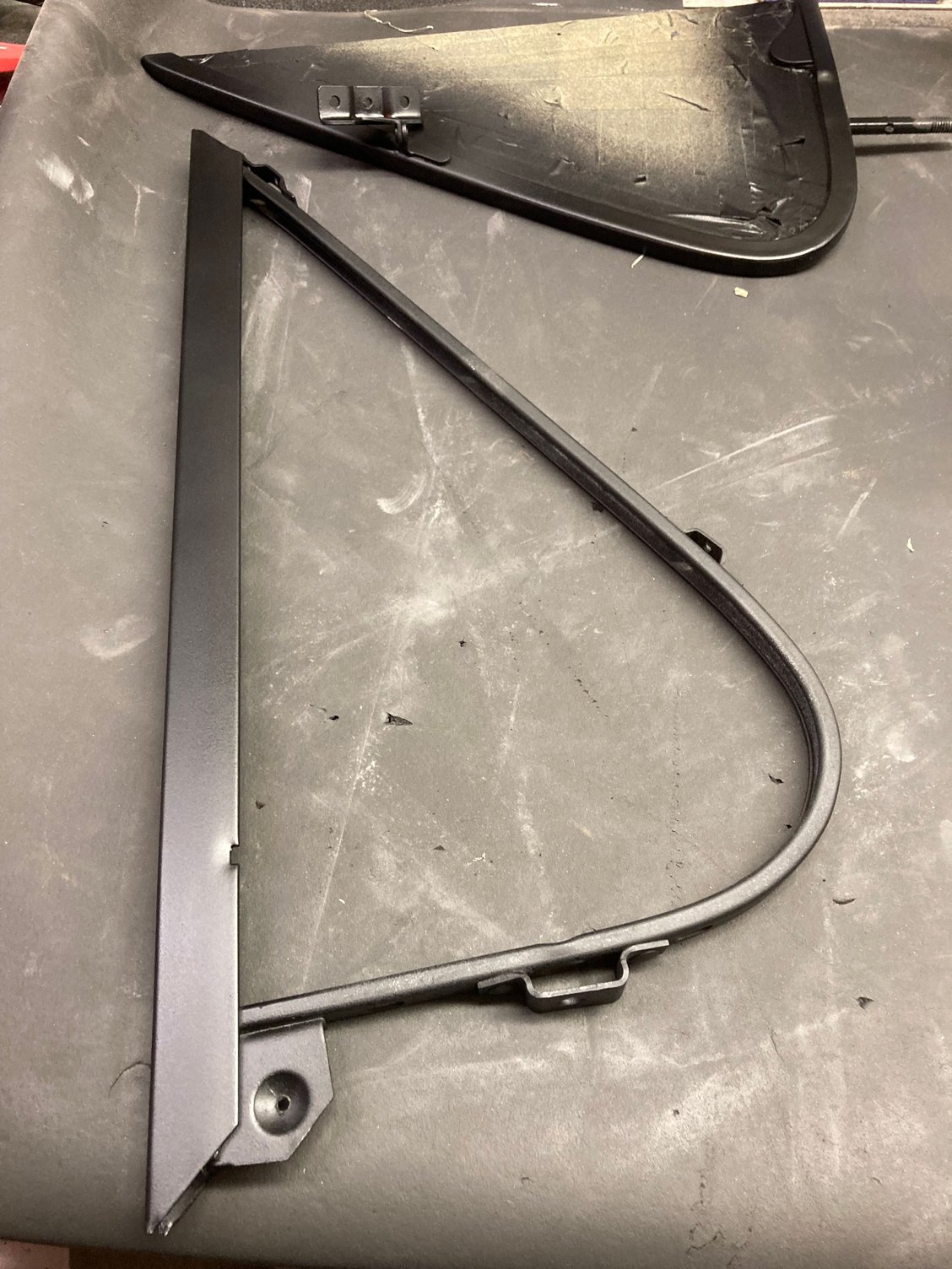

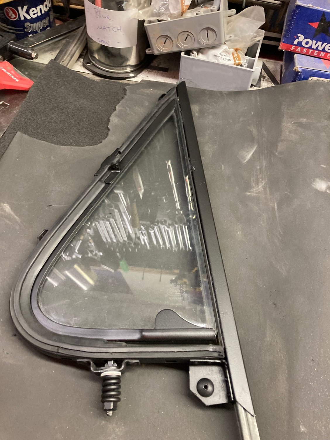

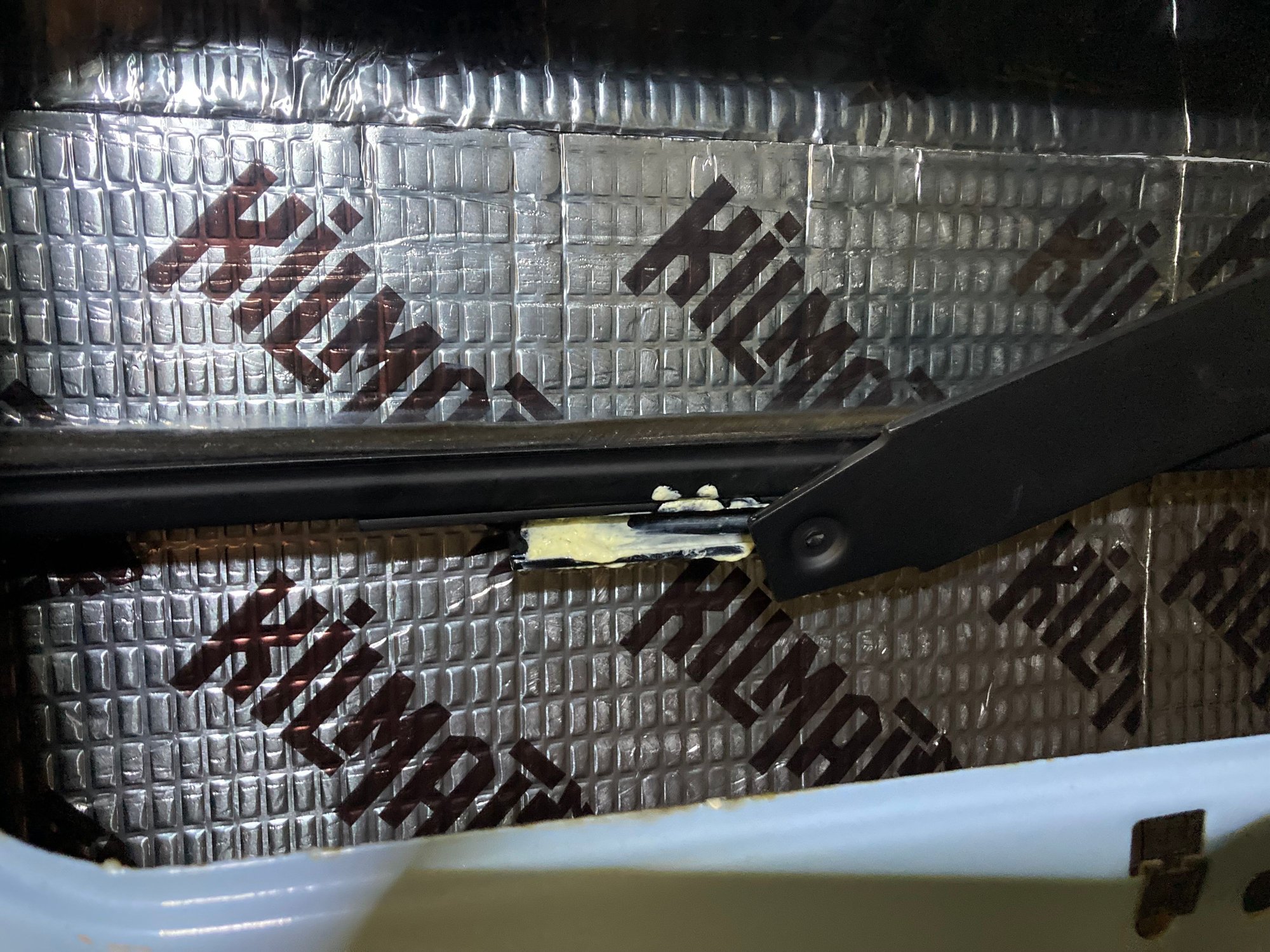

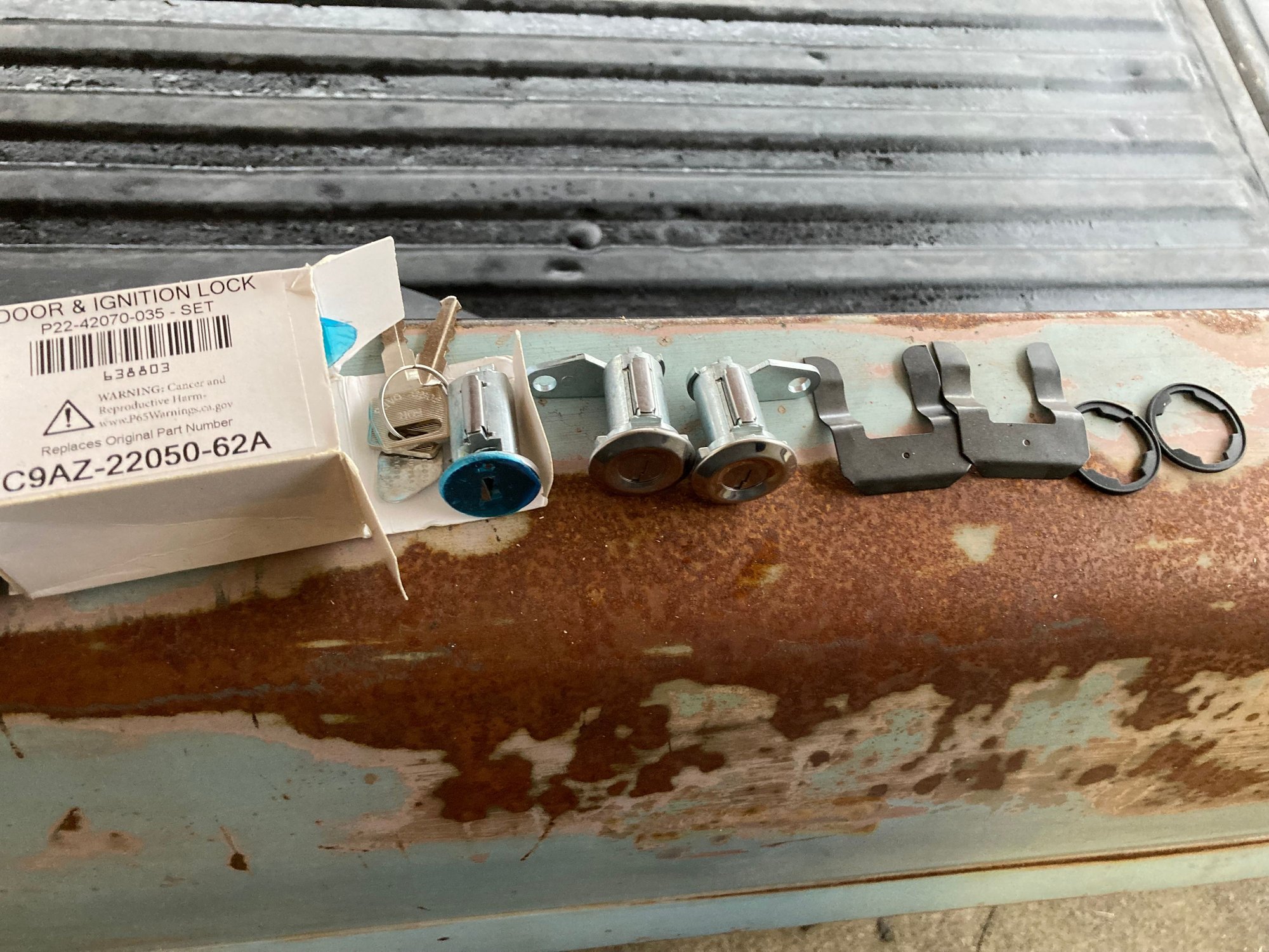

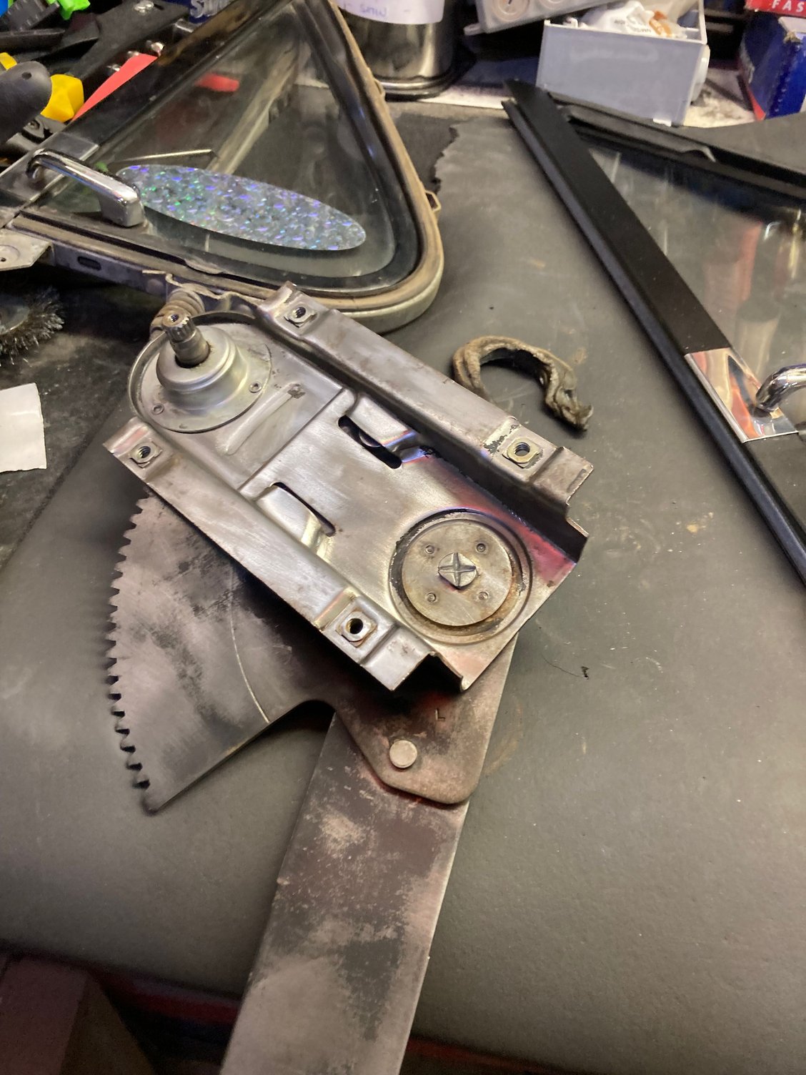

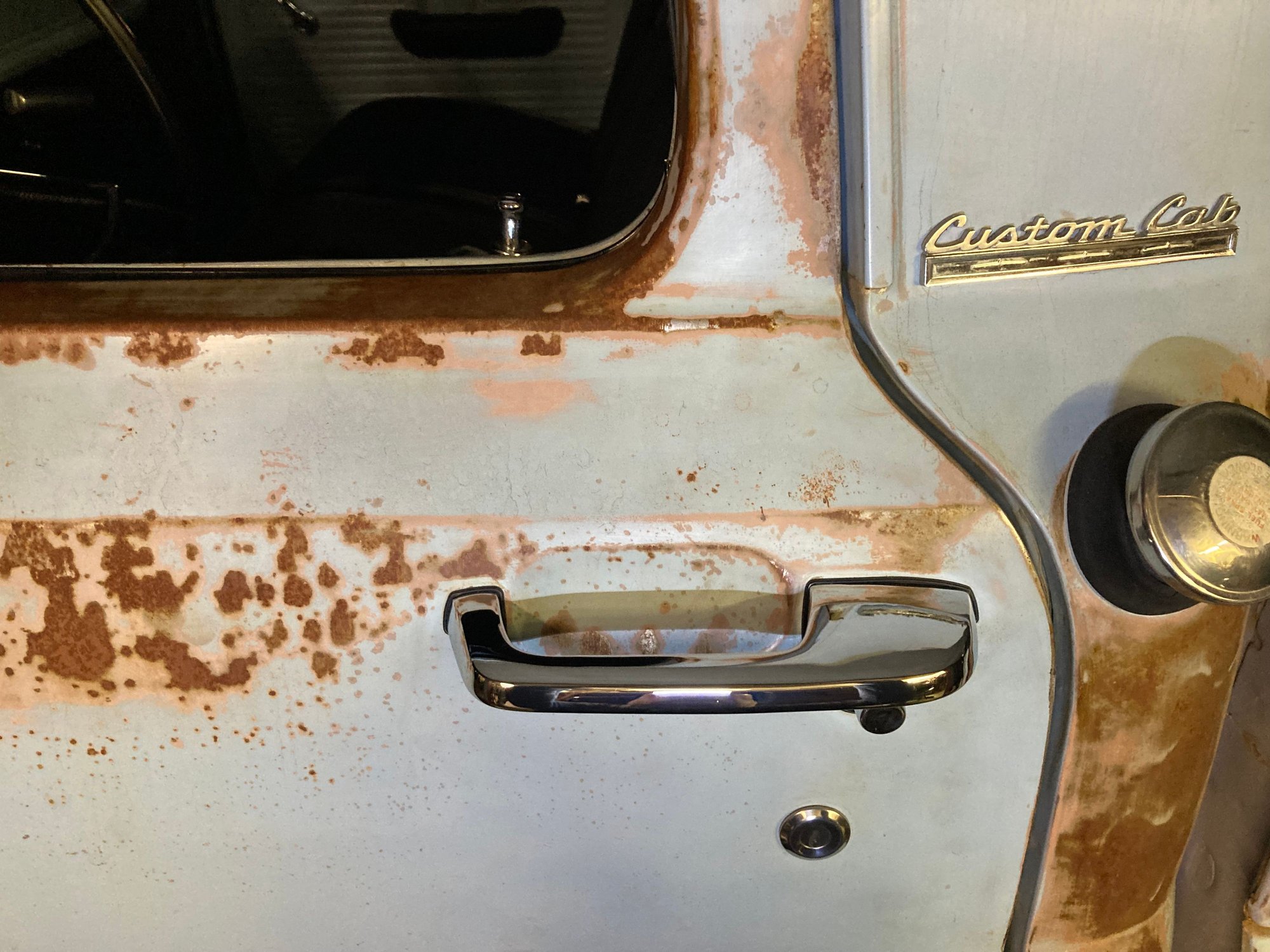

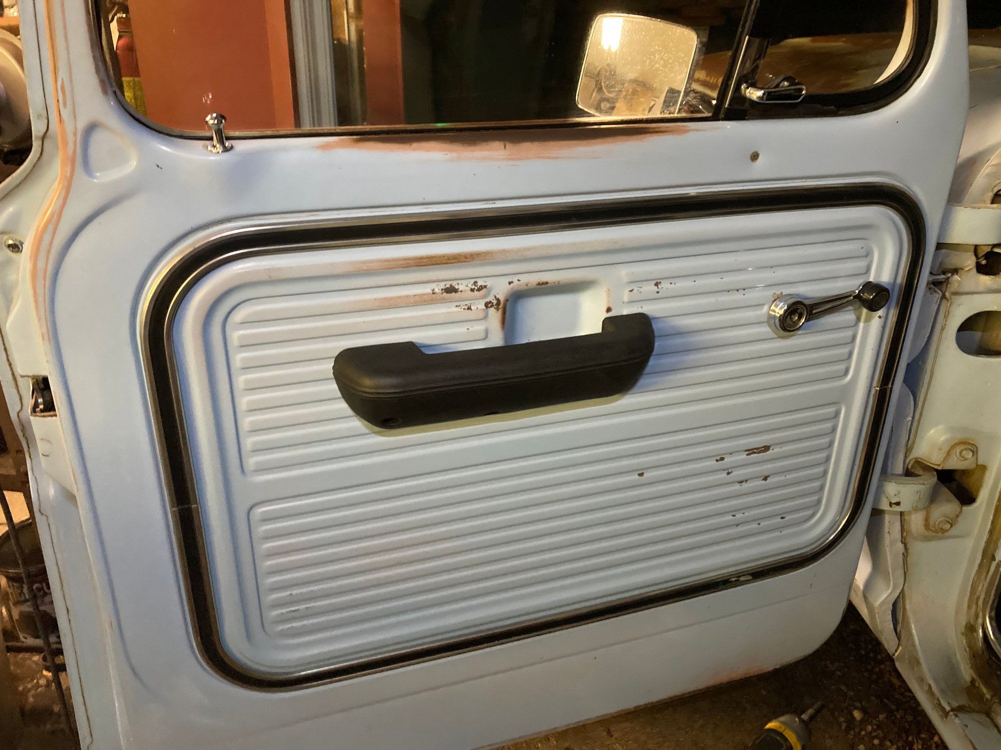

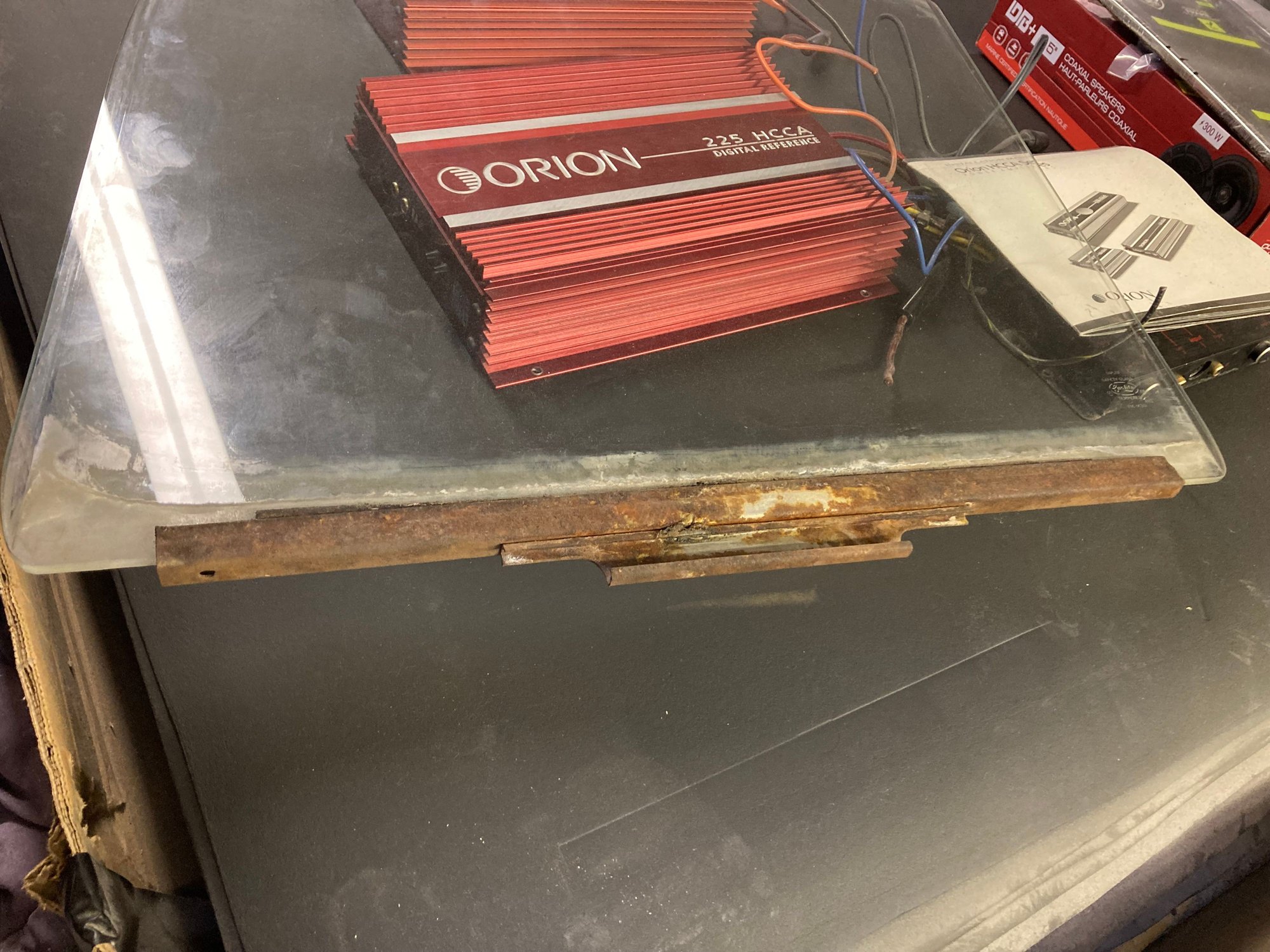

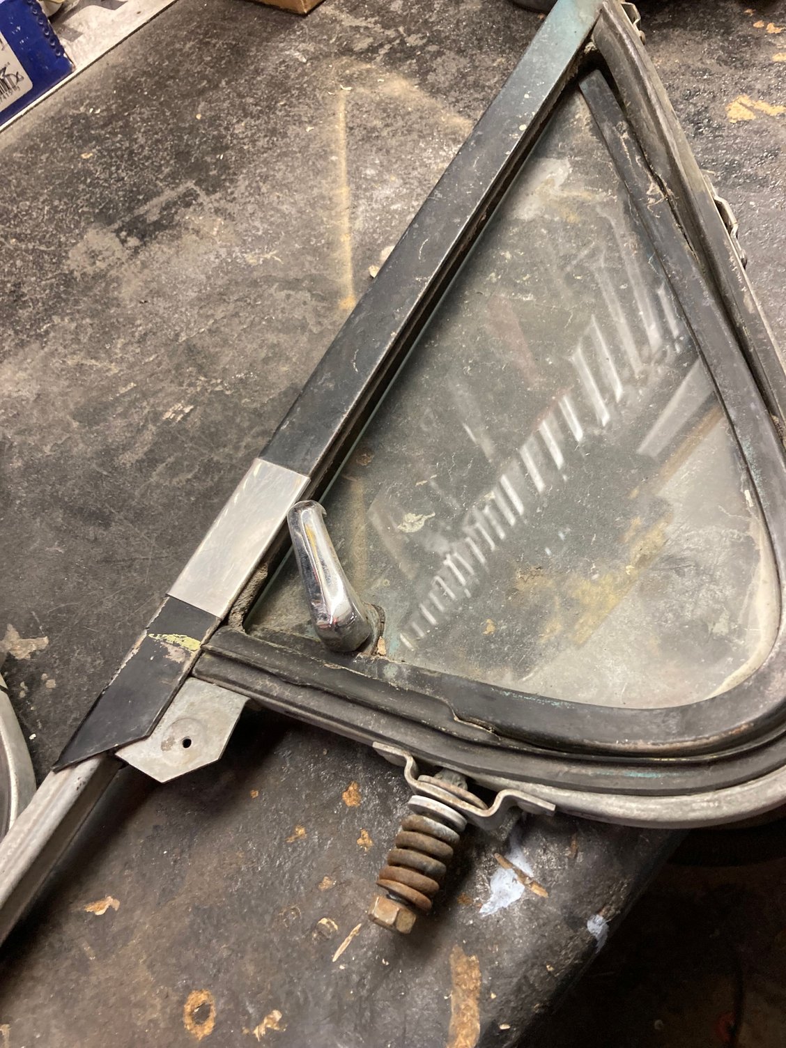

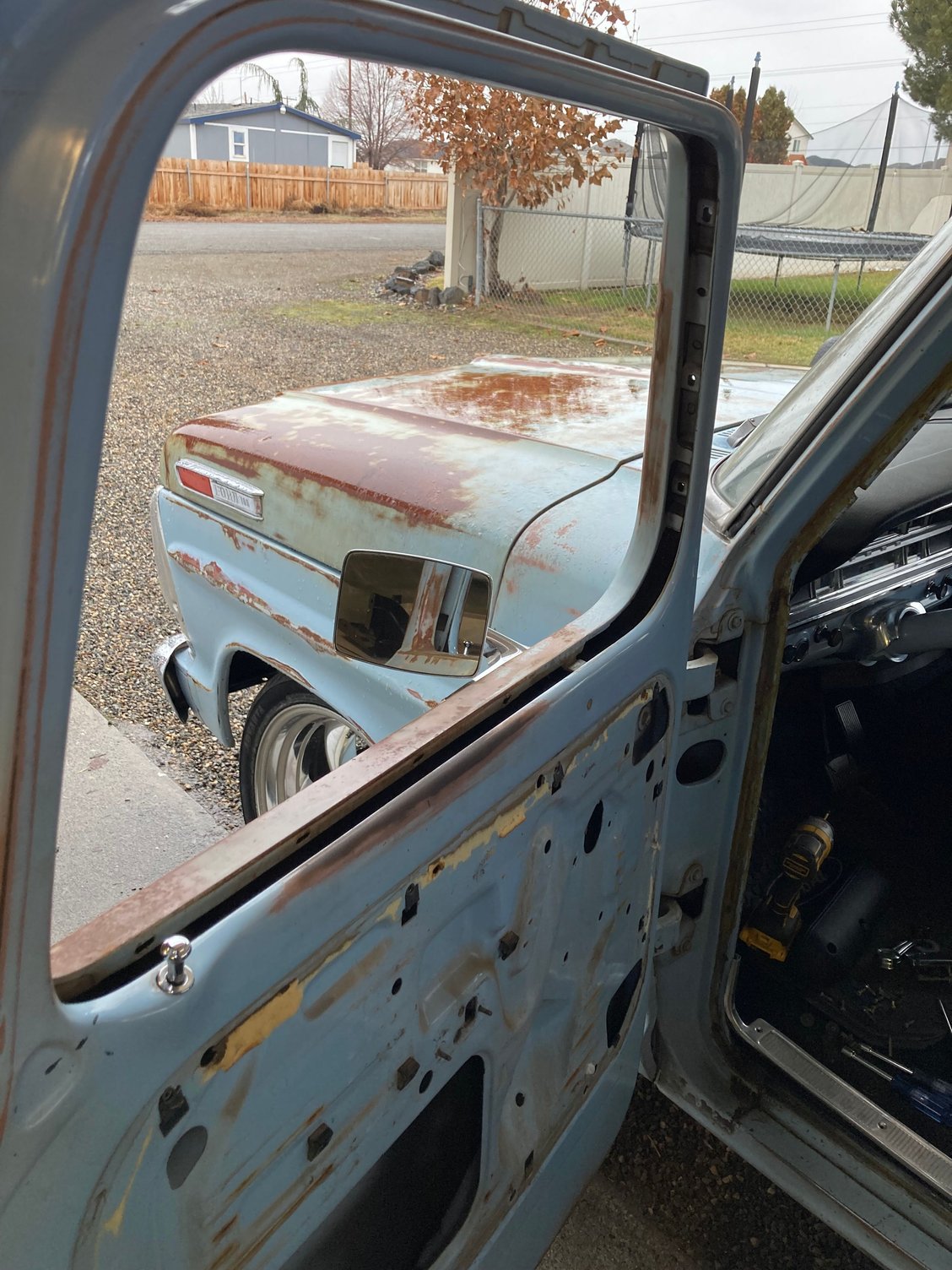

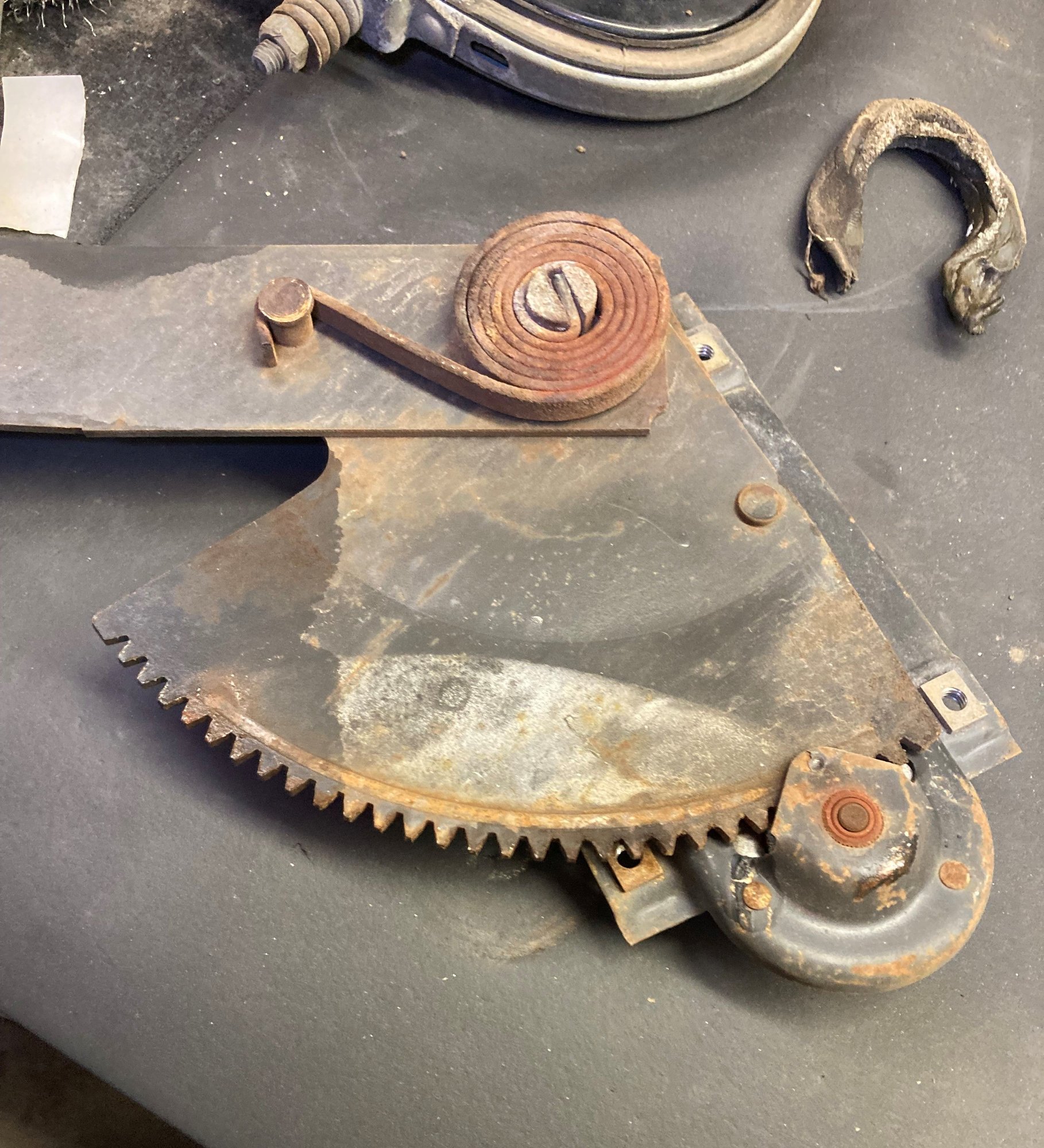

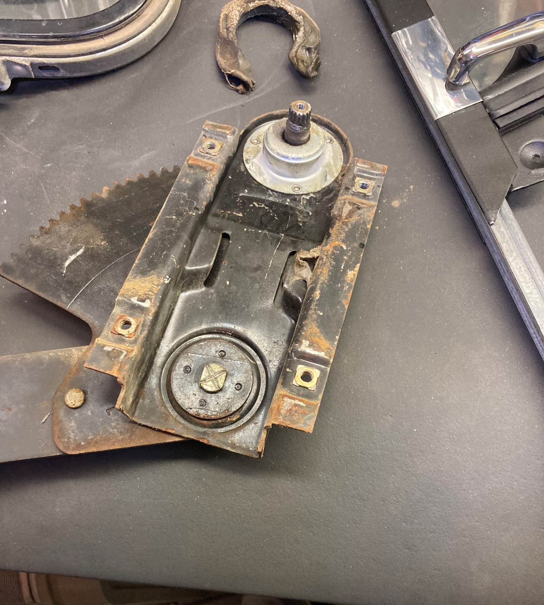

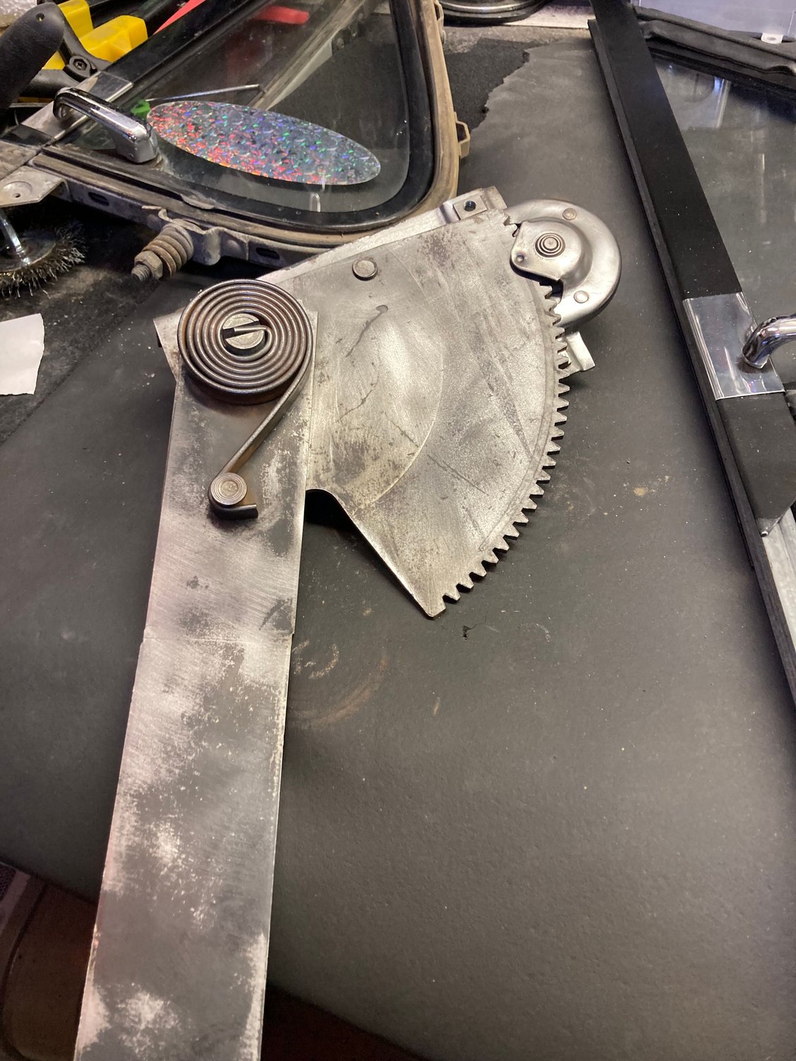

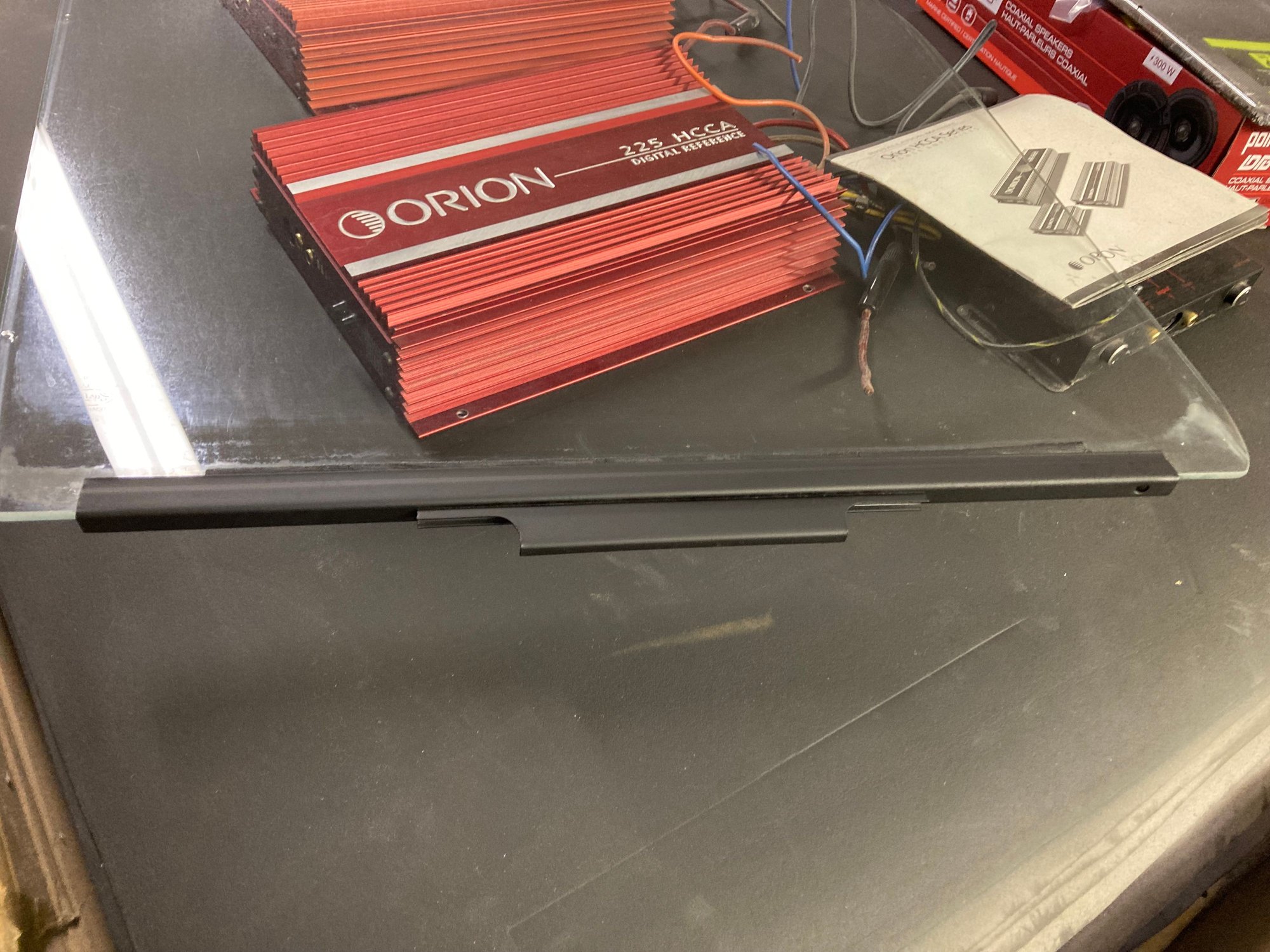

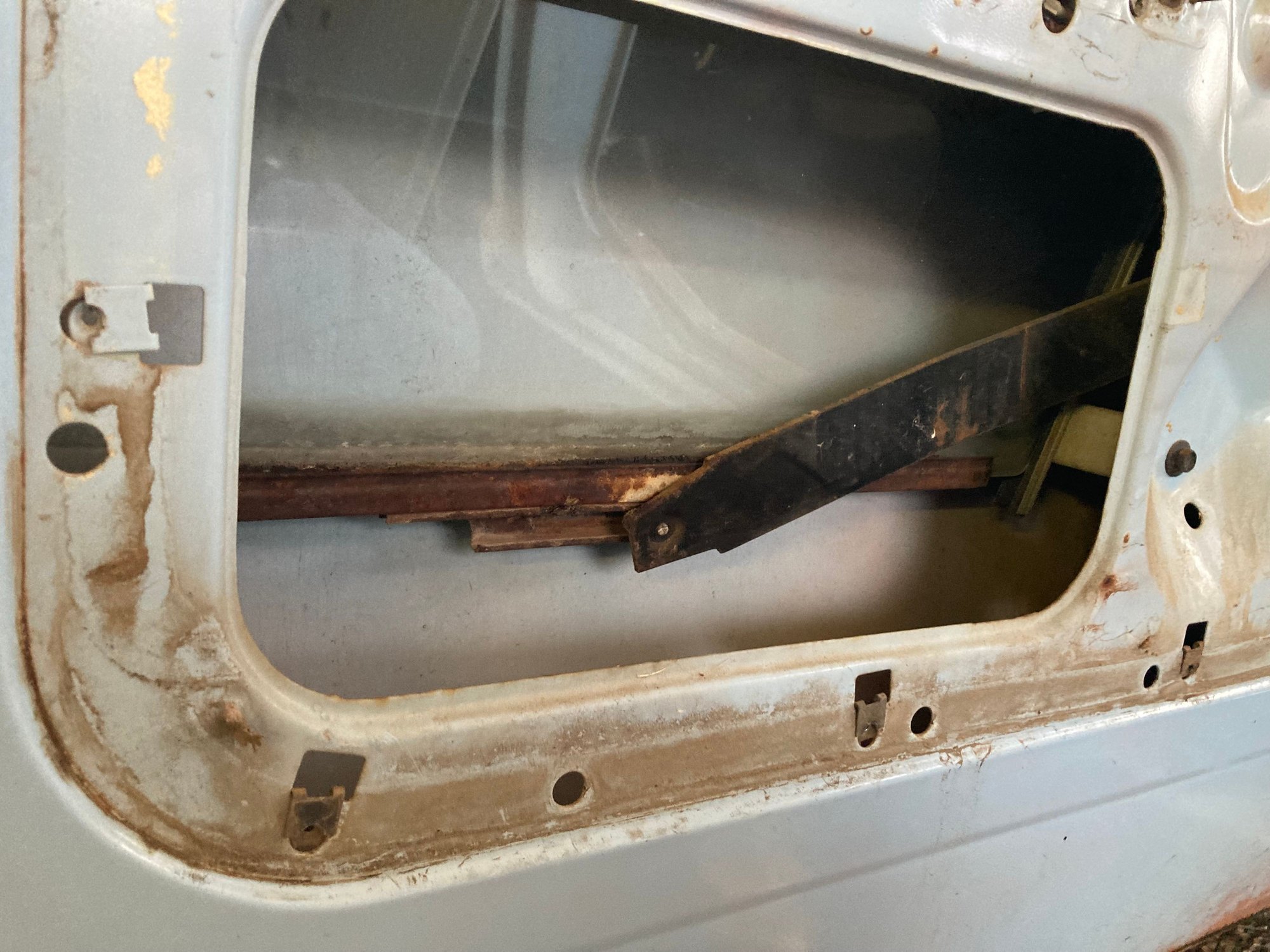

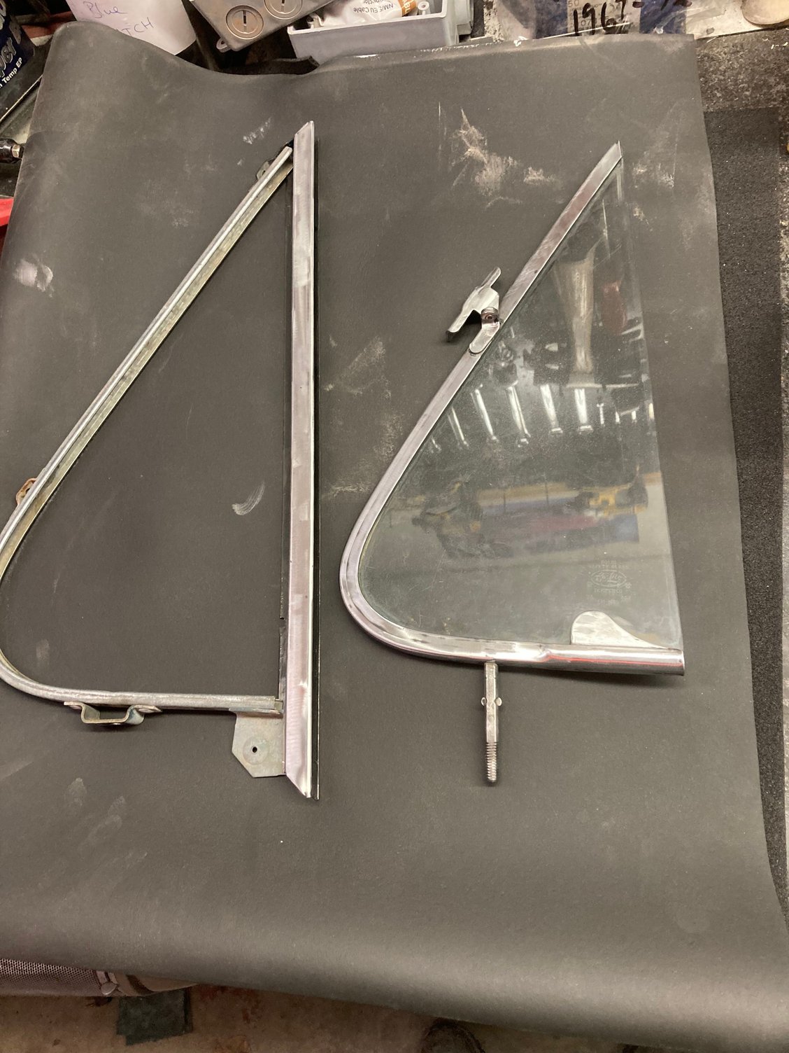

I spent my day taking the drivers door apart and installing some new parts and some general maintenance on the door... rebuilt the wing window, put in new window felt / weather-stripping, matched set of door locks with a matching keyed ignition, a new outside door handle and sound deadener.

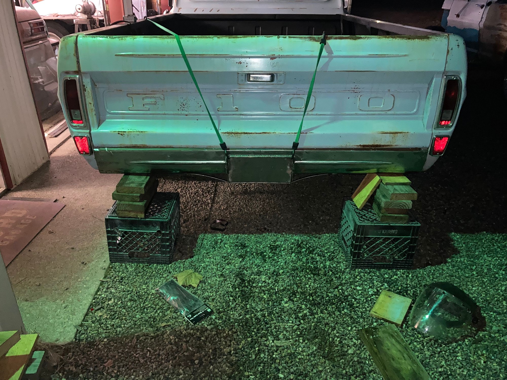

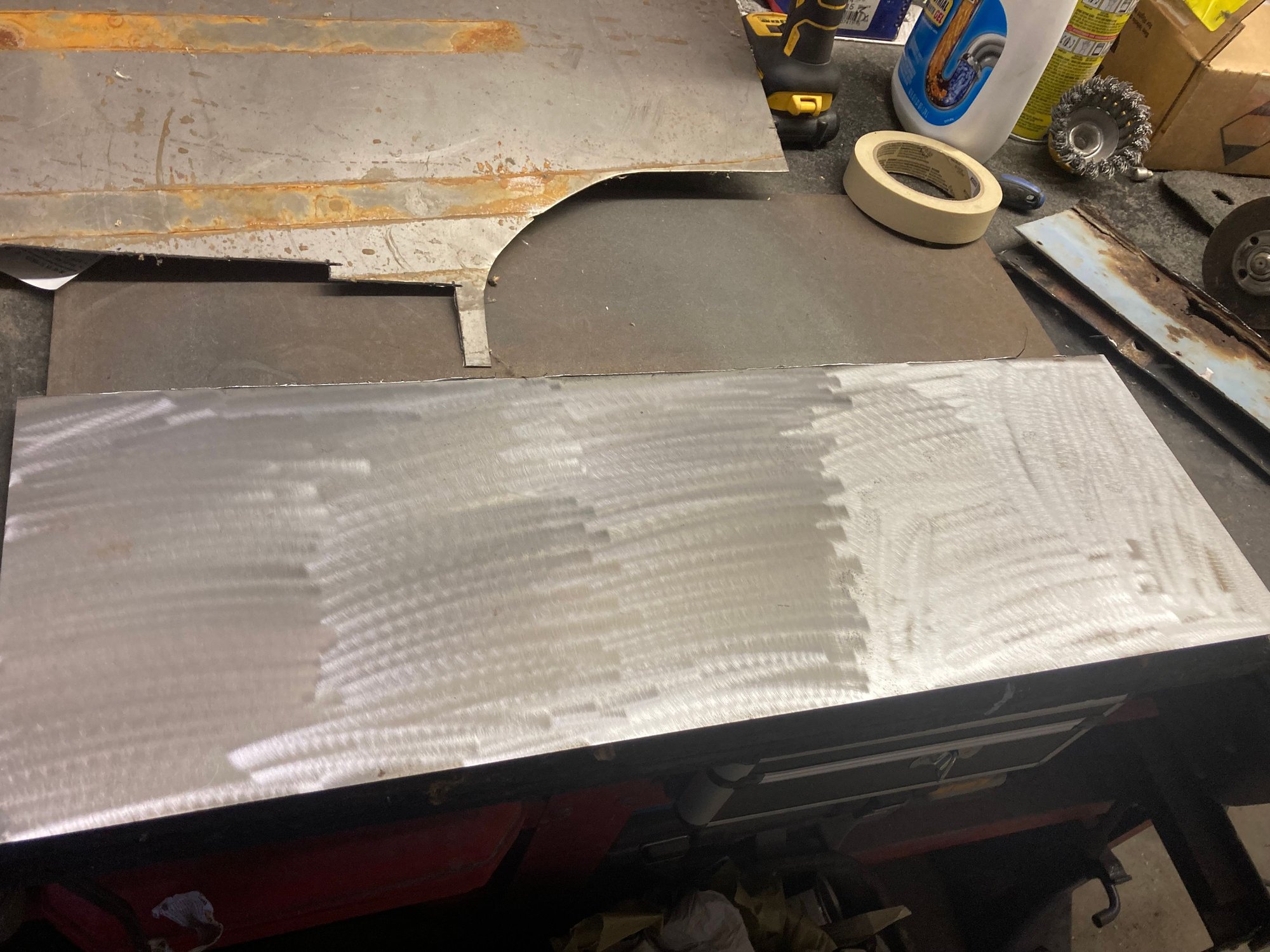

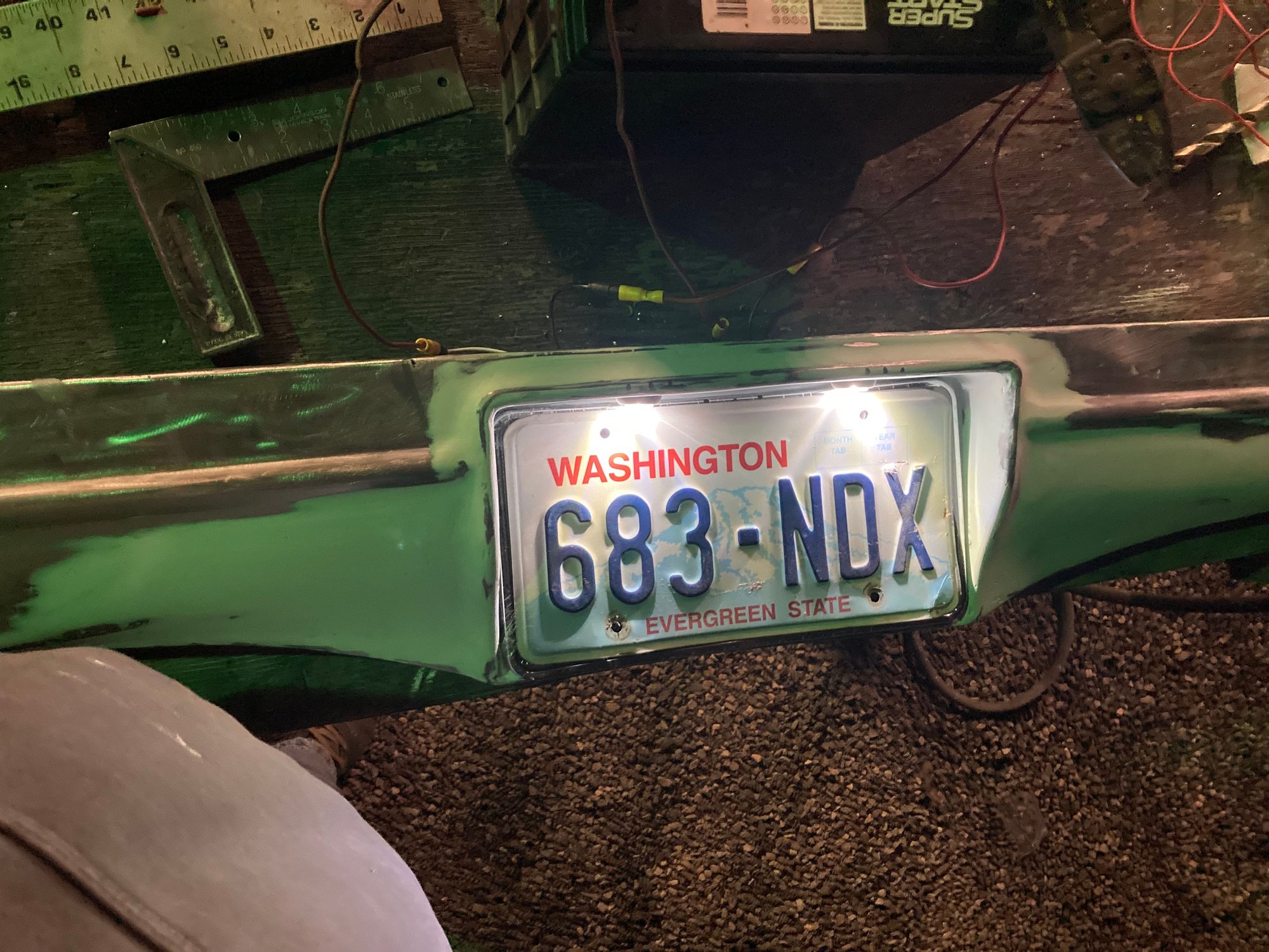

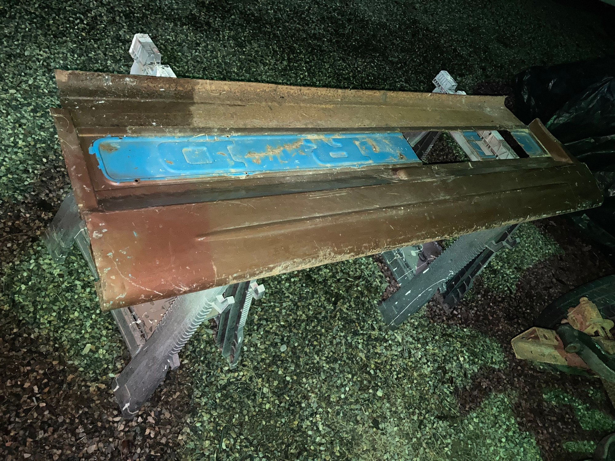

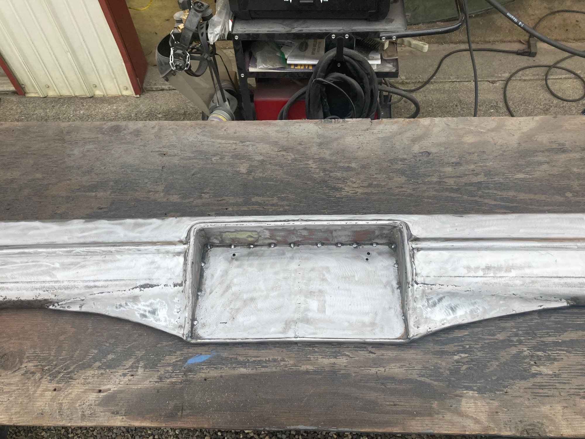

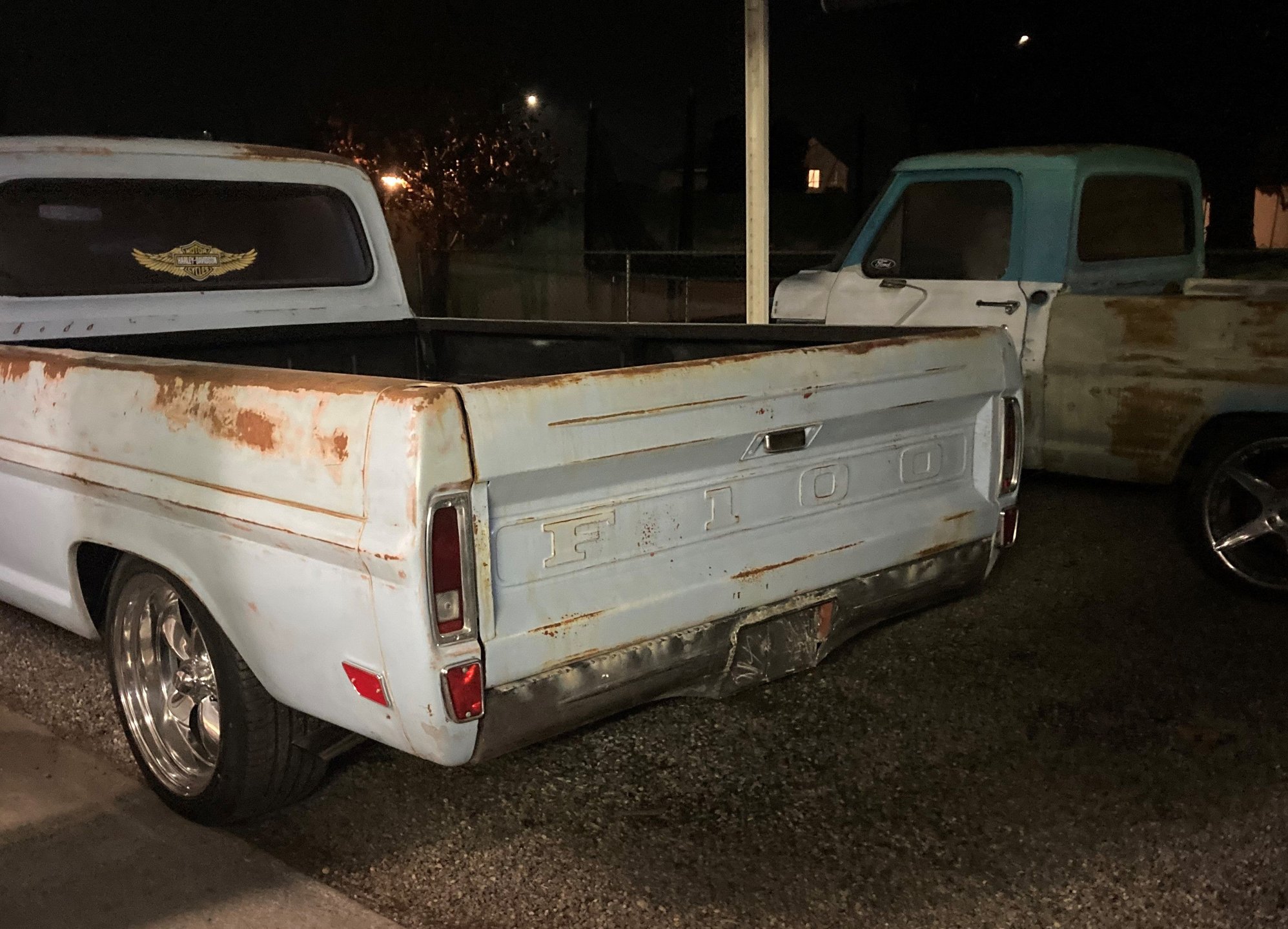

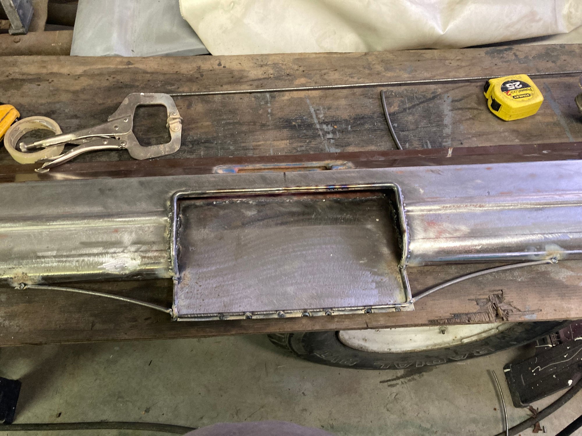

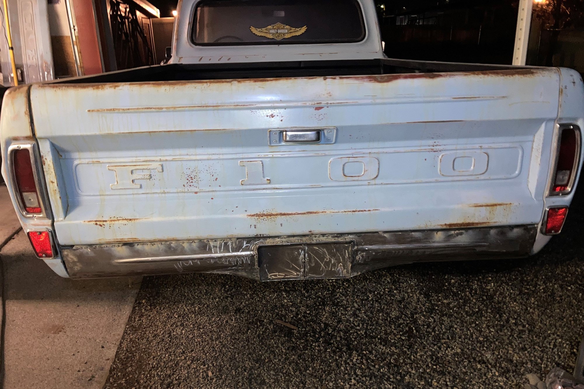

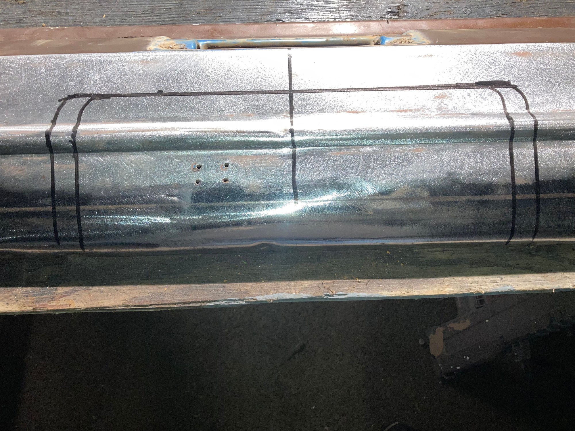

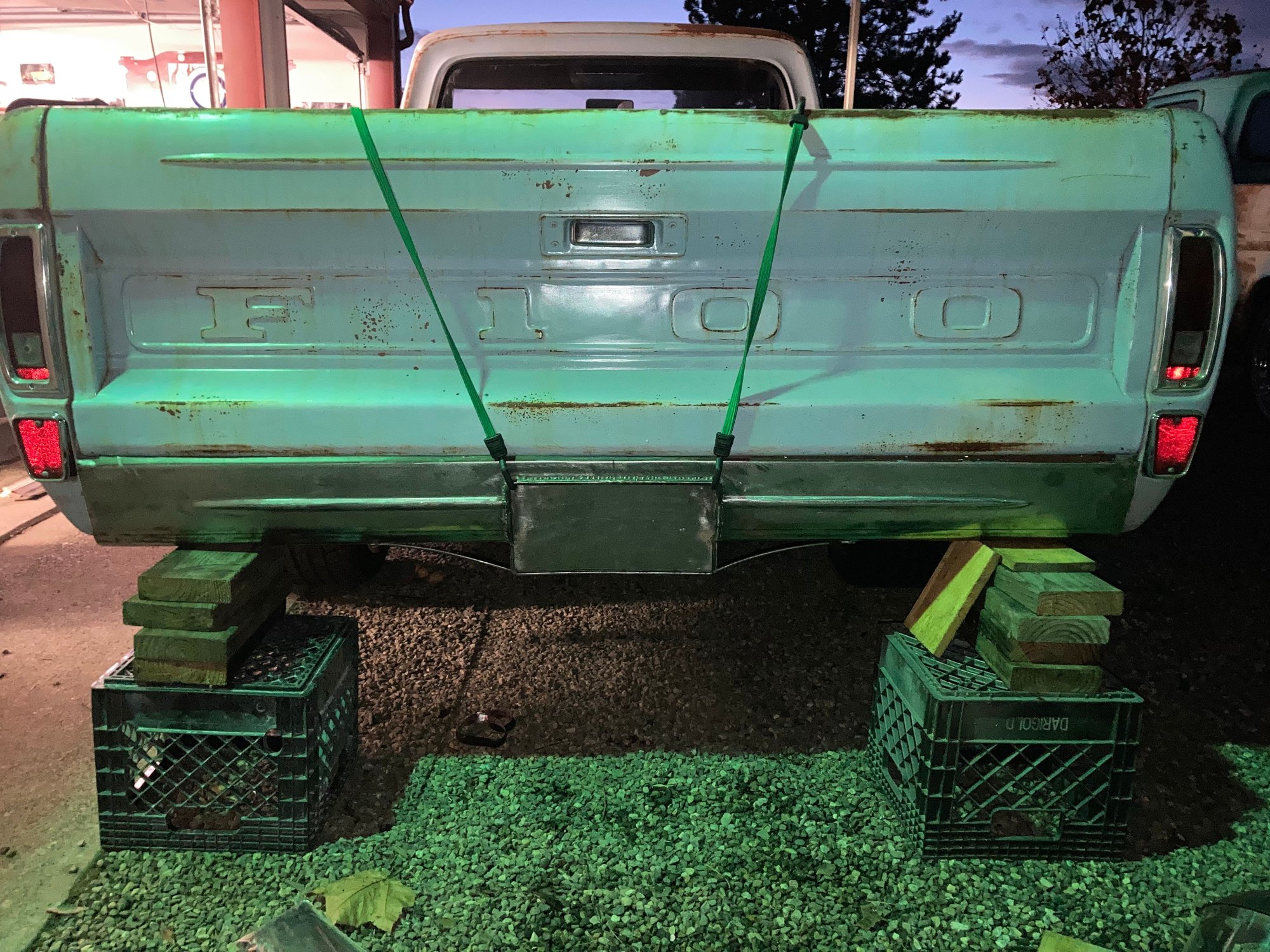

Started one more custom job for this truck. No matter how I looked at the truck I just wasn't happy with the big step bumper anymore so I took it off and started making a rear roll pan from the left over scrap tailgate.
I saw someone start to do this a long time ago but never saw the finished product and when I searched for it I couldn't find it. They chopped the top of the tailgate and flipped it over and mounted it like that. I never saw it past that point.
So my version of it is this but still in the mock up...
That's it for now, more to come...

More fitting issues and a lot of trimming... fitting and trimming today.... oh and a bunch of spot welds. Still have a lot more to go but it's starting to line up with the truck.

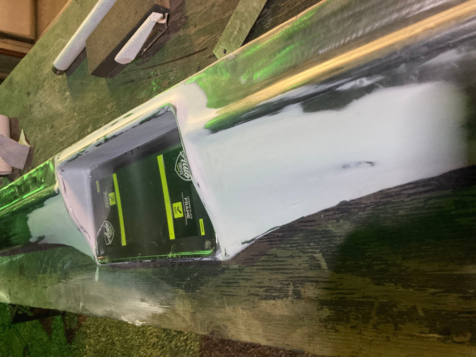

I had a medical issue that caused a bit of a delay for my projects and had to take it easy for a little while. Starting to feel good enough to continue work on the roll pan today.
The shape is dialed in now just a lot of sanding to get all the transitions smooth so everything flows together nicely.
