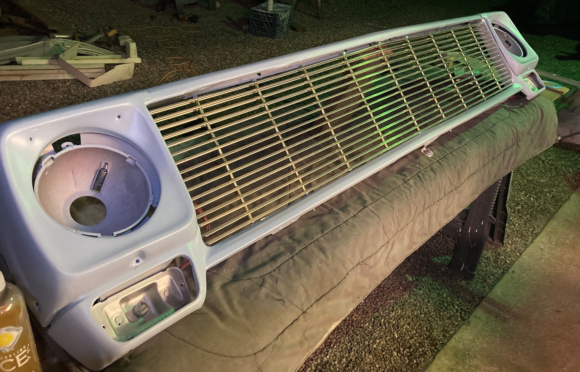

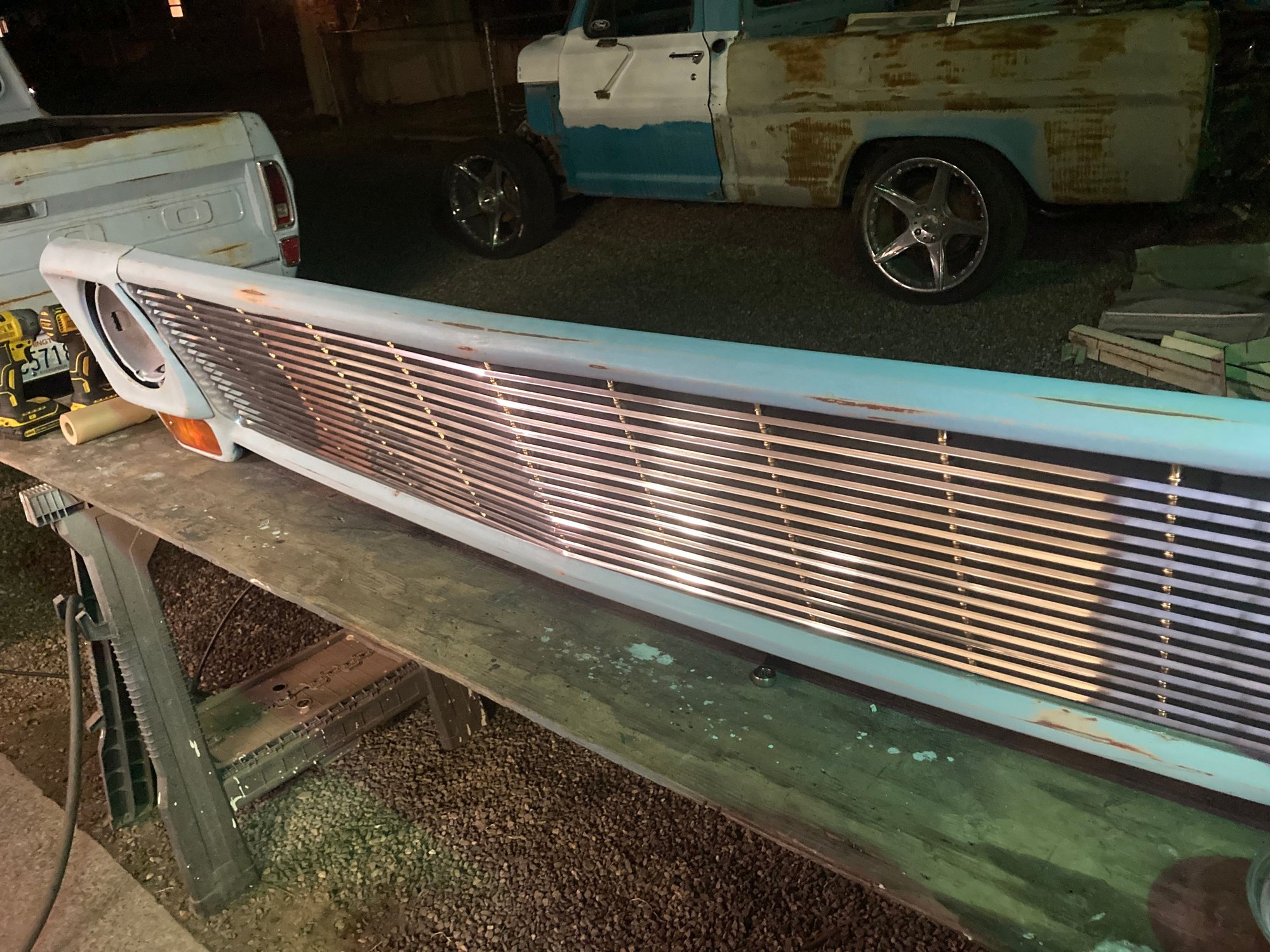

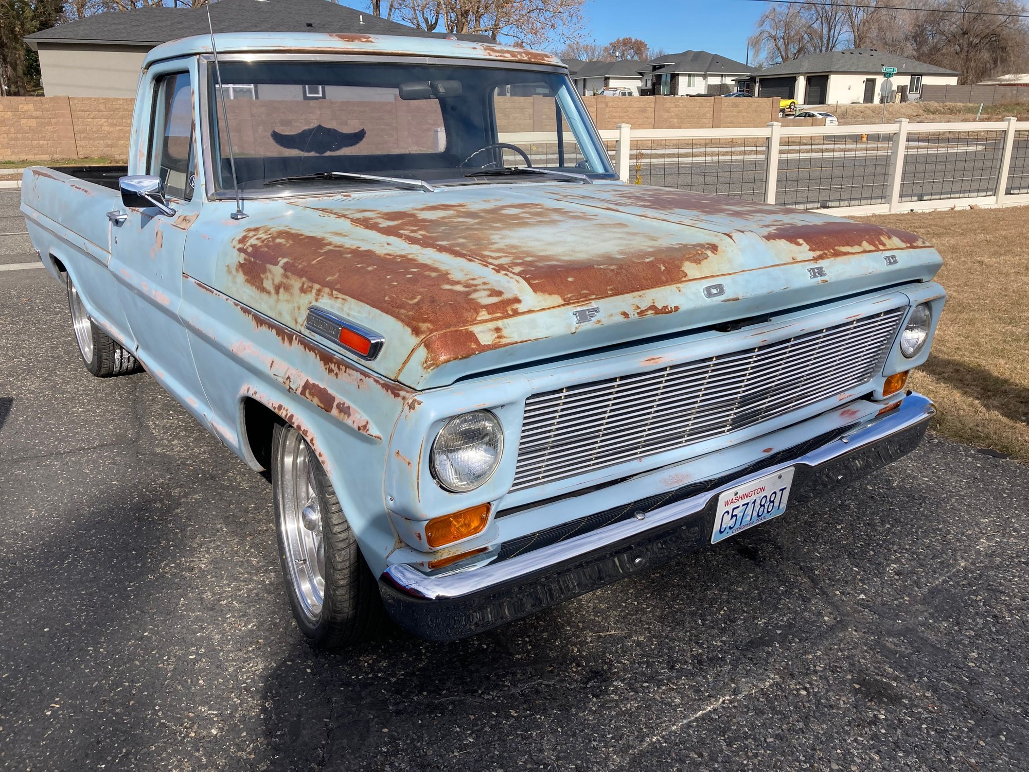

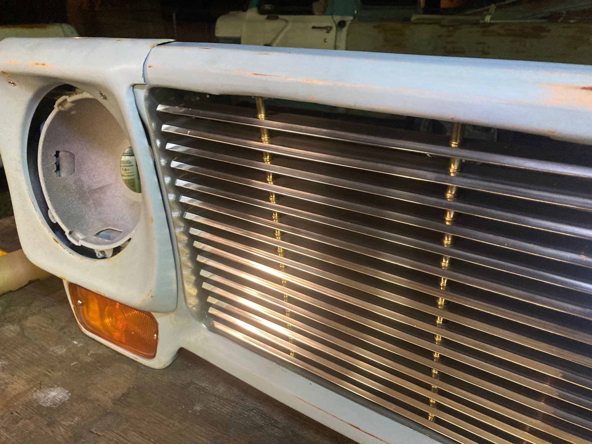

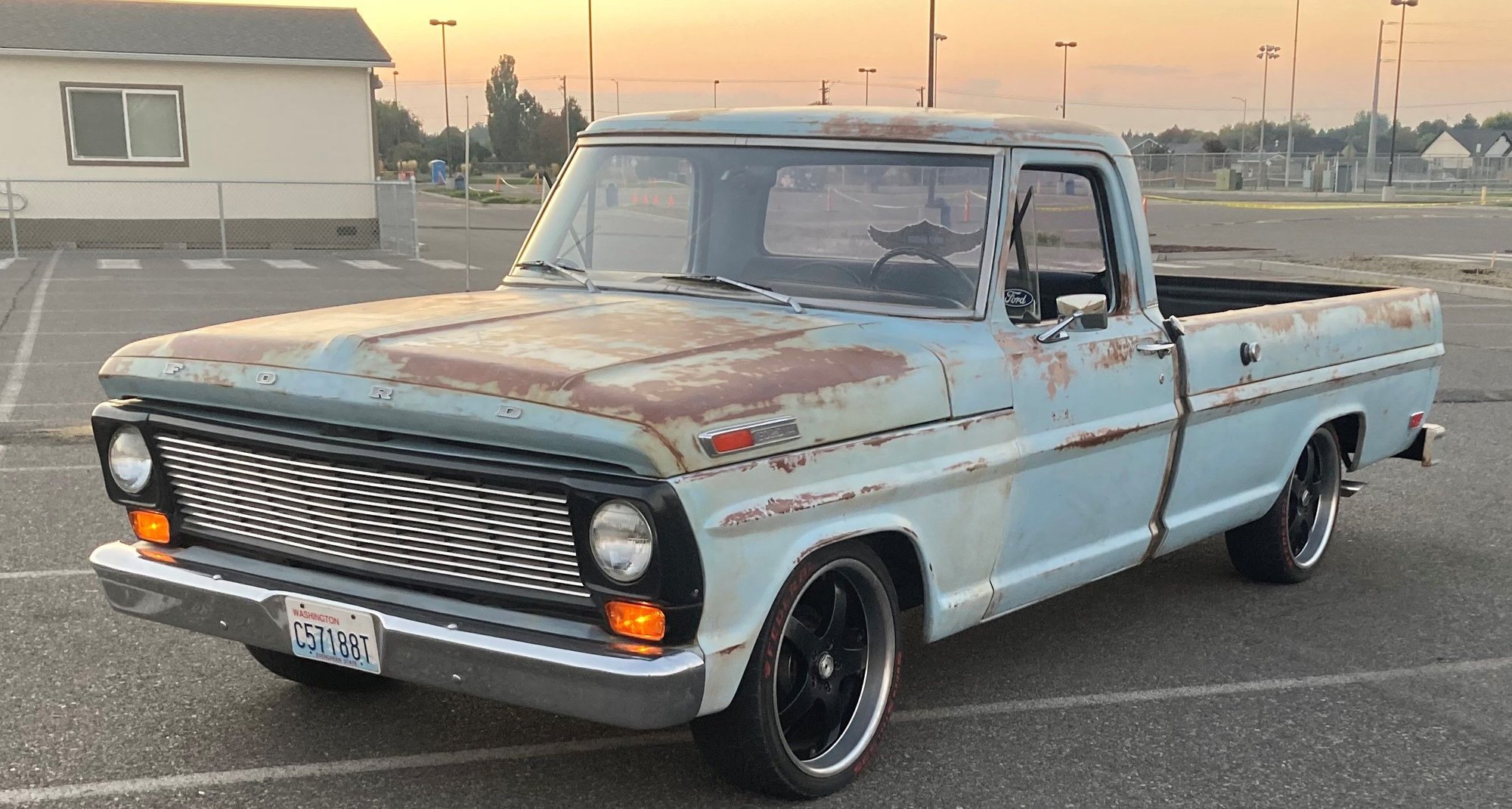

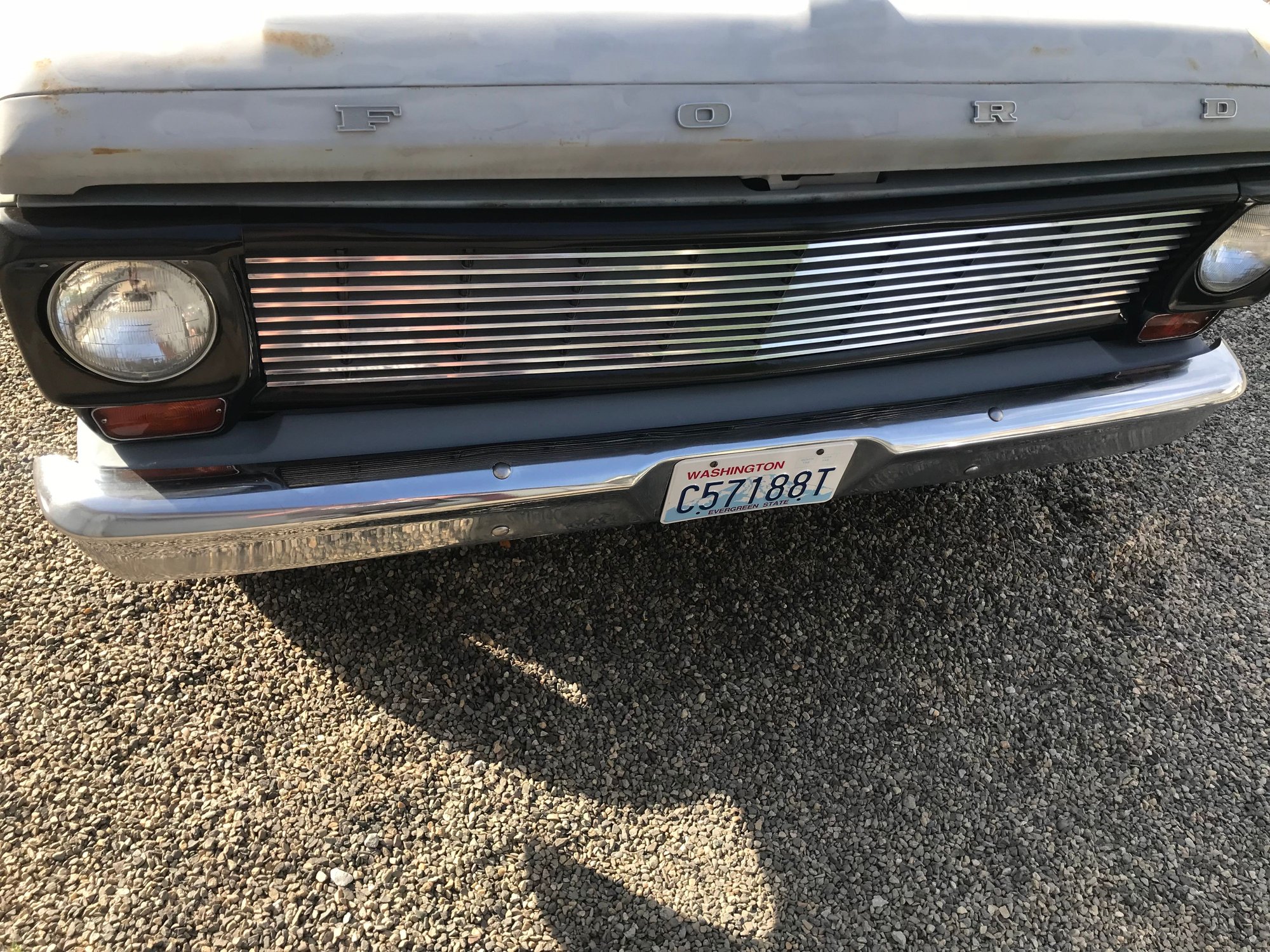

Taking this thread all the way back to how it started... it was about attempting to build a custom grill but then it turned into my F100 build. I was pleased with how the grill turned out but there were a few things over time that I noticed and I needed to repaint the shell to match the the new/old look of the truck. So I pulled it all apart and used smaller threaded rod and smaller spacers to "slim up" the look a bit. Here are a couple throw back pictures to what it looked like when the plan was to paint the truck mat black.
And now with the light blue paint and the thin rod and spacers... (sorry bad lighting looks white)
I still need to do a few more adjustments and then "patina" the paint to match the truck.

1) Glad you are feeling better!
2) How well does the sound deadening do in the doors?
3) Damn dude, that grill is awesome!

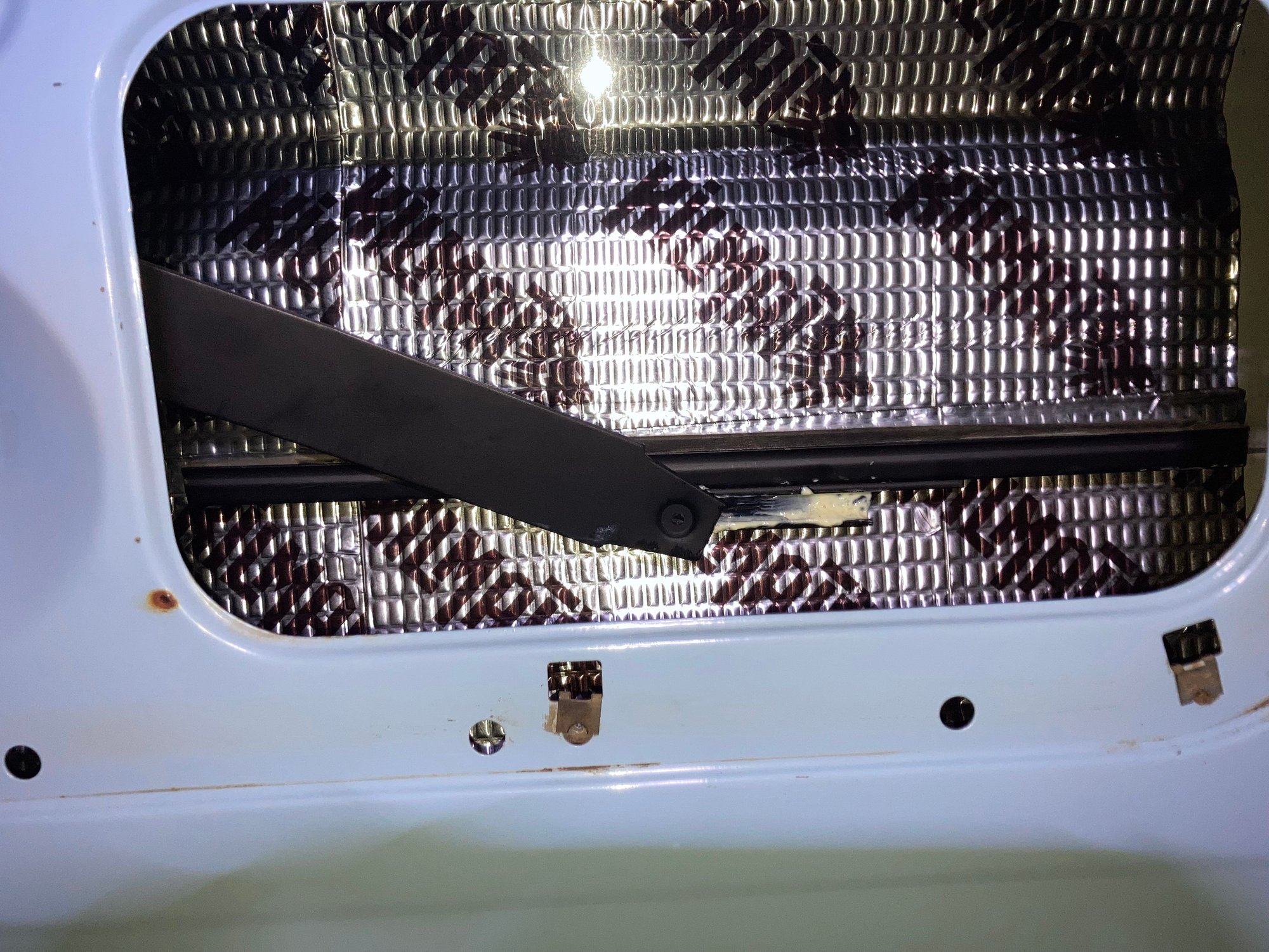

Thank you, getting older sucks... Just can't bounce back like I used too.

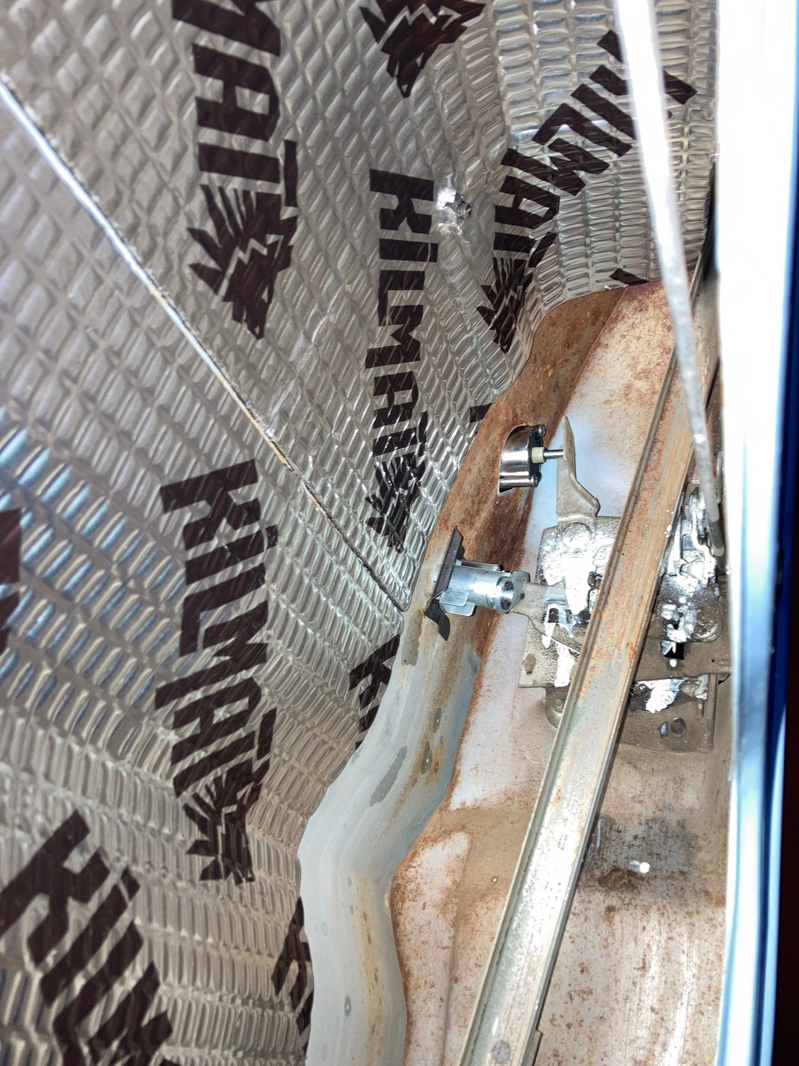

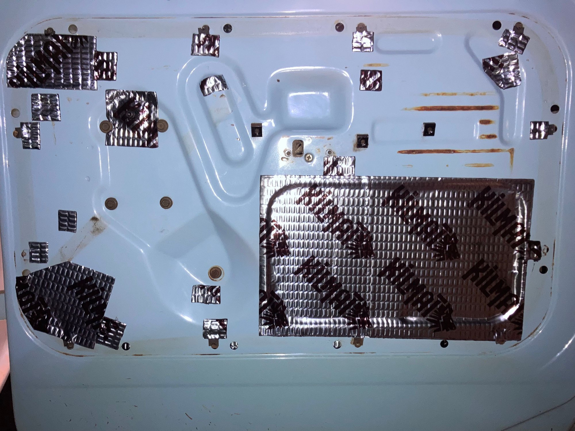

It makes a big difference in the doors as they go from having that tin pan ting sound to having a nice solid thud.
Thank you, I'm happy with how the grill is turning out "again" I'll try to get some better pictures in the daylight soon.

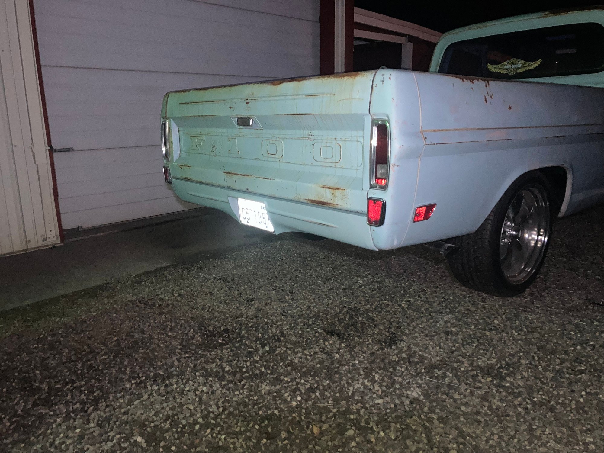

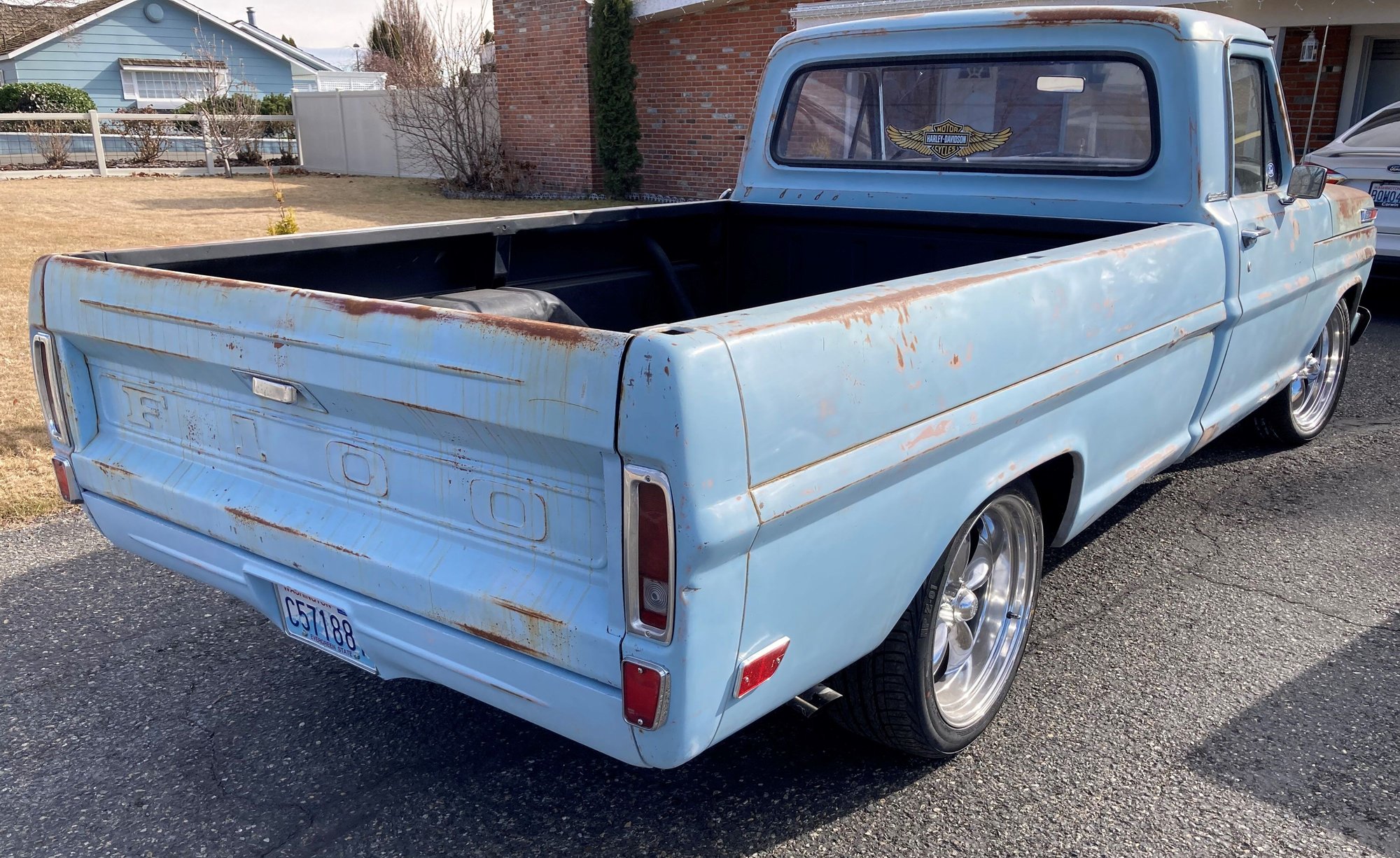

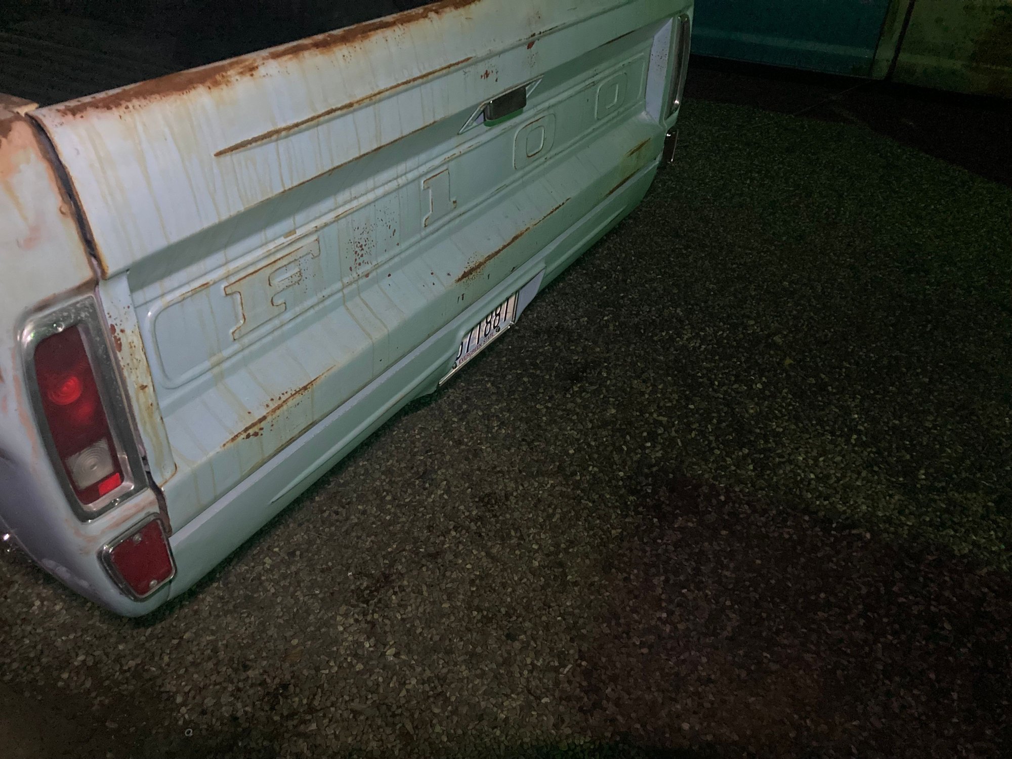

Finished up the chopped tailgate turned into a roll pan project today...

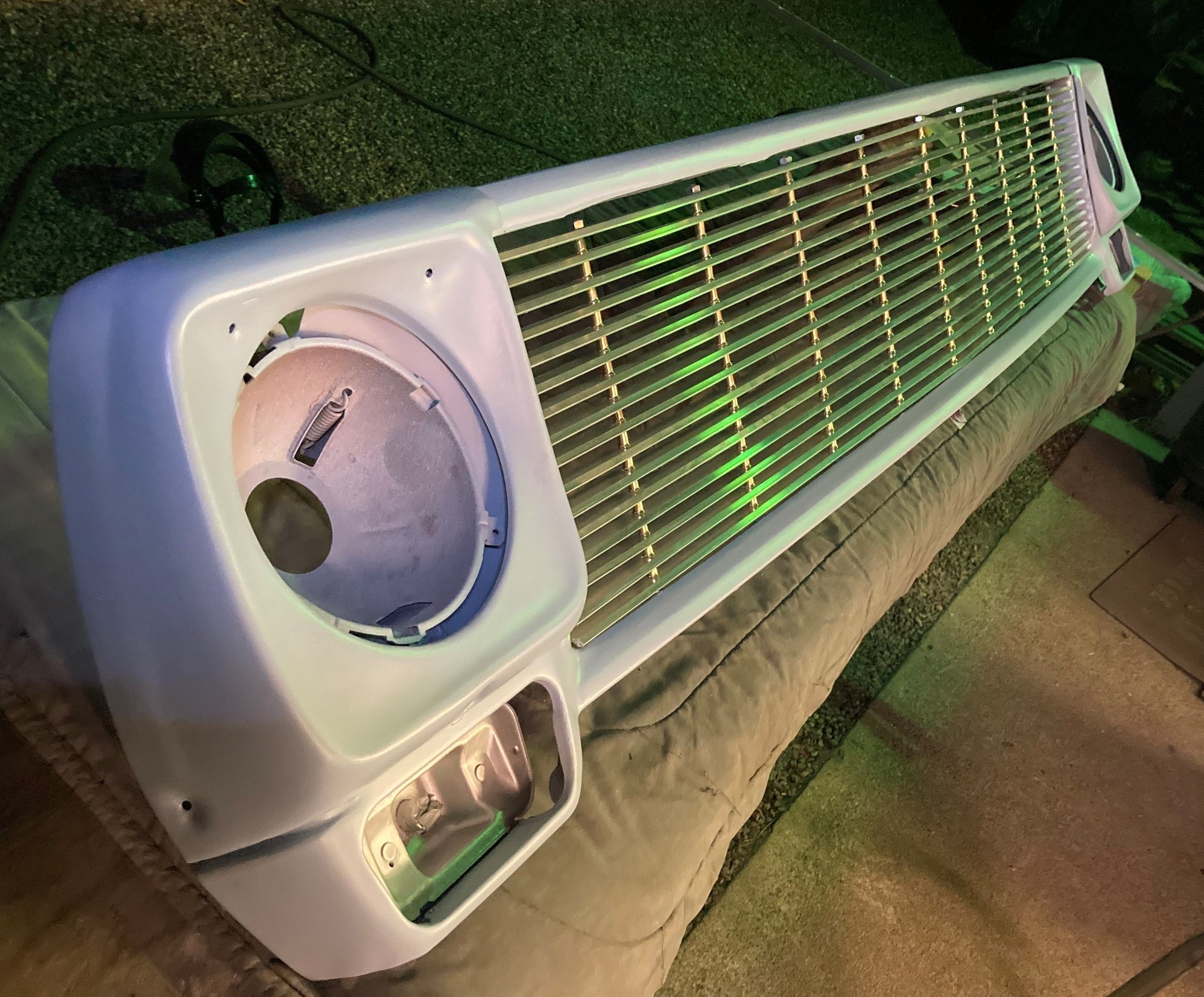

Final assembly on the center section of the grill, all the trimming and polishing is done. Painted the inside surround argent silver with fine metal flake and assembled the 360 pieces that make up the center for the last time. Tomorrow I can install it on the truck and fine tune whatever needs some adjusting. Very happy with how it looks so far, looking forward to seeing it on the truck.

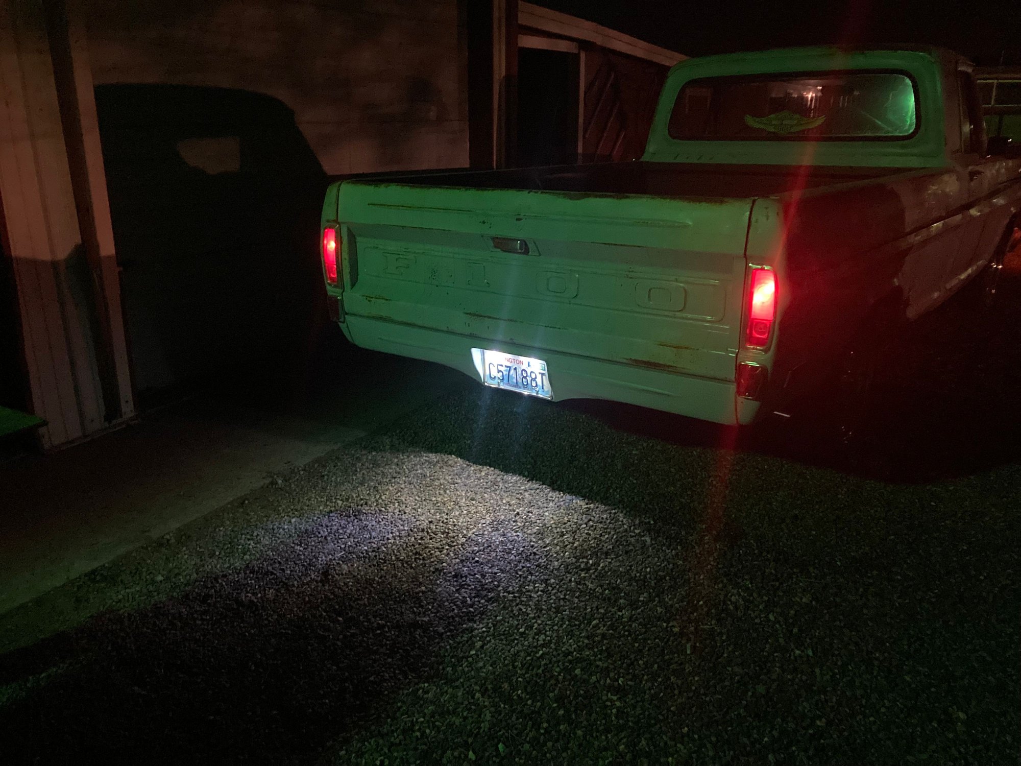

I also got the lights wired up for the license plate...
I like the way this turned out. Great idea and execution.

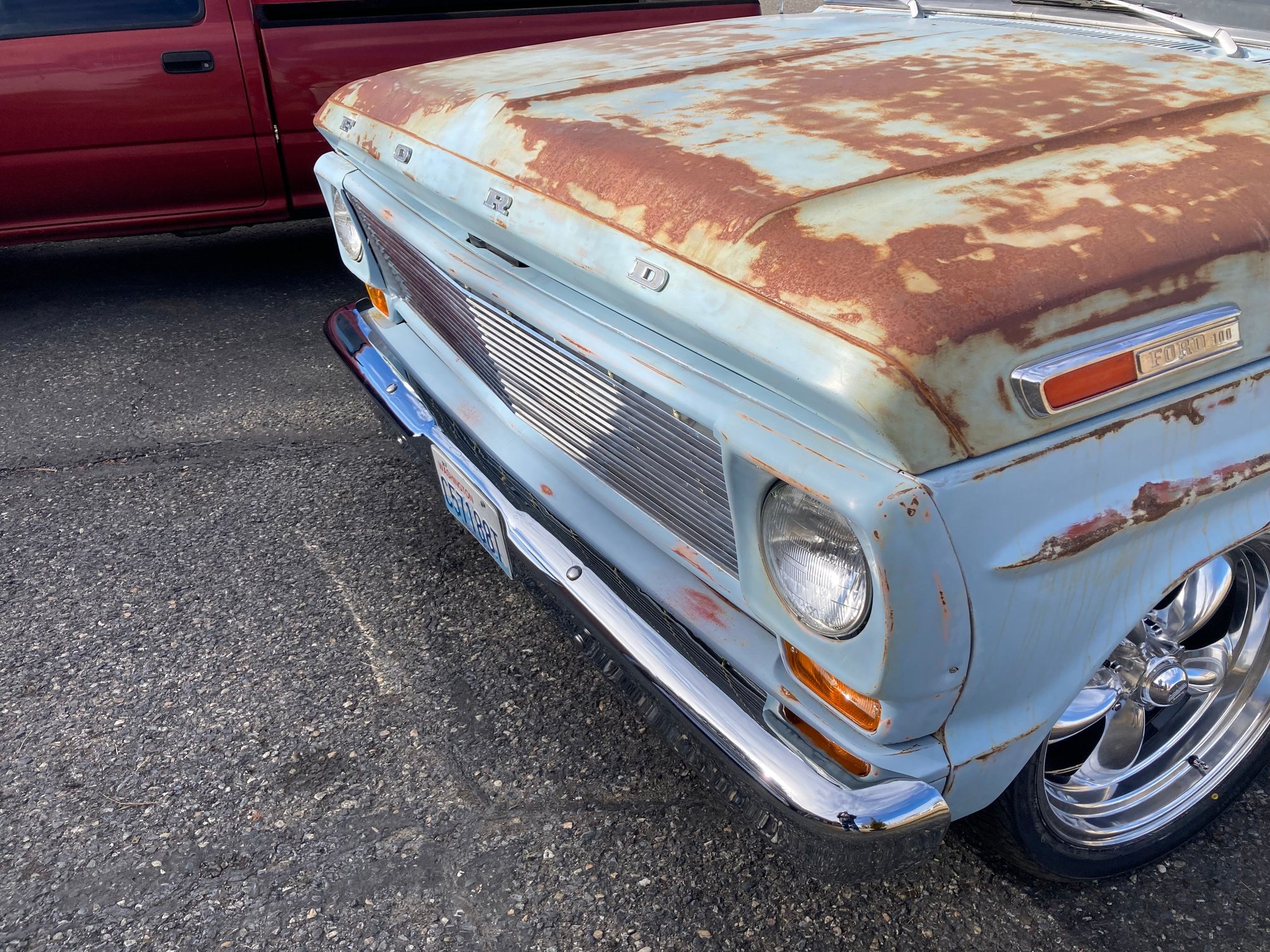

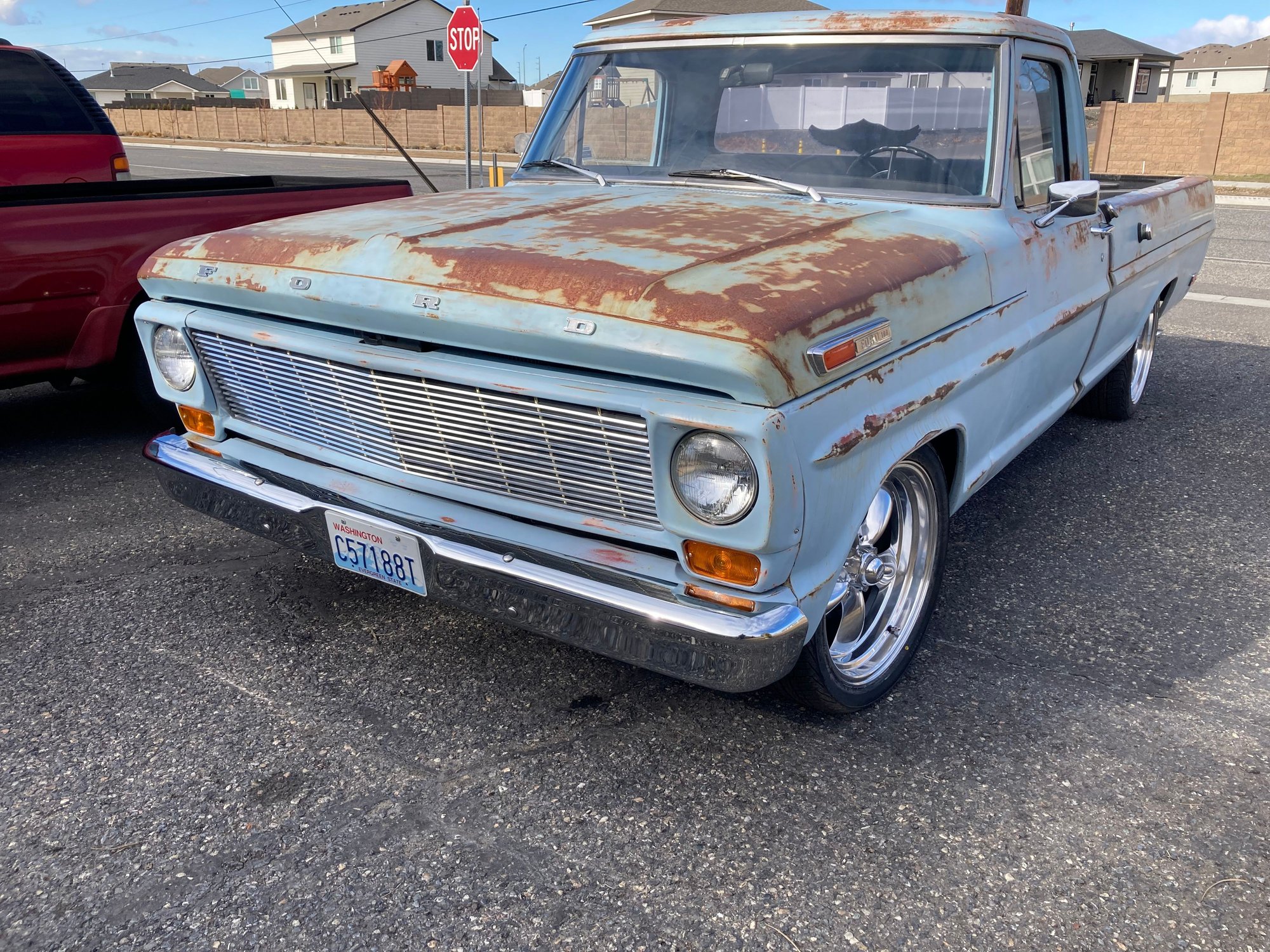

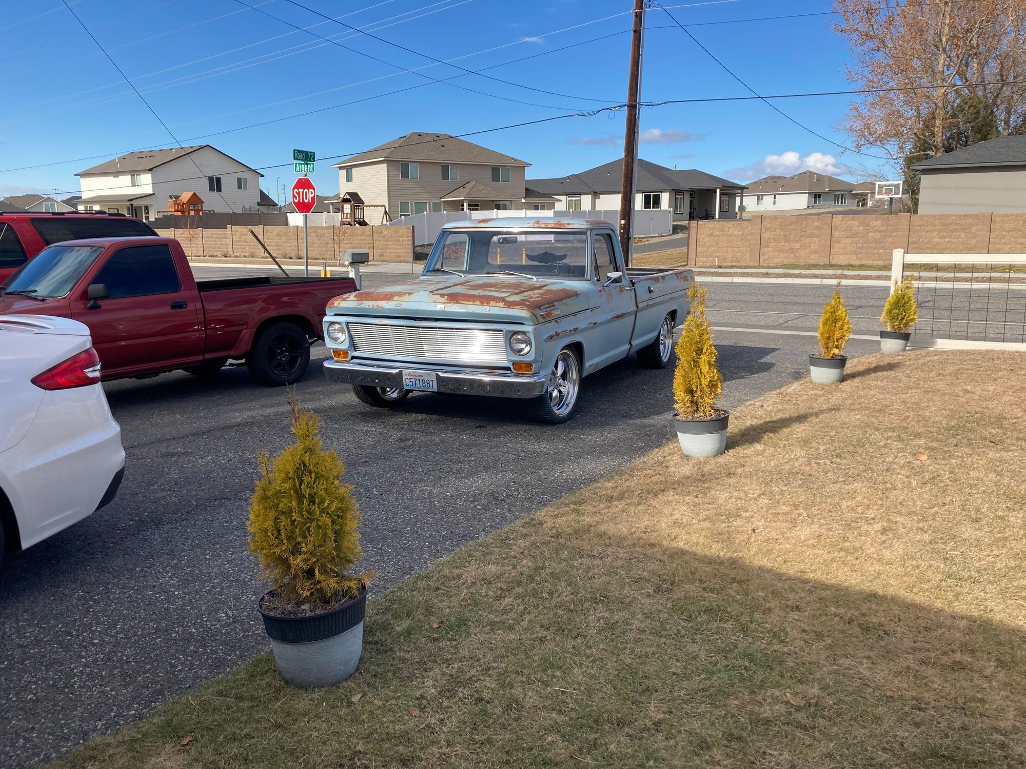

OK!!! I think the exterior of my truck is finally done!!! The newly revamped custom grill is done and mounted.... ....
Here is the "Before Shot"
And here it is now...
Pictures of the roll pan in the day light as well...

Keep doing what you been doing! Like the grill. Tail gate and roll pan are wicked, I like it! Truck looks great.....

Decided today was good as any to rebuild the passenger door so I got to work on it...
cleaned off the rust and got it ready for primer & paint
Primers on

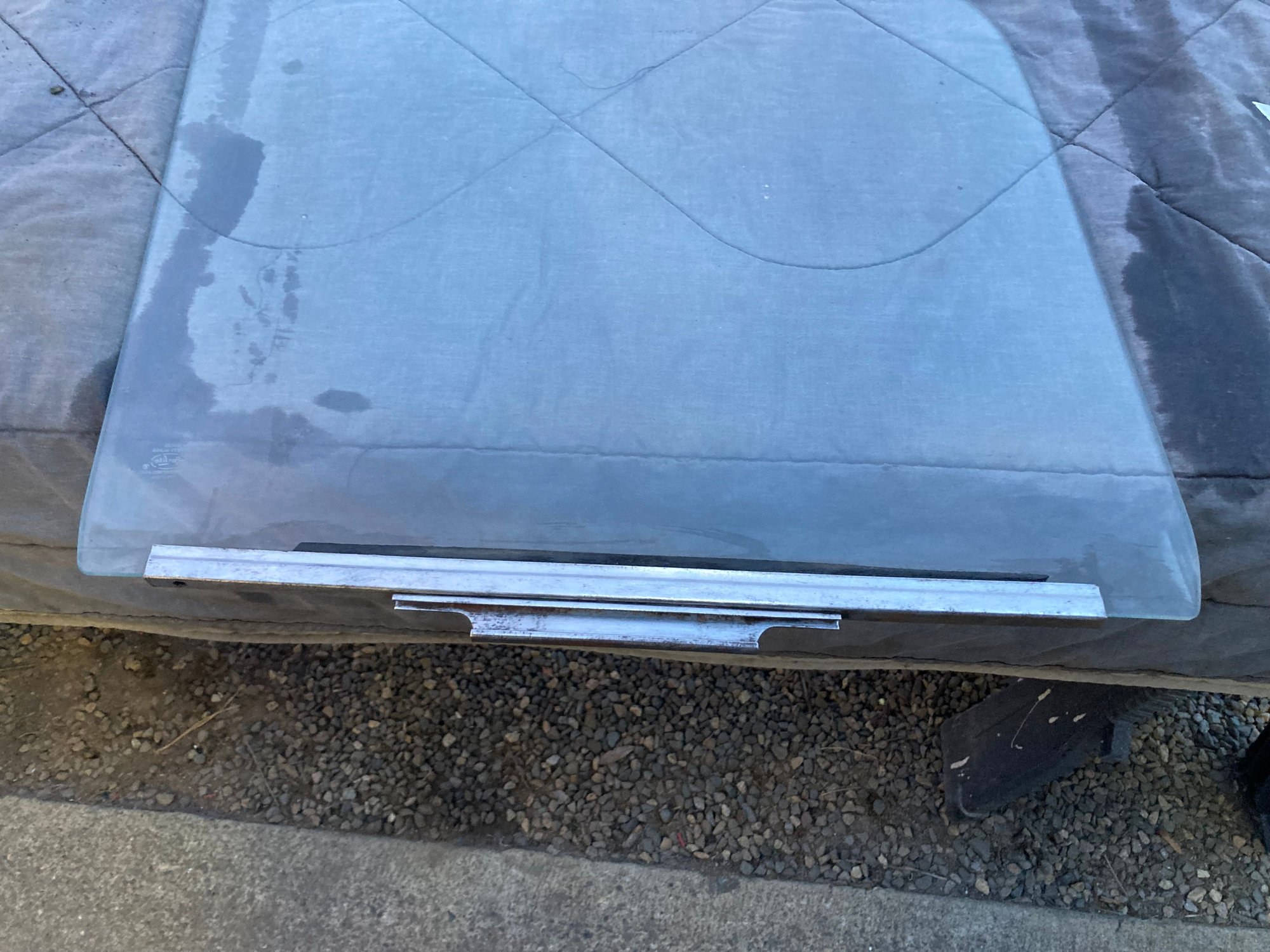

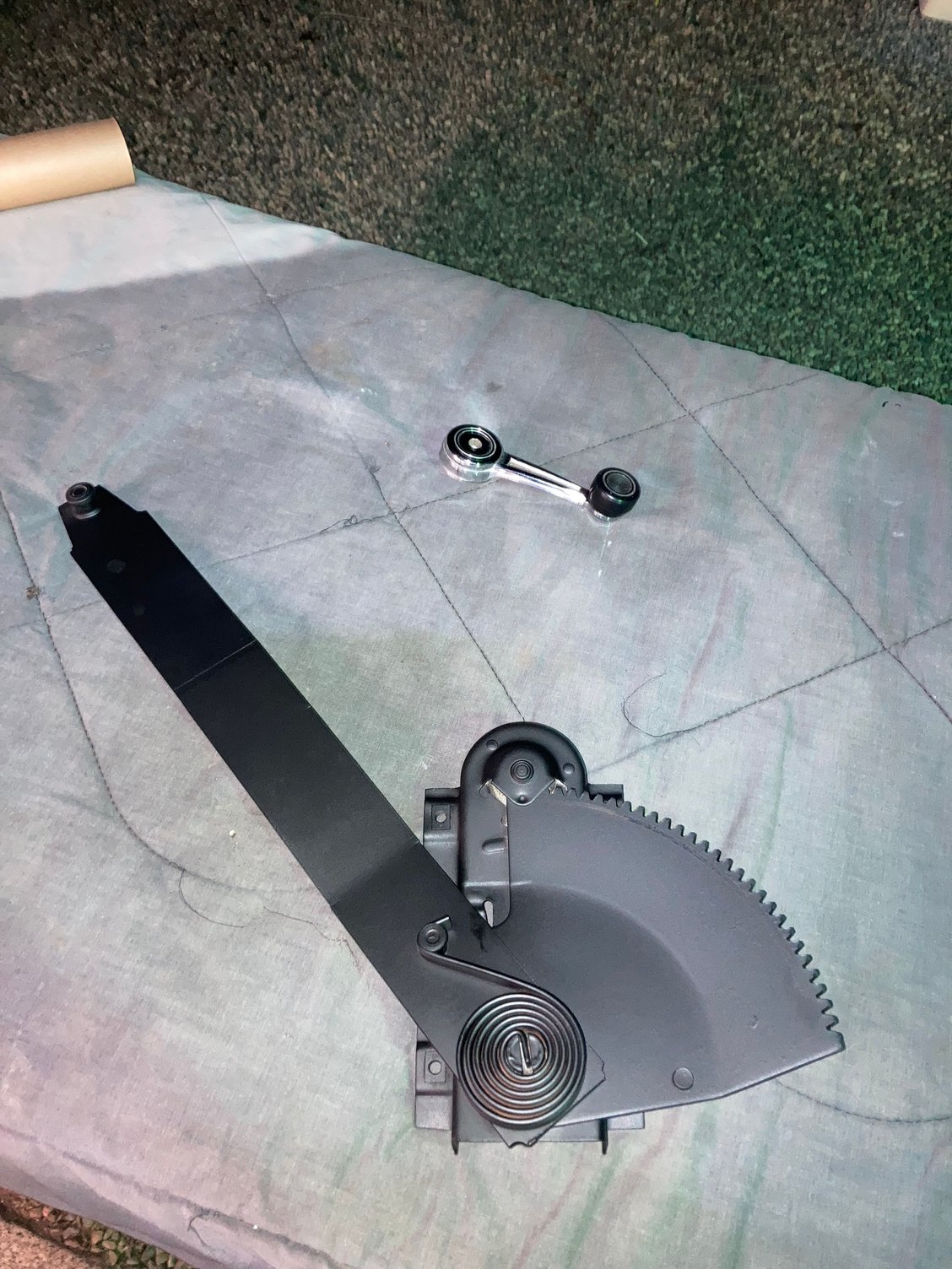

rebuilt the passenger wing window (same steps as the drivers side)

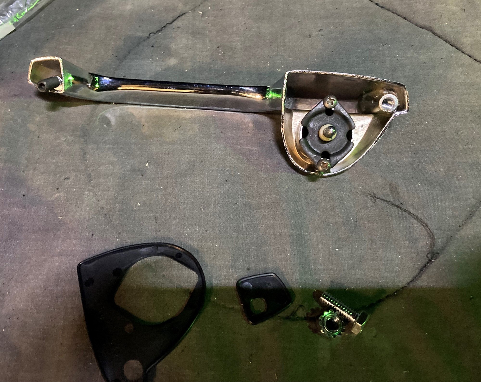

Removed the old door handle and lock
removed all the old felt/weather stripping
Laid out the new handle for assembly
New handle and lock installed
Sound deadener installed
sprayed the moving parts with fresh lube
window crank cleaned up and painted
New lube on the channel
sealed up all openings that could let in cold air
installed and cleaned up the door panel.
