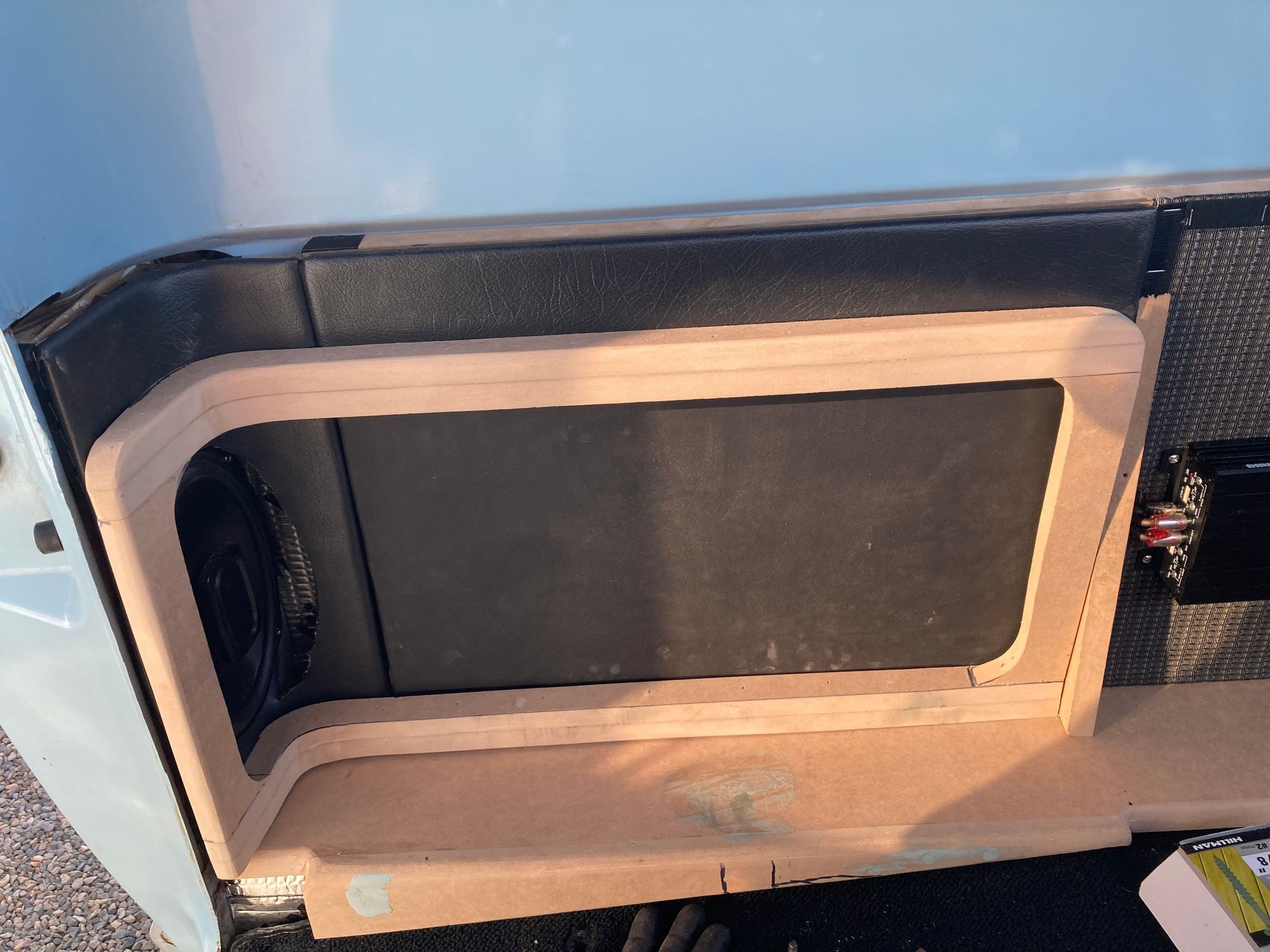

Started making the curved speaker grill cover/decorative panel.
The center insert panel with the retro fabric is done and the frame is covered with padding. I'll pull the center insert out and wrap the frame with the black vinyl next.

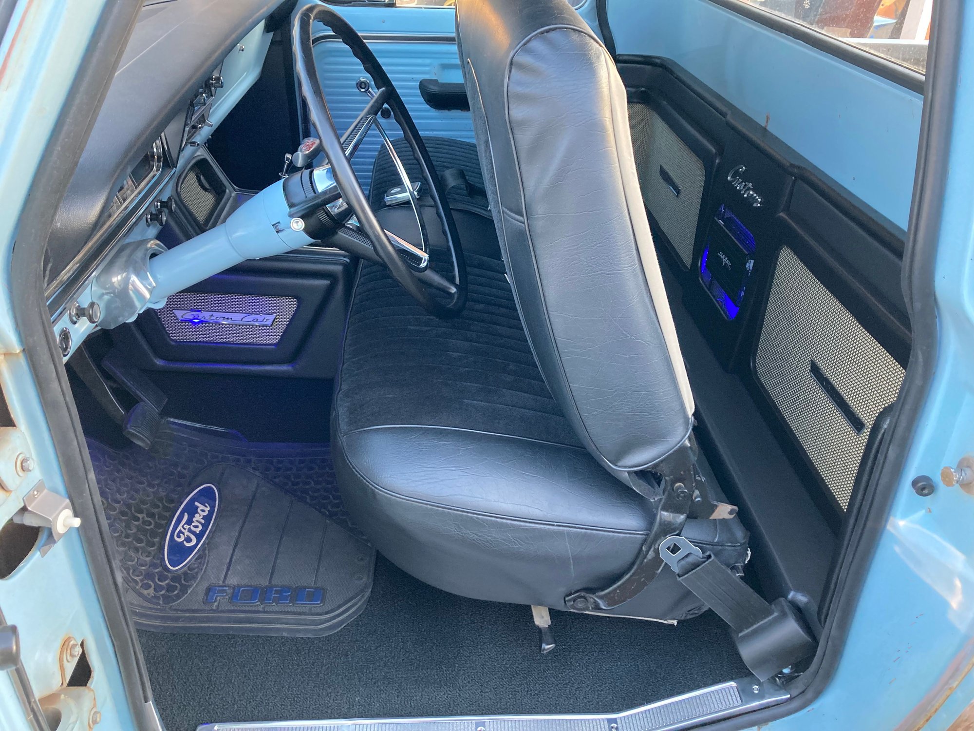

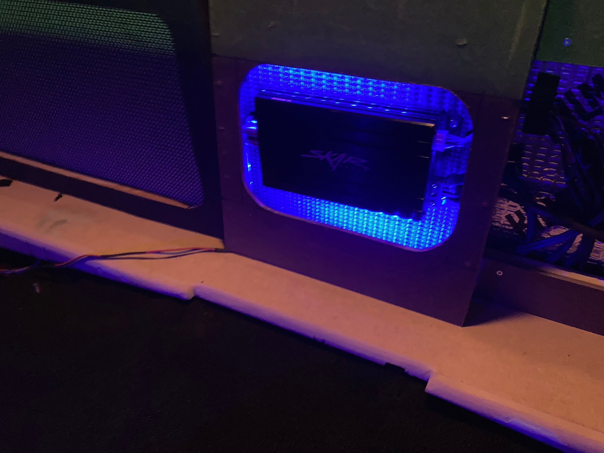

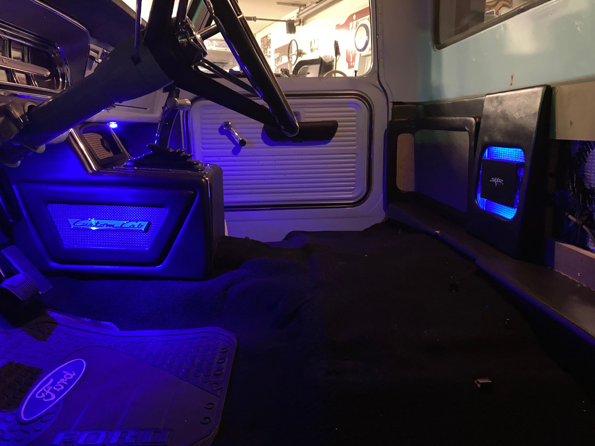

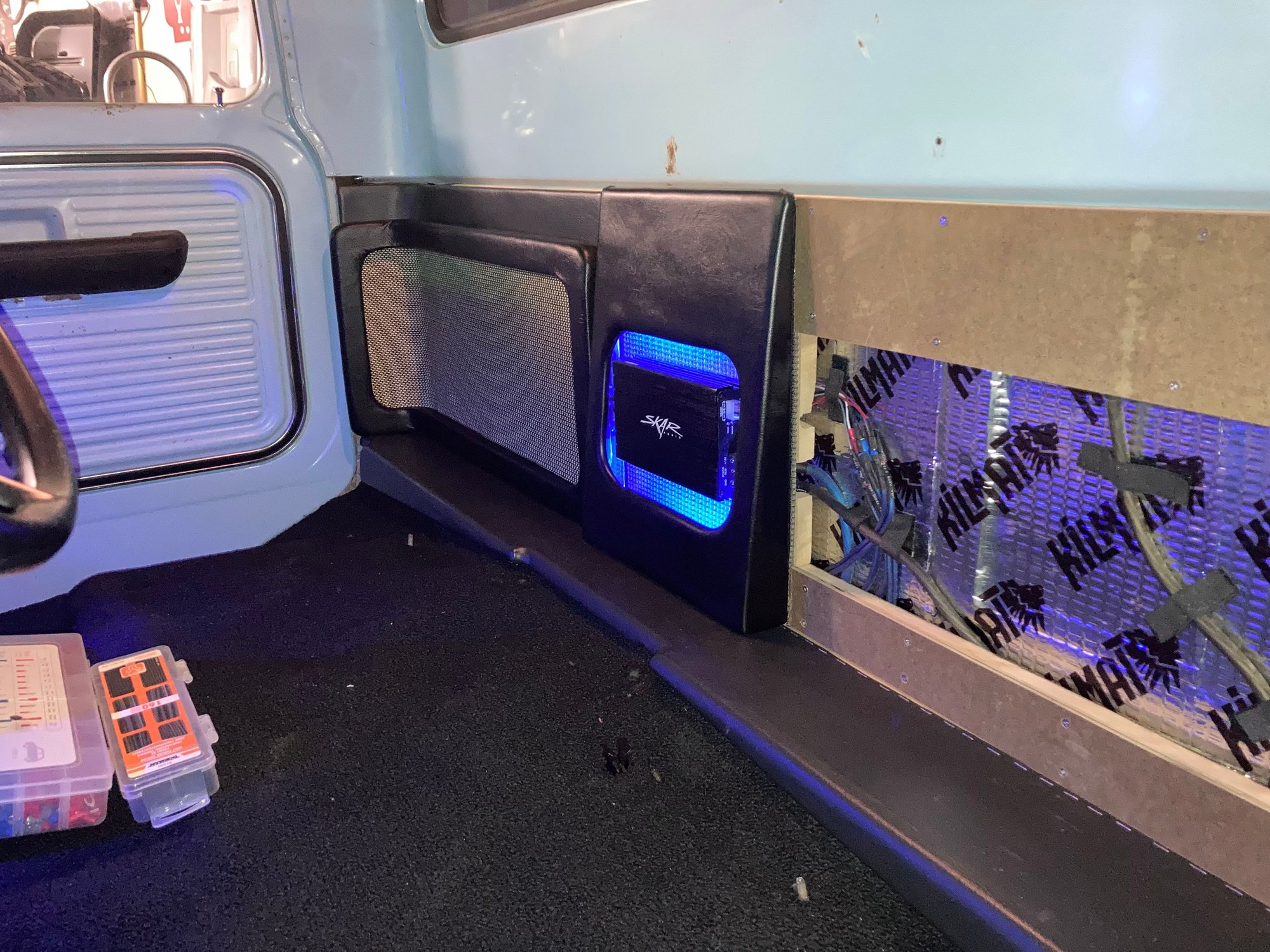

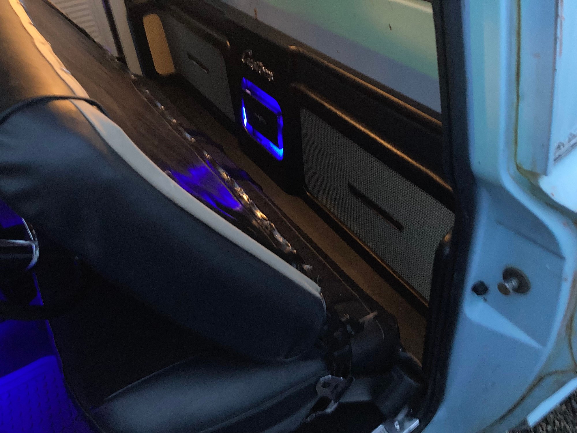

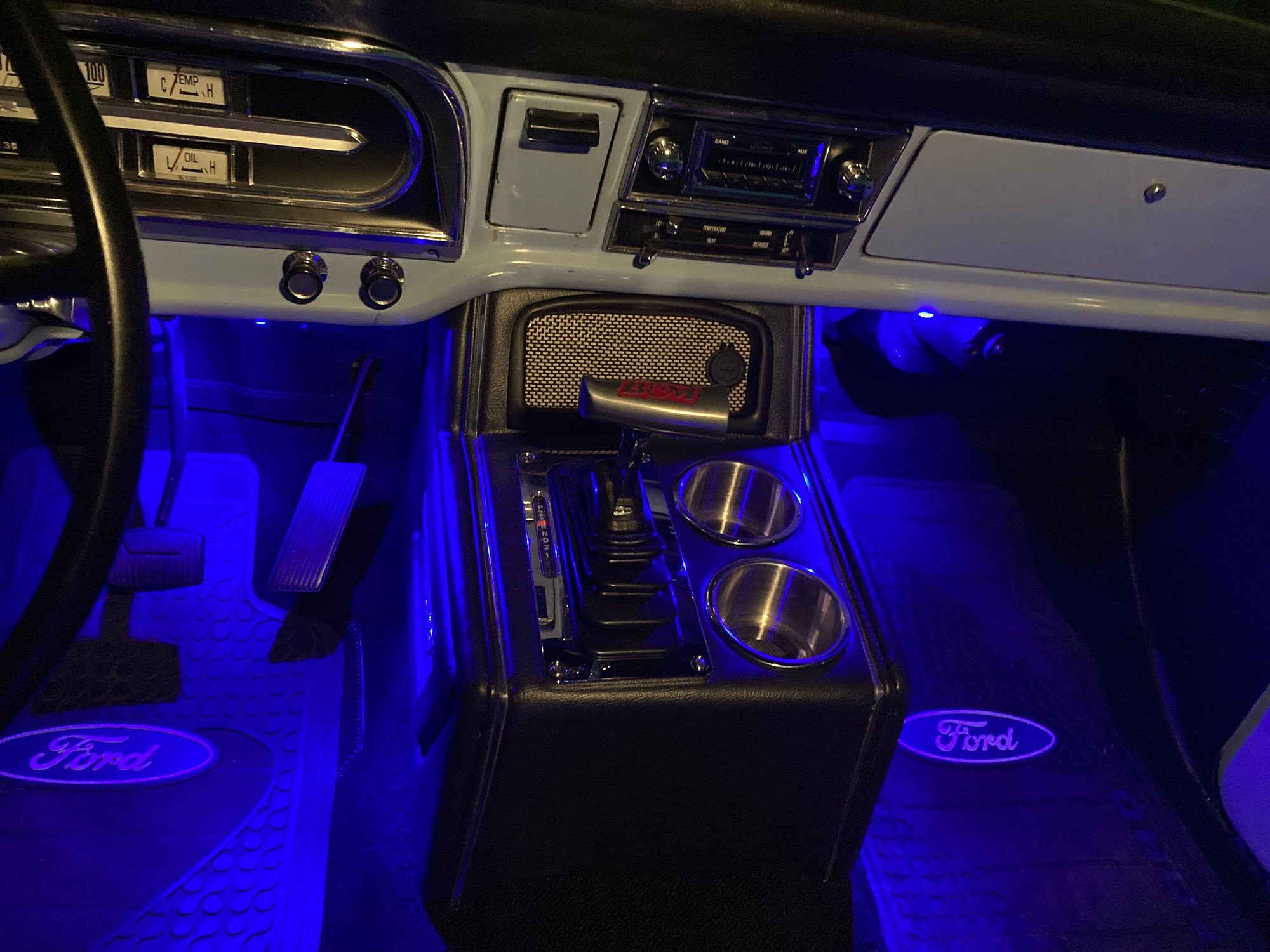

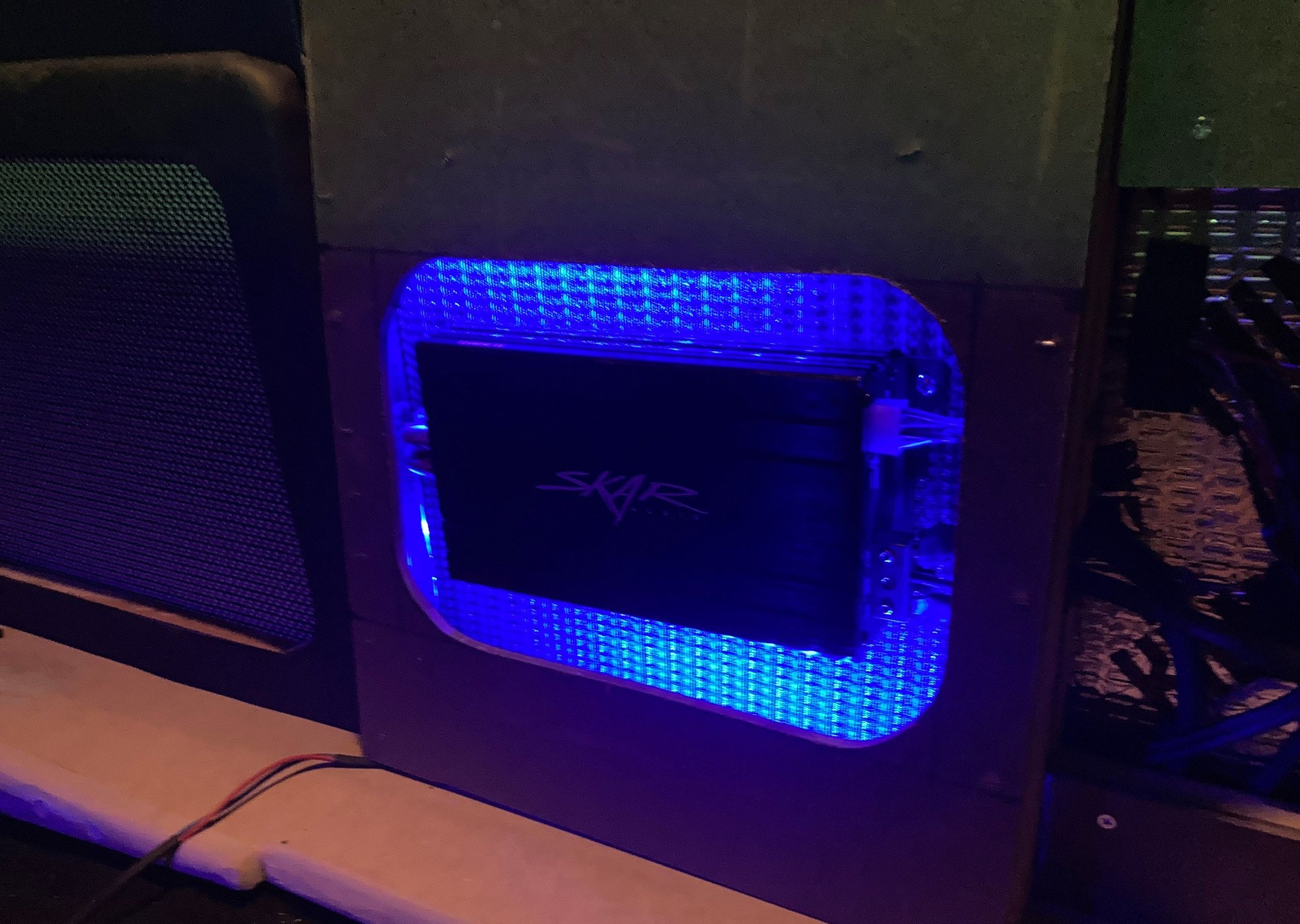

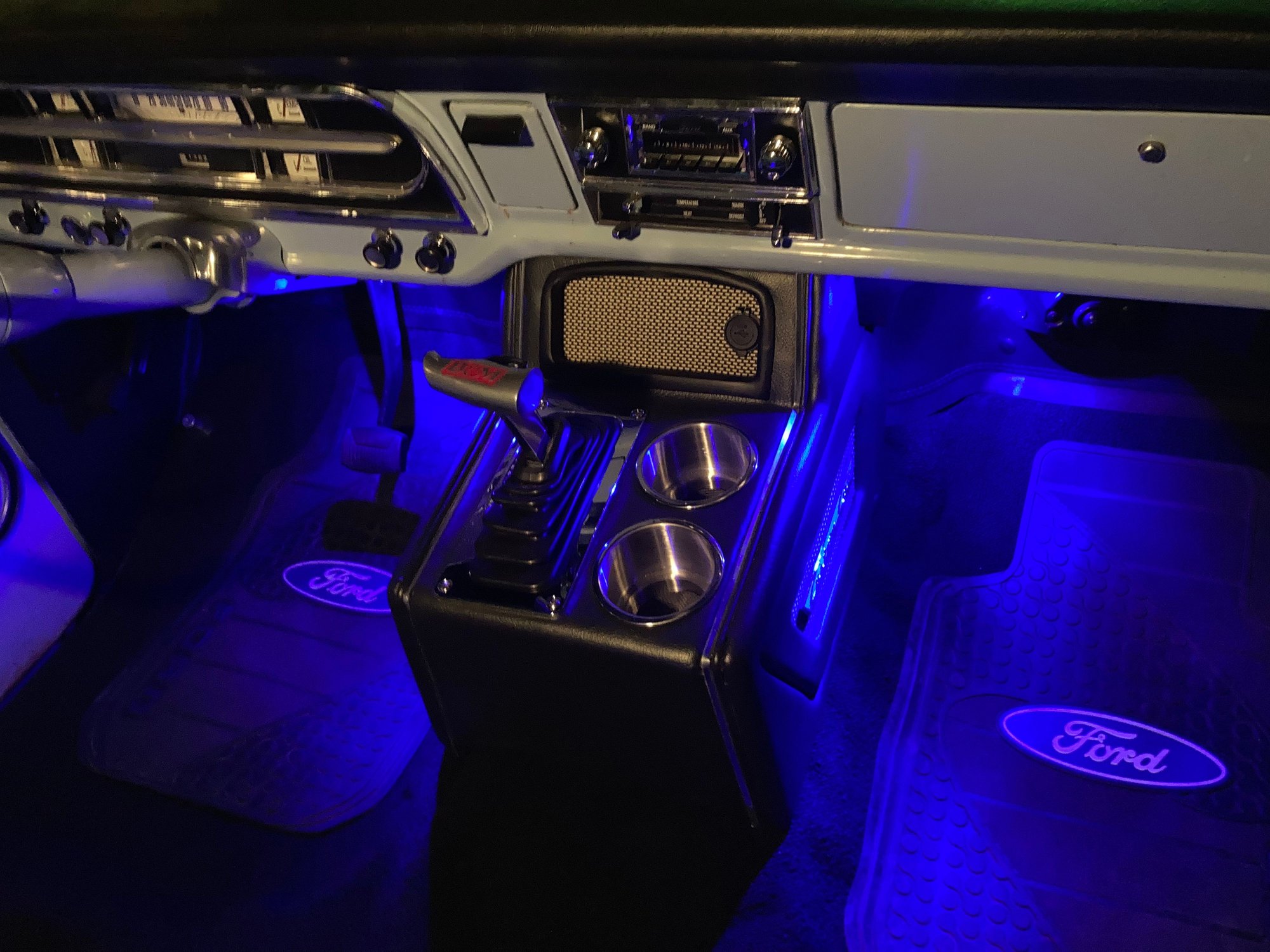

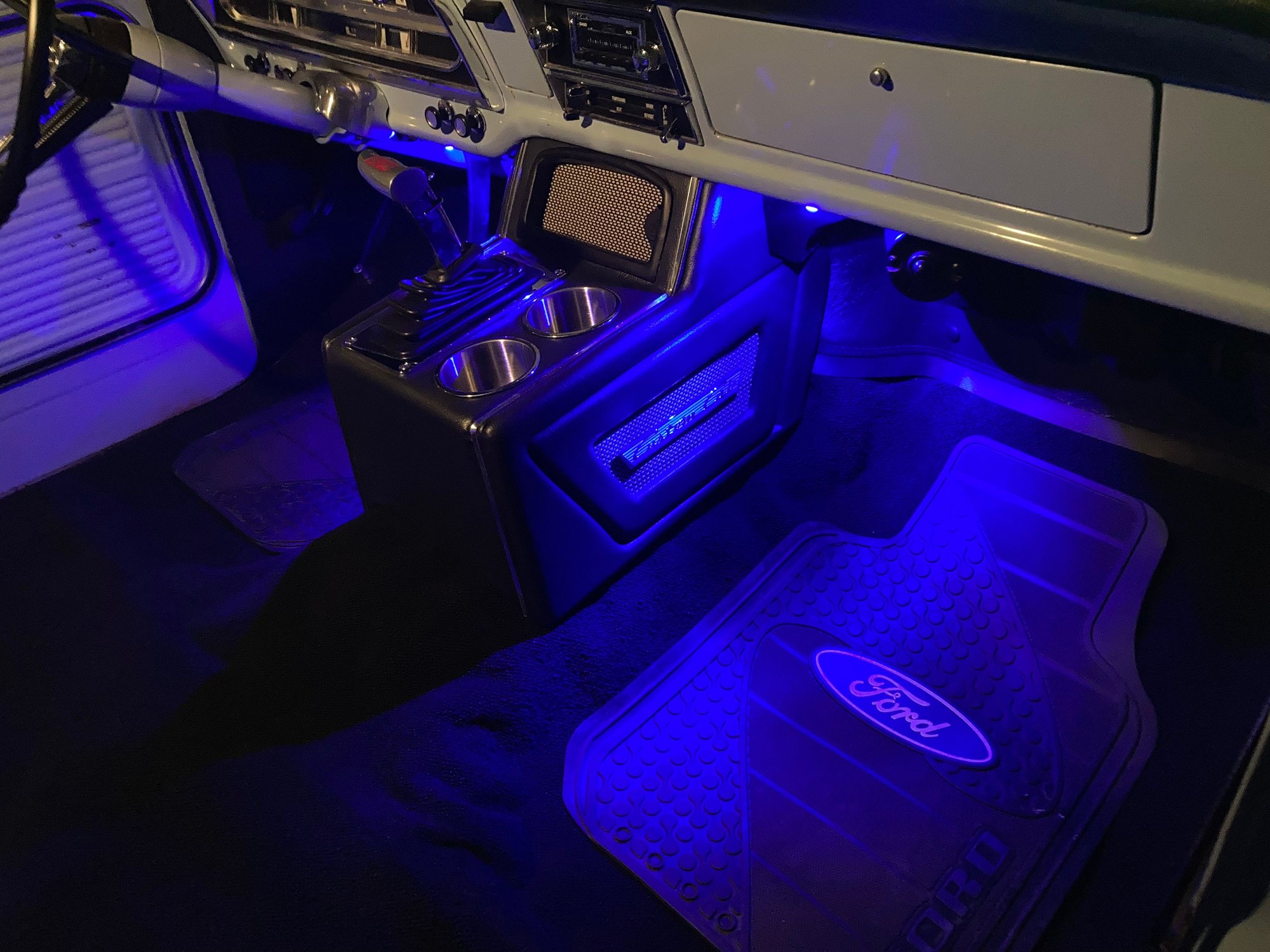

Added some backlighting LED's around the amp cover and also under the dash. Everything works off of the dome light switch so they are only on when the doors are open or when the switch is turned.

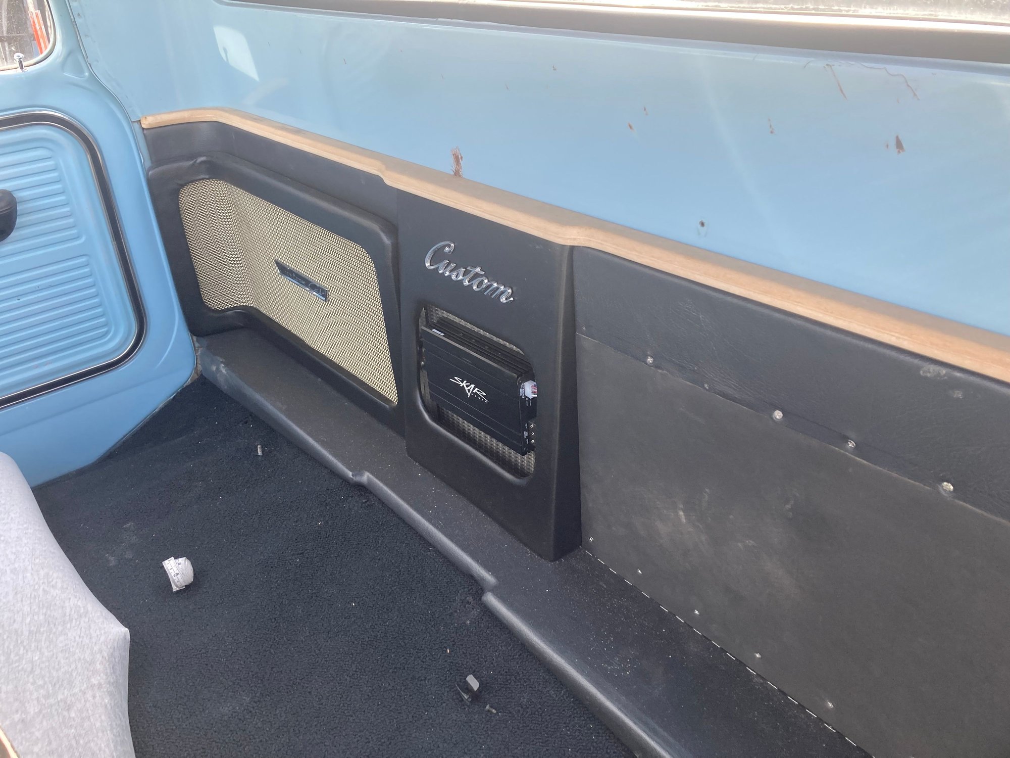

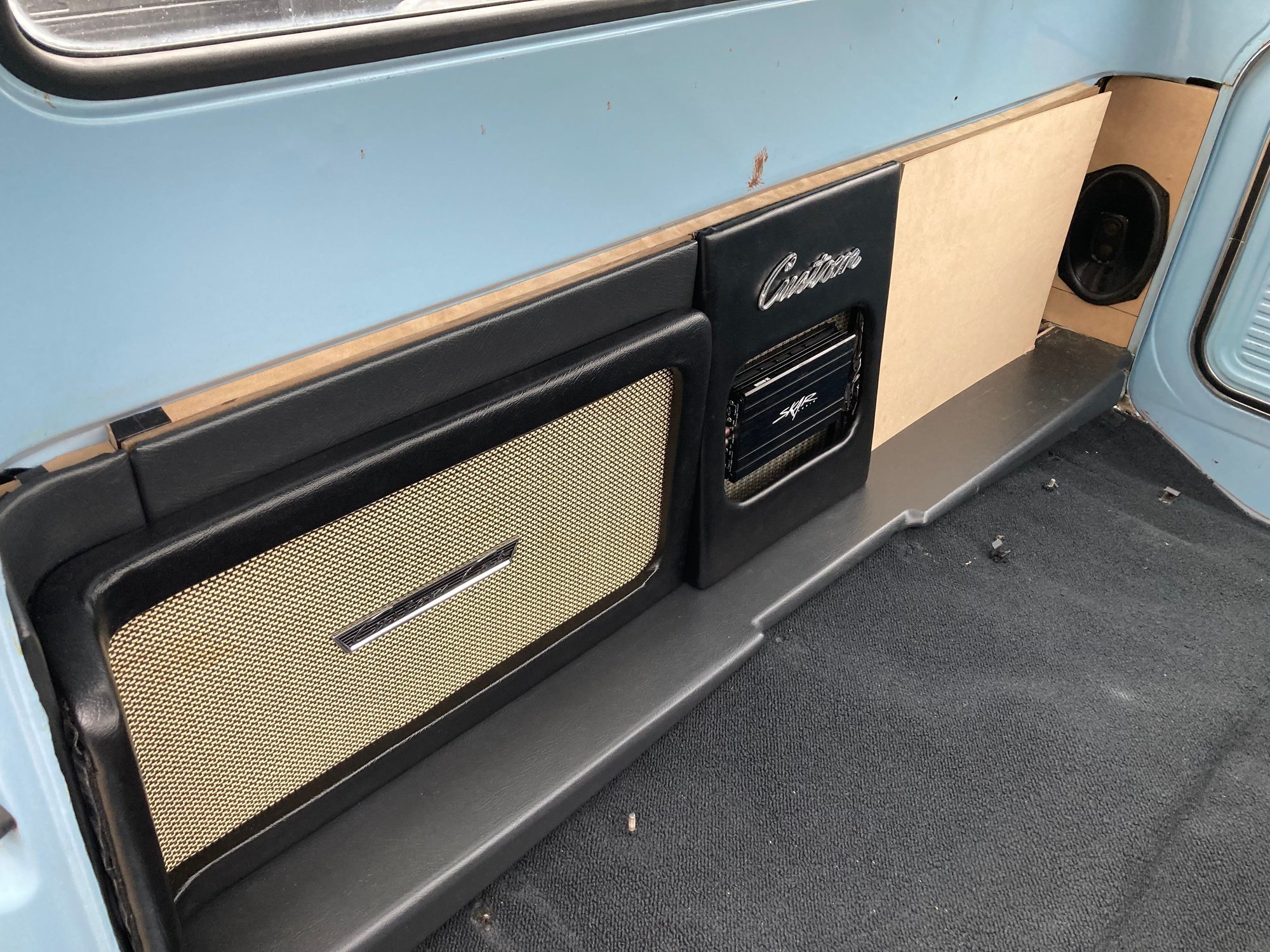

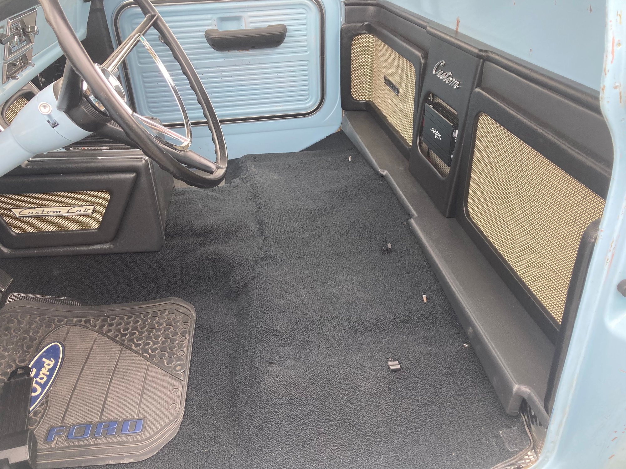

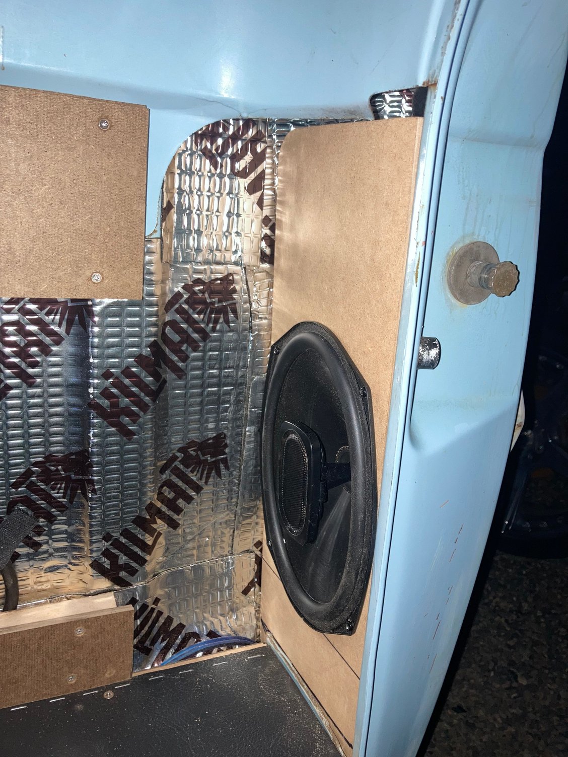

Finished the passenger side rear panels and the center amp surround. Now I need to build the mirror opposite for the drivers side. I still have all my patterns so I should be able to flip them and use them to finish out that side as well. Then when that is finished I can make a top cap that will finish off the rear upholstery.

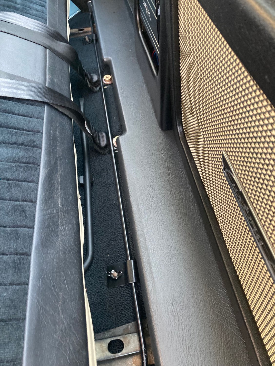

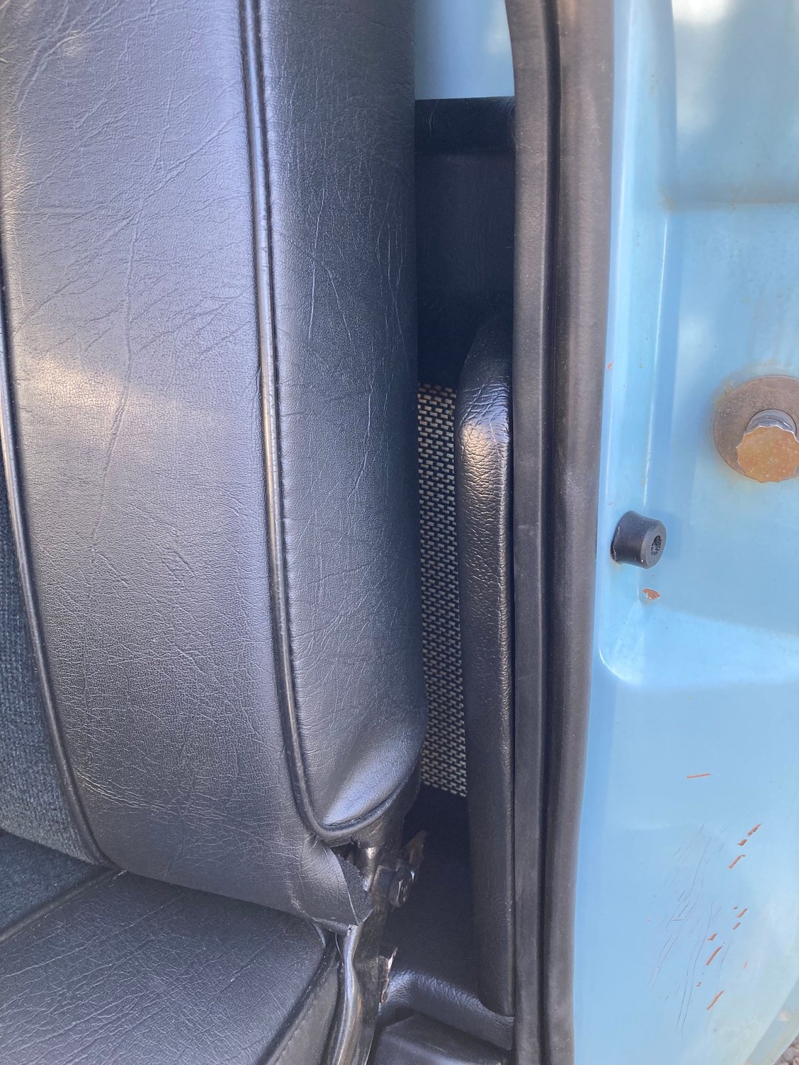

It's a snug fit but a simple 3/4" thick x 6-1/8" wide x 18" high MDF board tucks nicely in the space and I replaced the little rubber door bump stop screw with a longer 1" Stainless Steel screw that pulls the board tightly against the wall

added some emblems to help break up the big open spaces and add in a little chrome...

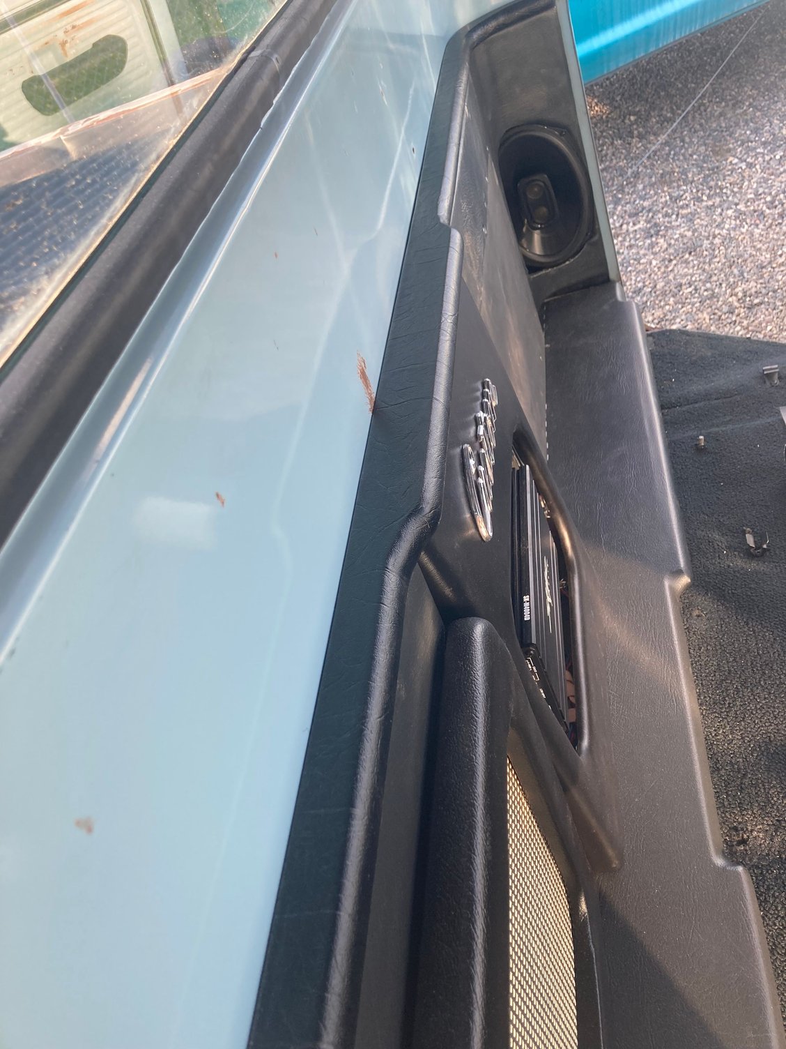

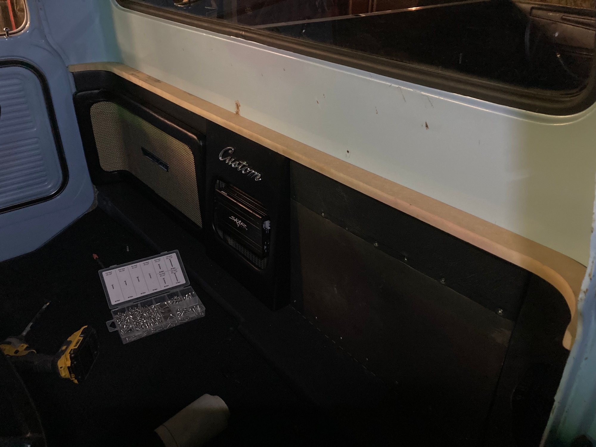

Made the top cap but it just didn't feel right so straight, so I trimmed it back until I liked the look and flow.
Wrapped it and put it back in and it fit like a glove...

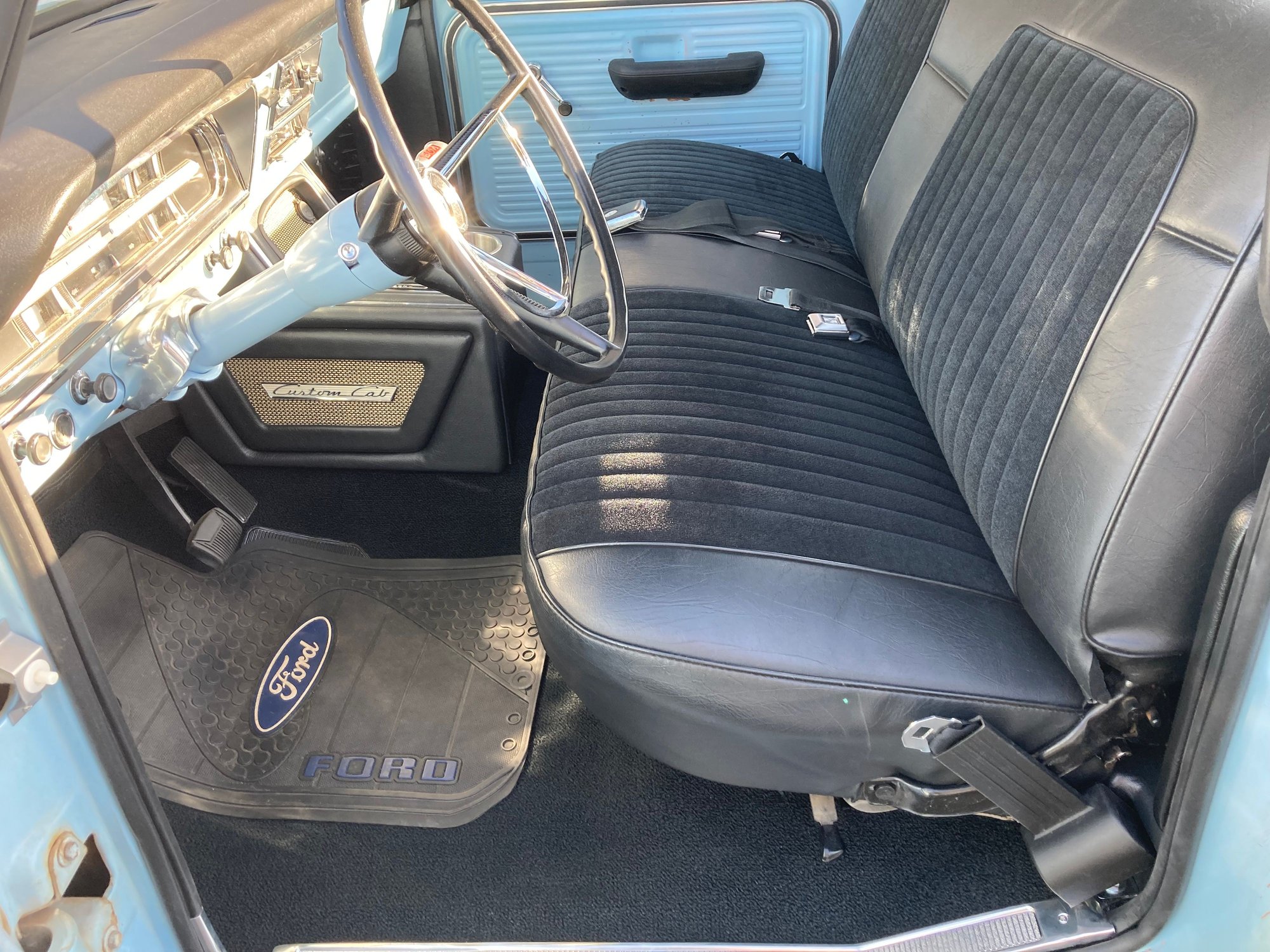

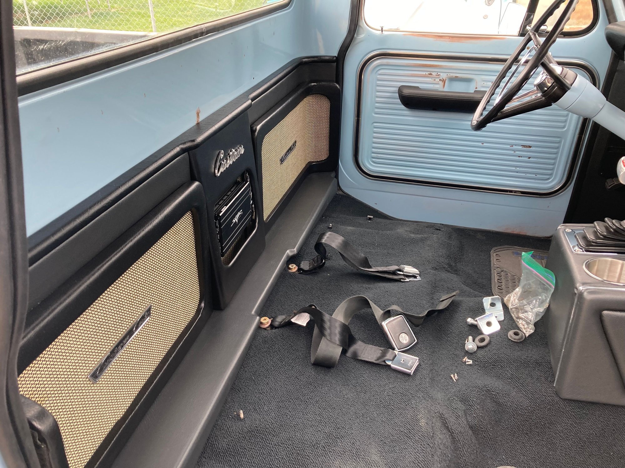

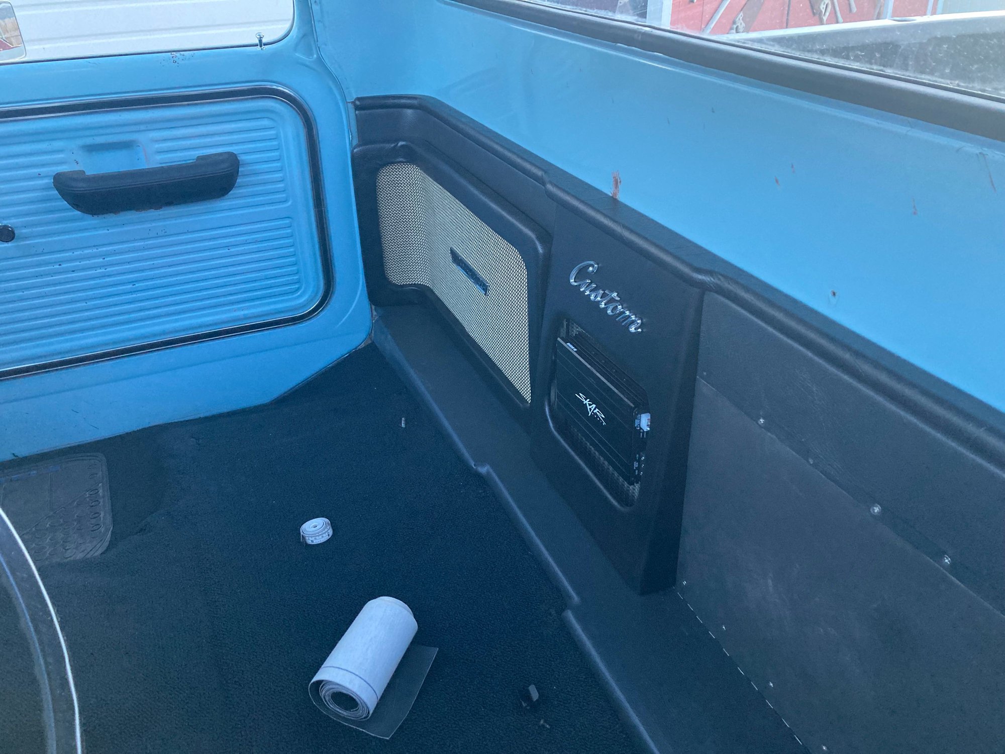

Final install of the rear panels and interior!!!!

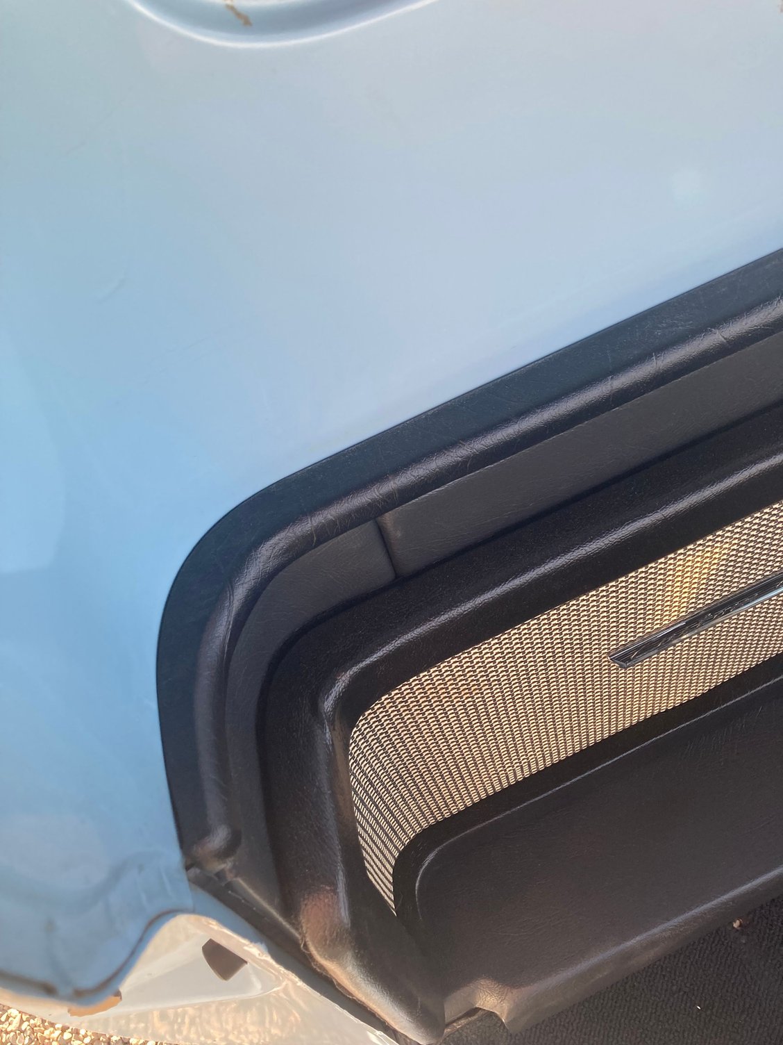

I finished building the drivers side speaker cover panel. Wrapped it and added the emblem then installed.

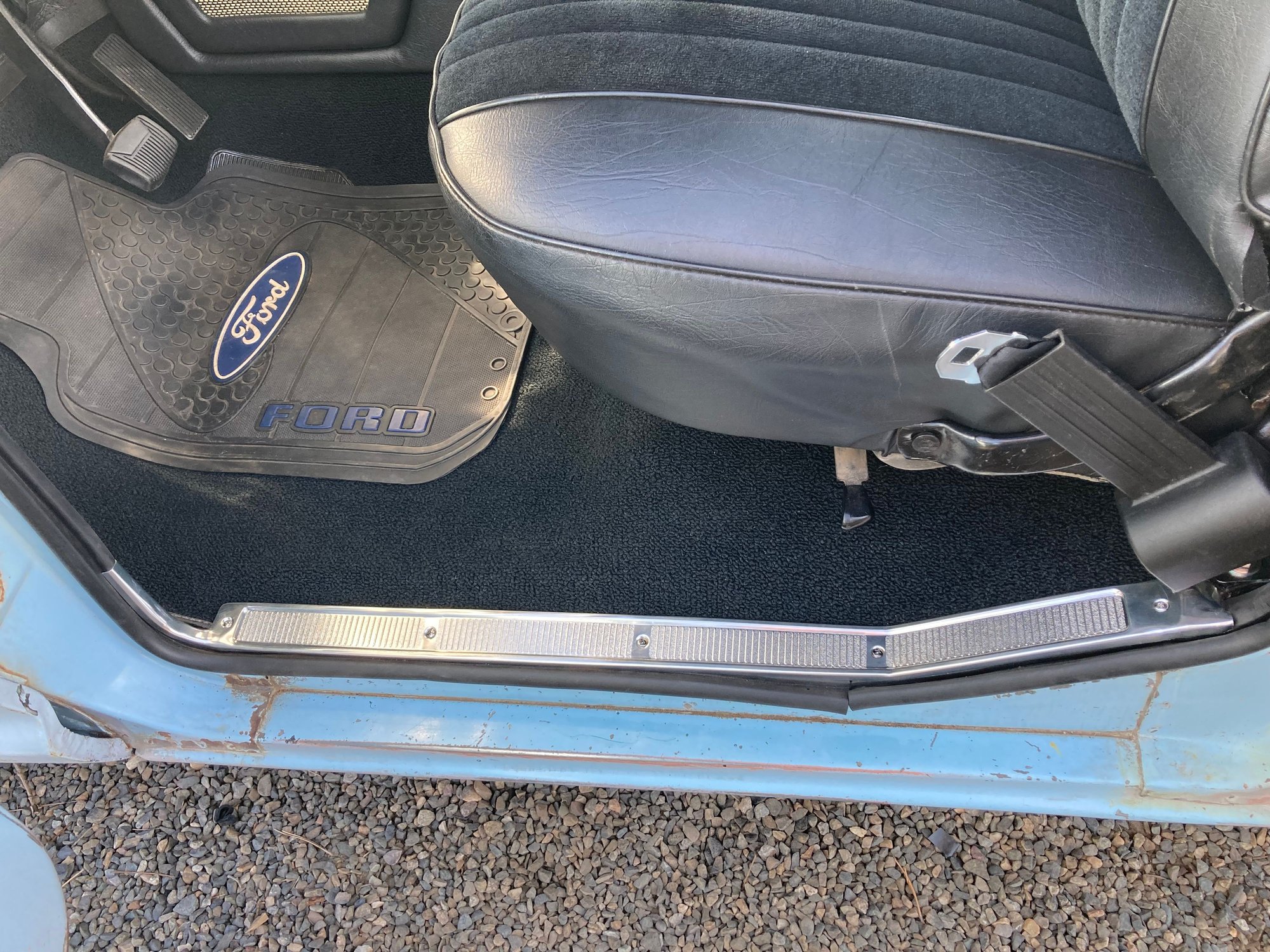

I finally pulled out the door weather-stripping and installed it
Panels fit nice and snug to the new weather stripping
Also pulled the new aluminum door strips out of storage and installed them as well...
Crow bar and jack crank installed

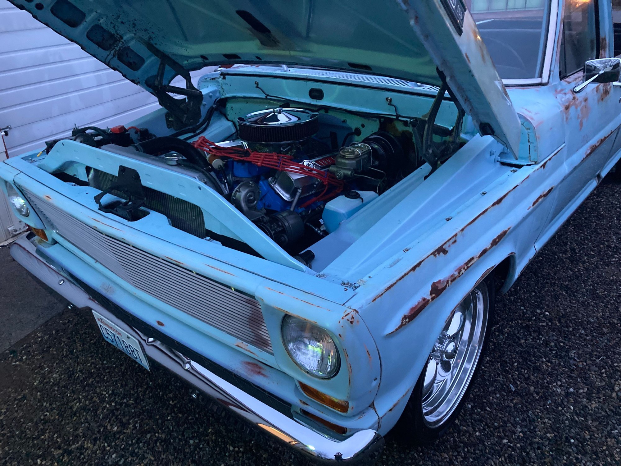

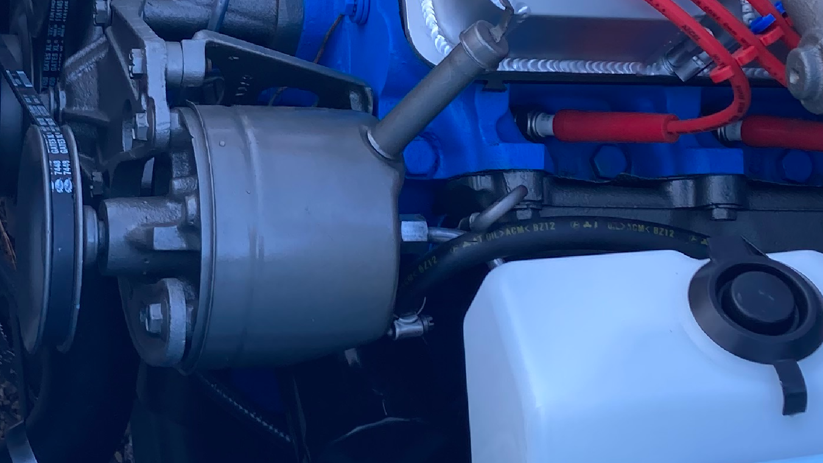

I already had a failure that needs to be addressed. The power steering pump seals must have been ready to fail or there is a crack in the housing. I didn't notice any leaks when I took it apart so I reused the pump. Anyway I picked up a new pump and a new high pressure line as the one that's on it won't allow for any belt adjustment (See picture below). The line is hitting the dip stick and it only has about a 1/2" of adjustment for the belt. The new line has a tighter bend right off the pump and should allow for full adjustment. Probably better this way now as everything on the steering system is new or rebuilt.

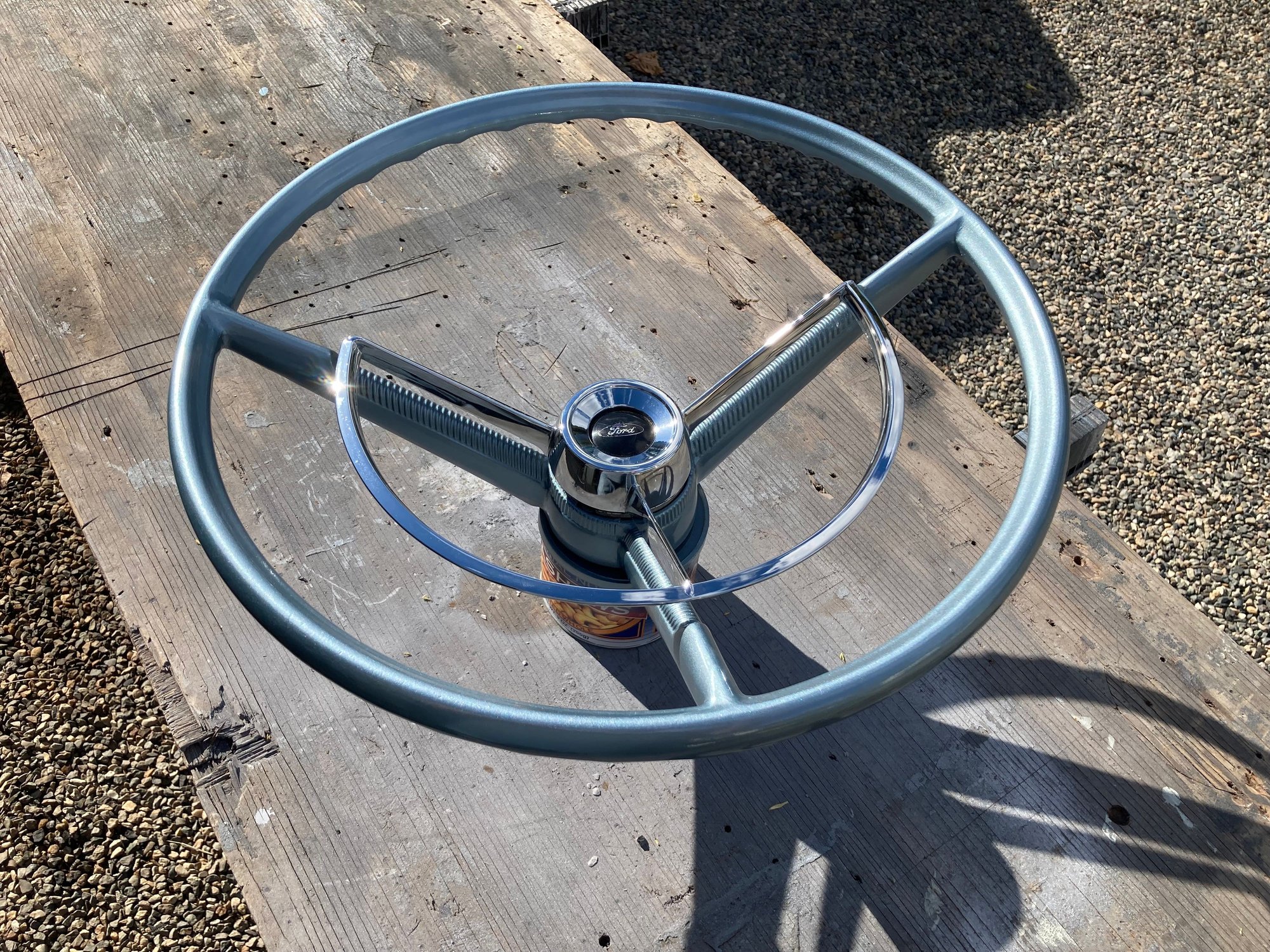

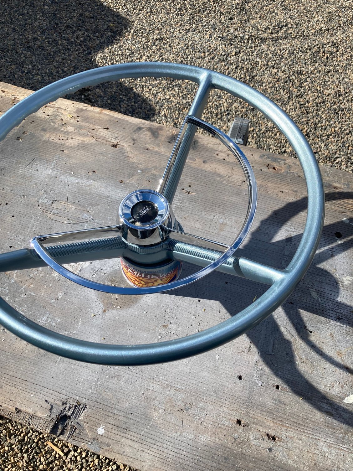

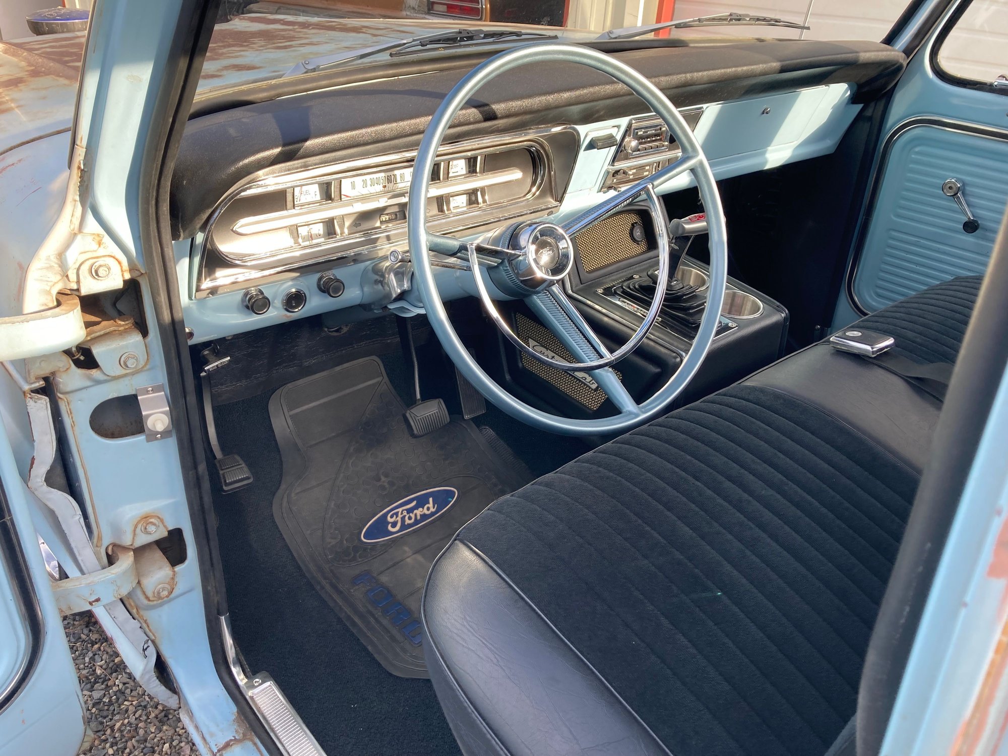

Landscape and house projects got delayed a bit so I was cleaning up the shop yesterday and ran across the original steering wheel for this truck. (I had cleaned up and repaired the cracks on one of my spare ones and painted it black so that's what got installed into the truck.) As I was looking this one over it had sections that were a silver light blue metallic but most of it was worn off. I started looking through my paint as I was sure I had a color that was really close and sure enough I did. So I sat down and repaired the cracks and got it prepped for paint. The original color wasn't a match for the light blue that's on the truck so I was a bit unsure about it but after installing it I think it works and will stay.

From: Pasco WA
RGTB
Looks very nice, what did you repair the steering wheel cracks with?
Richard
Thanks
The black steering wheel I used JB Weld and posted a thread about it but for this Light Blue Metallic steering wheel I used superglue and baking soda. I'm much happier with the superglue steering wheel because it heats up when mixed and is super strong very quickly. When it heats up it seems like it softens the steering wheel material a little and then solidifies. I have no proof of that but when sanding it back down it looks more like a blended material then something that just filled the crack.
Not my video but a simple example.
Here is my thread about repairing the steering wheel and how I got all the separated cracks to line back up. I did the same process on the blue steering wheel but used the superglue and baking soda as the filler/bond.
