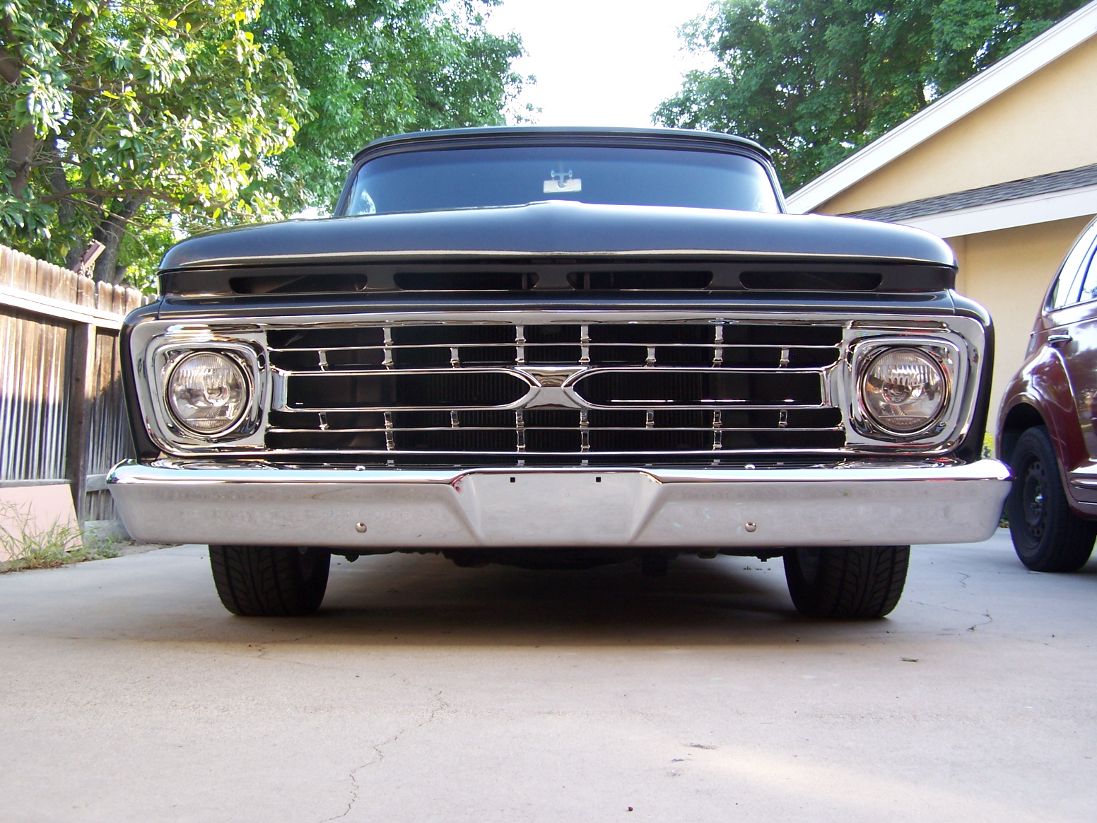

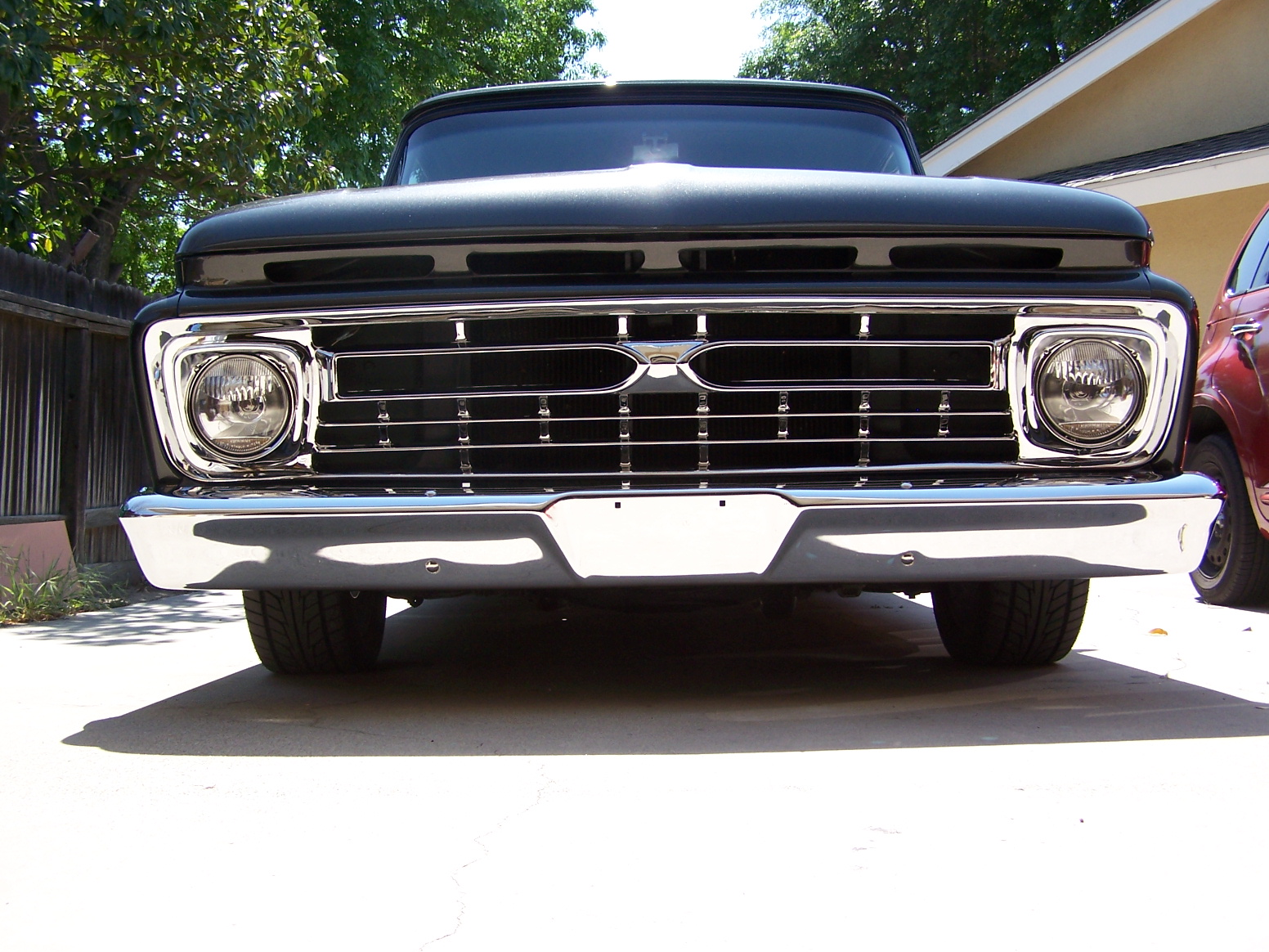

Customs are nice but sometimes difficult. All depends on what look your going for. Here's two pictures of my 66 custom grille on my 64.
"Before"

"After"
"Before"

"After"

Beautiful work! I'm guessing that is an aluminum grille?
I'm still walking around both of the ones I have trying to decide what to do. You are correct about customs being difficult and a lot of work. Cut it apart, TIG new stuff in, grind the welds, then polish it all, then anodize. You know after typing that I realized those two sentences amount to a week or more of work.

It's actually a steel grille.
