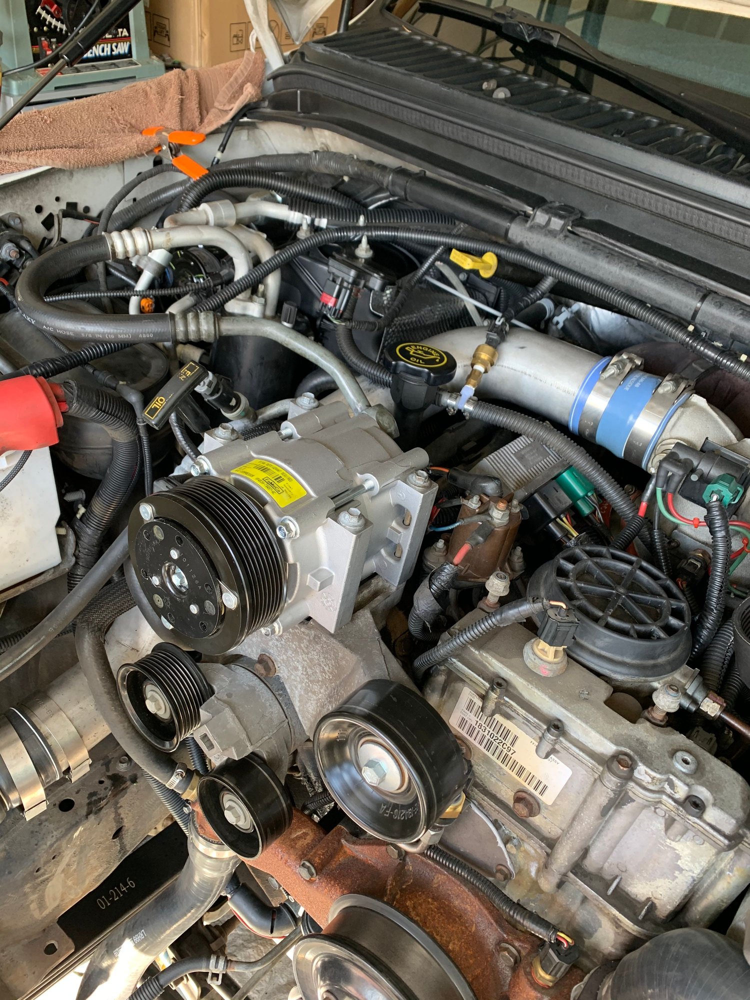

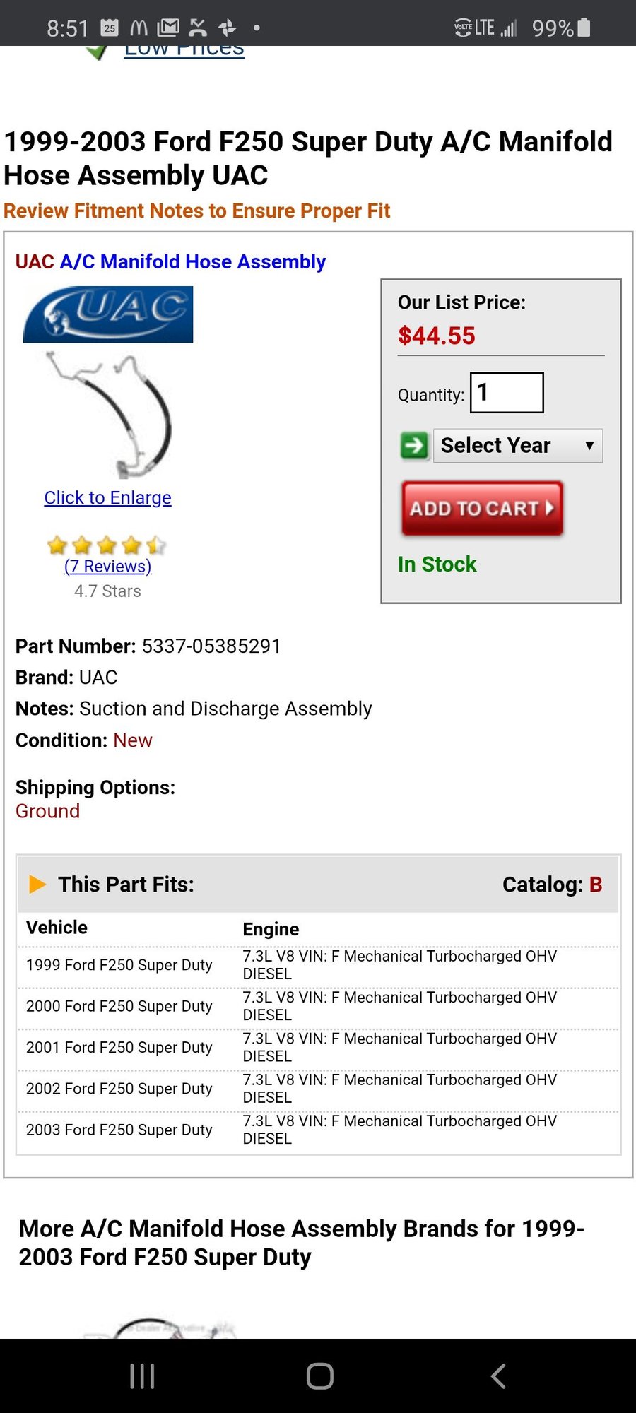

The OE Ford manifold hose set off the 7.3 compressor is NLA, (from the dealers anyway) you may find it in aftermarket, Tasca, Etc. Captured in the first pic below is the V-10 I replaced the manifold studs, nuts, and gaskets on, the A/C compressor is below the manifold to the right, notice the manifold attaches to the side of the compressor body, whereas the 7.3 compressor attaches to the rear of the compressor body. Second pic..

All hoses are available and pretty easy to get.

So it’s looking like the compressor on v10 sits at the bottom of the engine what !?! That’s crazy well it looks like I’ll be getting lines too lol don’t I have to vacuum the system out too ?

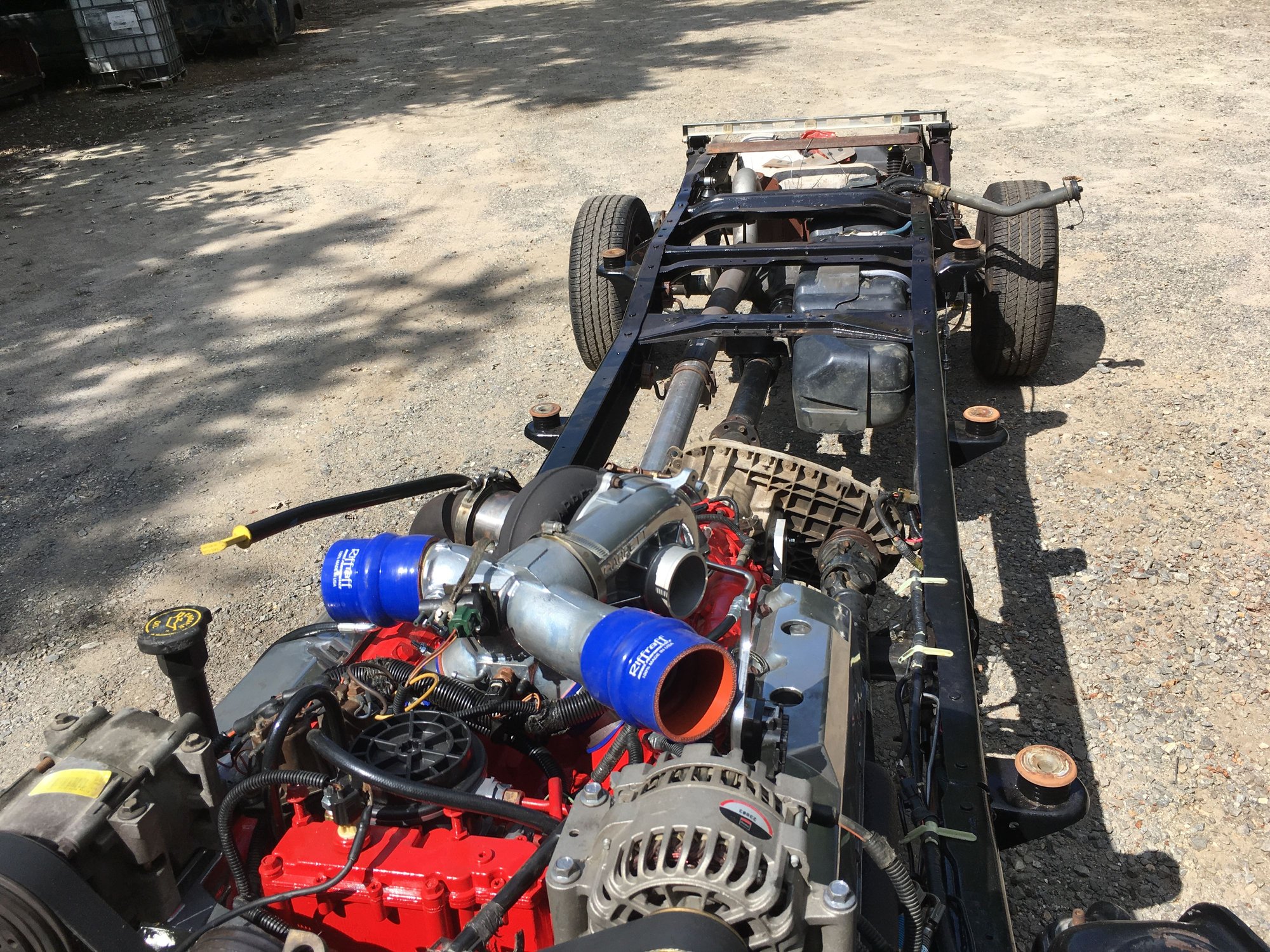

Posts: 12,782
Likes: 2,142
From: N.GA Mountains
Wait.
This is a V10 to 7.3 swap?? There is only one way to do that right and maybe a million ways to do it wrong....
I’ve done a bunch of these swaps. If you aren’t using 100% of the 7.3 wiring harnesses, etc (bumper to bumper), you’re doing it one of the wrong ways.
Youll absolutely have to use 7.3 AC compressor and lines.
I literally use nothing from the V10, 5.4 or 6,0 when I swap a 7.3 in one of those trucks. Just the body and suspension.
This is the last one I did.
2006 F250 lariat with 7.3 PSD.

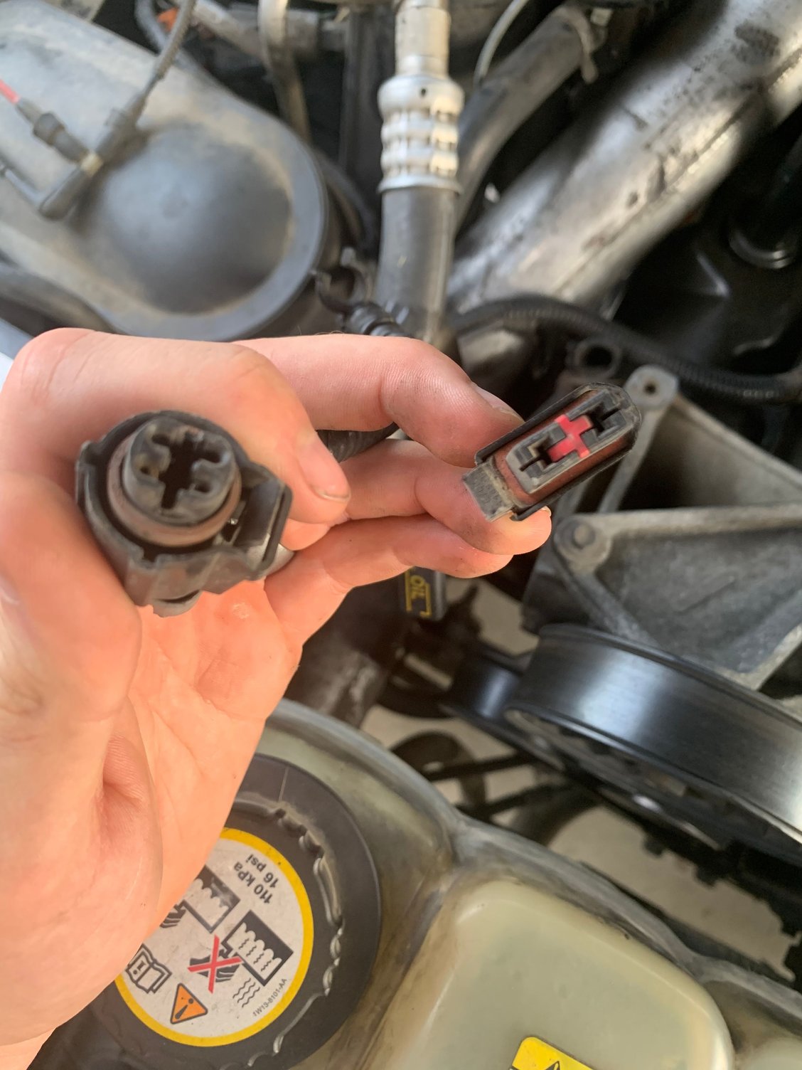

I have found what I believe is the ac compressor plugs ? Would I still be able to use these for the 7.3 compressor? And would the ac lines that come off still hook up the the evaporator that’s in front of the radiator? One line was cut off and I’m thinking that went to the compressor from the v10 and it’s just been hanging off to the side would this cause damage to my ac after I vacuum it ? I live out in the deser

You absolutely need a 7.3 lineset from compressor to condenser and accumulator/dryer.
The round plug will go to pressure switch that is on the line to dryer and the flat plug is for compressor clutch.
If there was not a compressor failure or similar, you can just evacuate the system and add oil and refrigerant.

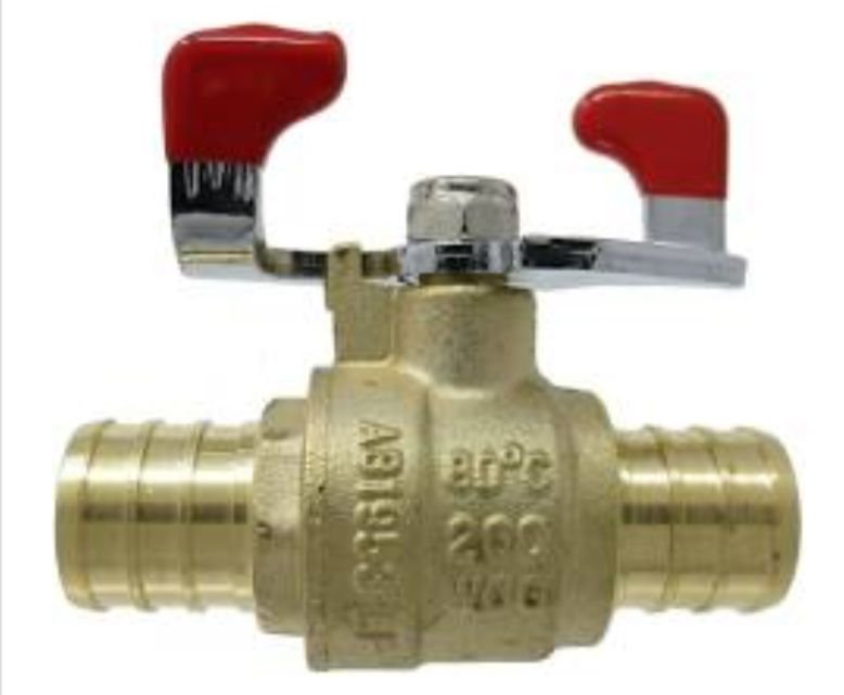

I strongly recommend you install a 38639 orifice tube for colder AC. I also like to add a valve to the heater core supply (from block, the return is to water pump). Closing this valve in summer makes the air/cab even colder. The best valve I’ve found is a 1/4 turn 3/4” PEX barbed valve. I like to put it on the hose where it runs parallel to the firewall.
