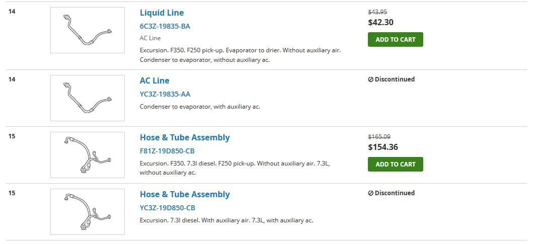

It's a long shot, but have you thought about buying the same hose for non rear A/C applications? You'll possibly be able to graft your rear A/C aluminum hose onto the new hose assembly. This will give you an OE part with the GoodYear rubber hose.
https://www.tascaparts.com/oem-parts...y-f81z19d850cb
my phone doesn’t like this site a lot lol I just saw this but I went and found a used one for about 100 bucks so the odd thing is the ac line isn’t a split line . I couldnt fix the line I took it to get tig welded and the line was falling apart on itself. My question next is do I need to worry about the ac oil absorbing moisture ????????i know the oil is hydroscopic but I don’t know if me replacing the accumulator and vacuum and charge will make everything good ? I live out in the desert and when I first found the leak I just tapped it off till I could get a line . I’m just trying to make sure I do everything right with the ac

Going to a hose shop may be the best idea. I wonder if they can cut the rubber hose where it's bent, and make a boomerang bend metal hose and crimp that in. That hose is the compressor suction hose, it needs to stay rigid. The factory hose for non rear ac system is still avail. Maybe purchase that so you can get the front system going at minimum.

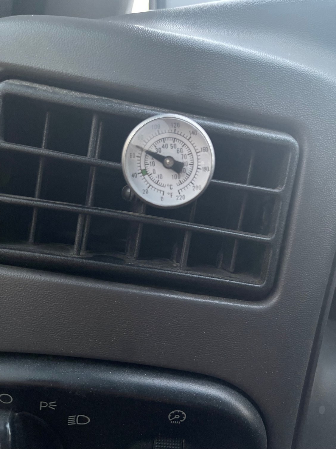

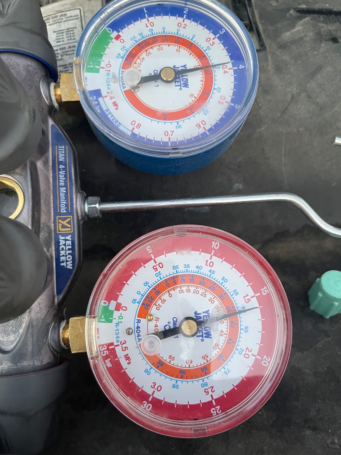

So I just go back from a field training and my wife says that the ac isn’t blowing as cold as it used to it would only blow about 70 degrees out of the vents and wouldn’t get any colder than that it takes a really long time for to even get that cold around 5-10 mins and that was when it was 112 outside and that’s when I’m driving ! I hooked my gauges up to it and this is what I got . These are the readings I got after everything was stable and when I turned it off the pressures on both sides equalized to 7 bar I’m not sure where else to go . The high side is low it should have been at 22-23 bar based on temp outside . Anyone have any ideas ????

Pressures while not running don't tell us much. Take another picture of gauges with AC system running.
the picture I showed with the gauge set was with truck running both front and rear air blowing 3.8 bar (55.1 psi) for suction side and 16 bar (232 psi ) for high side
. temp out side 112
. temp out side 112
My bad. I agree your high side seems low for the ambient temperature. Maybe your orifice tube has failed.

A failed orifice tube is the only thing I can think of that would prevent the hi-side from building pressure assuming everything else is working as it should.
