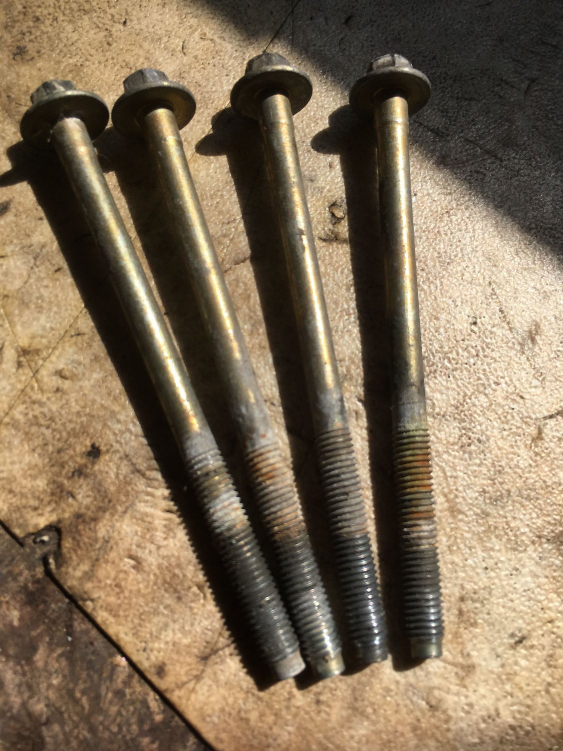

Originally Posted by Mayham7.3
Did you ever get those compressor bolts? I can’t find them online all that comes up is the ac bracket bolts
One step closer!! PM me an address.
