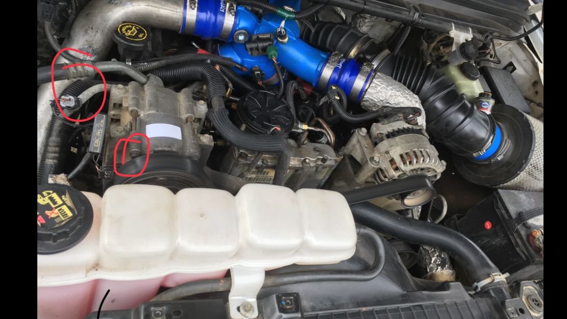

This is where your plugs will go.

Those are the correct AC plugs.
You need the 7.3 compressor and lines.
This Excursion has actually run with the 7.3 in it?????

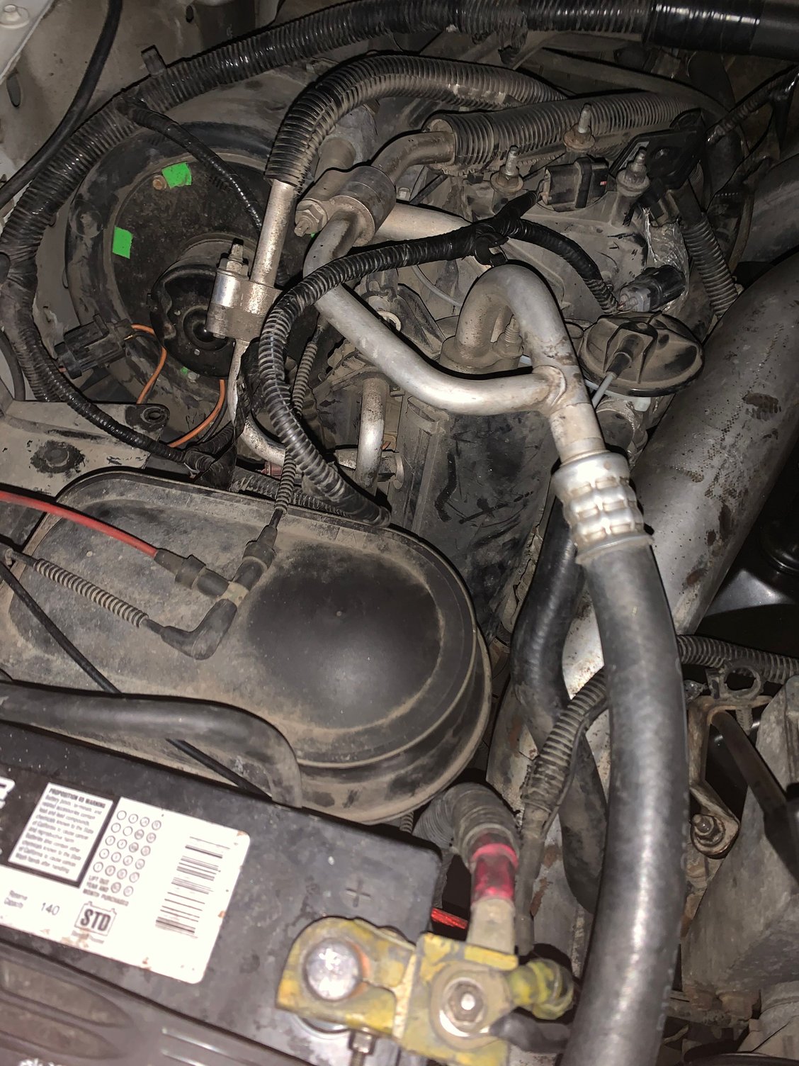

So I ordered the compressor it should be in by Monday . I ran into a small problem the ac line that splits to the rear ac it’s a little longer and has different bend in it for the v10 the 7.3 one is just a 90 degree turn
edit : I just ordered it screw it I’ll find out if it does if not I’ll force it to lol but would this branch off on the ac line from the compressor to the condenser radiator would this be where the high side switch screws on ????

I'll hopefully remember to take some pics tomorrow for you. No high pressure switch from what I remember, a high pressure blow off on the compressor if I remember.
I’m not sure either , I can’t find anything on it and I just got off the phone that I bought the x from and he said the v10 ac compressor was good but being that the compressor lines are cut would that mean I would have to flush or replace the evaporator and lines as well or just throw a vacuum on it and change it ??? And would the expansion valve be ok?
this is the line that was cut and it’s been open for some time I’m not sure really what to do this is my first ac system iv worked on
