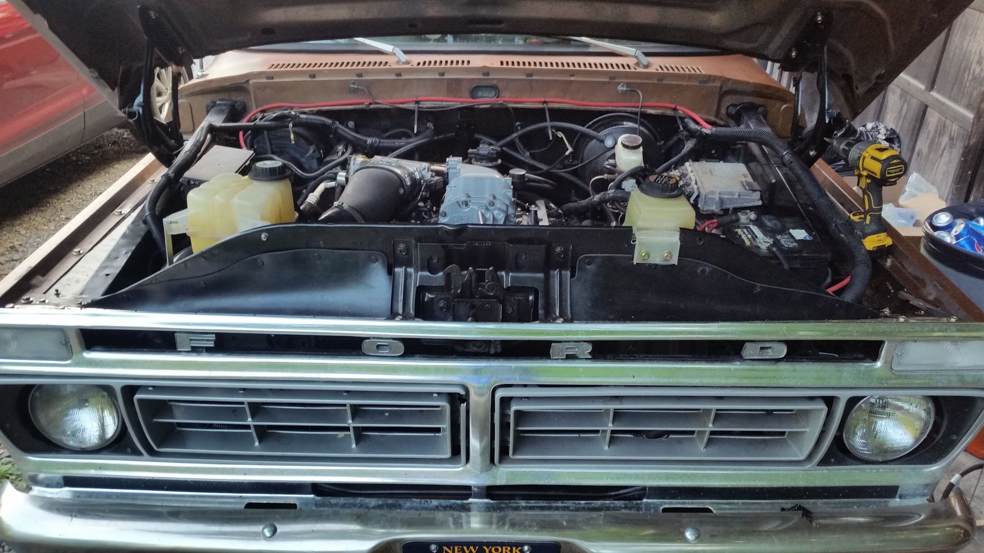

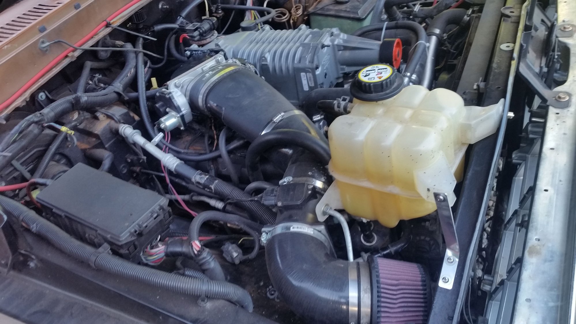

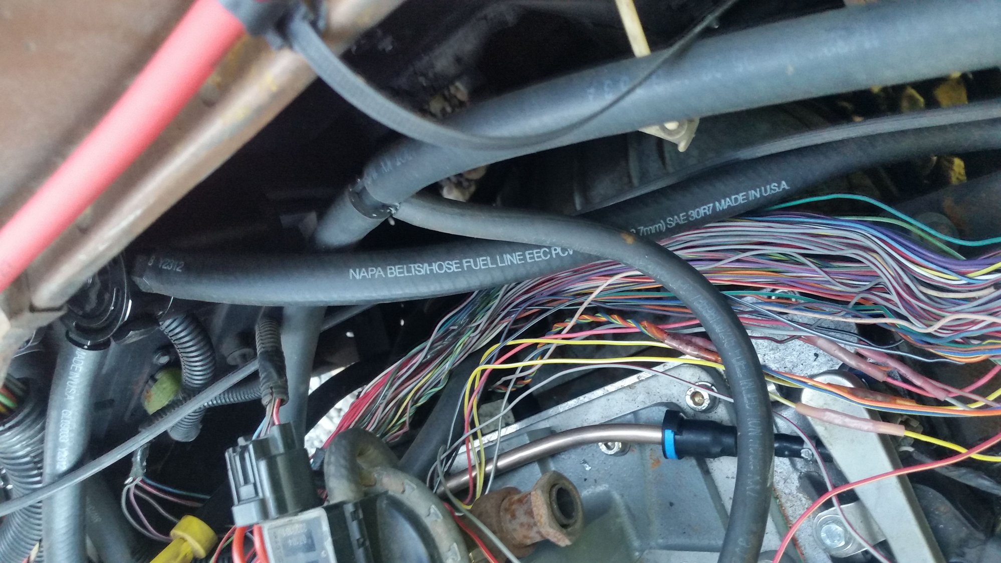

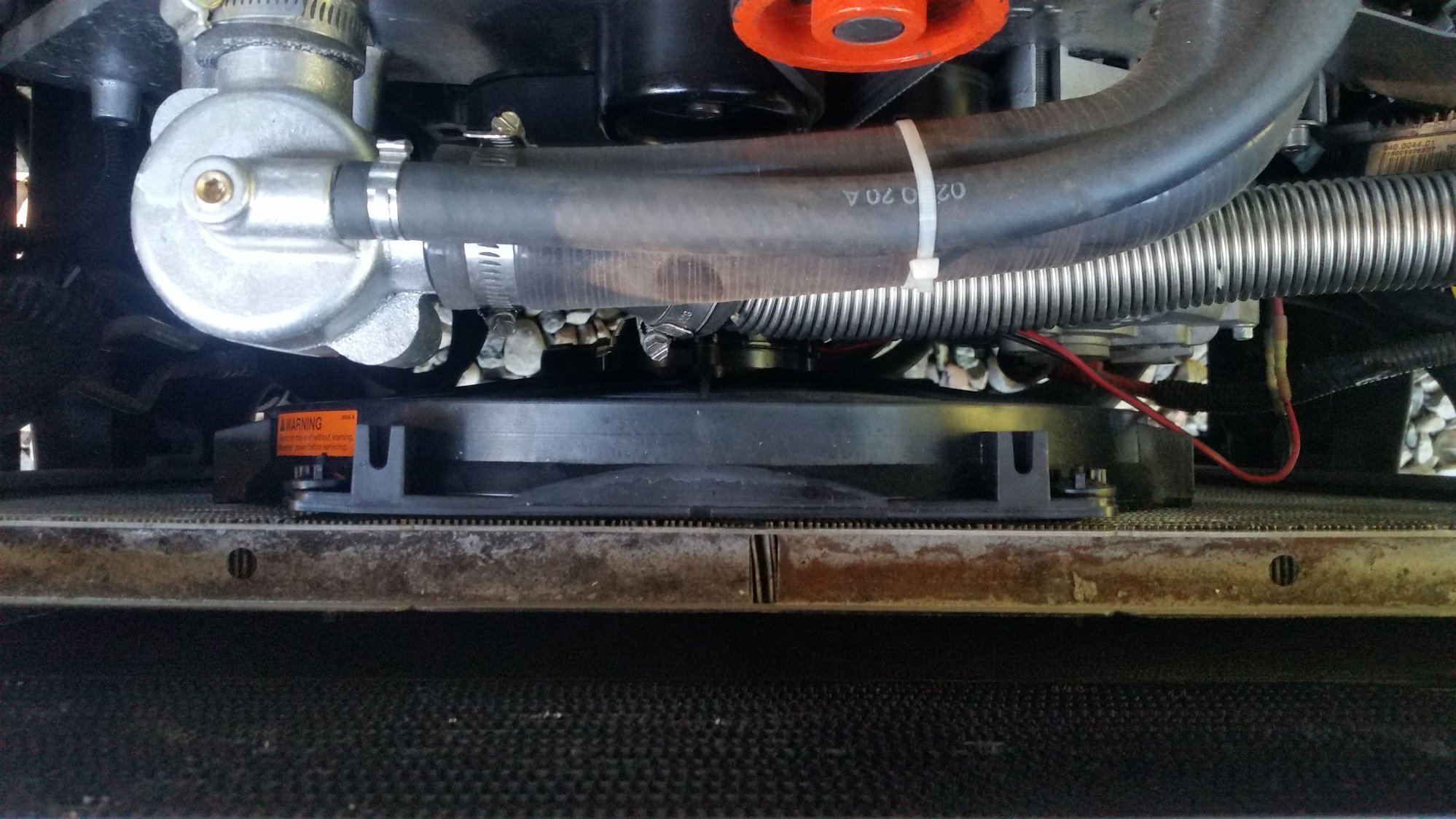

Heres some pics don't mind the wiring have new loom for it just Waiting to comfiRM it's all good to go first
Intake tube
Fan
Half of fuel crossover its hard to get a pic of
Other half

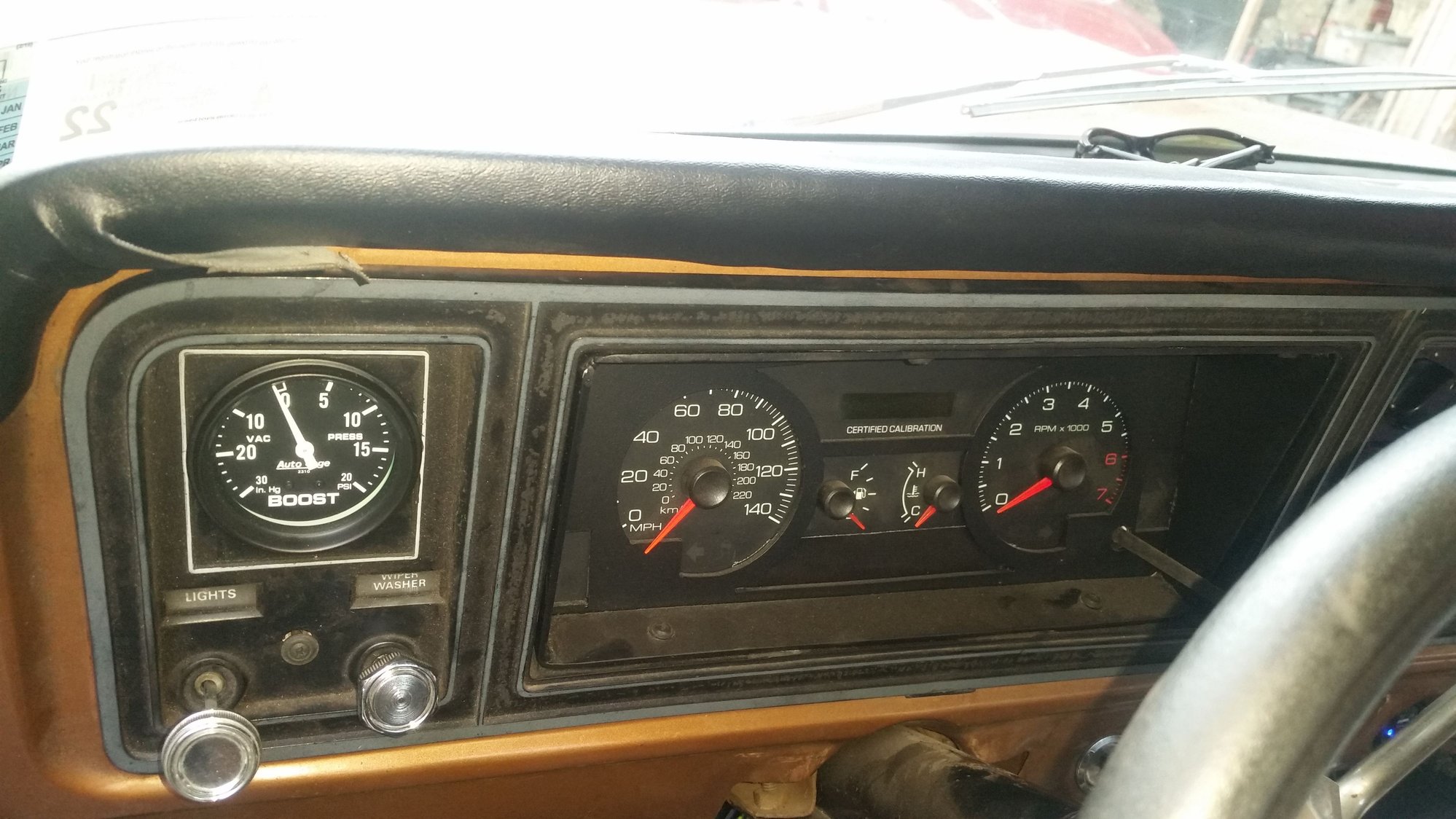

Boost/vacuum guage is hooked up mounted and wired. I Have Seen Alot Of Ppl Mount gaugesHere So I Did Also. Not gaudy and out of the way.

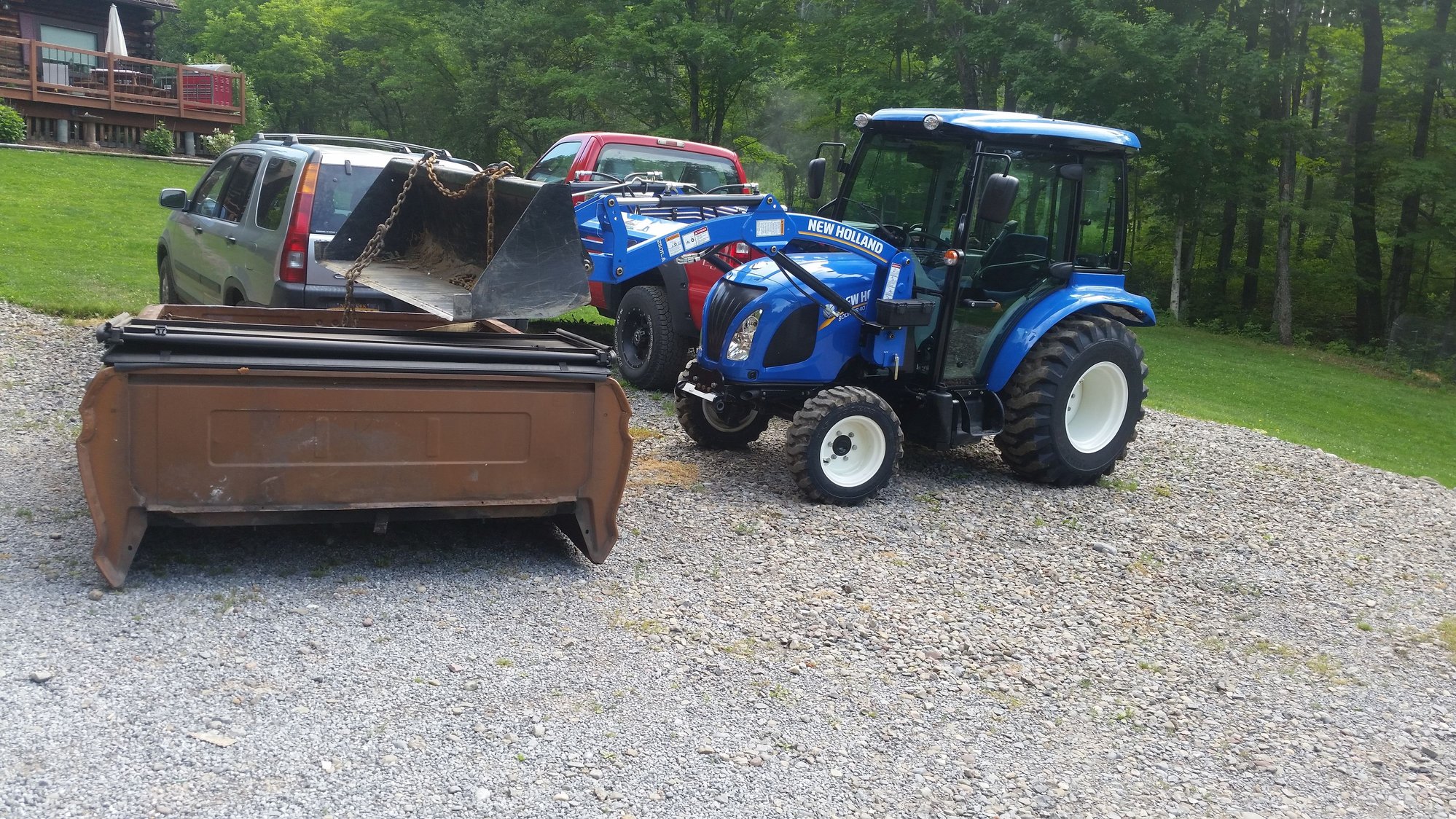

Had a day off work yesterday and got alot done dispite it being in the high 90s with 80%humidity. Pulled the bed again an finished the exhaust, I only had to change the tail pipes they went over the axle before but with the irs they had to go under. I used the old tail pipes just cut the bends up and reconfigured they were only a year old, looks a bit patched togather but they will be a good pattern if someday I decide to replace with new pipe. Also washed under the bed and checked all nuts and bolts and bled breaks before putting bed back on. I plan to order the tuner today and that's the last big item. The plan is for the wife and I to take the truck on a 2.5 hour trip to the thousand islands for our 5th anniversary the end of August, there's a cruise in up there that weekend also so will be the first time I have been able to take it to any event thanks to Covid and working on it.
Bed removal for the 100th time it feels like

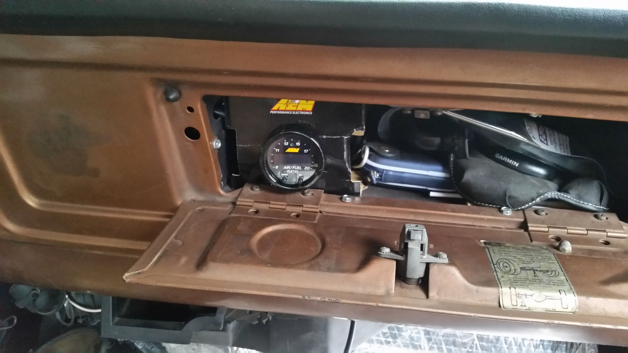

I got seat belts orders and my sct4 tuner ordered with a bass tune from moes speed shop, also have a remote tuning session scheduled for the 13th​​​​​​. Had to install a wide band af guage for the tuning so that's done, donno where to Mont it so stuck it in the glove box for now. Also installed a cable to hook it to the tuner/data logger. Last I got some rubber parts installed from the grill to radiator support as well as fenders to rad support they have always been missing getting closer

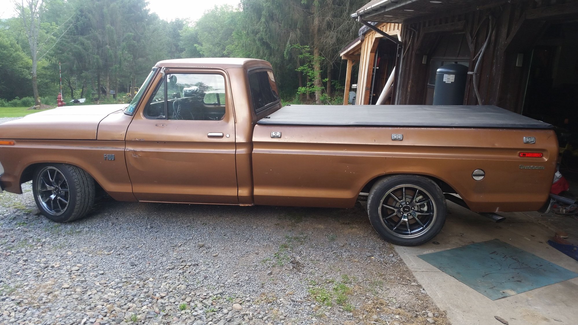

Stands out in a parking lot
