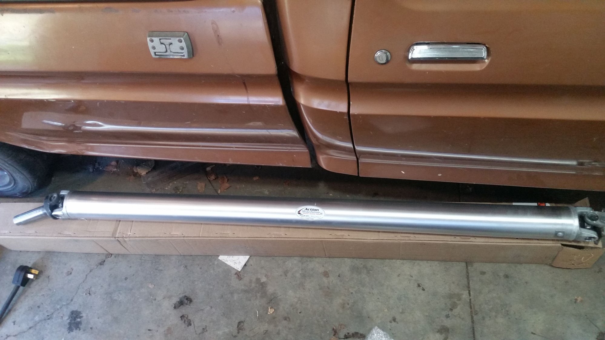

Well I got the shaft today lol. LoOKs good was pretty fast turn around, I would deal with them again.

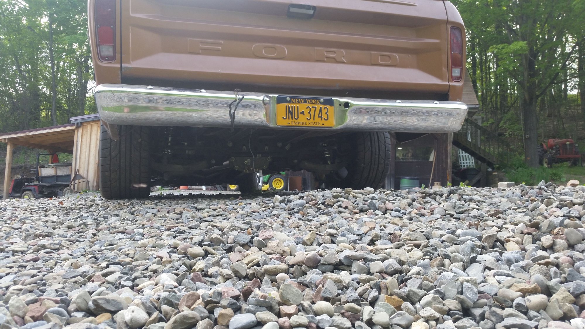

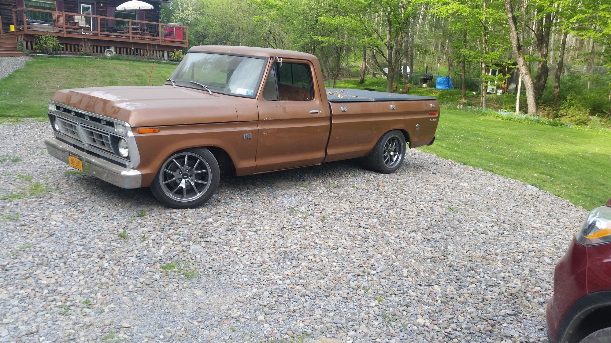

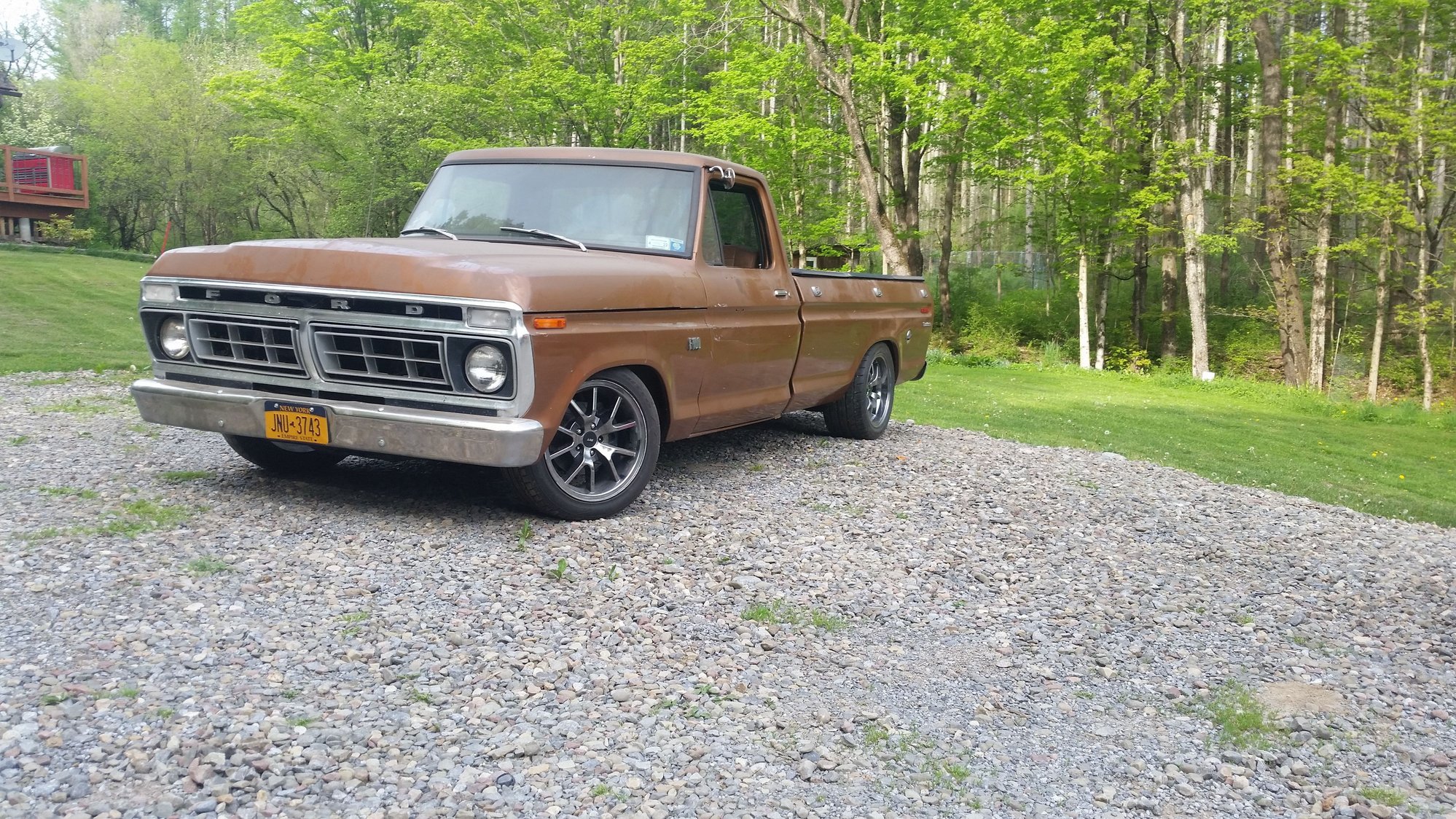

I got the new drive shaft installed but then the head gasket went on my dd honda so had to push the he truck our to make sone room. Nice to see it out of the garage, snapped some pics of the new stance.
