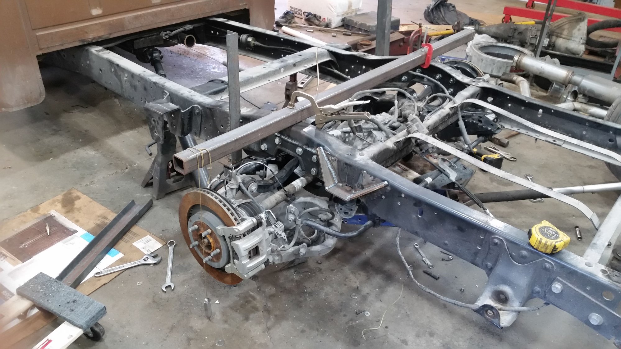

Some progress on the rear suspension dont mind my mess I was in the "zone". Monlunting the suspensiom to the bottom of the frame made ride hieght to tall for my so i had to recess the rear mount 2 inches. The front mounts are just to hold it while I build permanent ones. Then the whole thing will have to be boxed for strength I also had to modify the top part where the sway bars mount so I can still hopefully fit a stock fuel tank.

Got some more done tonight, mounts are done coil overs are mounted and gas tank is goin to fit with a small but of rubber hammer work to the front lower corners and bending the seam up so it fits between the rails. I think the ebrake cables will hook up to the stock truck pull assembly. The driveshaft will have to be shortened so hopefully I can go to a one piece shaft also. One other thing I didn't know the irs uses 14mm lugs which is bigger then the crown vic. Here is where I am at still needs to come back apart so I can finish grind and repaint the frame.

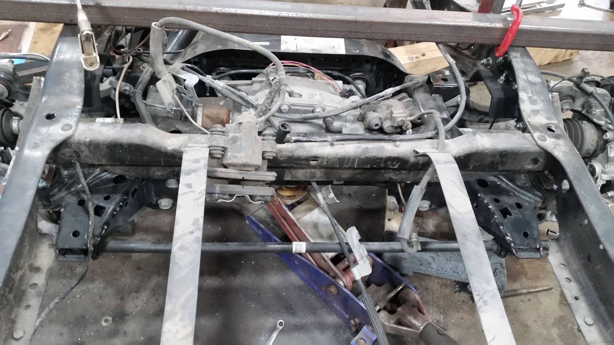

Boxed part of the frame where the subframe is, painted it and installed subframe hopefully for last time
Had to pie cut the end of the sub Frame for fuel tank cleanance

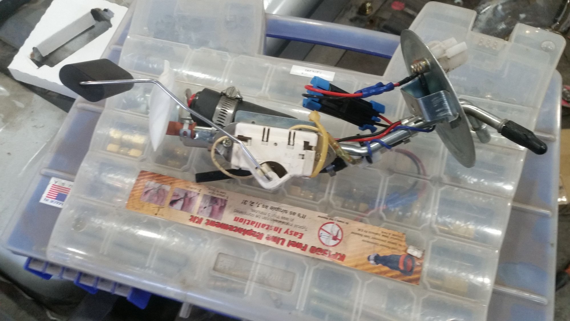

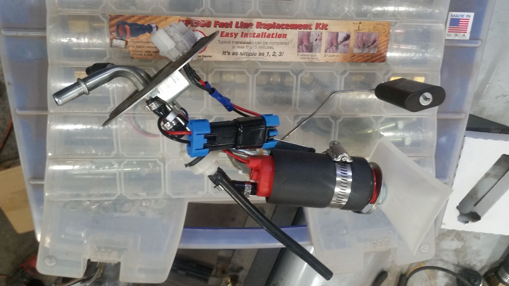

I got the fuel tank reinstalled, I also swapped the stock pump out for a 340lph aeromotive unit. This should supply enough fuel even with the supercharger. Took some pics of the sending unit I am using because I couldn't find much info on it whe I originally built the truck. I used a fuel injection tank and sending out of a 85? bull nose f100. Adapted the sender to fit the crown vic level sensor as well as fuel pump and bypass. It works well so far I set the float so empty is accurate but guage does stay on full for quite a while befor dropping. I am using crown vic guages

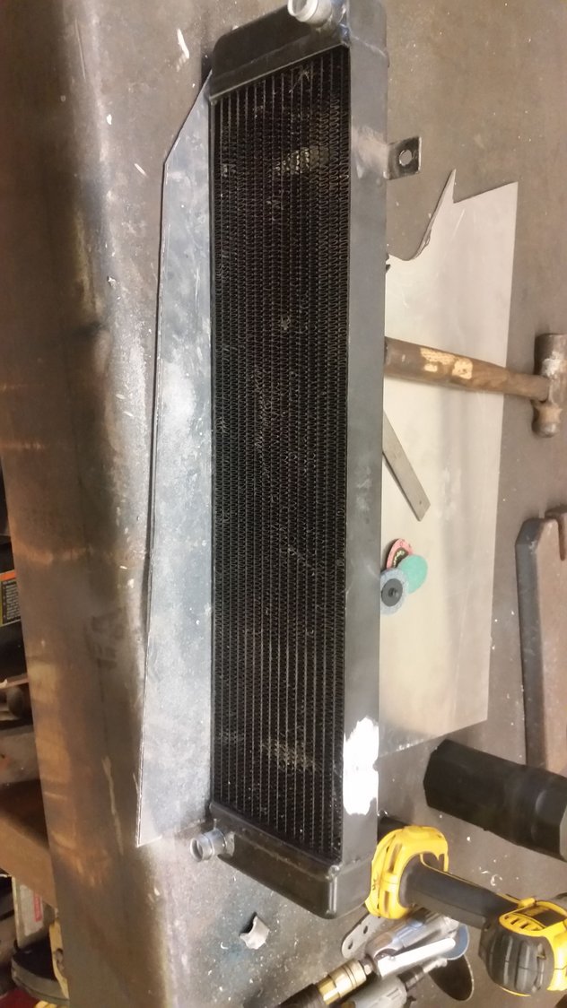

My supercharger heatexchanger showed up I bought a used on with broken tabs because it was 1/4 the price of new and I would have to move the mounting tabs anyway for my untraditional setup. The tabs looks a but funny but should fit in the space I have above the radiator, since I used a crown vic radiator and it is mounted low to use stock hoses.

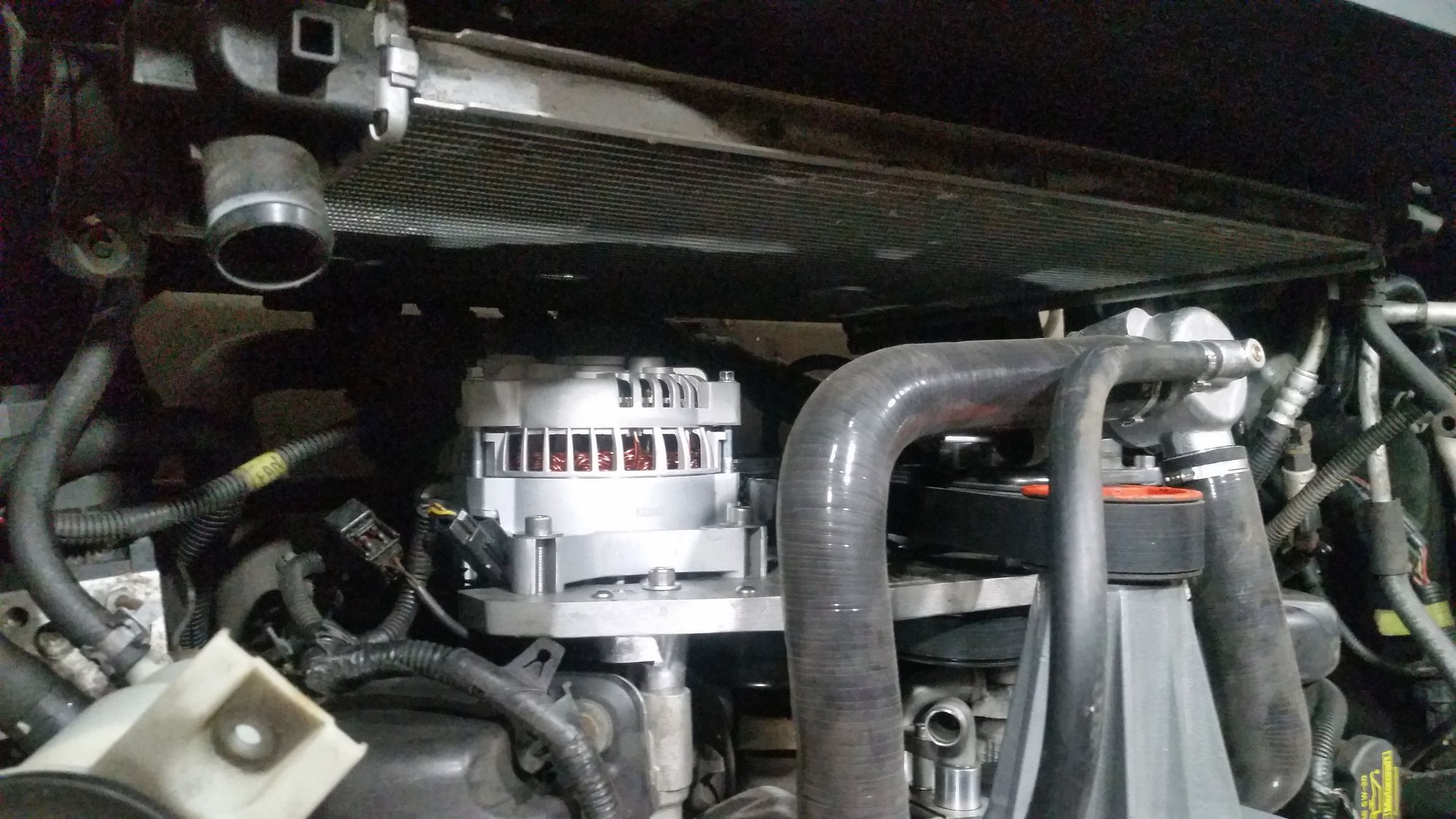

Haven't had much time to work on truck since we had our first child Nov 30th but I had a few hours last night and got the intake and supercharger mounted. Figured out where to mount the intercooler, put in some cooler plugs. I also had to put a non police interseptor alternator on so it would fit. Kits made for a mustang so there are some challenge fitting it to a crown vic and more if the crown vic parts are in a truck. The stock crown vic fan won't fit now so I will go to a slimmer aftermarket one. The intake tube and the ac lone are fighting for space and the fuel rail cross tube needs to be longer now. But it's coming.

Cooler mocked up i will install nutserts for final mounting
New alternator and mounting location will need thinner fan i dont want to move radiator condenser oil and trans coolers and change all the hoses to run the stock fan
