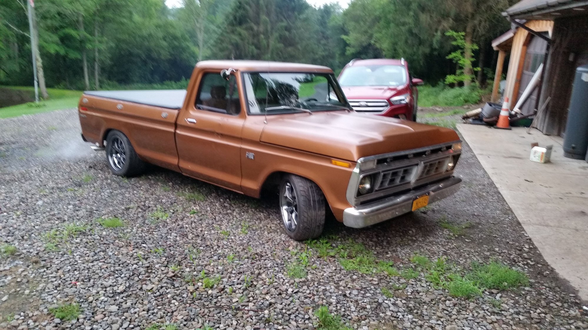

We get them too but I haven't had any problems with pot holes, really not any lower then a crown vic. frames about 7 inches from ground and headers are about 4 but if I didn't have long tubes they wouldn't hang below the frame. I did hit a spot where the road heaved right after a dip and the header scrubbed but that was when I had stock struts and leafs, with the coil overs on it now and rebound and compression set how I want it I don't think that would happen now. I am hoping one day someone will make a long tube for this swap that fit better these are mustang headers with one primary modified to alow for the steering shaft.

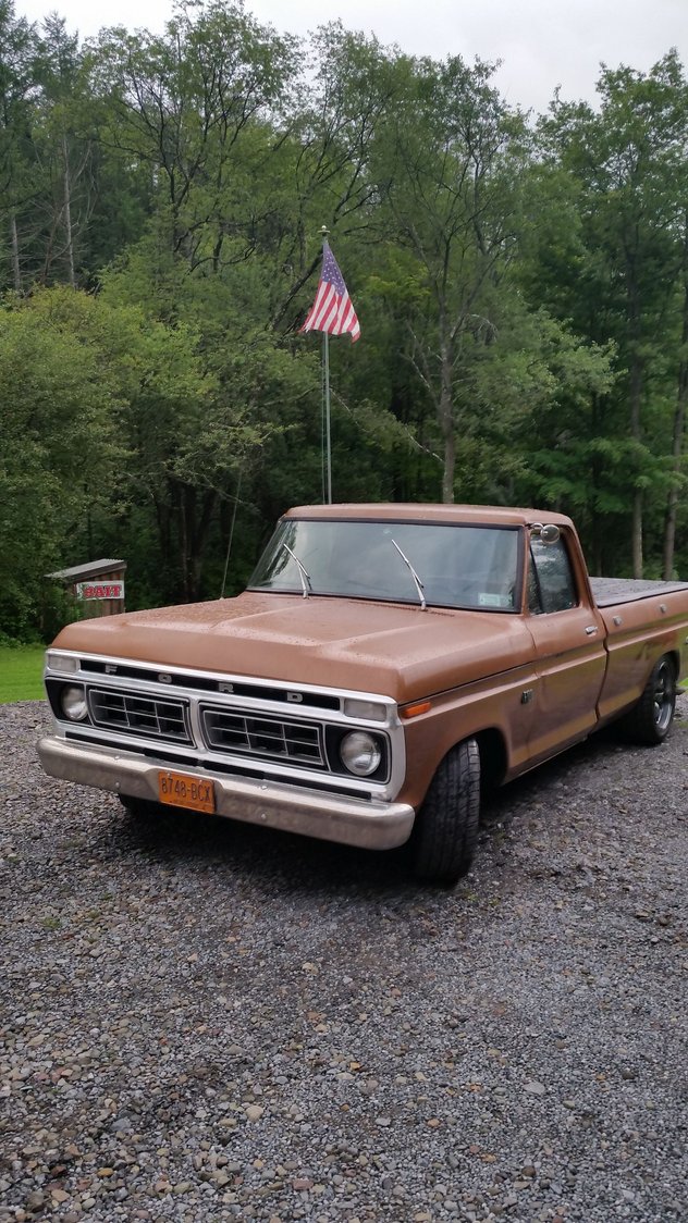

Thanks for the kind words, I upgraded the fuel pump wiring and data logged another 2000-5000 pull I will send today . There is a rich cold start or open loop issue I datalogged also so we cn figure that out. But other then that its running well, I plan to get the tires road force balanced I have a small vibration at 65. Also need to get leaking winshield fixed or replaced. I did get it washed and waxed last night though

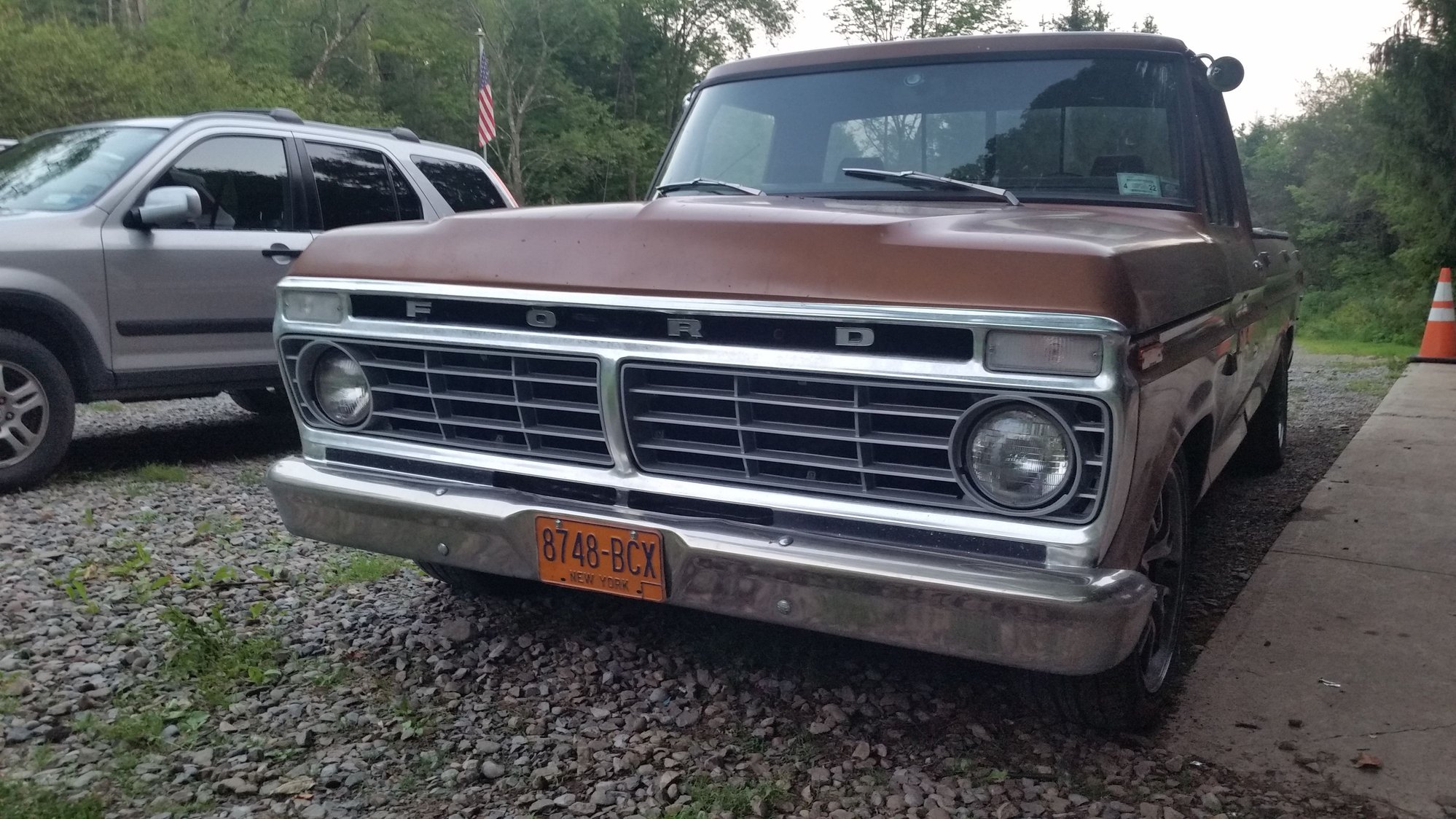

Got the regI station sticker in the mail today for my "vintage" plates. These were used in ny from 1973 to early 80s I think. Got a reproduction 1973 registration sticker for the rear one. Maybe it will help me sleeper profile
I know i have to adjust that bumper

I really like the look of that contour bumper

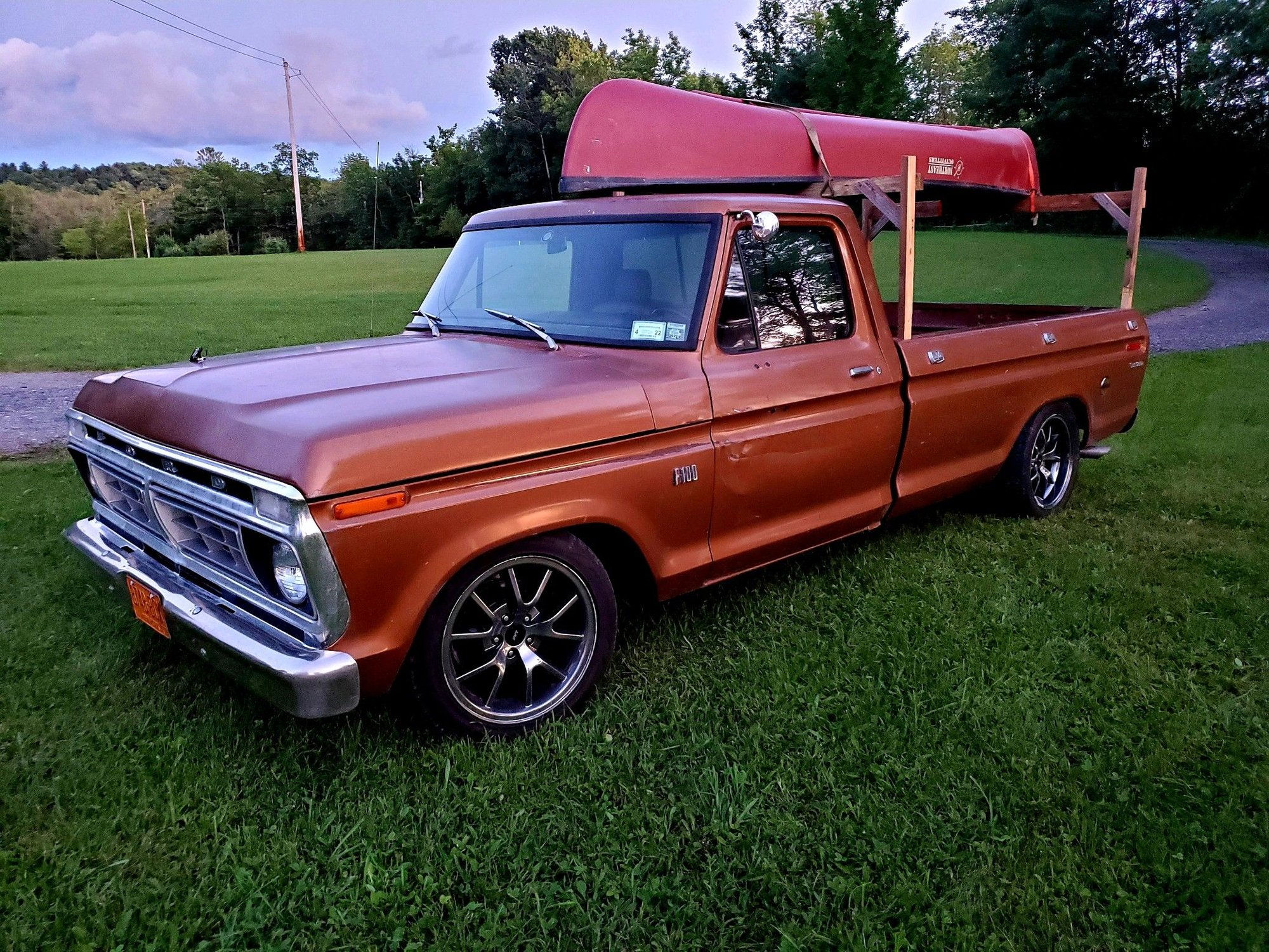

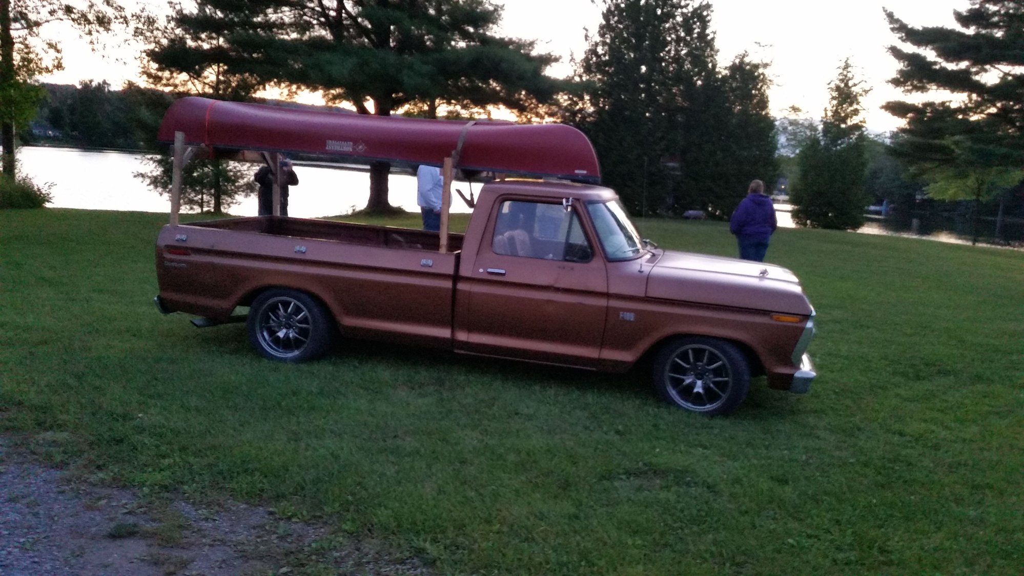

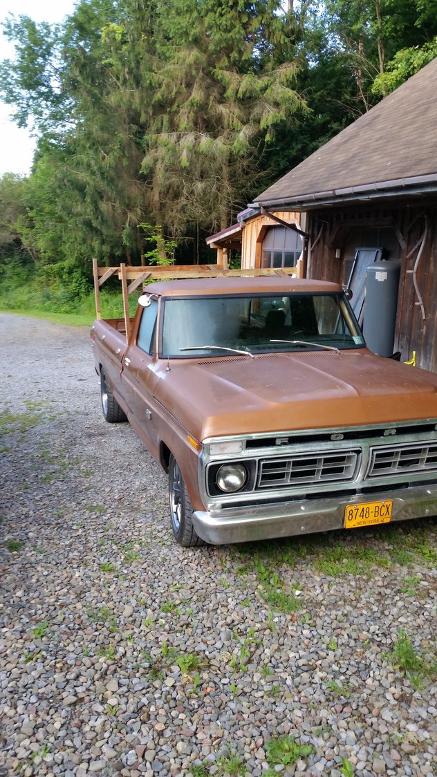

Did some "heavy" hauling wit the truck yesterday. My aunt in syracuse neighbor wanted this canoe gone and my wife's uncle wanted one for his home on the lake. Was about a hour and 15 min each way truck ran great. Got some looks for some reason.
Quick rack from some scrap lumber

My 73 grilles arrived from denny carpenter so I installed then ,at first I wasn't sure I would like them because I I really like the 76 inserts but I think they have grown on me now and will stay. Also ordered a universal steering column with tilt that I will replace my ford column with. My signal switch won't return, I can't get the shift indicator to line up good with the
4r75e trans and I really want a tilt wheel to see gauges better. Once that arrive I will attempt to install it and get it to play nice with the crown vics bcu.
