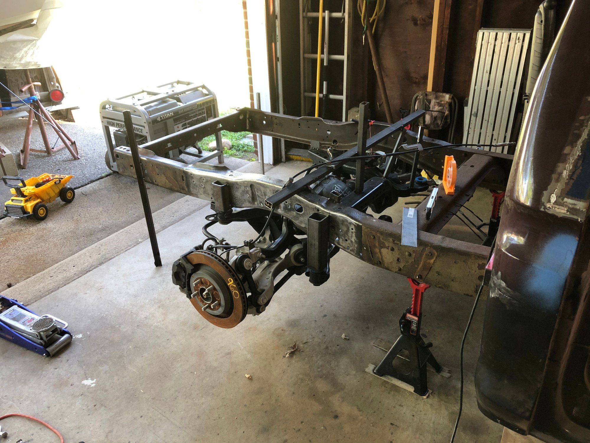

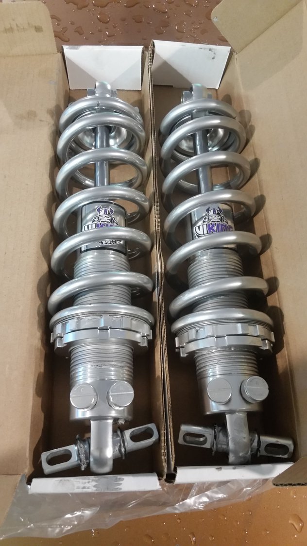

Well it's been a while but I built and installed some anti drone tubes and the exhaust still sounds good but quiet inside. I installed 80+ door weather strip but have to slam the doors so hard that I put stock style back on after a few weeks. i tried extra air holes adjusting stricker and lung the trim but it just didn't work on my truck. I still think the truck rides to stiff so I bought a a irs our of a 2017 mustang and a set of coil overs for all 4 corners. Hopefully I can get it all installed this winter even though my wife and I I are expecting our first child around thanksgiving. Time will tell, sorry for yhe long post but I have some pics
Lower control arm brackets from outcast i made my own from the stock crown vic parts. They funtion fine but these are so much nicer have poly bushings and use shims for alignment. And this guys fab work is awsome wish i knew about them when i built the truck
This is the irs complete with sway bar and ebrake cables, its 3.55 gears and limited slip
Rear coil overs for mustang irs still waitingnon the fronts but they both have 19 rebound and dampening adjustments

My viking coil overs with the brackets from andrews performance showed up yesterday so i installed them last night. What a difference in ride and handling. They fit perfectly. With them adjusted for full height the front dropped alost an inch and can be lowered about 2 more inches. Can't wait to get them on the rear.

Nice on the irs. I am putting the same one in my truck. Decided before I Hack the frame, built brackets that will be welded to. Have it all tacked for now. Going to sit it on the ground this weekend to see how ride height is.

Looks great I was thinkin same thing tack brackets and check ride height and hopefully won't have to hack frame to much. Are you running coil overs ?

yes, I got the kit from Andrew. Should have all the tacking done and on the floor this weekend. I’ll respond back when I do so you can get an idea of height.

Got the 8.8 rearend and springs out that will be posted is classifieds in the future along with the lowering hangers and shackles. Still have to remove the tail pipes but I rolled the irs under just to see. I also ordered the tork tech kit for mounting the supercharger, it's mostly the parts to mount and turn the SC I will have to source bigger injectors , maf, fuel pump and heat exchanger from various vehicles to make it all work. I did get a throttle body for a 2010 gt500 to use with the sc with very little modification needed to bolt it on and its bigger mm and uses the same plugs to operate as the crown vic harness has already

Can you turn your pics horizontal next time? I like seeing pics but I can't see yours very well on their side.....LOL.

Hope that works phone used to turn them for me must have screwed that up somehow
