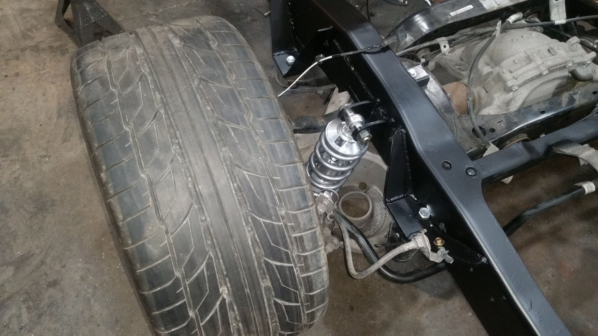

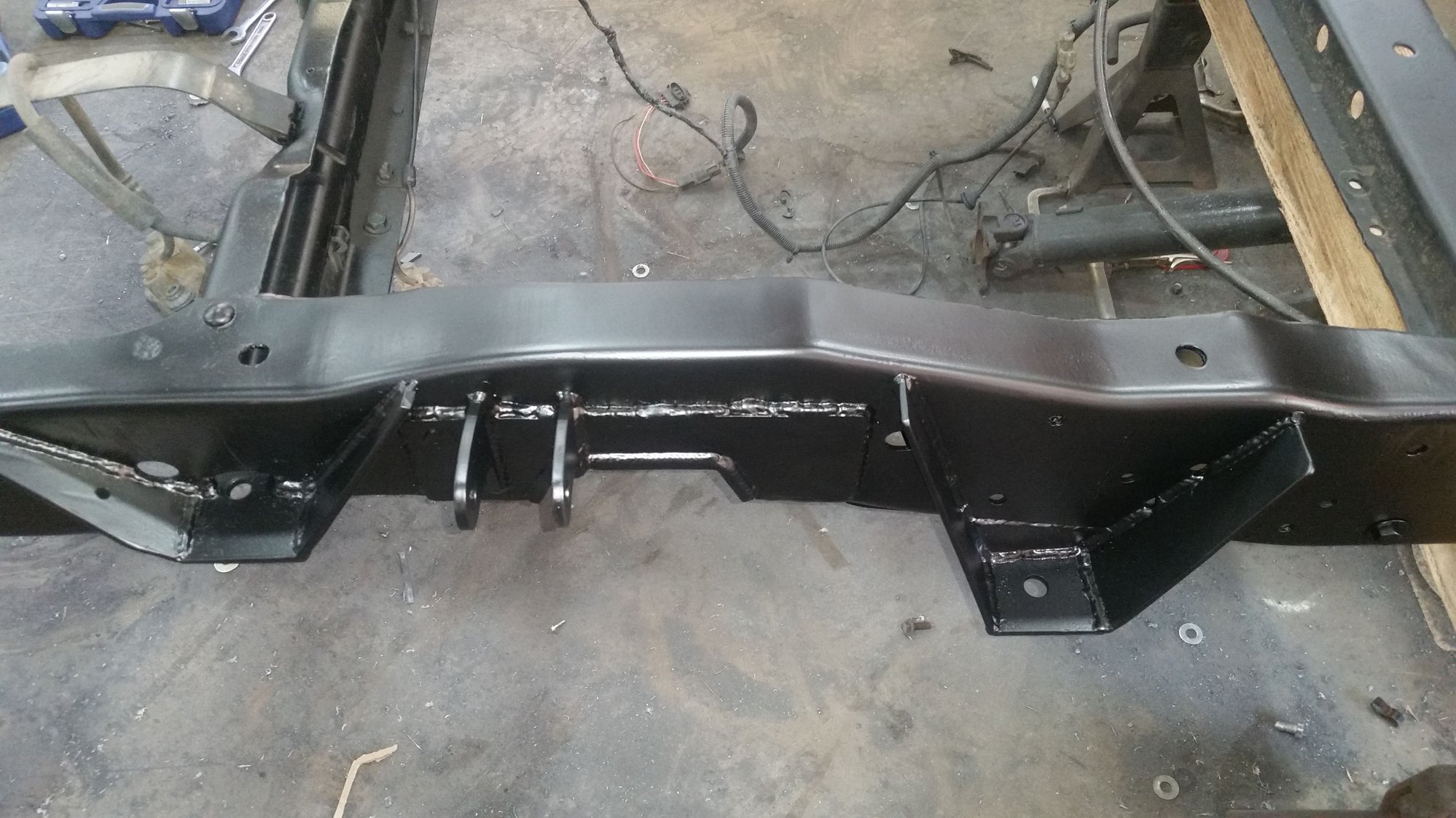

Boxed part of the frame where the subframe is, painted it and installed subframe hopefully for last time
Had to pie cut the end of the sub Frame for fuel tank cleanance
Finished

Im working on a father/son project similar to yours, except I have rust shell of a lwb ‘59. Crown Vic is mocked up up front and I think I have the irs where I want it. I am going a little lower and bags (why? why not?;-/). I’m currently working on the mounts and was wondering if you had any advice from your swap? I’ve built offroad trucks before, but this is a new adventure for me. I’ll take any advice you have.

I considered bags also that will be cool . I just measured alot toger the where I thought I needed it , I 2x2 angle I had tacked to the frame with the mounting plates tacked to the angles and bolted the irs in with my coil overs. I used heaved tags in places I could easily grind them off. The I test fit the wheels bed ect, I removed the springs to test travel as well. when everything was where I wanted it I I disassembled everything built gussets to the mounting plates and removed the angles and boxed the frame. Donno if its thr right was but I goes straight was able to be aligned and so far hasn't fallen out

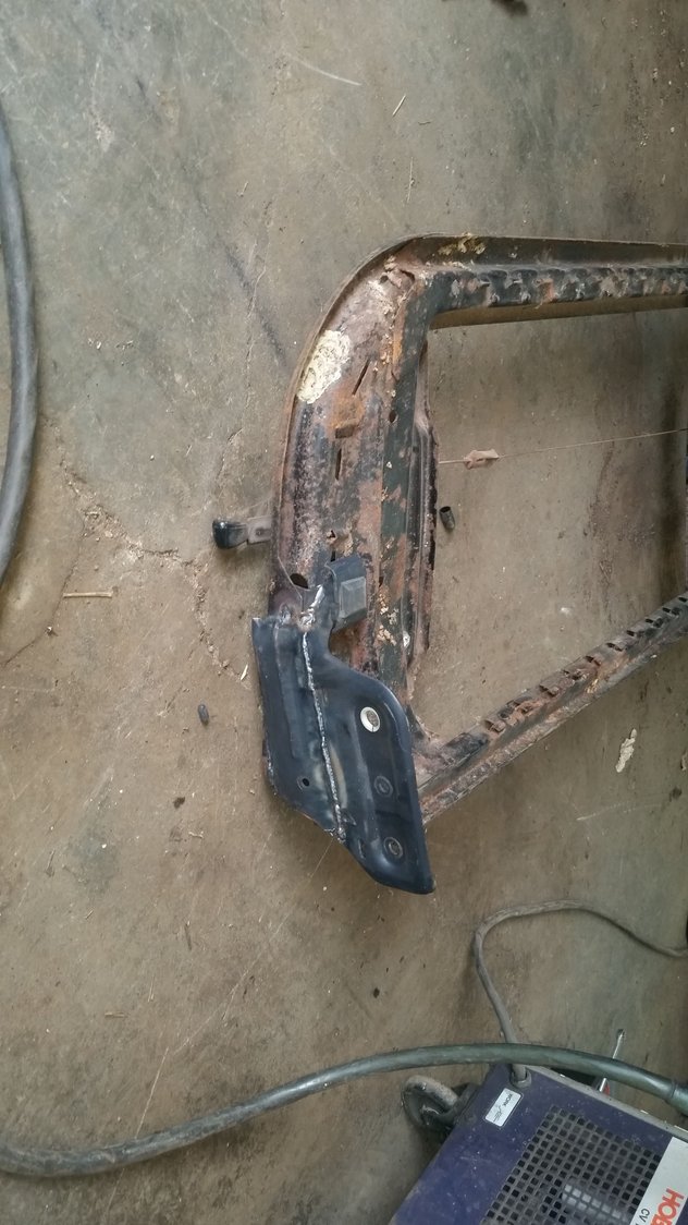

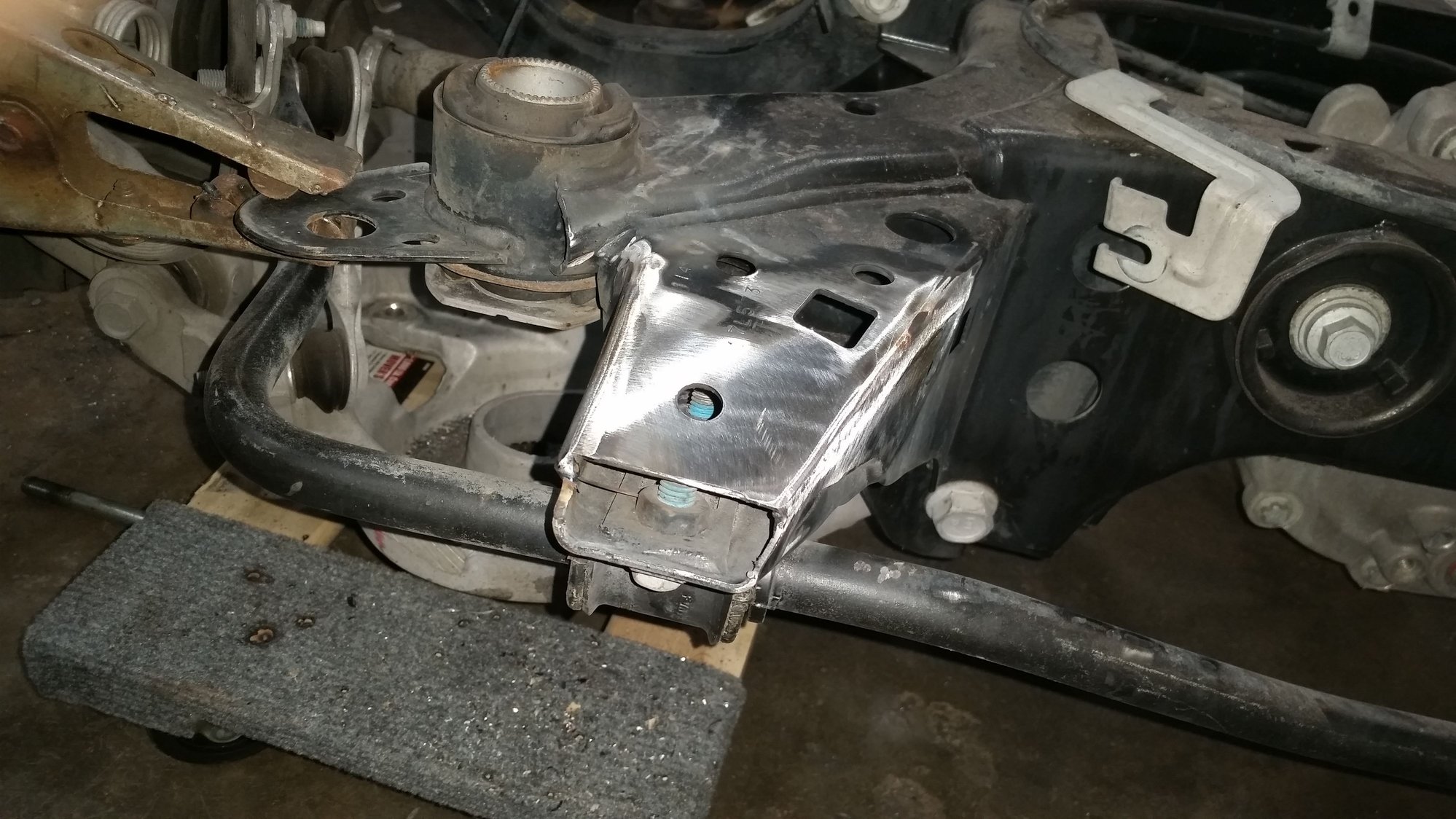

Got the seat installed used old pan and welding parts of the rear king ranch seat to it worked out pretty well
Thanks for sharing! Trying to understand how you approached this - I've removed the track from my original seat, but it looks like you removed the entire bottom frame from the seat with the track still attached?
And then, you removed the bracket from the new seat? And cut some of that down?
How did you determine how much to cut from the new seat bracket to get things lined up right/sitting where you wanted it?
Thanks! Sorry, never done a project quite like this, so how I was going to approach this was pretty different from this, but guessing this is way smarter/better than I was going to do.
Old Nov 27, 2023 | 06:34 AM
  #187
symonds86's Avatar
symonds86
Posts: 962
Likes: 89
From: upstate ny
i used the old seat bottom because the replacement seat was 2 pieces and i wanted to use the stock mounts i did some calculated guesses and trial and error to figure out where to trim and weld
