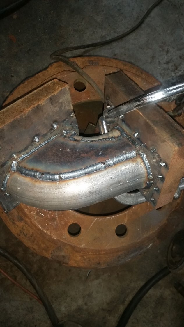

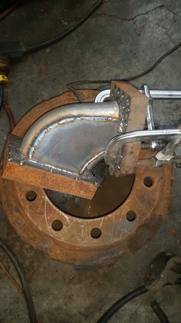

Had some time today, I have been trying to figure out how to make the elbow off the super charger work. The throttle body was hitting the fuel pressure regulator, and the intake tube needed to go where the ac line was. I am not giving up ac and the line doesn't have the flexibility to not be in the way, and I can't really move the fuel pressure regulator. I had some 1/4 hot rolled plate, a scrap 2.5 inch exhaust bend, and a plasma cutter so made and elbow. Its just tacked up for proof of concept and needs plates cut to fill the top and bottom, finish welded and a lot of cleaning and grinding but I think it will work. I have a cuple pieces of 3/4 plate I will tack the ends to.while.welding prevent the 1/4 plate from warping.
Stock elbow works great on a 4v mustang not so much on a f100 2v frankentruck and i didnt need the idle air control on the stock elbow
Rough and ugly but i think it will work when finished
Throttle body clears everything

I got the elbow welded up once it cools I will cut it loose of the 1 inch plate that hopefully kept the flanges straight​​​​. If it worked I'll clean it up and paint

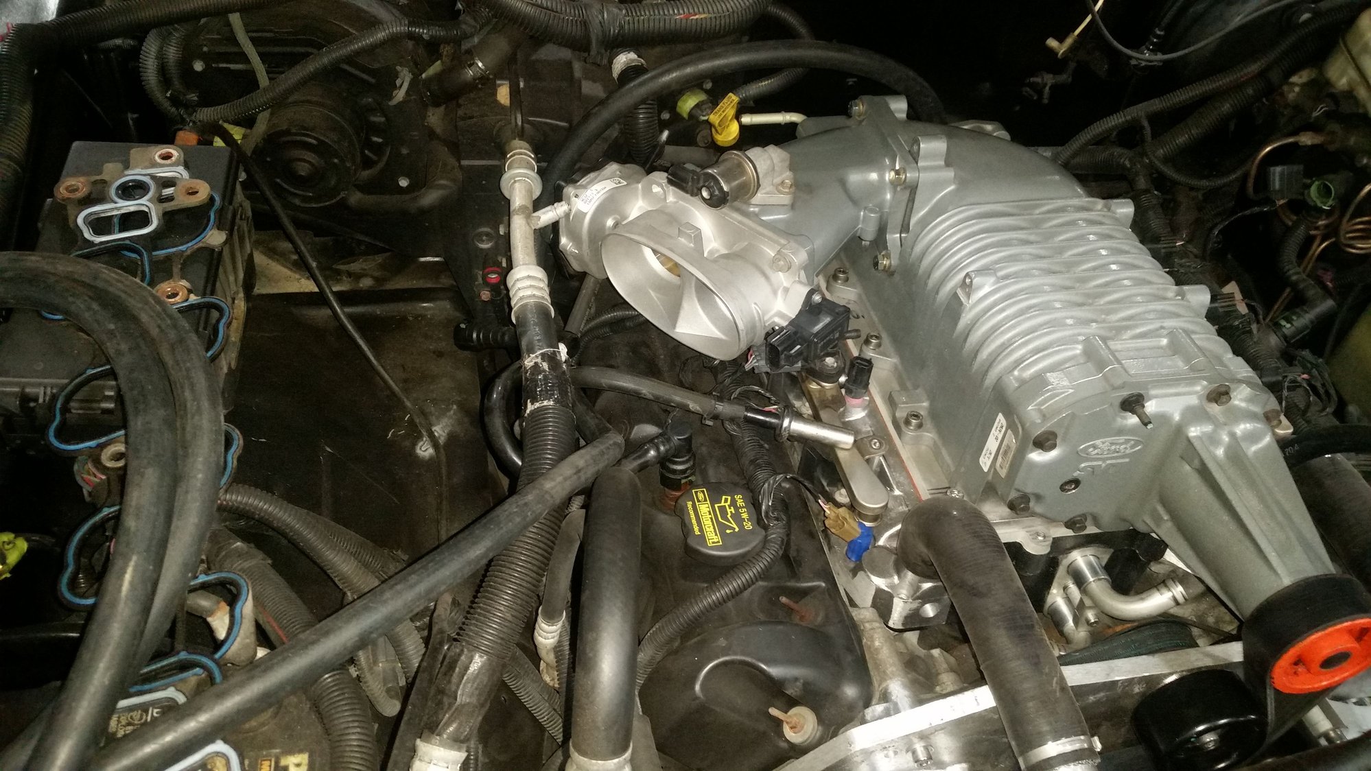

Mocking up the plumbing for engine coolant, sc coolant and intake. Most if the throttle body, and maf wires need to be rerouted and lengthened that's why the harness is a mess

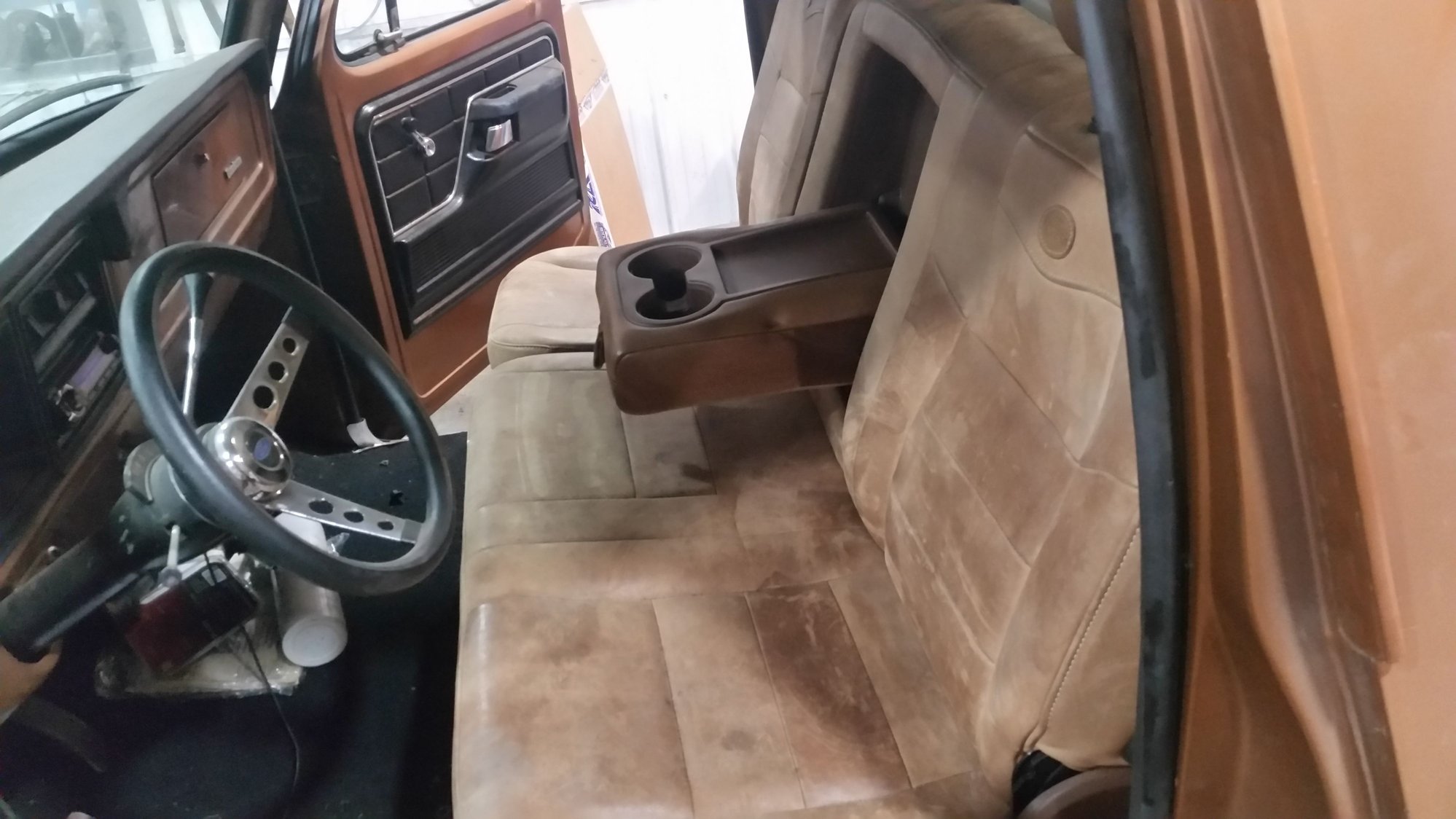

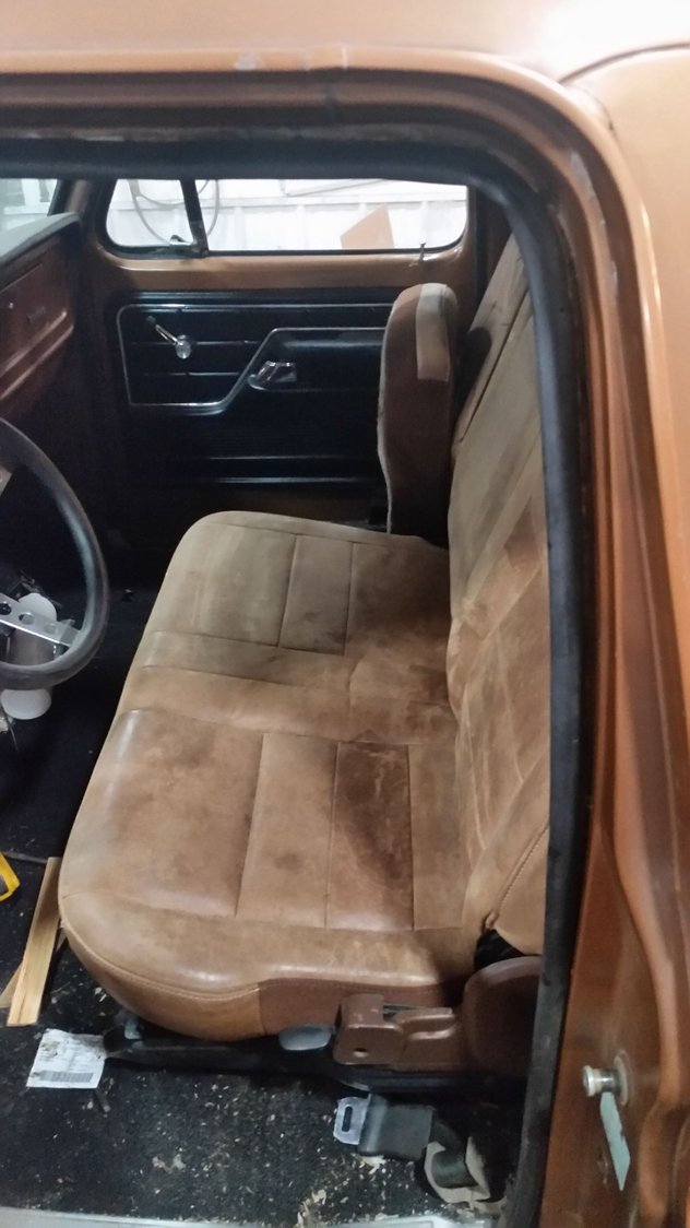

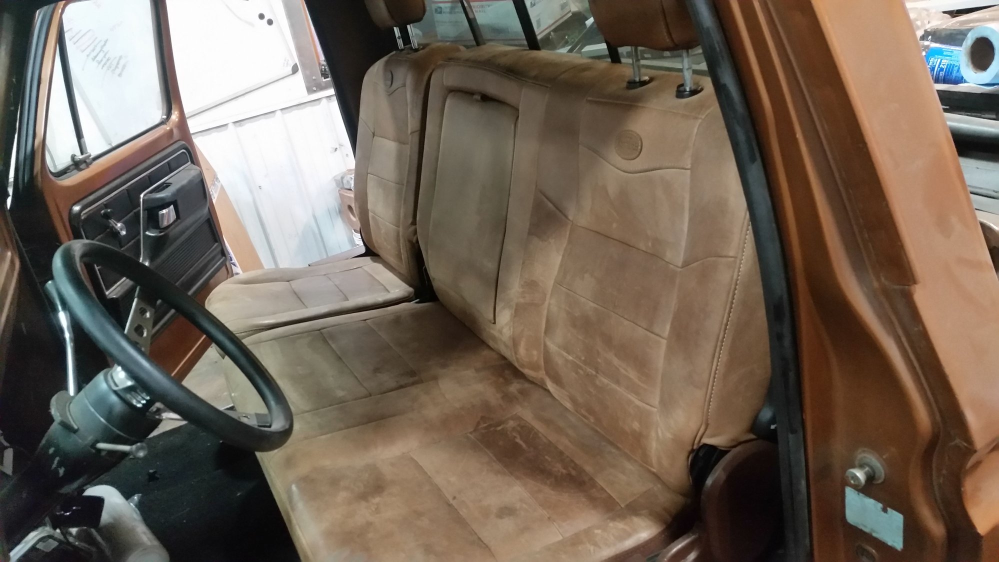

Well my black seat didn't pan out as I hoped way to tall and really would have been a ton of work take them fit. So I called around and a salvage yard about an hour away had a rear bench from an 05 sd 4dr king ranch, I called and the said it was in good shape so I had them send it to a shop I used to work at because it was free shipping to them and close to home. Picked it up today and it's not exactly what I pictured. I was thinking 1 piece bench well it's not. It will fit with minor mods , mainly section an inch or so out of the mounts to lower my sight line in the windshield, color looks good with truck, it has console, and it's comfy but it folds up im not sure if that's a plus or minus. What do you guys think. Send it back or use it.

Sort of does match the truck, bottom lifting up makes it easy to clean under, If you can easily make it work for you, I'd keep it

I am leaning that way too, depending on how much room the is when it's mounted maybe I could do storage bins under it also
